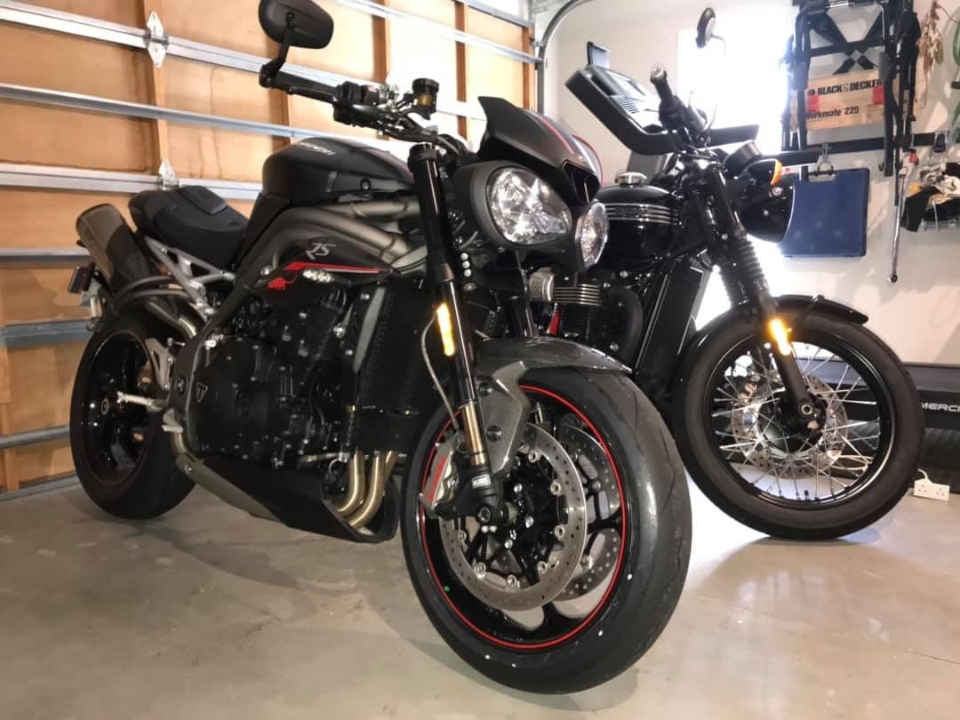

    My brand new RS was pouring oil from the dipstick, turns out there was no o ring at all. Now fixed but some burnt oil stains on the heat shield that won’t come off. They will replace it at first service.
    Not inspiring at all. My paranoid mind hopes the o ring didn’t fall into the motor somehow, pretty unlikely I guess

    Who would have thought that the O-ring problem could get worse. That’s really sloppy - but glad to hear it’s being put right.
    Such a shame this kind of thing taints the ownership experience.
    I’m sure there will be plenty to smile about though - enjoy your new bike!

    Will do, just got to 6,000 rpm and already hilarious. Tucked up in bed with the Bonnie
