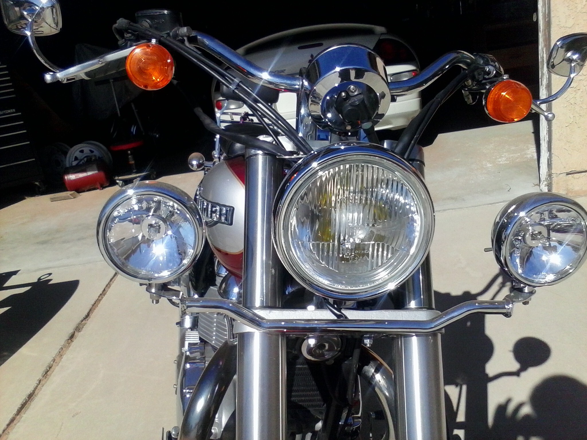

    I have the factory "Passing Lights" on my America. They have thier own switch and relay. But I plan to add another switch and relay for the main beam. Then I can run what lights I want to whenever. I have already found all the parts. Just need to get around to it. ...J.D.
