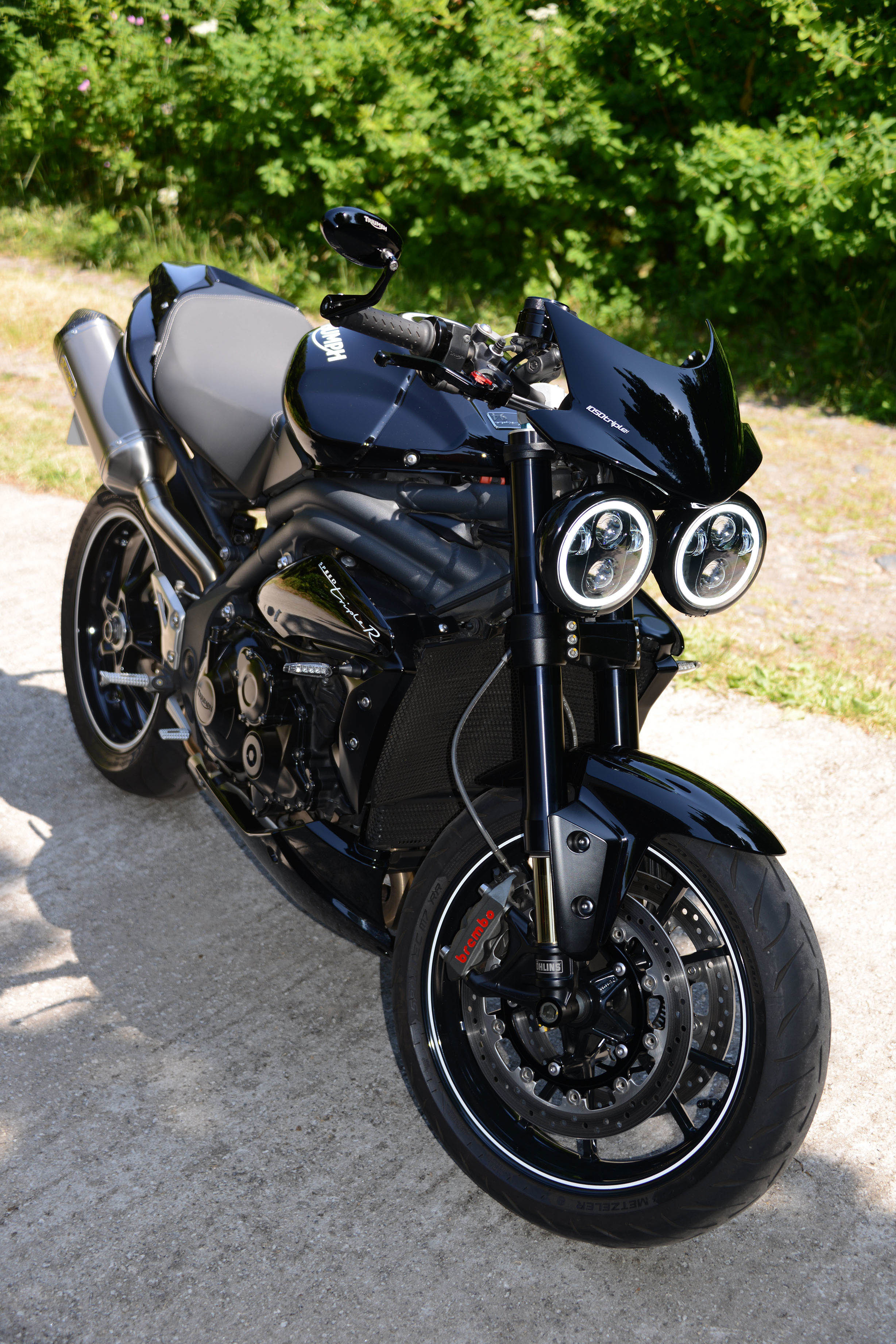

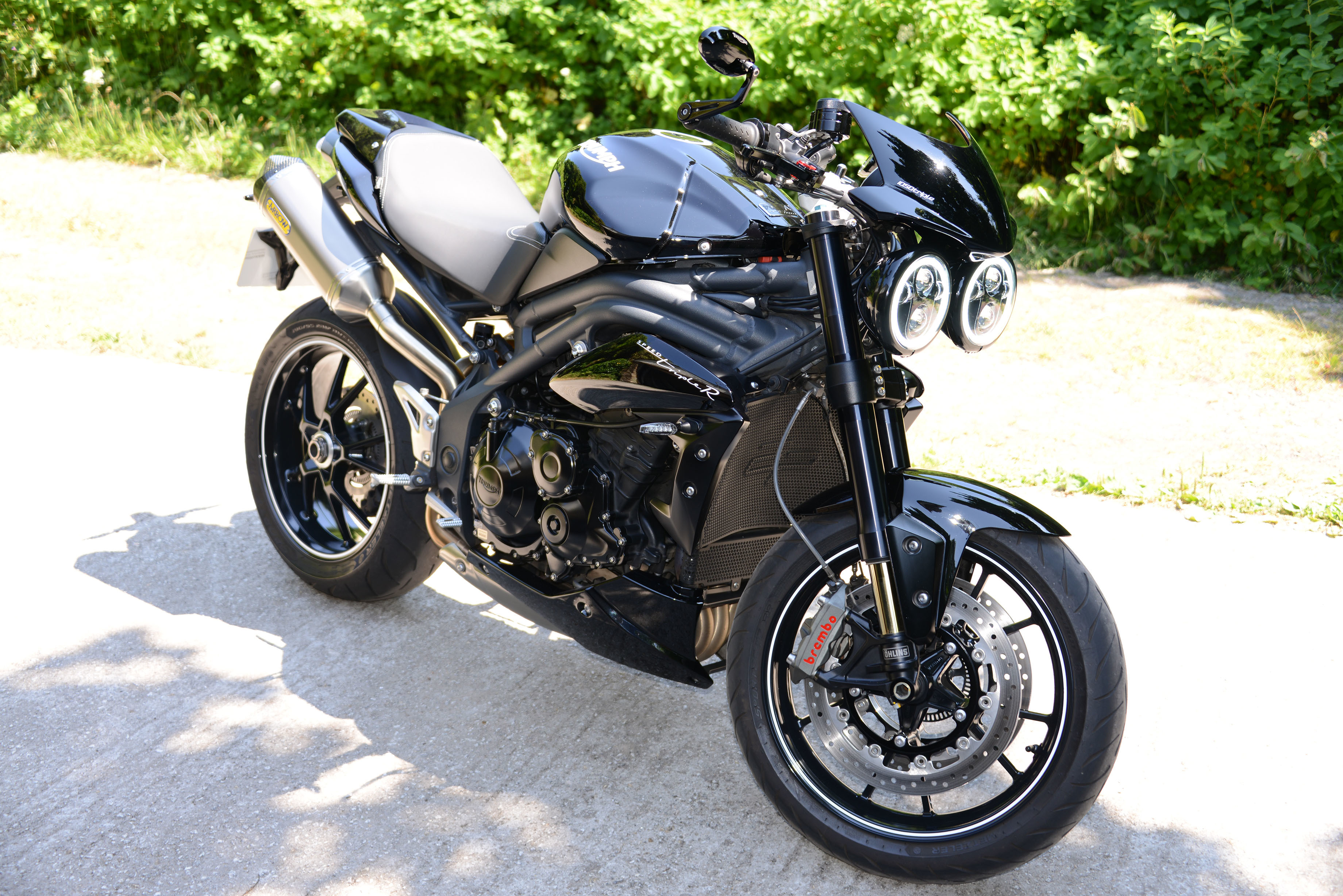

    So when the Speed Triple 94R came out I had to have one, in black of course. Had it now for nearly 3 years and loved every minute. Along the way there’ve been a few mods, mostly the usual stuff from the Triumph accessory catalogue etc. But a few not so routine....
    Starting at the front and most obvious are the headlights.
    The Dame Edna’s have always been contentious and at best I learnt to tolerate them but finally decided they had to go. In place are old school round headlights but with a future twist, I wanted halo DRL’s and LED projectors, this gets rid of the large bright reflector area and gives the bike a meaner look (IMO). The headlights now being mostly black with the white halo it fits well with the retro white graphics of the 94R. A push button (with white halo) is added to the dash panel to enable dipped beam to be disabled, the DRL’s are well bright!

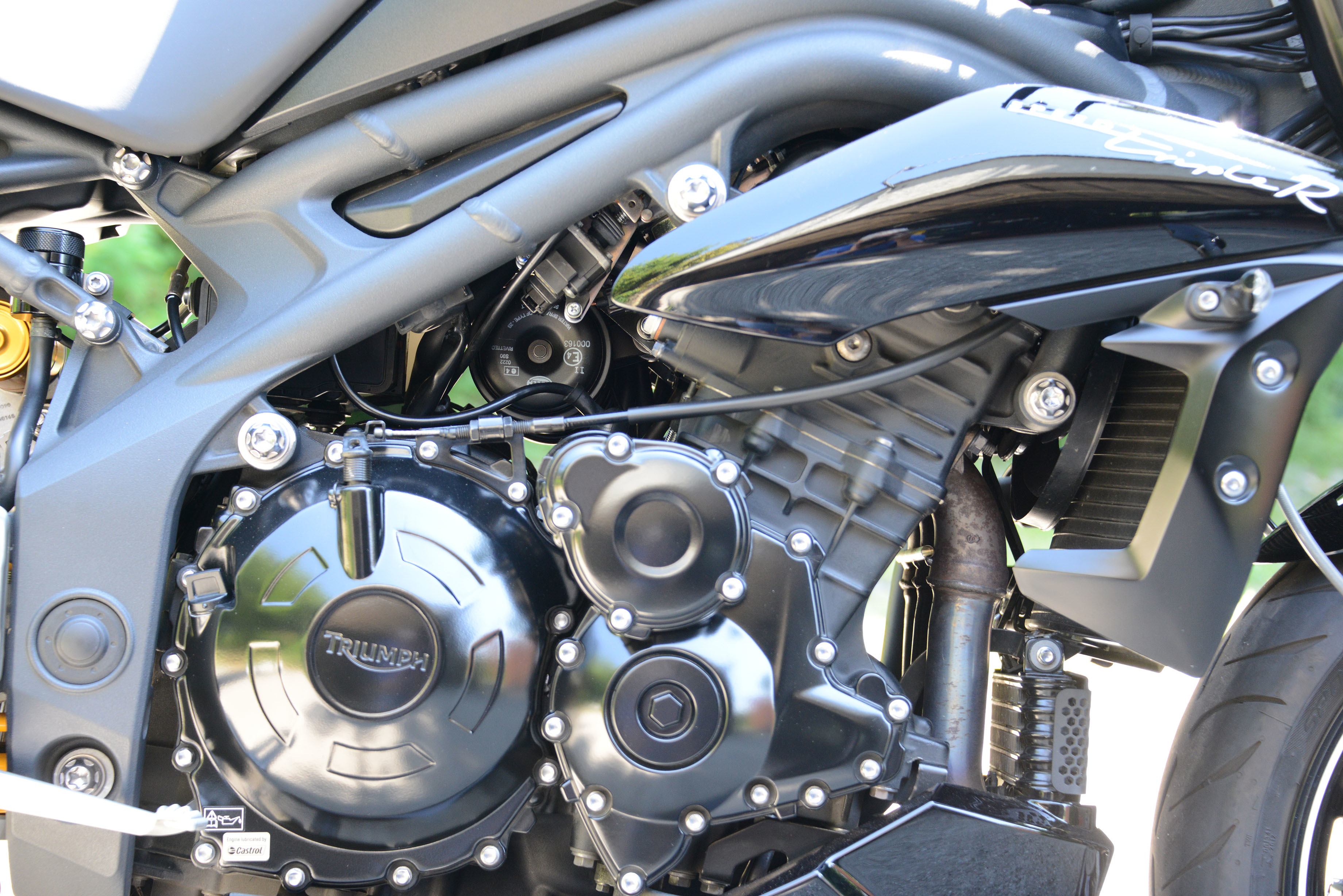

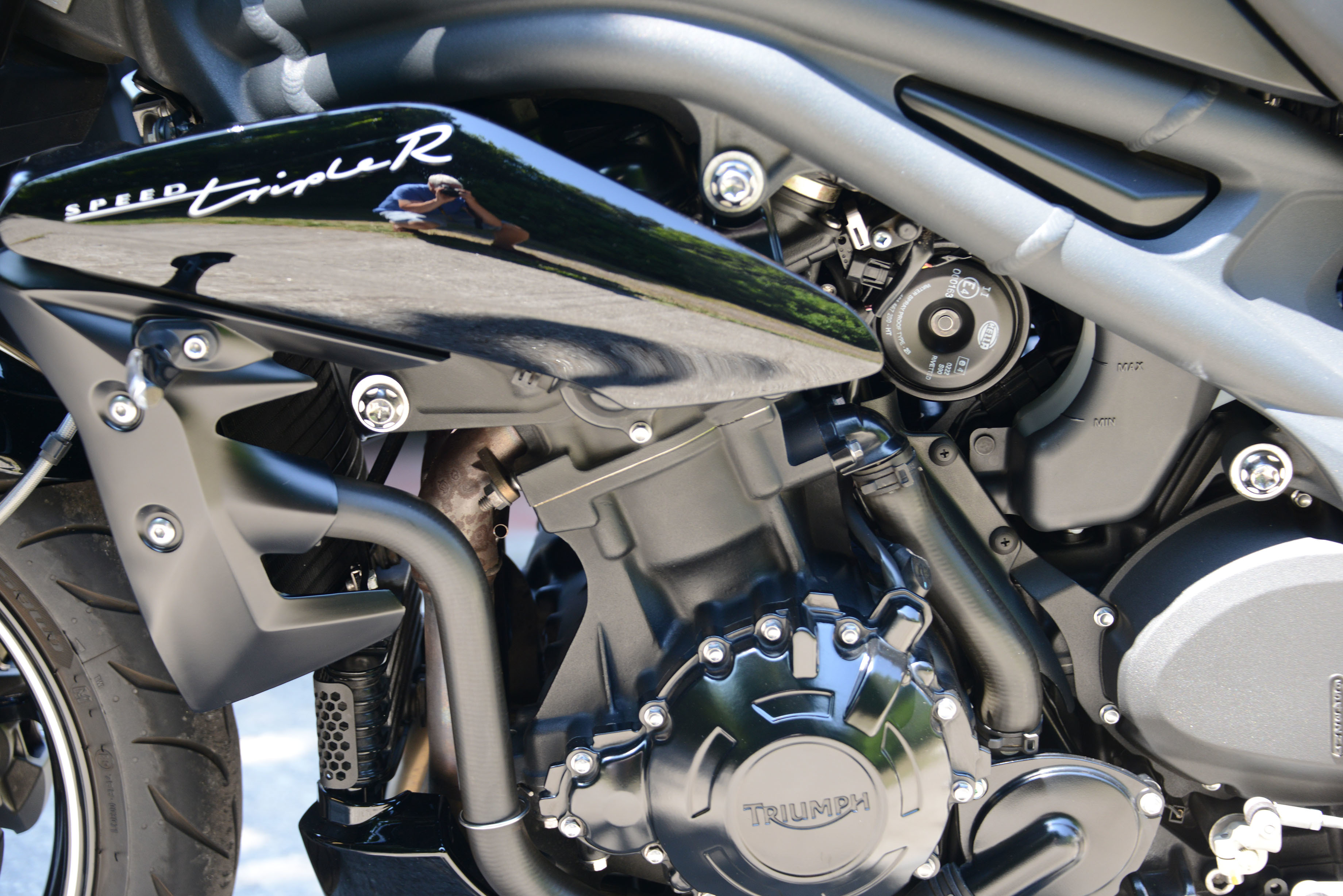

    Another irritation has been the pathetic horn, sounds embarrassing to use and looks just as bad, stuck down next to the oil cooler looking like an afterthought. So that’s gone and I’ve manage to squeeze a pair of car horns in the space behind the engine just below the fuel rail, relay is mounted in the battery box.

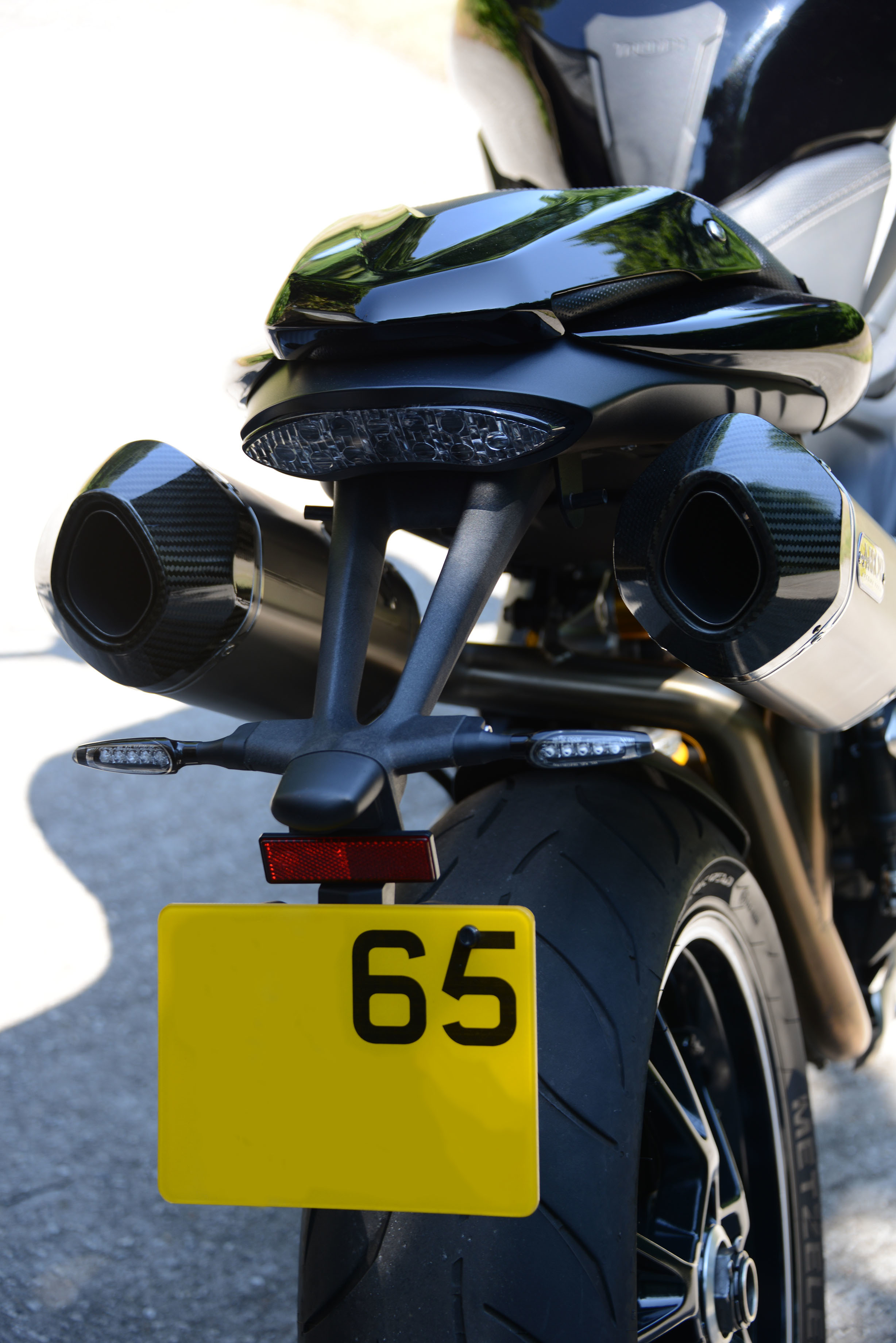

    So finally to the back (it’s gone to the future), the standard metal number plate hanger looks a bit agricultural/dated and I quite liked the newer plastic version fitted to later models (I’m not a fan of so-called tail tidies). Took a bit more work than anticipated but is do-able, only down side is the old one was better at stopping road crud spraying up the rear of the bike.

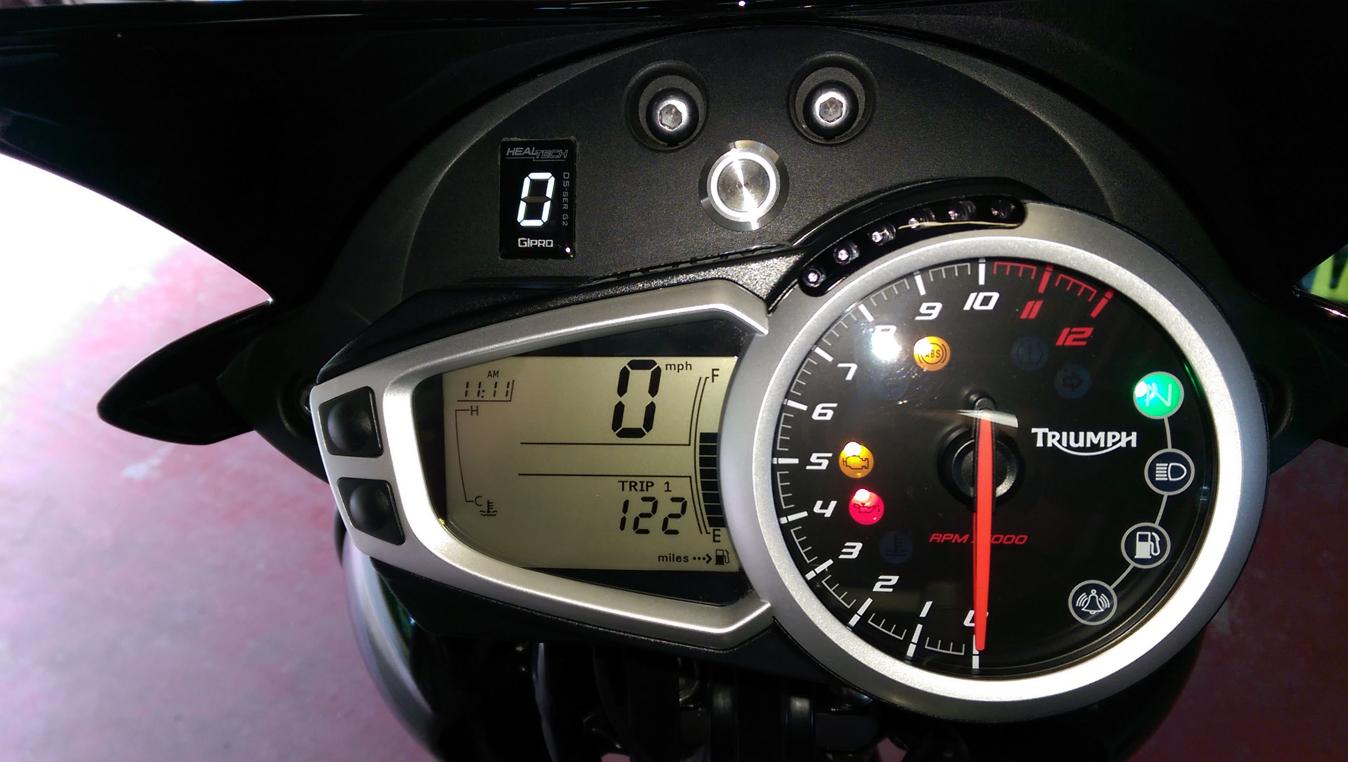

    Latest mod has been the addition of a gear indicator, Healtech have recently added an ABS compatible version that doesn’t require additional sensors (which put me off the idea previously). Only done a few hundred miles since fitting but so far so good, calibration is easy, just compares engine revs to wheel speed. Not as good as a factory fitted indicator (due to the afore mentioned operating limitations) but a fair second best.

    Thats really nice Col! Very nice indeed. Only thing I would say is the number plate hanger, yes it looks fine but I found the tail light gets beat up and becomes rough to the toich because crap from the tyre is able to hit it
  3. Col_C
    Col_C I can't re...Member
    Aug 5, 2015
    651
    Yes heard others comment the same, think I might put some protective film there.
    Should have left the old hanger on, functionally superior. :rolleyes::joy:

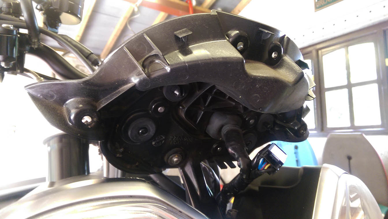

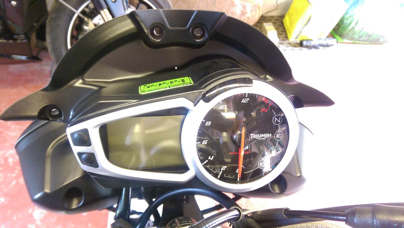

    As a matter of interest, can you let me/us have a bit more information on how you fabbed up and fitted that dash panel infill above the clock set, please? It looks very neat. I've got a Street Triple with a similar clock set and would like to have a similar arrangement for a digital voltmeter and, perhaps, a digital clock?

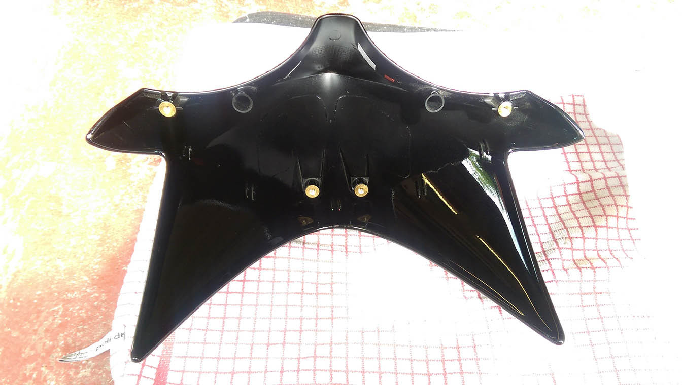

    @Adie P Hi, I spoil you guys, doing your research for you ;)........
    Fortunately the wife has a Street Triple so I understand the relevance of your question (I'm comparing a 2015 Speed with a 2014 Street, so may not be true for other model years).
    I've removed the flyscreen from both and other than colour they are identical.

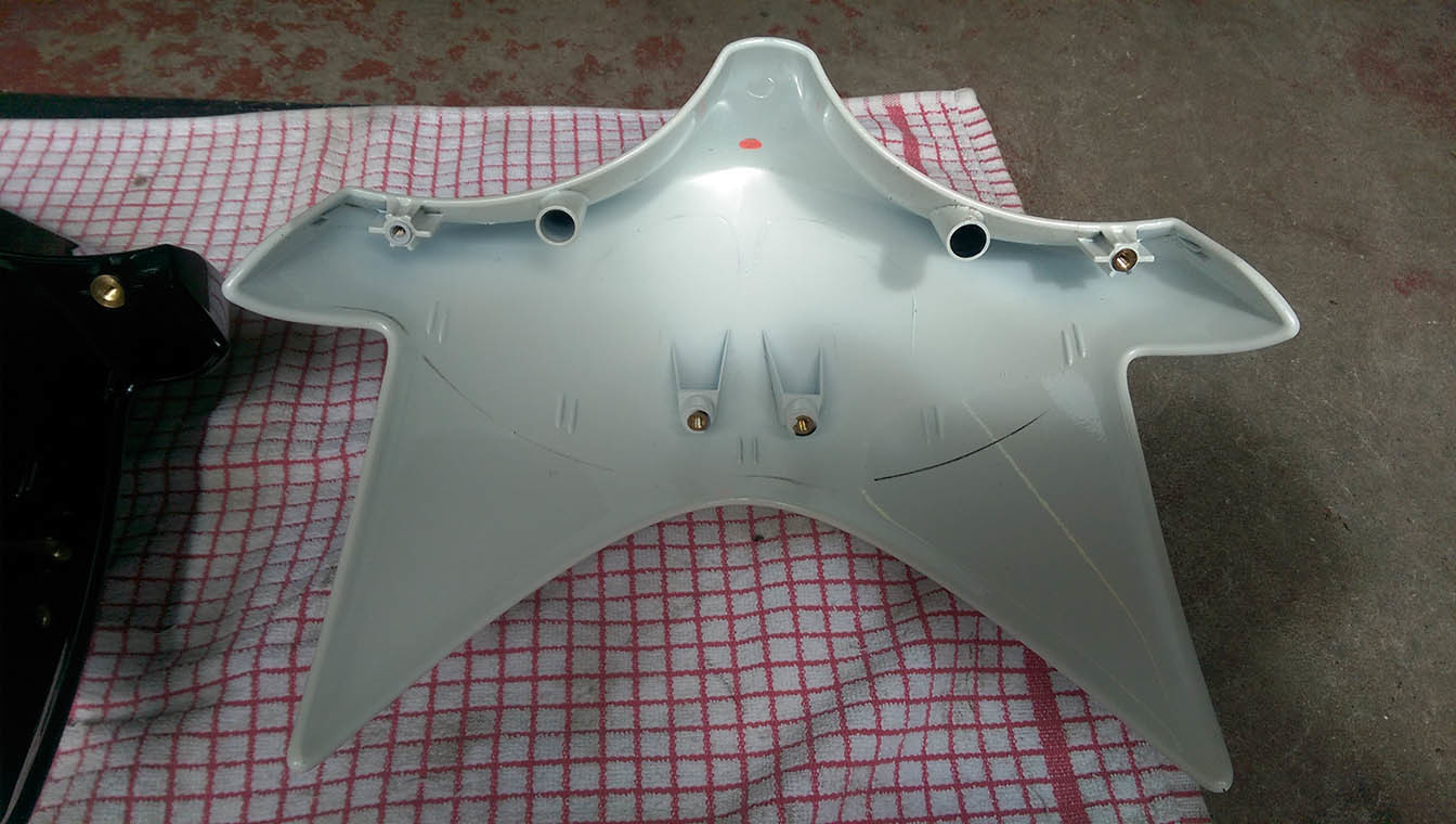

    So the Street has a more sculpted infill panel behind the flyscreen....
    and the Speed is relatively flat (and softer plastic BTW)....
    Fortunately for you the two will be entirely interchangeable, so all you need to do is order the Speed part T2302135 here
    Once you have the flyscreen removed there is a single screw near the bottom to remove, disconnect the instrument panel connector and the instruments can be pulled off the mounting grommets. Under the instrument panel there's then 3 screws holding the infill panel. Swap panels, re-assemble, job done.

    Hi Col. You, Sir, are a scholar and a gentleman. Thank you most kindly for that - looks like it should be interchangeable with my 2010 (and/or the wife's 2009) Street Triple!
