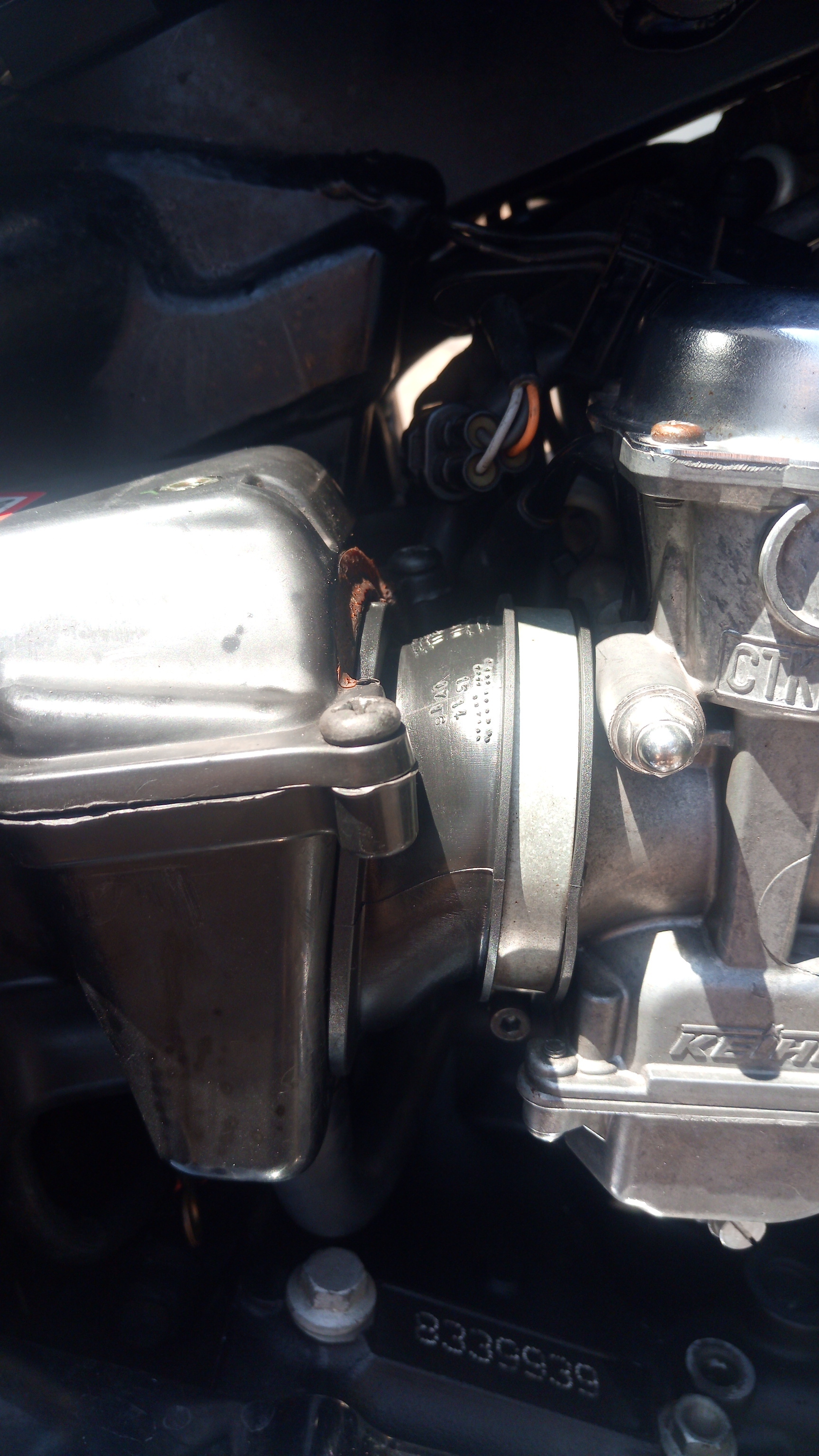

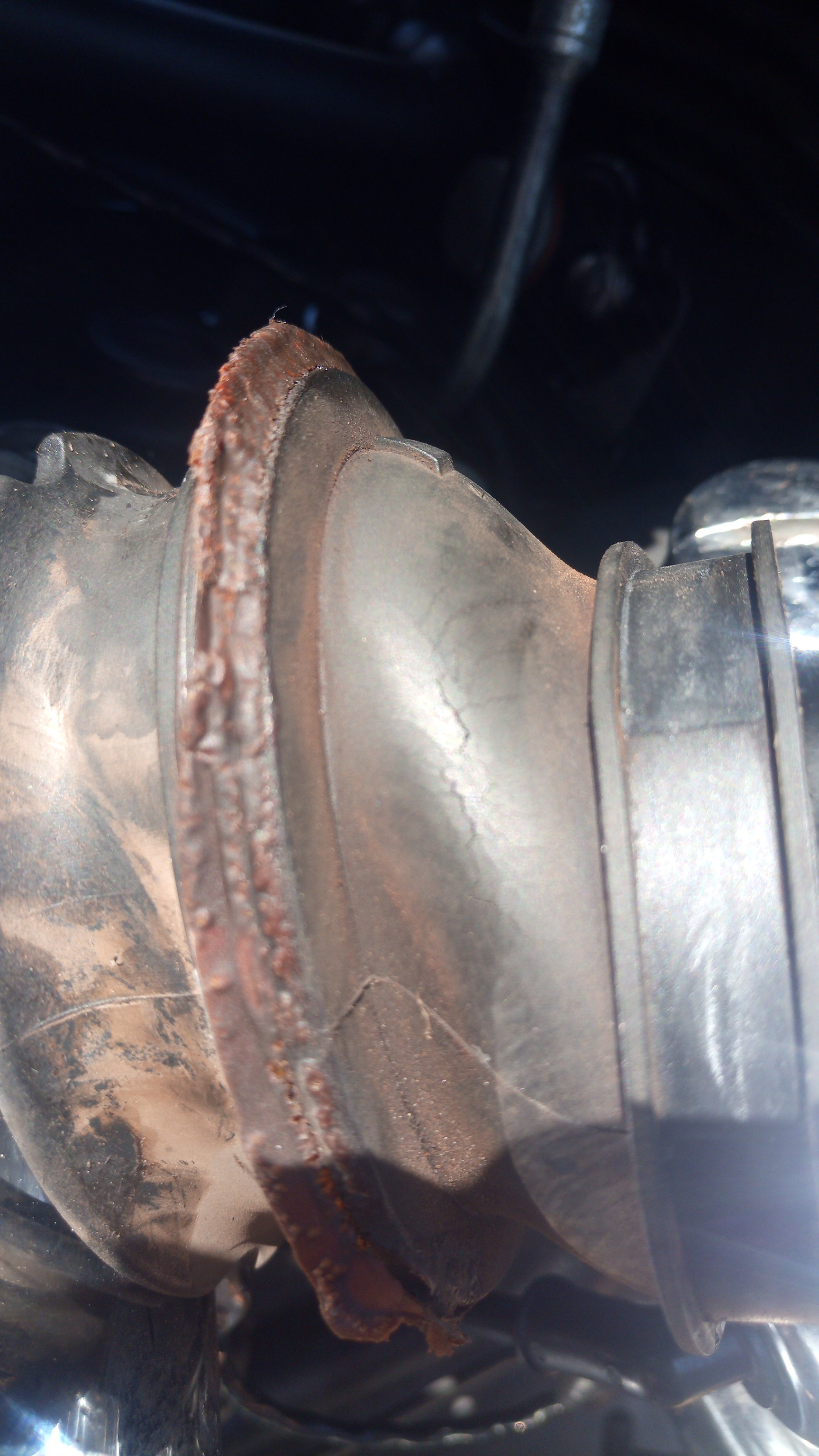

    This morning changed this out
    New one in situ , took about 30 minutes or so , helps if you immerse it in hot water for a few minutes IMG_20200118_104934.jpg
    Pop open top front corner of air box , and then plenty of swearing and cursing Voila !! :)

    Always a pain to do carb rubbers. A little red grease helps aswell as the heat :)

    The problem is , the rubber inlet tract is nearly twice the length of the gap between air filter box and throttle body.
    I pushed the tube into the air box , then jiggled it back out until the mouth of the rubber tube was nearly on to throttle body mouth. Then forced a screw drive into the air box side , worked it back and forth until fully on throttle body. Then the really hard part ! Levering back and forth inside air box , working the flange over the lip of the opening in the air box ... ! All whilst keeping the front right hand corner wedged as wide open as possible , to give room for long skinny screw driver to work around the tube !
    Rubber grease might have made it harder to do ! As the force I was using with grease involved would have made the tube slip too much when I was trying to get the lip on the air box side to seat !
    The easiest way to do it , is the longest . Air box out , which would mean carburetors/throttle bodies Off , which would involve , splitting the frame and partially dropping the motor out or similar !

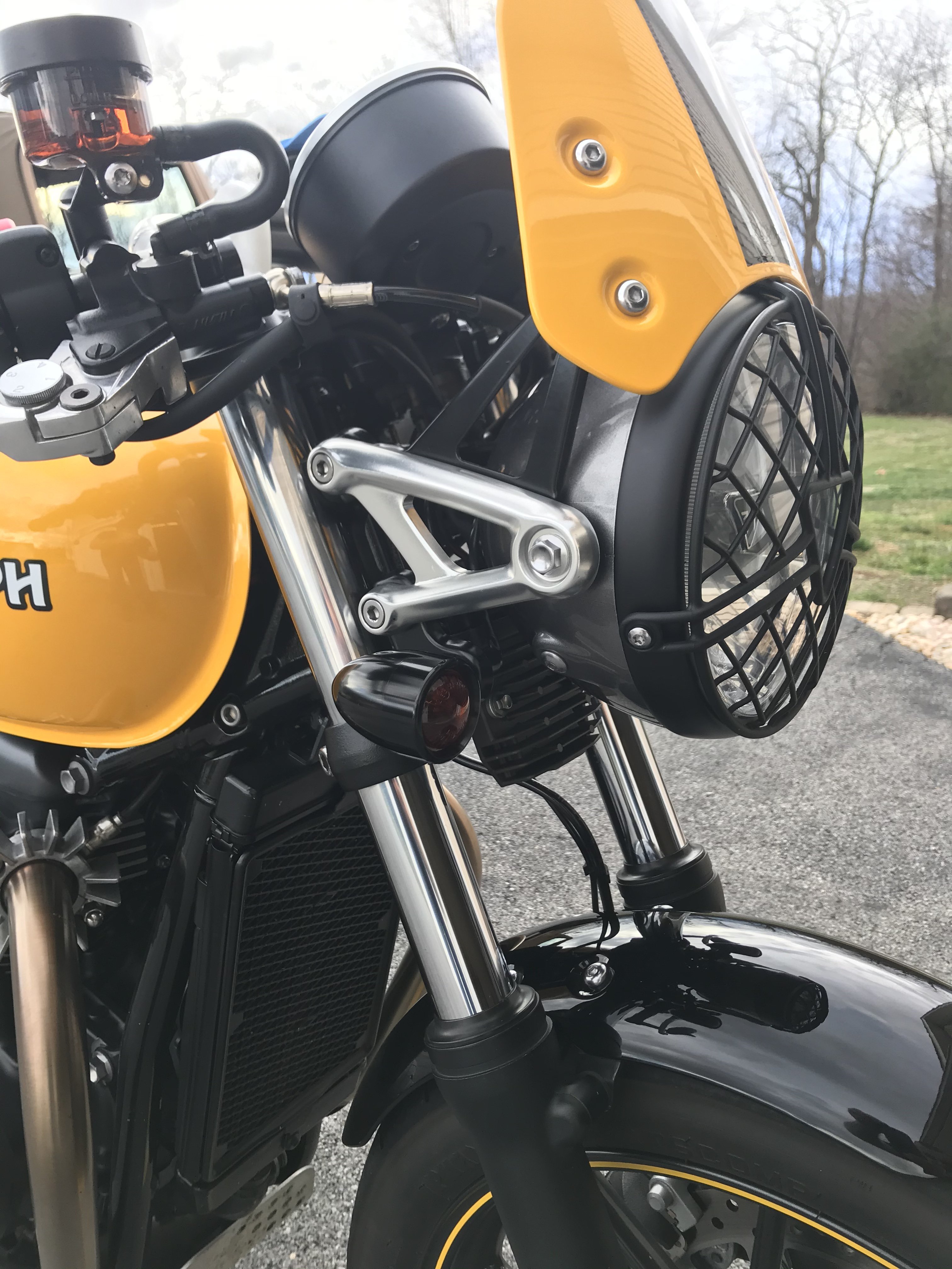

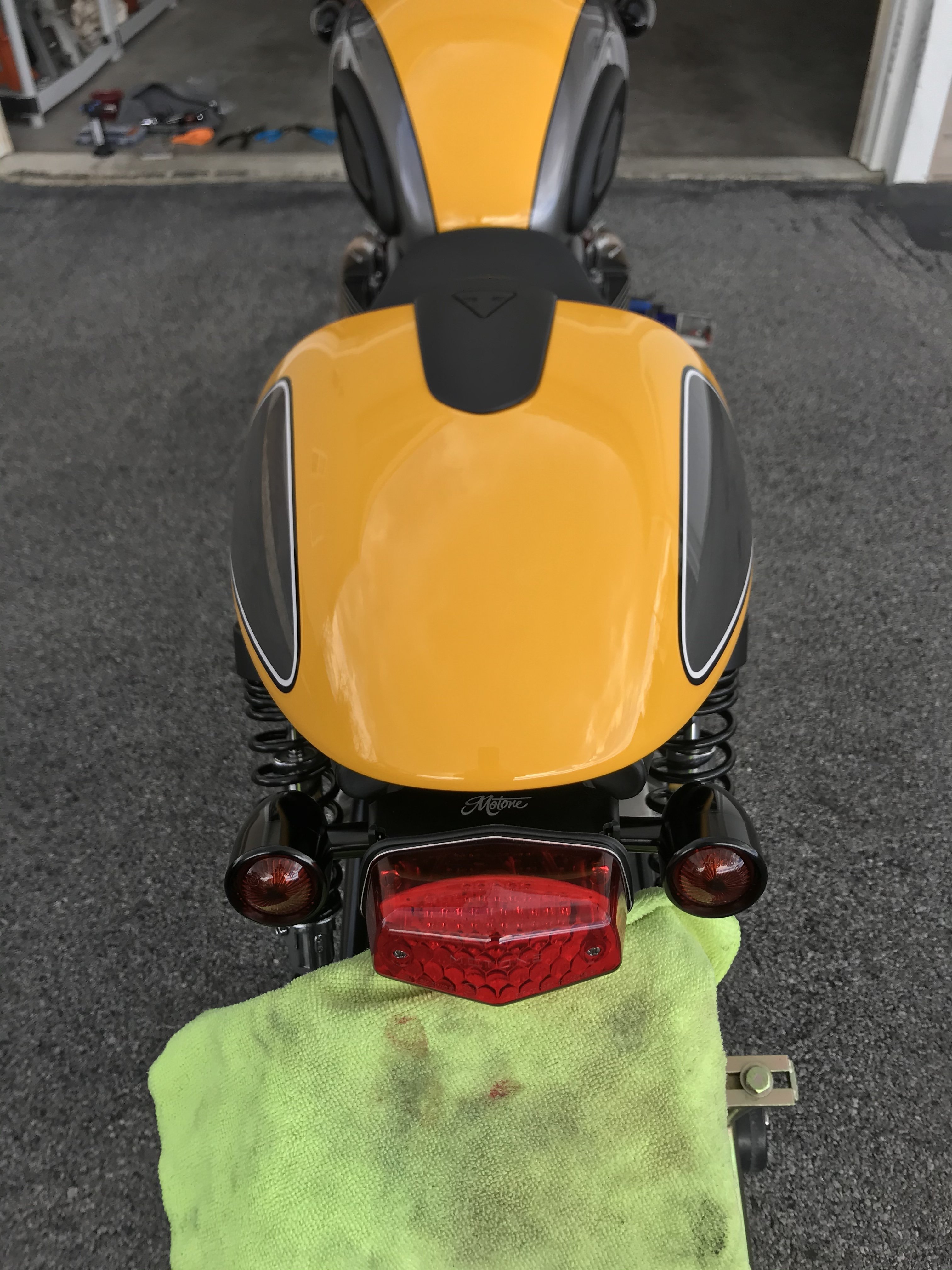

    Finished installing a set of Motone indicators on my Street Cup. Full write up in Builds and Projects.
    • Like Like x 15

    An improvement over the originals. I've got the same. Looks like you've got their tail light, so you've probably got their tail-tidy. Good quality stuff.

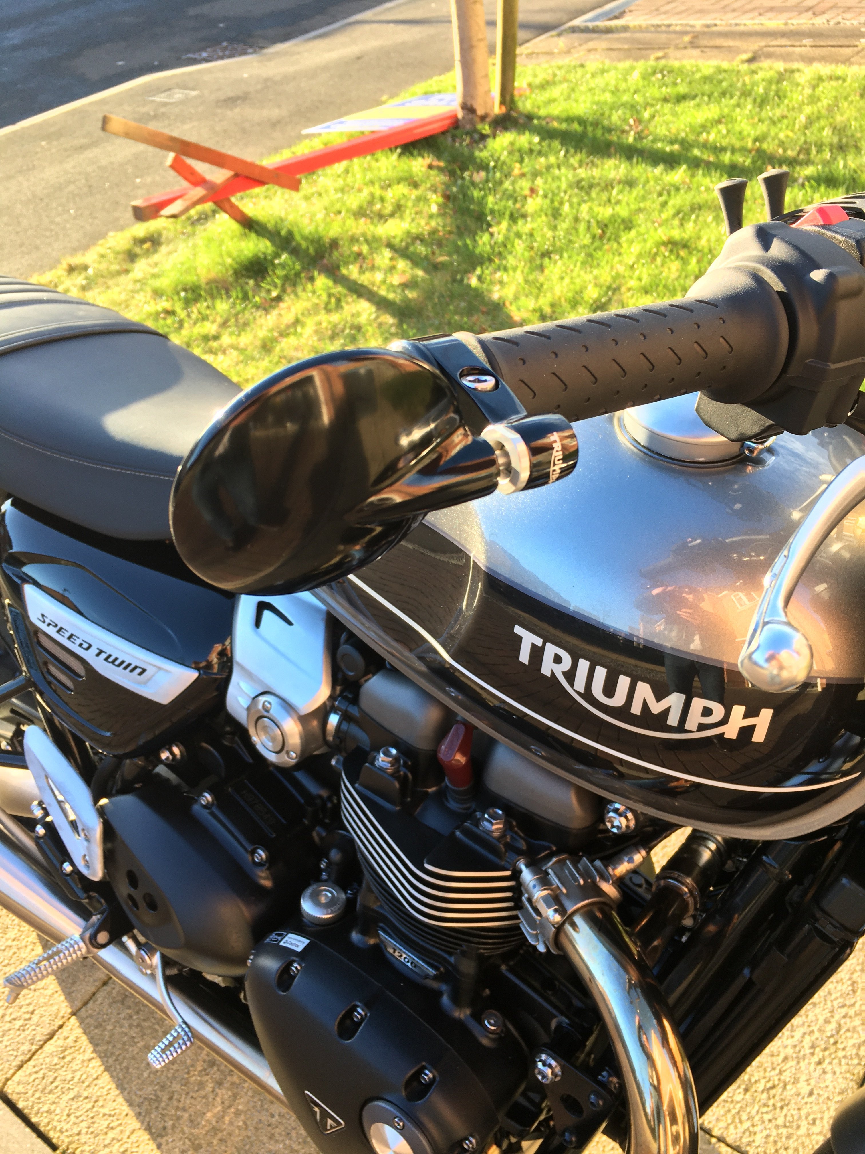

    Carl556 Senior Member
    Nov 13, 2019
    271
    Durham Uk

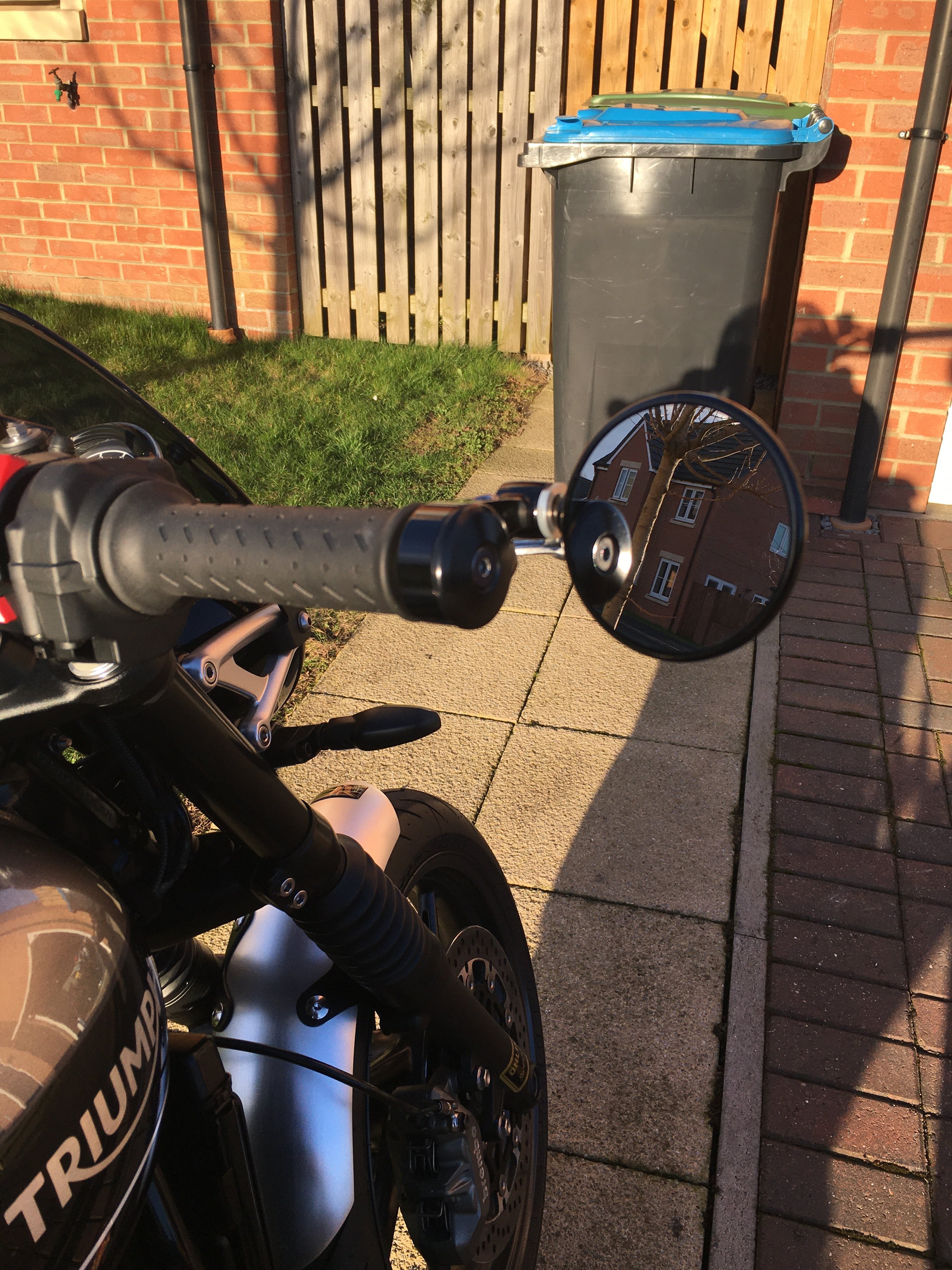

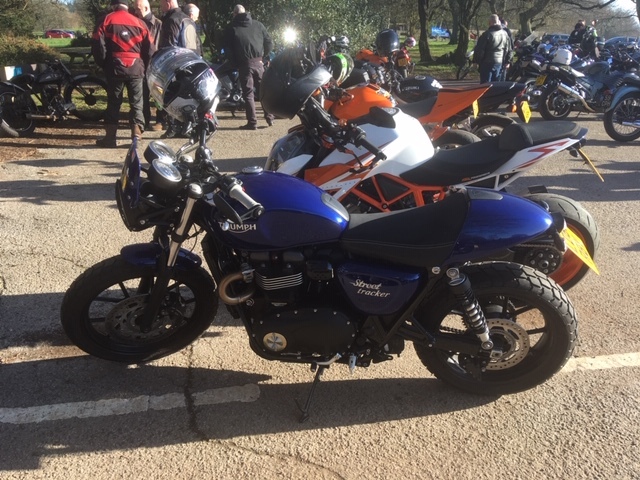

    Just fitted Triumph “peep” mirrors to my speed twin. I like them better than stock and can actually see quite well out of them!
    • Like Like x 12

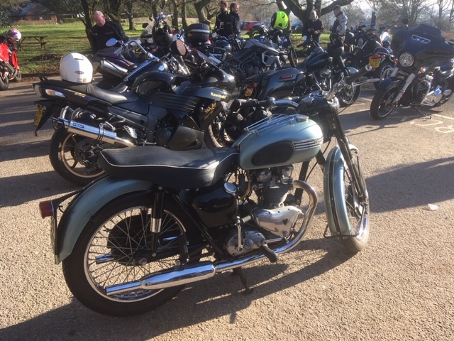

    Took Tracey out today went up to newlands to start off, quite busy. Then took to the Surrey a and B roads, some places it felt a bit more like off-roading there was so much mud and crap!
    sorry for the shadows.
    Not seen one of these for a while
    Then you see 2
    • Like Like x 14

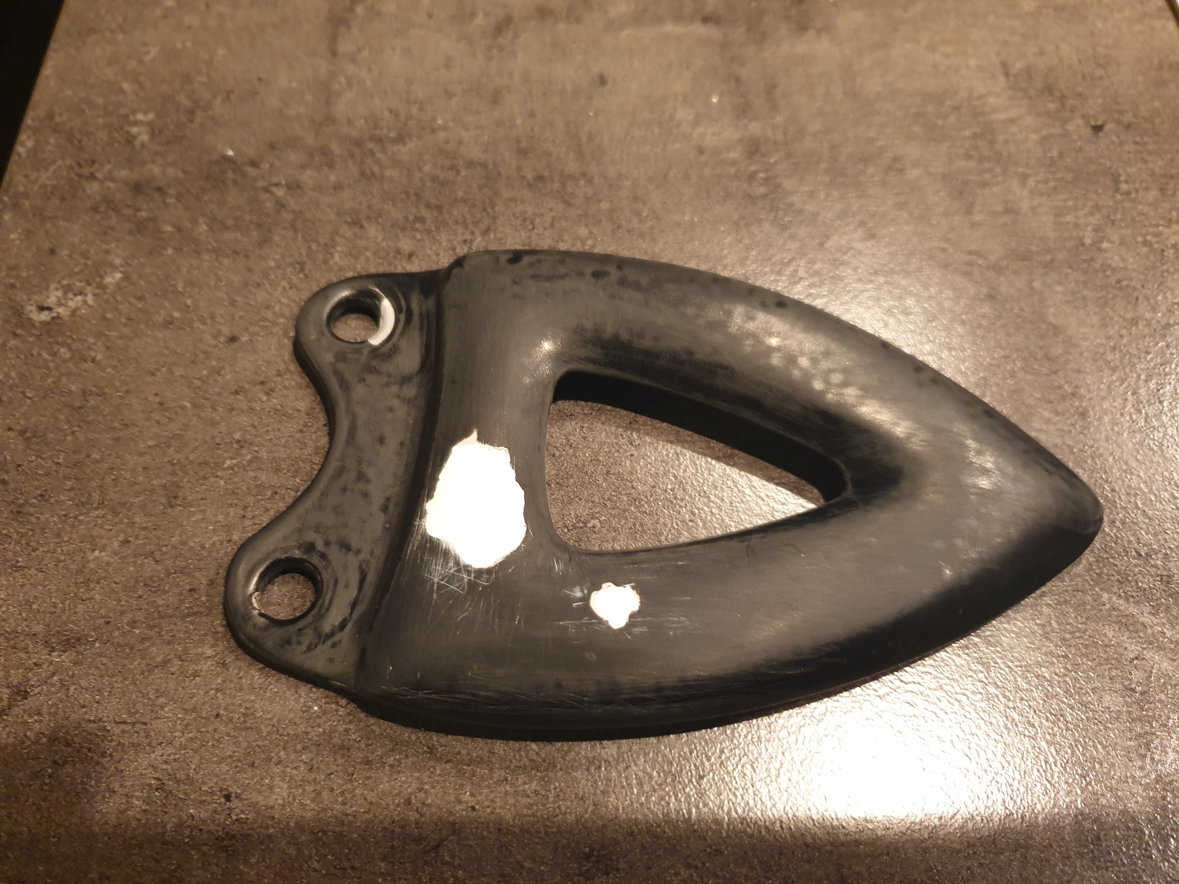

    19,640

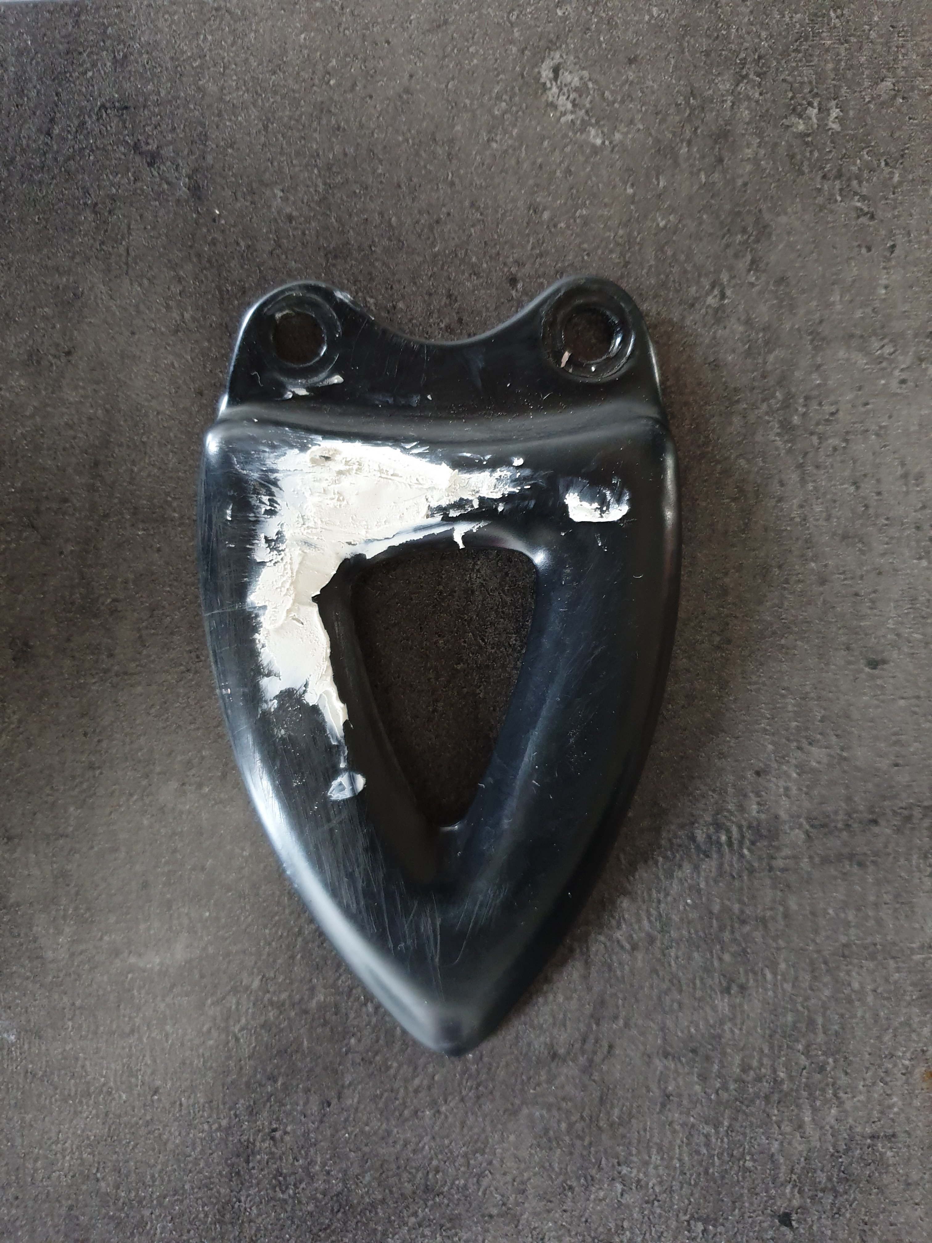

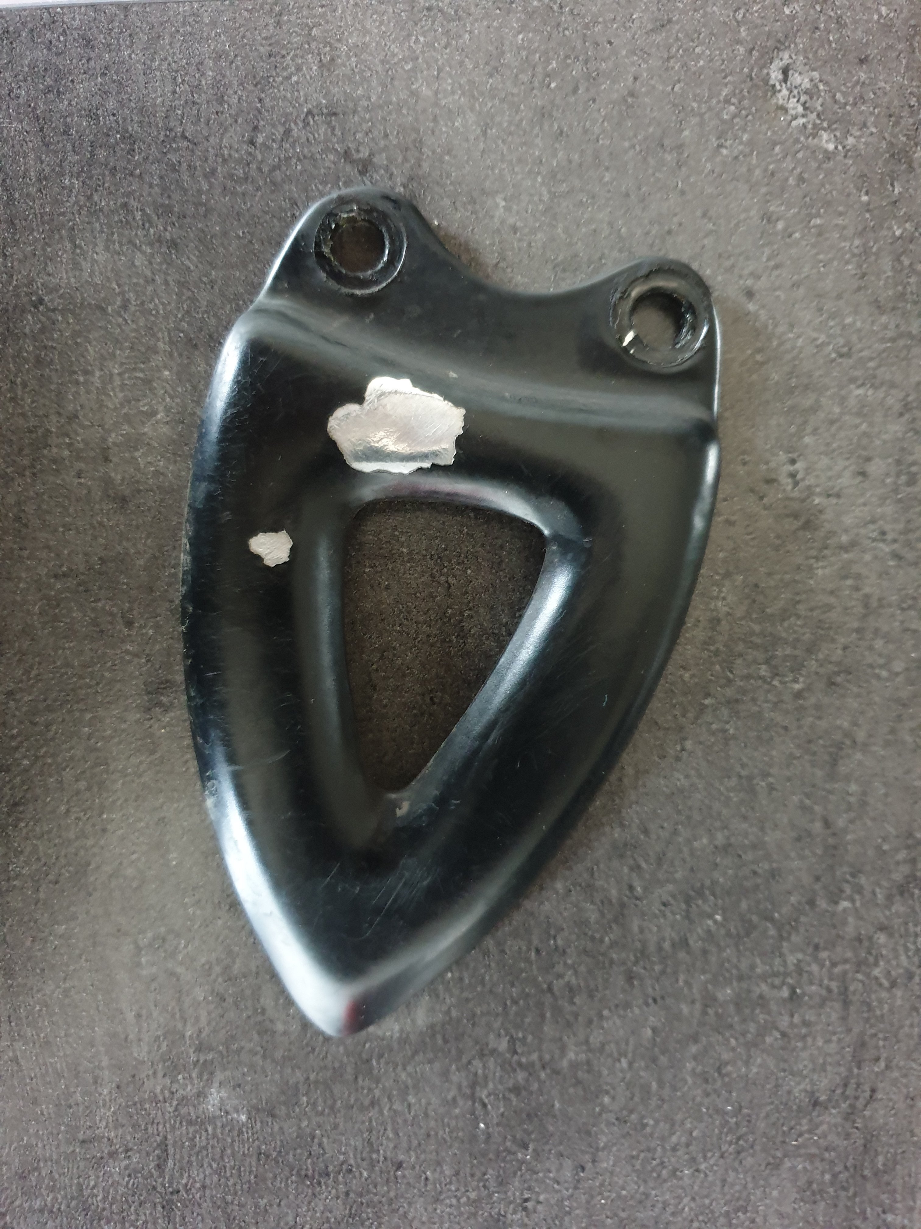

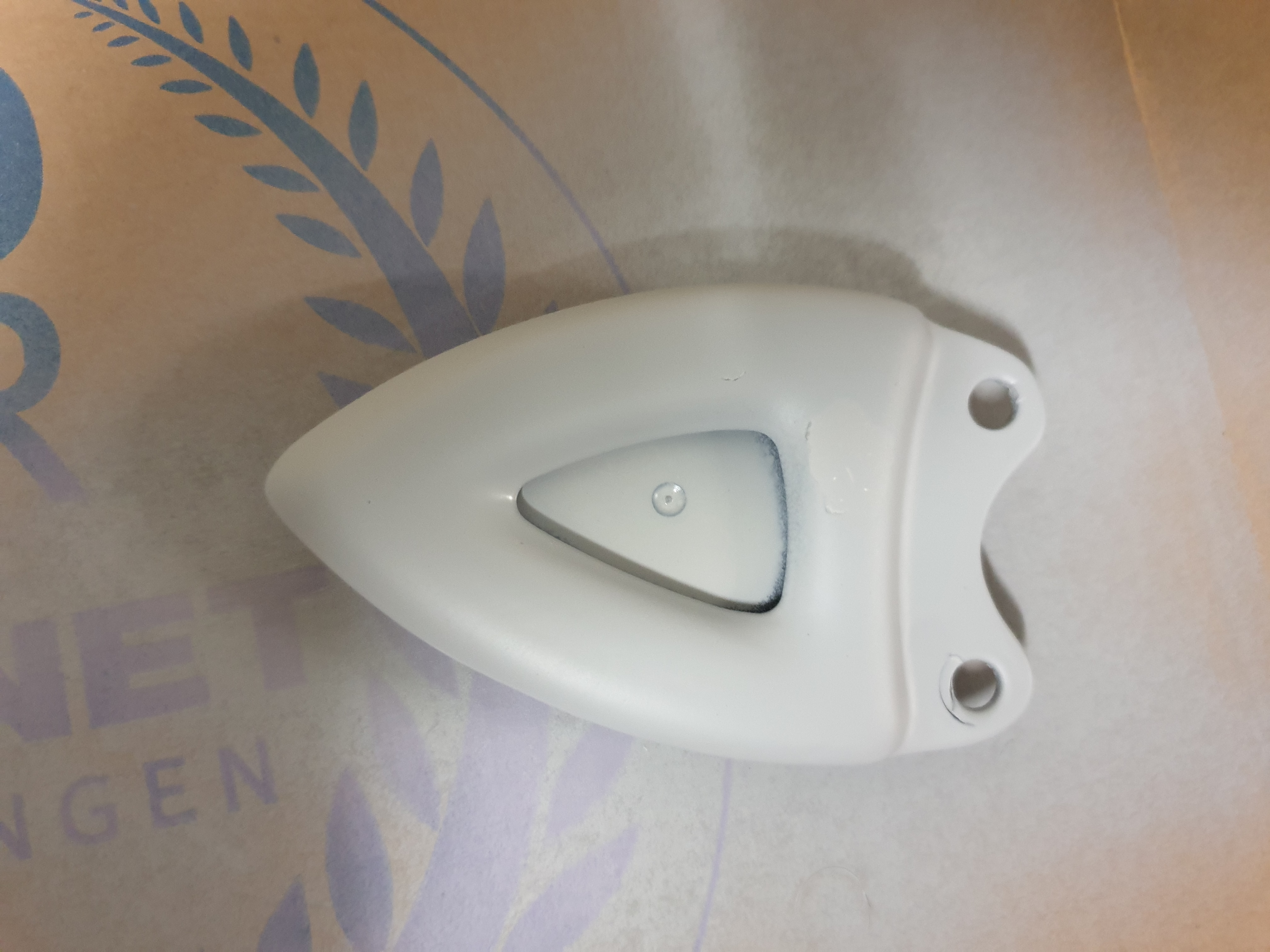

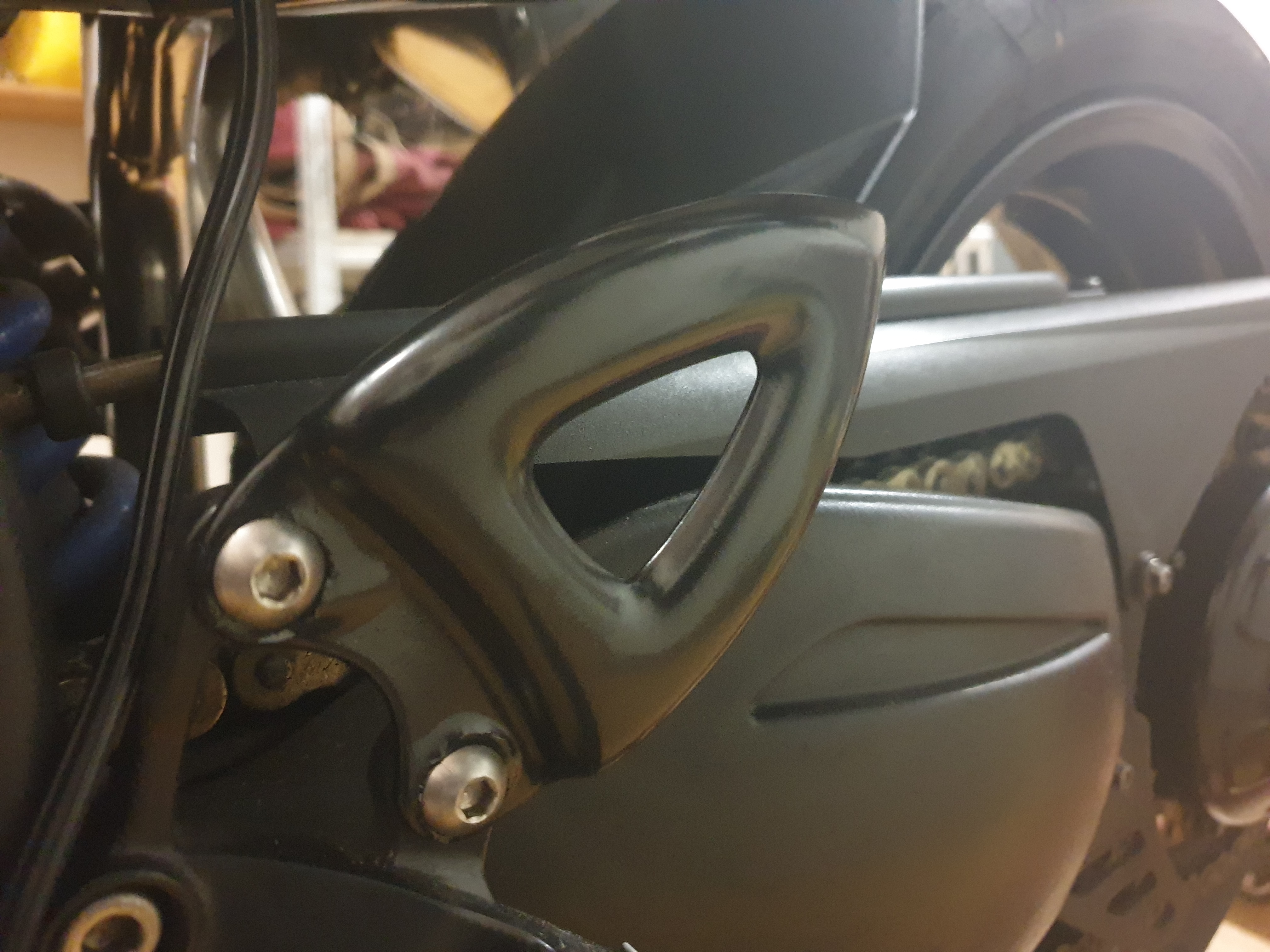

    My left hand heelguard was chipped and it annoyed me...
    So sorted that...
    20200107_145319.jpg 20200107_184742.jpg 20200110_172027.jpg 20200119_215744.jpg

    Cheers James! Rattle can job, but happy with it!
