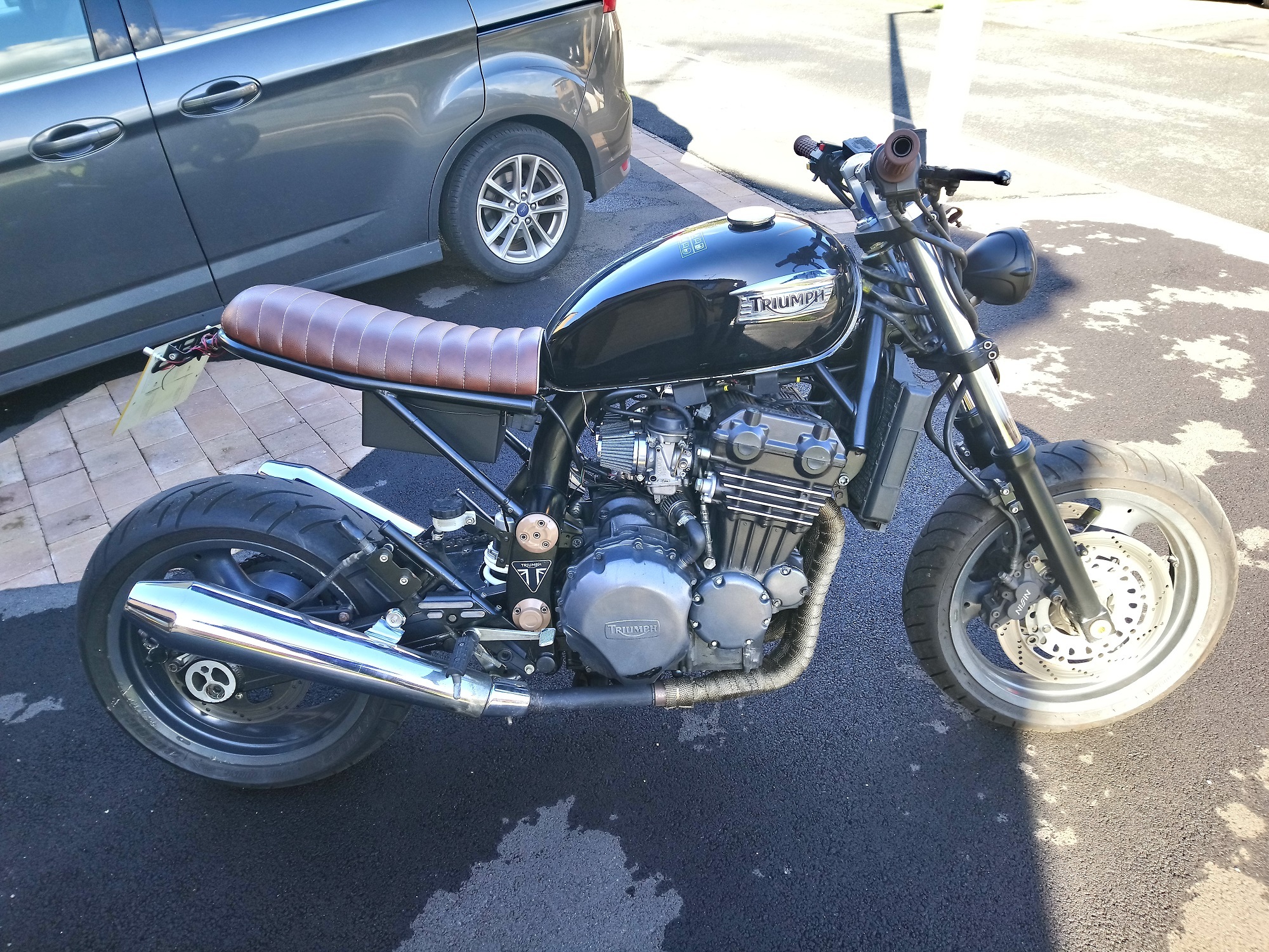

    I'm not sure about the bag either, I was wondering what to do with the battery and electrics when I saw Daryl Dixon's new bike on the Walking Dead built by Classified Moto. It had a similar bag and I thought I'd try it. It actually covers a 4mm aluminium box containing the majority of the electrickery and the lithium battery. I may have a new Ali box fabricated and powder coated satin black at some point.
    The new air filters have arrived and I noticed they also come with new 135 jets which I was not expecting. Once the crankcase breather filter arrives it will be off to Retrotune for the set up and Dyno runs. Then I will be looking at new dash, tyres and upside down forks over next winter.

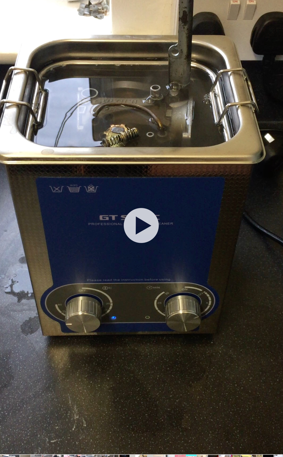

    Yes these are the jets I used, easy to drop in, but a this point having the carbs out I stripped and gave then an ultosonic clean
    Remember though my bike had been polished more then any mechanical work so I didn’t know the state they were in and the bike was running rough with hesitation

    Hi everyone! well after a summer of travelling i am back to the build. Quite a lot has happened since my last post and there has been ups and downs but finally the Triumph is running well. I wanted to get it on the dyno sooner but the clutch basket fell to bits and the tps sensor decided to play up, all fixed now. So after that, it finally went to the shop for set up.

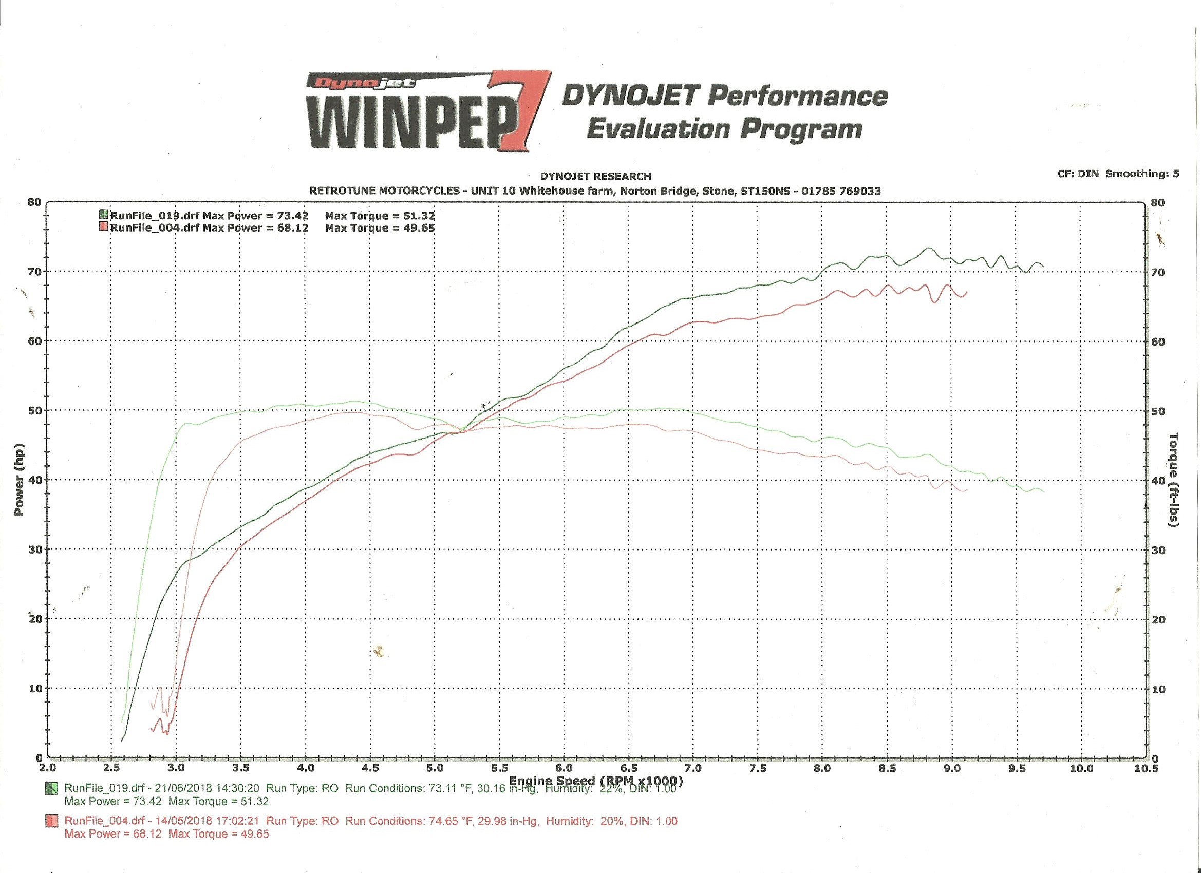

    The carbs were ultrasonically cleaned, all seals replaced, a dynojet kit fitted, then many dyno runs. The brief was to go for smoothness through the rev range instead of power which is what i got.
    The bike produces over 73hp at 51 ftlb of torque. The acceleration is smooth going a little fluffy right at the top end. Through the mid range it pulls really well which is where it will spend most of its time.
    The bike is almost ready for MOT, just waiting for the KOSO dash to arrive. Following the MOT there will hopefully be the following done.
    Powder coat wheels and engine cases in black
    Fit Continental Twinduro tyes
    Decide what to do with battery, igniter etc currently residing in aluminium box beneath the seat, (any ideas gratefully received)
    Couple of pics of the bike currently.
    Ta ta!
