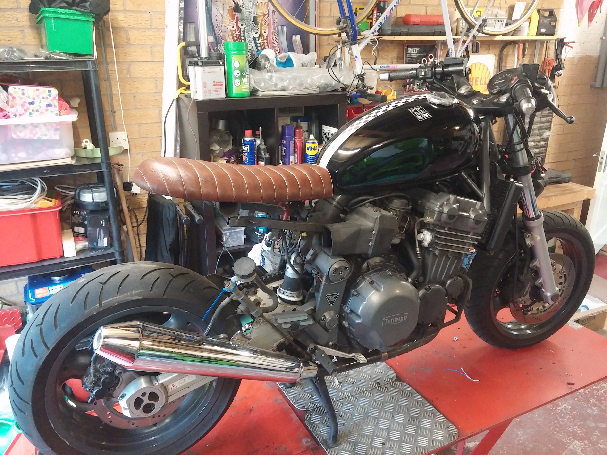

    Well i had to tell of my good fortune, as I said I was unable to get a tank for my special so on the off chance and while I was working in the area, I popped into my local Triumph dealer. While chatting, I happened to mention that I was looking for a classic style tank. The guy said he would go and see if he had anything and a few minutes later came out with a Thruxton special edition tank, as soon as I saw it I knew I would be walking out with it. So a little haggling later I was the proud owner of an unused Thruxton tank for the price of £300 and a new Chrome fuel cap thrown in. Result!
    And here it is.
    I also managed to obtain a set of Thruxton exhausts mint unused for the princely sum of £50. The bike is now with Made In Metal bike builders having the new subframe fabricated and exhaust mod to allow the new exhausts to be fitted to the original downpipes and not fowl the swingarm.
    Before it went I couldn't resist a little mock up to get a flavour of the finished bike, when its back it will be dry build time before full strip down when the work can really begin. Hopefully it will be back about the time of the Stafford mechanics show in October.

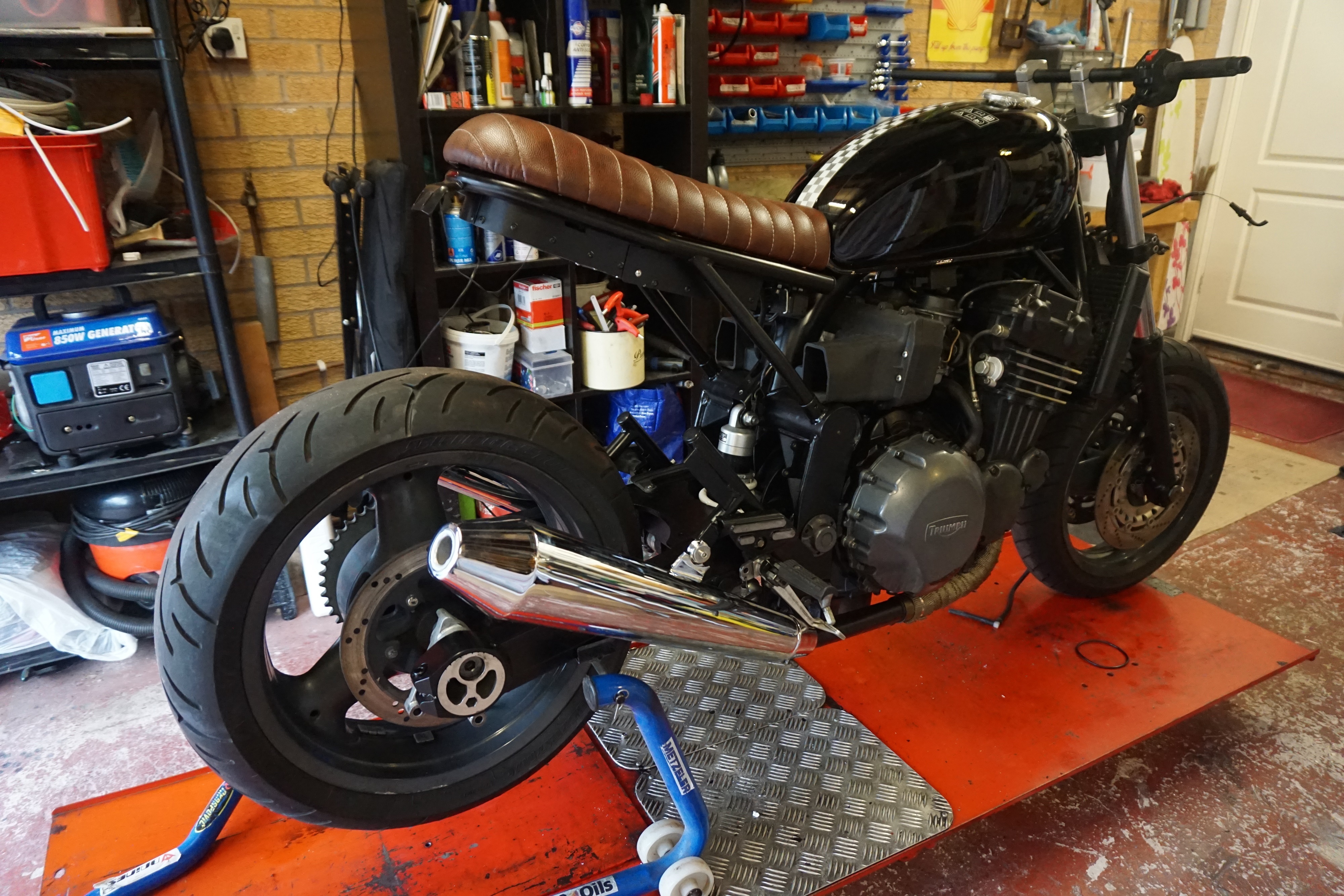

    Well the Trophy is back from made in Metal sporting its new rear subframe. They did a great job and the whole subframe can be unbolted and removed. They also split and re- welded the downpipes so that the end cans clear the swingarm. Next job is to fabricate exhaust brackets as I don't think the zip tie look will catch on.

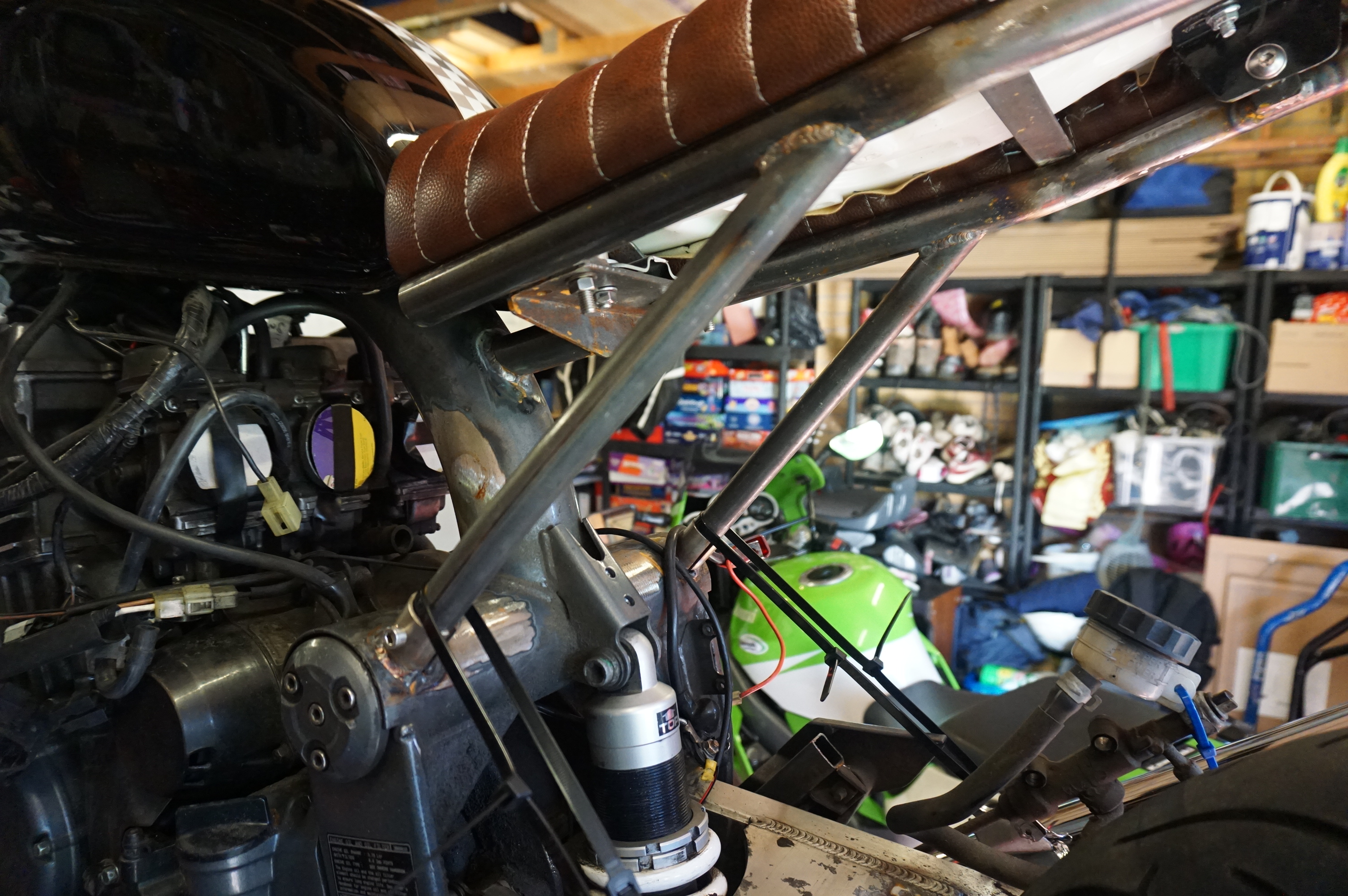

    Well i now have the plastic to try thermoforming 2 separate seat undertrays to house the electrics. I will use a lithium battery laid on its side under the seat. This means the battery tray will sit 30mm below the subframe tube lower edge. Just hope i don't make a mess of the oven or may be in trouble.

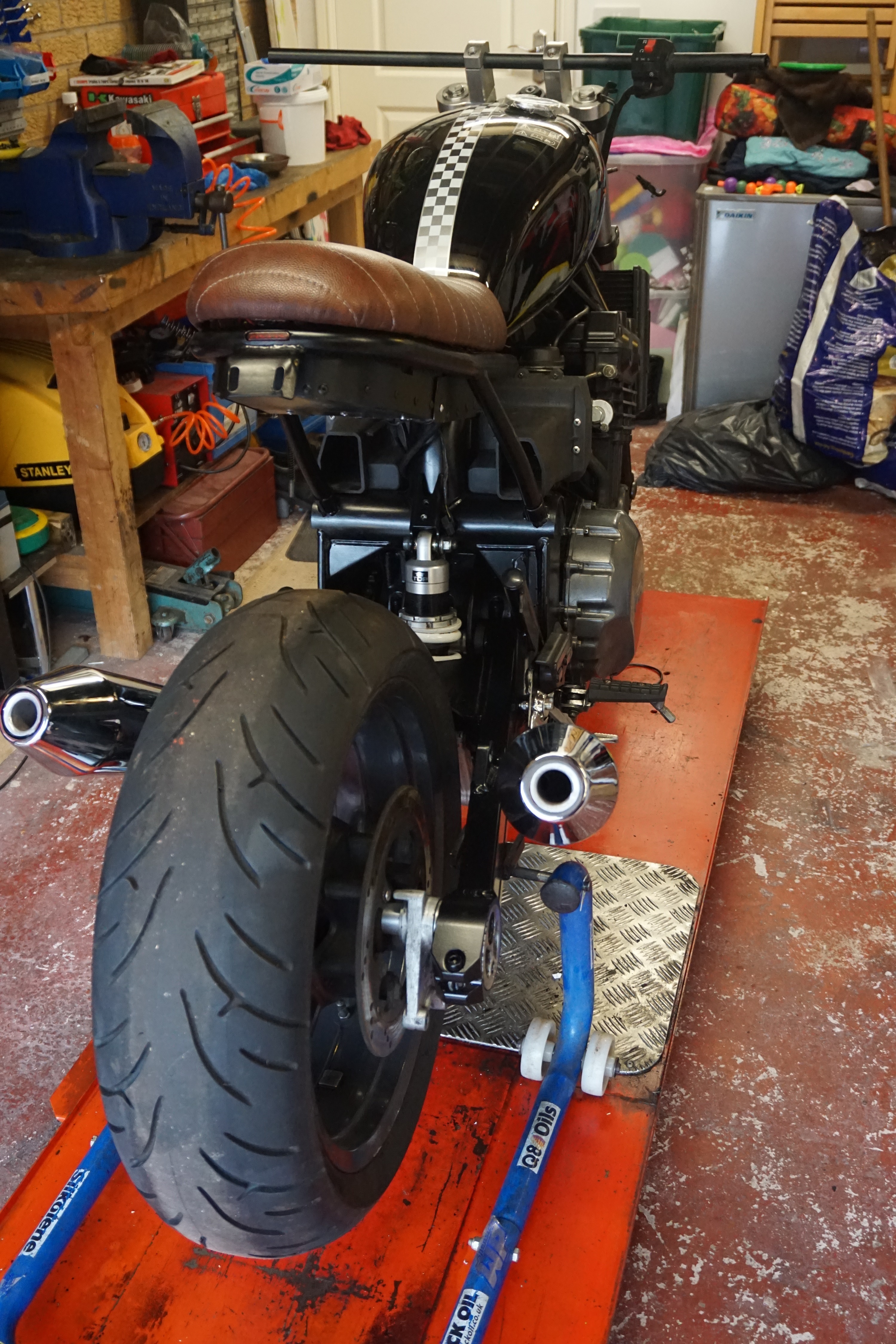

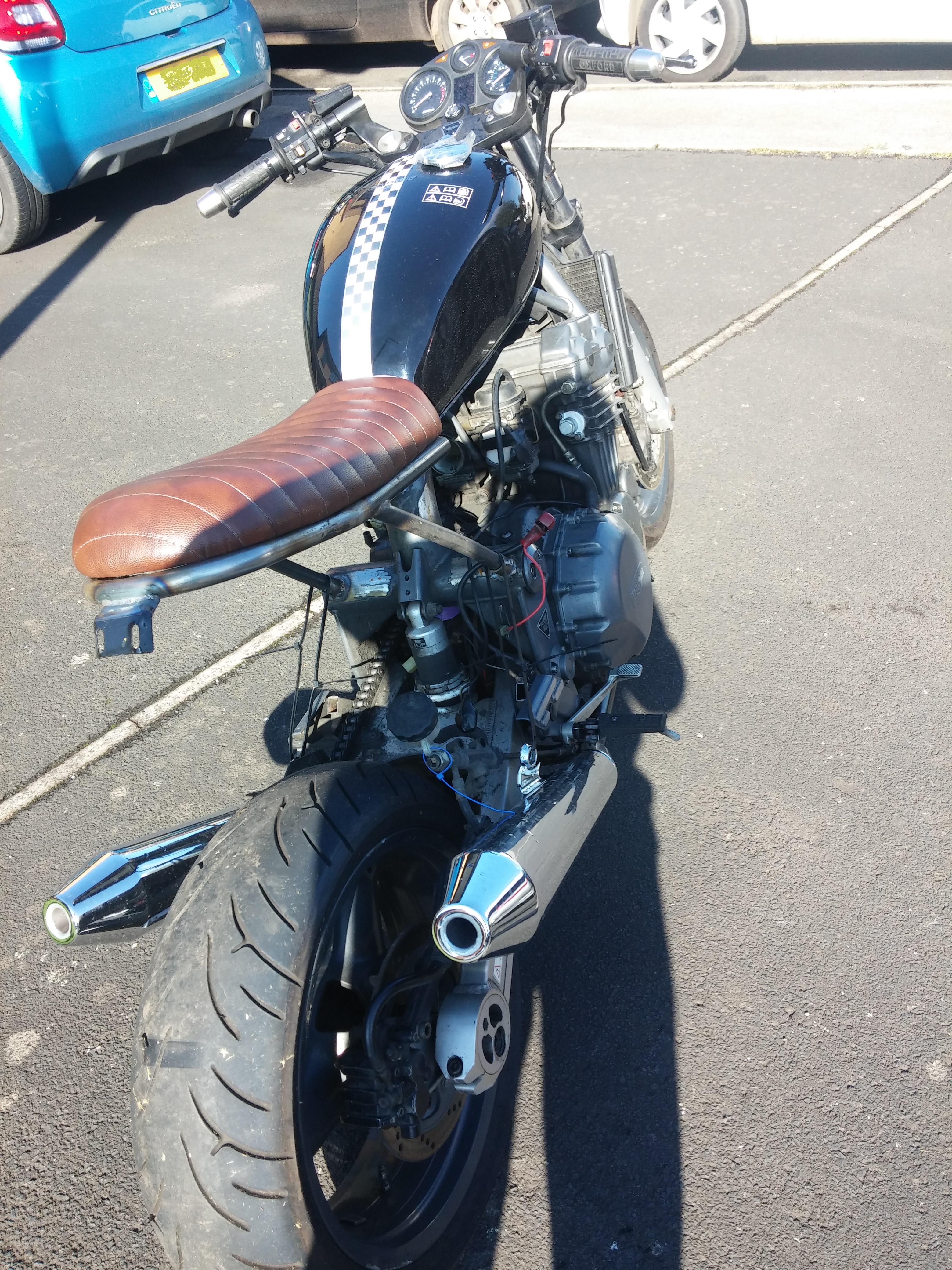

    Hi, I have not posted for ages but just wanted to show how far I got with the Trophy Brat. Things have been going well but have completed things when funds allow. If I had Jeremy Corbins money tree it would be on the road by now!
    Anyway there is around half a days work to get the bike running, then it's fitting the brakes.
    I fitted the original airbox for now as I wanted to see the effect that the loss of secondary airbox mixed with the Thruxton silencers would do. I will fit K&Ns then off to the dyno for set up.
    There is still lots to do. When the bike is MOT'd I will look to change the tyres and at the same time get the wheels and engine cases powder coated. Fingers crossed she runs.
