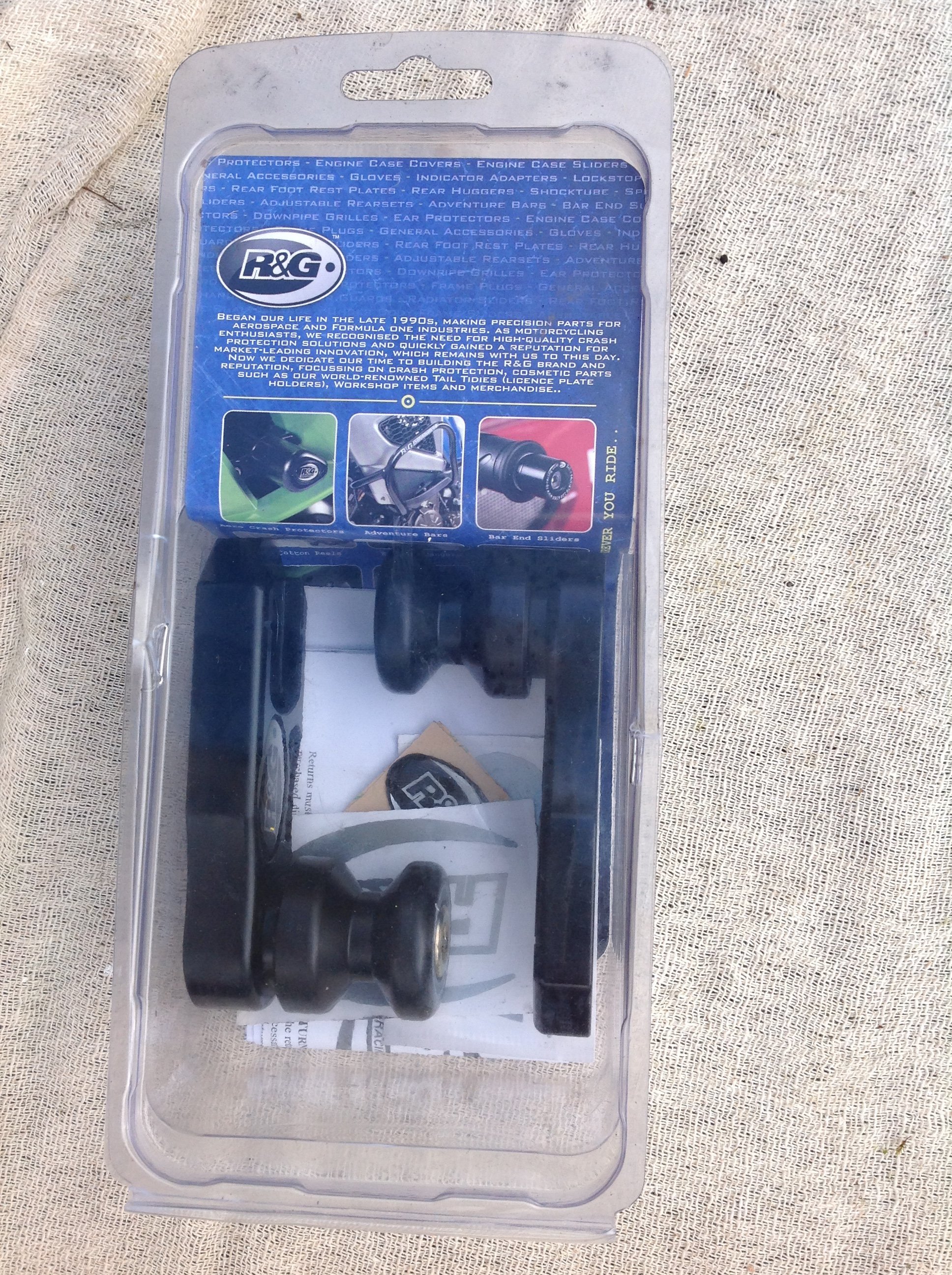

    Hi Robert I wouldn't advocate doing that if I were you, there are a number of reasons it could go horribly wrong, the bar could spin on the jacks, this would potentially cause the machine to fall over. Has the bike not got paddock stand bobbins, if it has I would purchase a rear paddock stand (it need not be expensive), it will be a good investment going forward, for example chain maintainance and adjustments. If you are working to a budget I can let you have a set of R&G extended rear bobbins for £10 plus postage, these are a lot dearer (check out the R&G website). I have put a picture of these on for you to look at. You can complete the job of re greasing the rear suspension on the side stand at a push, however I personally always like a more stable platform when I'm working on bike or car.
