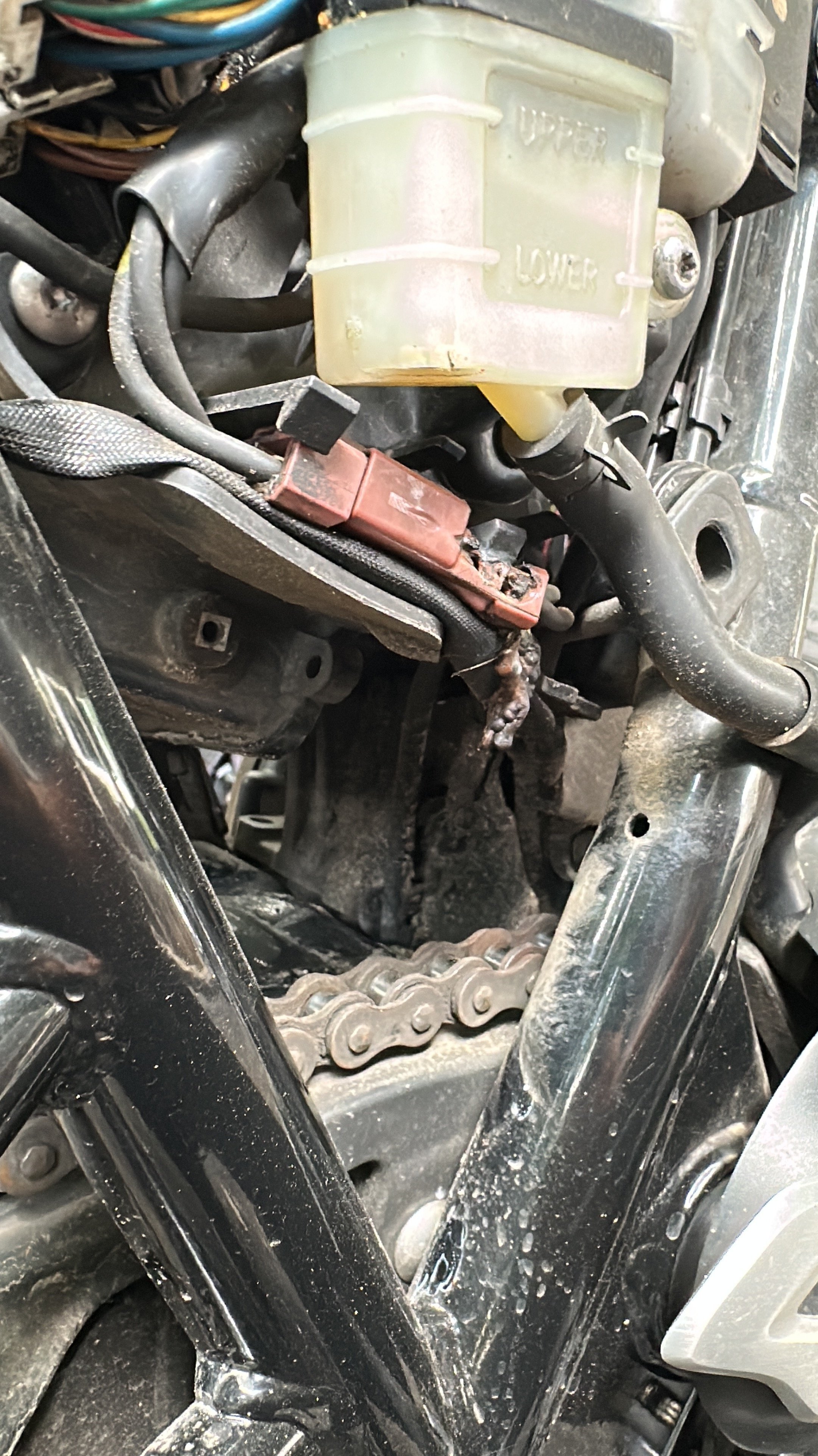

  8. Alvin
    Alvin New Member
    Nov 27, 2025
    Indonesia
    I have an issue with my alternator socket. It burned while i was riding it. Do you guys have the same issue?
  9. Regit nogara
    Regit nogara Active Member
    Apr 22, 2025
    North, North Wales
    Not had issues like that. Water ingress maybe???
    Your chain looks very dry.
    Tony

    Just got a Safety Recall letter SRAN641 3/18/26 from Triumph for my 2023 Bonneville T120 Black.
    It indicates that even if the Wire Alignment Clip from SRAN627 is done (which I did), that the repair in SRAN641 still needs to be done else what Alvin above showed occurs.
    The letter states:
    'Triumph Motorcycle Dealers will replace the current 2 piece connector body with a single in-line crimped solution for each of the three alternator assembly wires; about 20 minutes.'
    Installing the clip was easy; this fix is something I would let the dealer do.
    Makes you wonder what other functions the connector block has; so the clip doesn't solve the problem??

    OK, guys here it is:
    I have a subscription to the Triumph Technical Information website. The following is a link to TTIs instructions to the dealer to splice in new connections to avoid the burn problem.
    Read their instructions and it looks like 3 black wires out of the alternator out of the engine block have to be spliced with 3 black wires into the main harness going up under the seat after the old connector block is cut away.
    Don't know if you will be able to follow the link unless you have a subscription:
    https://triumphtechnicalinformation...db60c2927dfaf25e4?topics=13802360331&active=0
    What could possibly go wrong: the black wires are not marked and the tech would have to keep track of which black wire splices with the next by their position into the old connector blocks.
    I am not nuts about this fix.

    I did notice that when I bought it they had put in the 3 wire clip. Good idea about wrapping the plug... Wonder if there is a separate function of this clip and why is it melting... wire shouldn't generate that much heat....
  18. Kinjane
    Kinjane Well-Known Member
    Oct 15, 2017
    366
    Staffs
    You’d be surprised… If the internal male/female connectors are not large enough or (NB) fail to form a very tight connection, they’ll definitely be enough heat produced to convert a two part connector block into a one part solid mess. DAMHIK

  20. Kinjane
    Oct 15, 2017
    366
    Staffs
    In theory, but I missed the initial smell of melting plastic so my first clues were electrical associated problems from the battery being drained.
