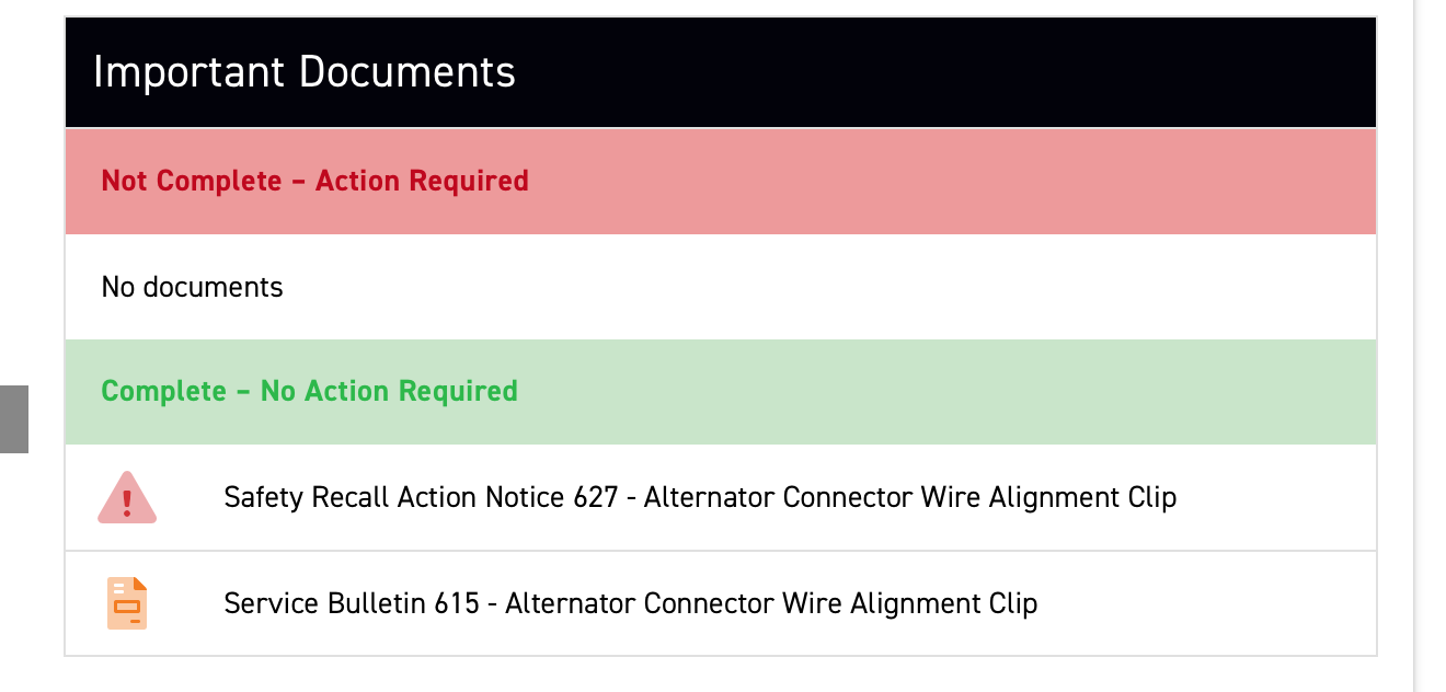

    A dealer would update the completion information on the Triumph Technical Information website.

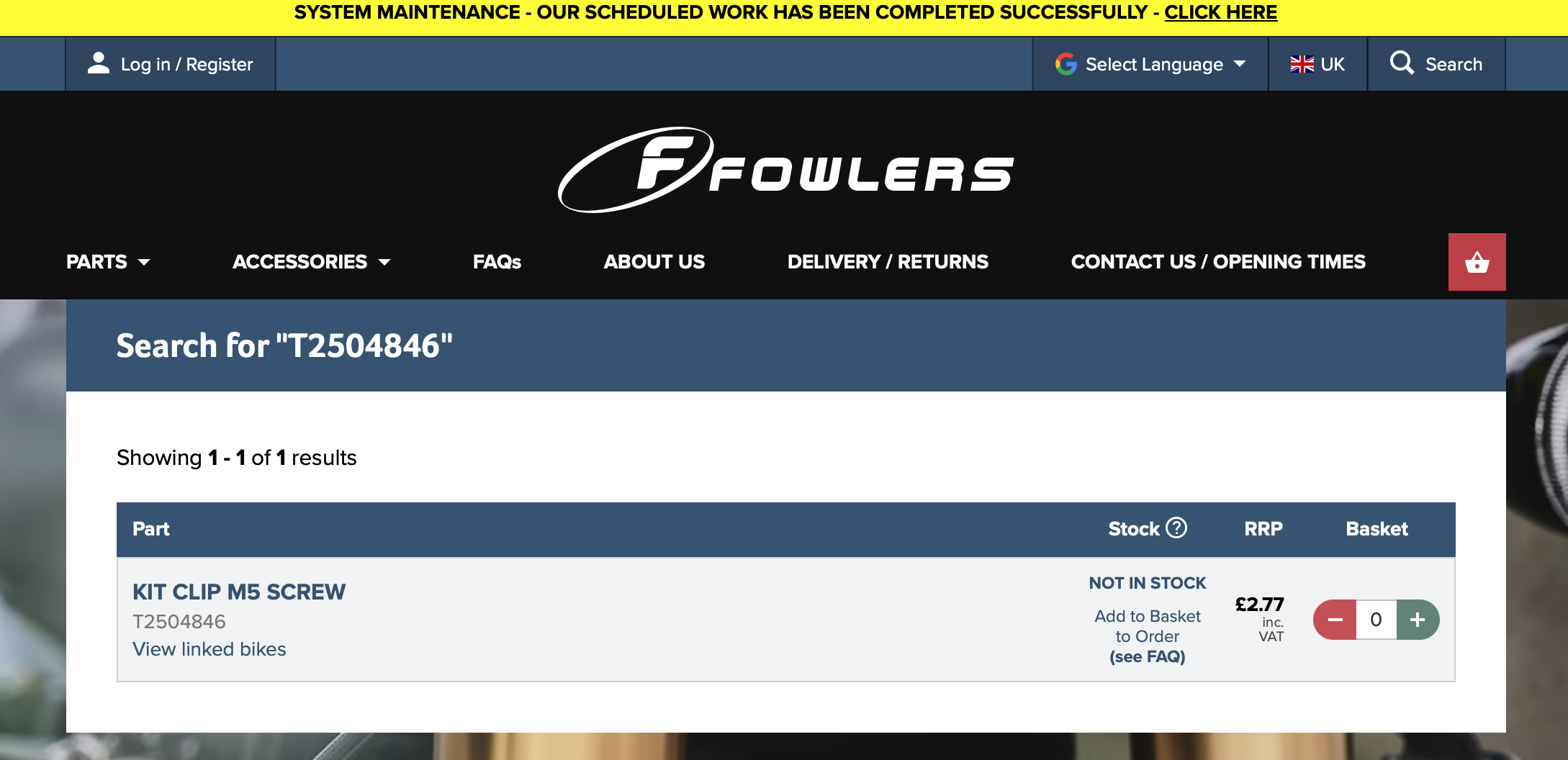

    Current situation at Fowlers
