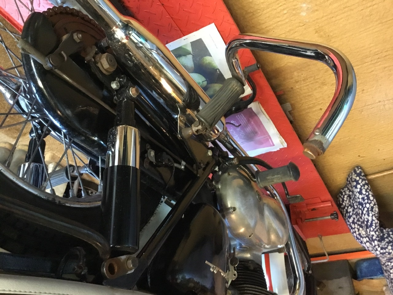

    New tool tray bolted on.
    New handlebar grips.

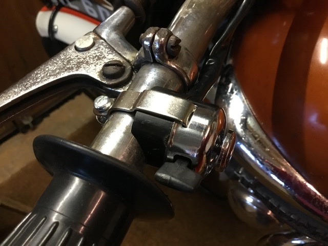

    The repaired hi-lo beam switch failed, now waiting for a replacement.

    New handlebar switch wired in and tested. Just need some dry weather to go for a spin.

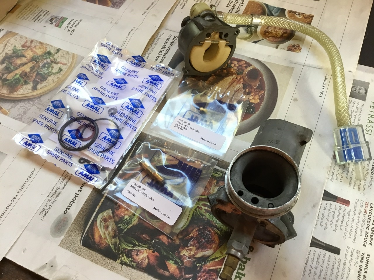

    Refurbished the carb with an Amal kit, now running much better and the annoying leak from the carb gasket has stopped.

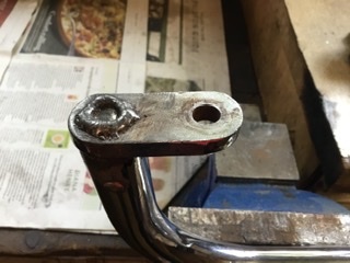

    Went for a spin today and the crash bar fell off!
    Also need to reposition the front mudguard, strengthen the side stand arm, and tighten the right hand exhaust down pipe. Apart from that, all is going well.

    Repair on the crash bar.

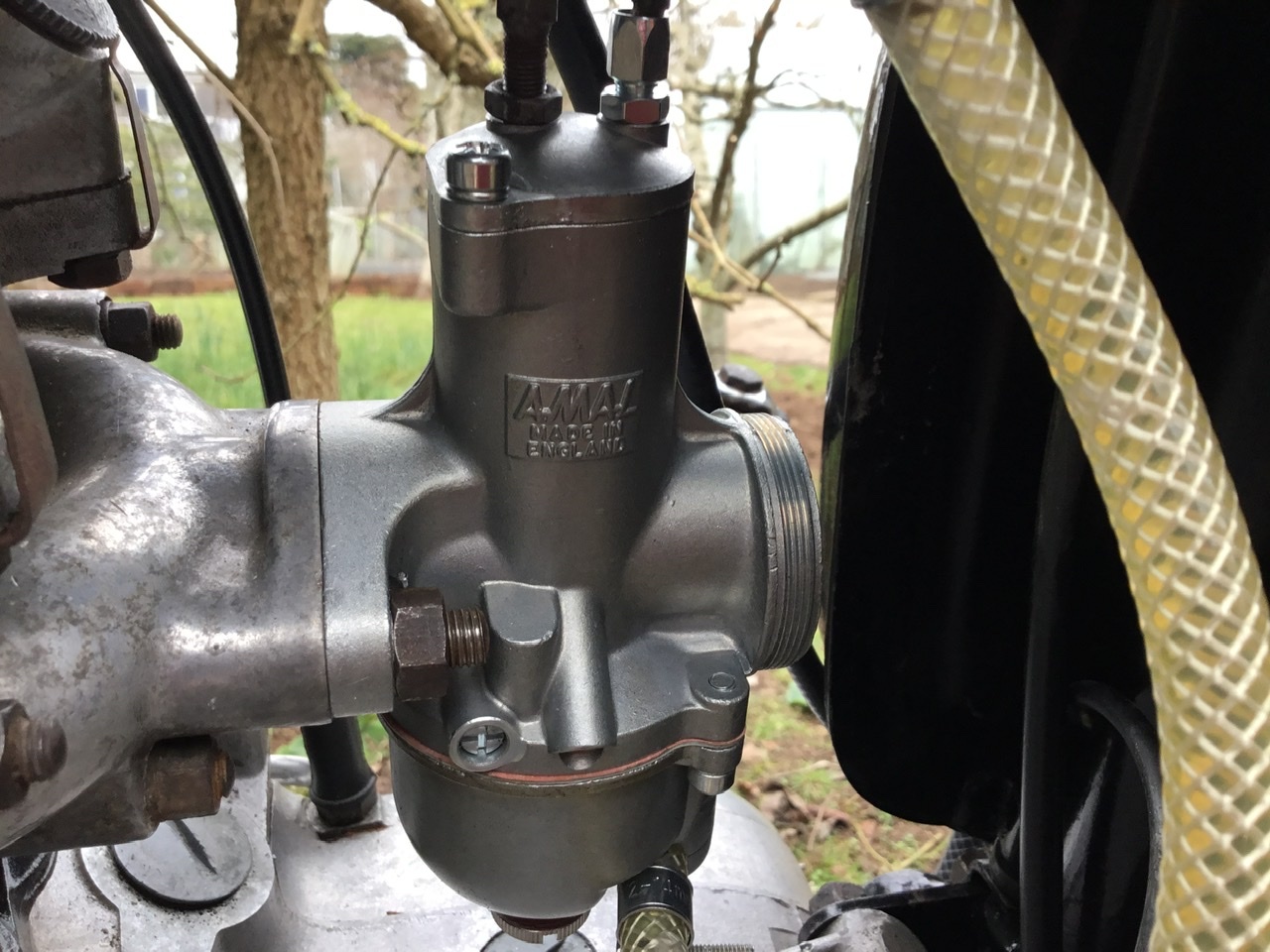

    The carb was a problem - it’s non-standard and has a huge flat spot half way through the rev range, probably because the Goldie style pipes have been swapped for a standard exhaust. The easiest fix (but not the cheapest) was to get a new, correct carb from Burlen. What a difference! It’s much more easy to rev, and accelerates well.
