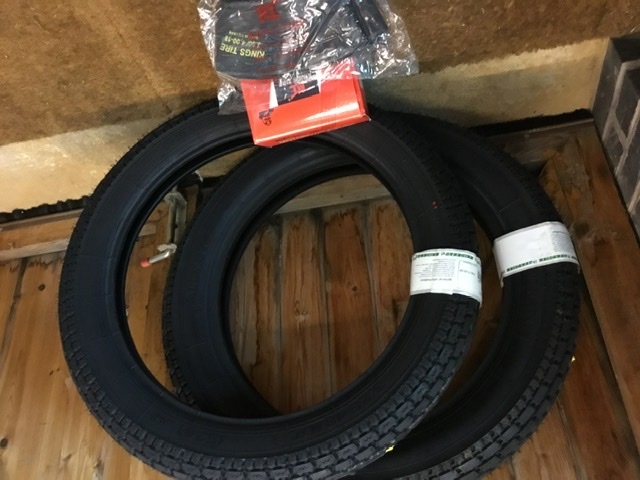

    A rubbery day today. Tyres, inner tubes, gaiters, and footrest rubbers arrived, plus rear shocks.

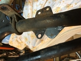

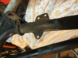

    Patching up the frame. The bracket for the ignition coils was part snapped off. Fixed with a bit of 3mm mild steel. (Suffering from upside-down syndrome again.)

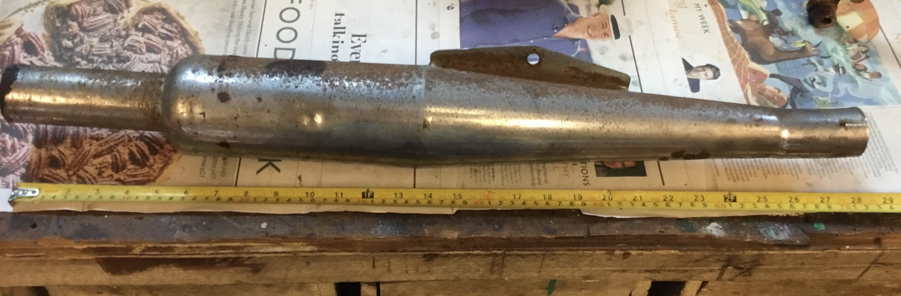

    The exhausts that were fitted to the bike don’t look original. Can anyone identify what bike they are from, or are they custom? They take a 1.5” diameter pipe, so not Norton.

    Looks like a generic aftermarket/repro. 'Goldie' mega. Common in the sixties and seventies.

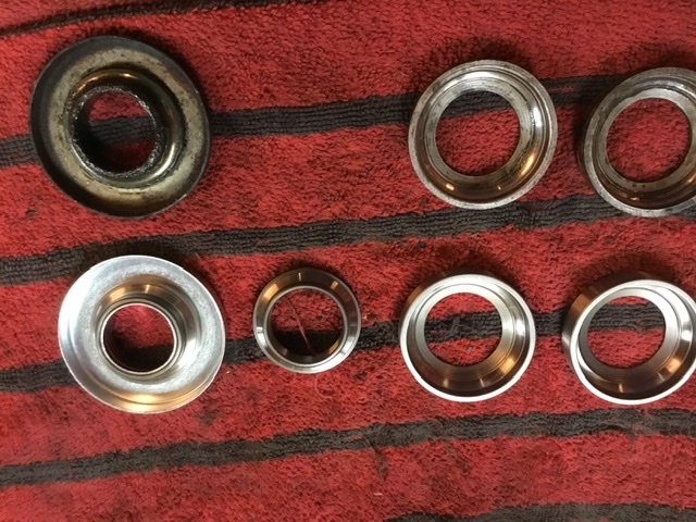

    Good news, the replacement head bearings arrived yesterday. The old cups were driven from the headstock without issue. (Unlike on my old BSA where they were a nightmare to get out.) I can now sand the frame, put the new cups in and paint it.
    New and old below in pic.

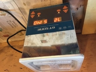

    Yesterday I cleaned up the fixings in petrol, and then an ultrasonic cleaner. They are still rusty looking but at least the threads are clean and the worst ones can be replaced. I’m really going to have to work out why the pics are inverted. Agh!

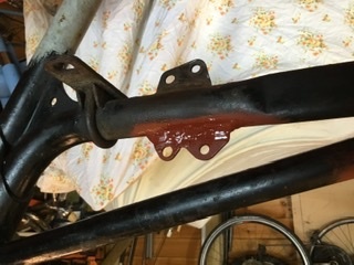

    The frame is now sanded and painted.
    Reminder to all that this is a sympathetic restoration, so nothing will be powder coated, and as many of the original parts used as possible. When finished it should (I hope) have kept its originality and patina.
    I thought I had solved the upside down issue, as previous pic was okay, I guess I need to do a bit more research and testing. Hey ho!
