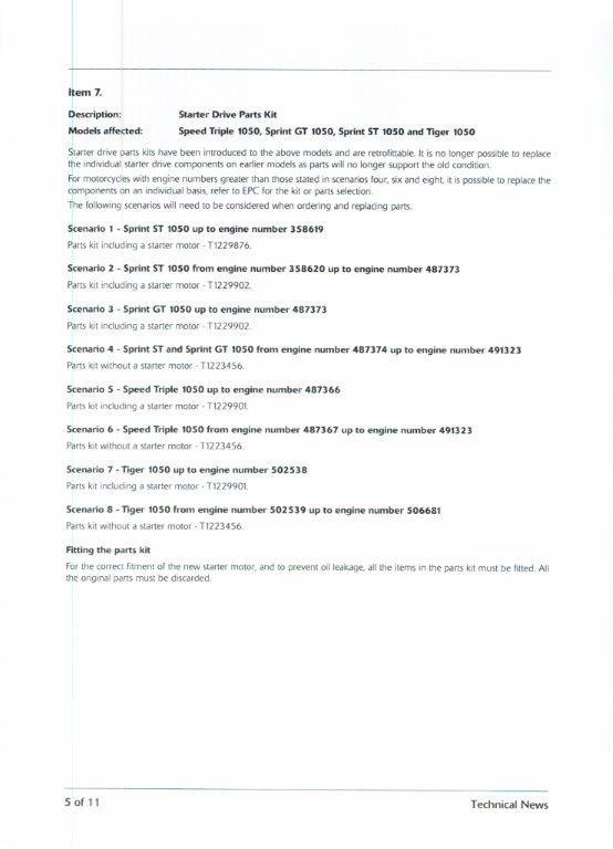

  7. Christian Raynor
    Christian Raynor New Member
    Jun 8, 2020
    Oregon
    This is a serious known issue with Tigers. My 2016 XR Tiger has stranded me multiple times in the backcountry around Mt Adams and Mt Rainer. I researched this bike well and it had good reviews, but I have never been on a less dependable motorcycle, much less one marketed as an "Adventure" bike. This is lawsuit waiting to happen. It will leave you STRANDED IN THE DANGEROUS MOUNTAINS OUT OF CELL SERVICE, in BEAR COUNTRY - RUN AWAY - THEY KNOW ABOUT IT AND IT IS A HUGE BILL OVER $2000 IF YOU CAN FIND THE ISSUE - IT IS DIFFERENT EACH TIME IT SEEMS - NO HELP - RUN AWAY FROM TRIUMPH
  8. Christian Raynor
    Jun 8, 2020
    Oregon
    #8 Christian Raynor, Jun 8, 2020
    ok.
