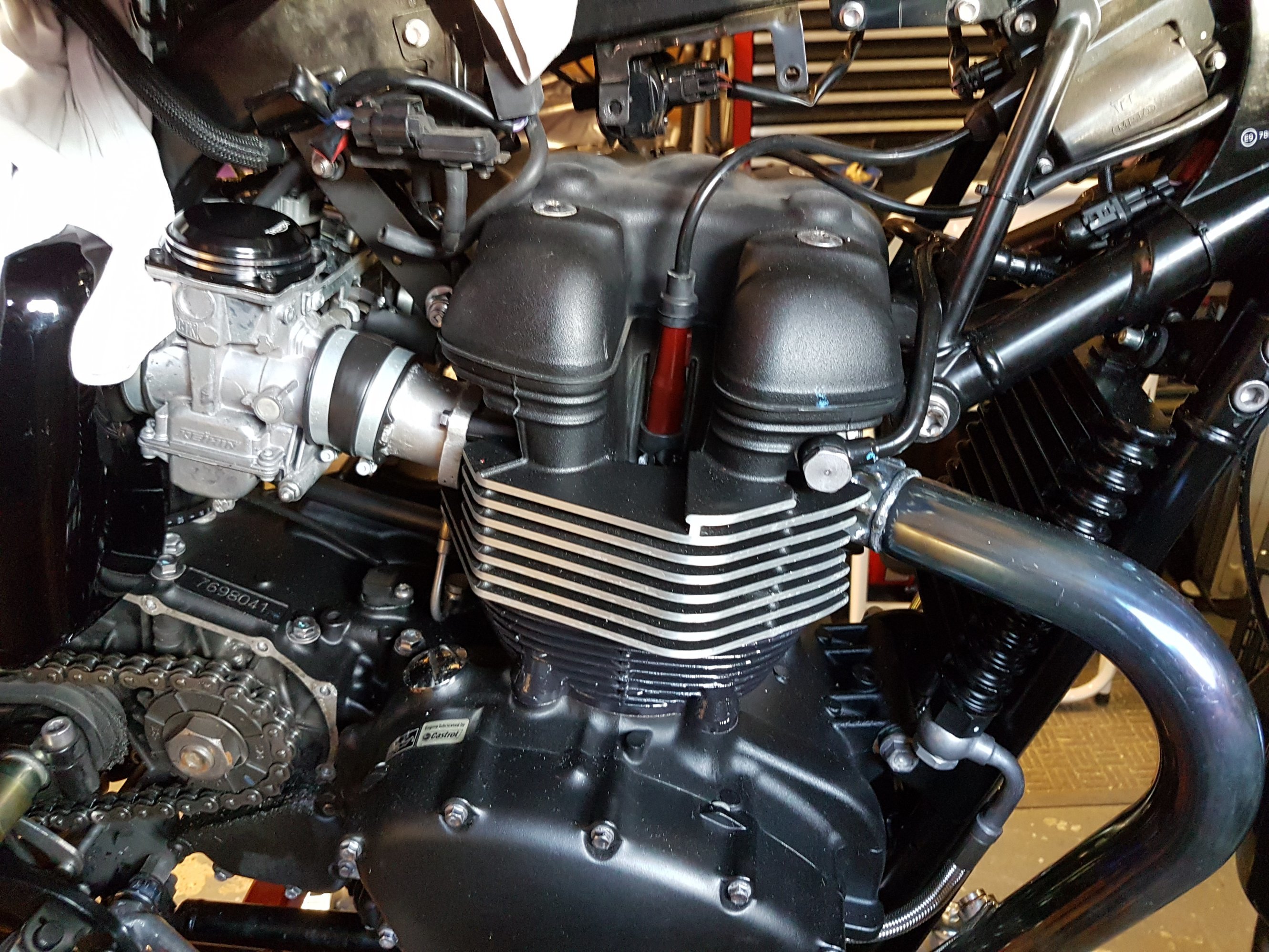

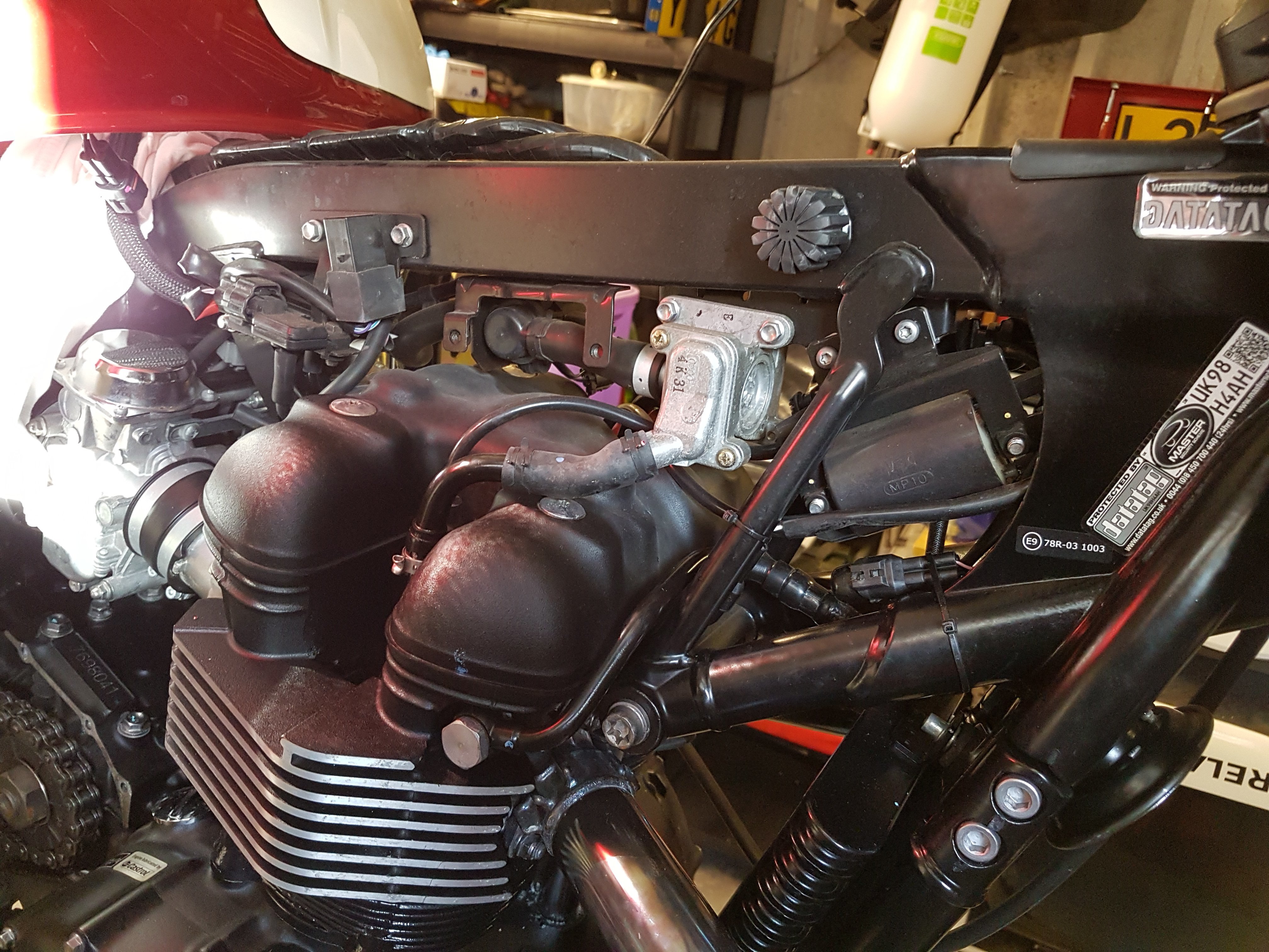

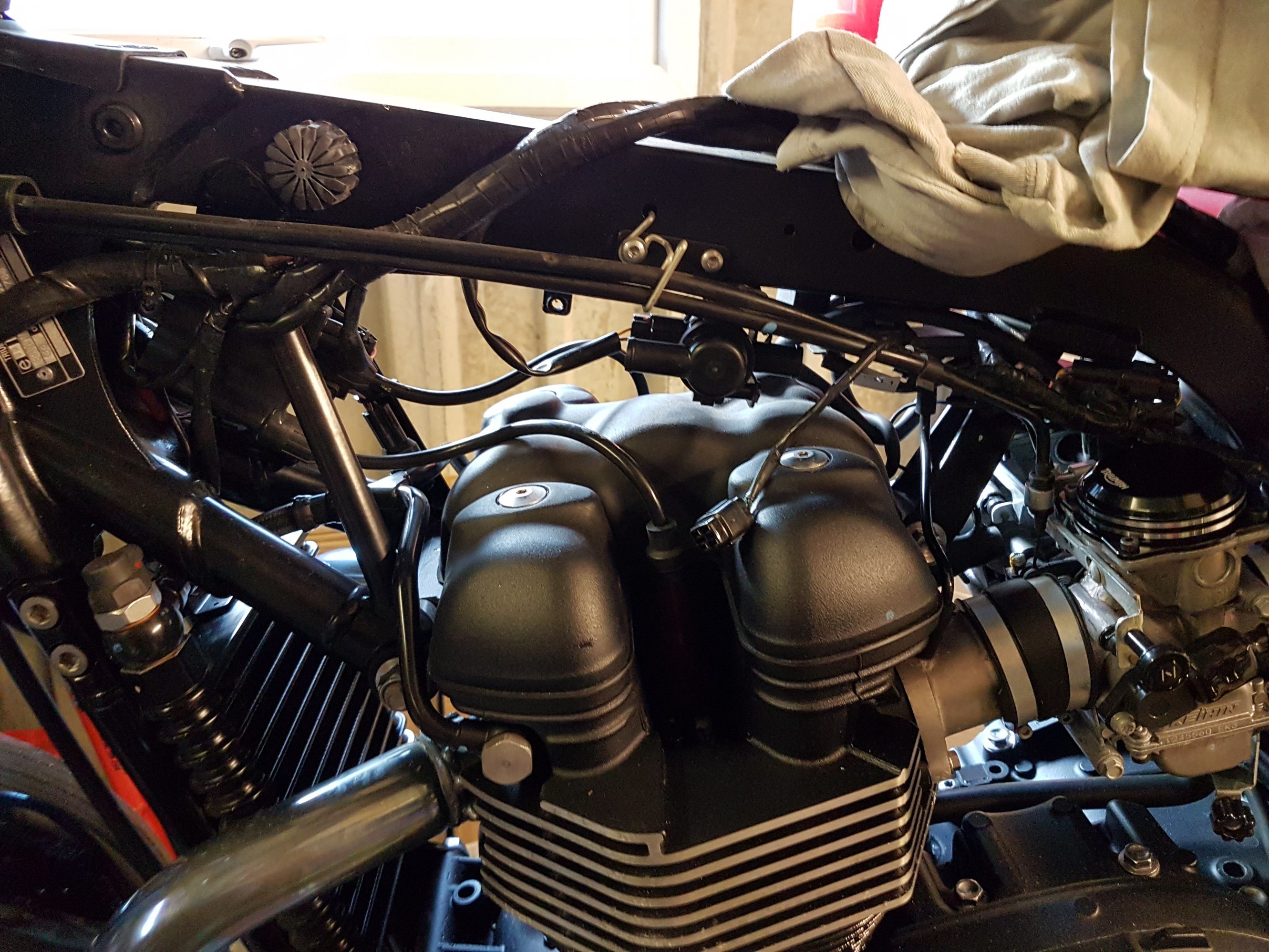

    Next set of mods done.
    First was the AIS removal.
    Before:
  4. tcbandituk
    Apr 8, 2016
    2,902
    Reading
  5. tcbandituk
    Apr 8, 2016
    2,902
    Reading
    From the video I watched about removing AIS, it looks like they re-positioned the coil at some point from above the engine to just behind the headstock?

    Reading

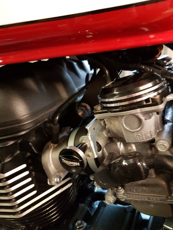

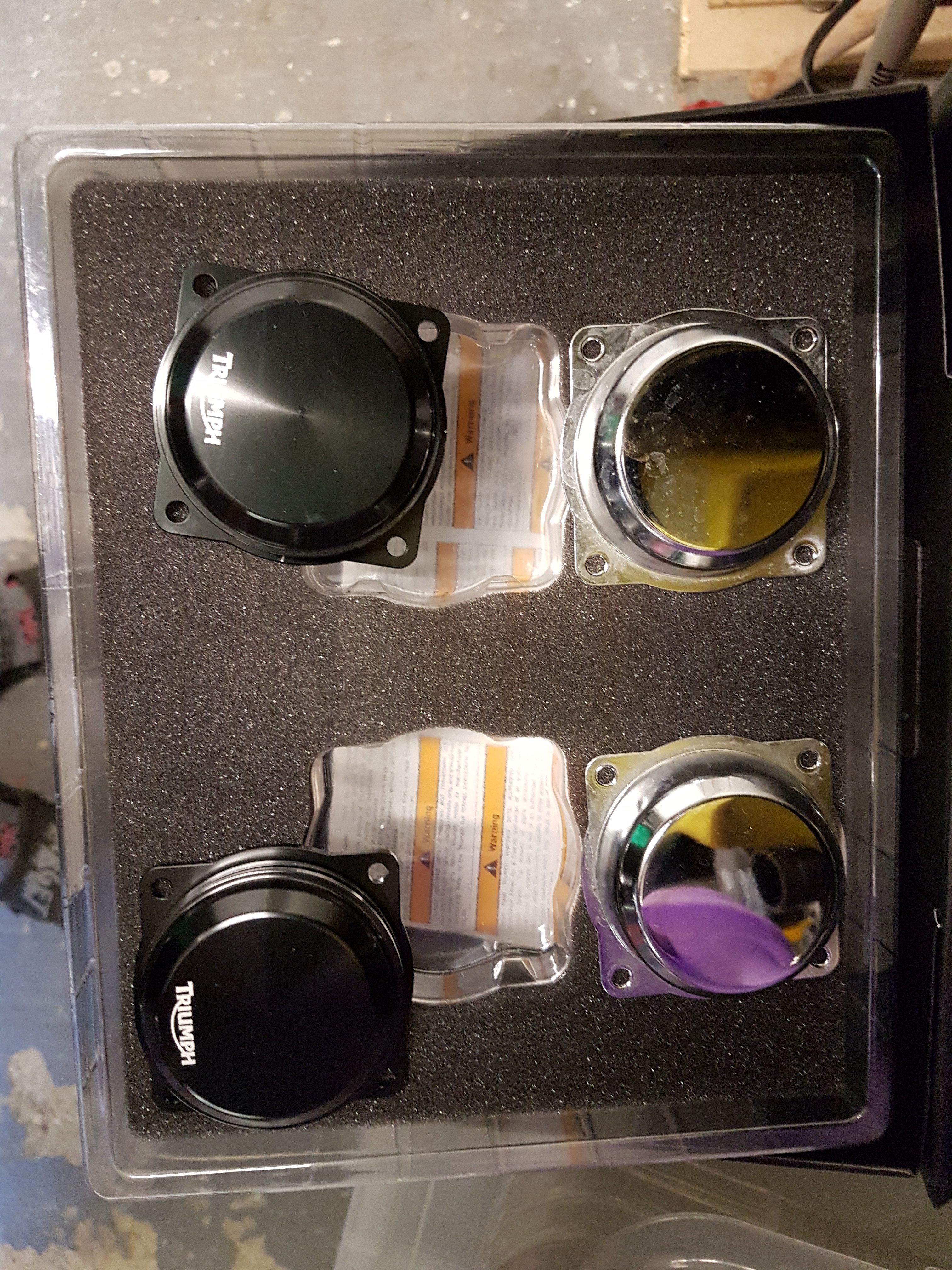

    Next was the FI caps.
    The before and after look can be seen in the AIS photos above.

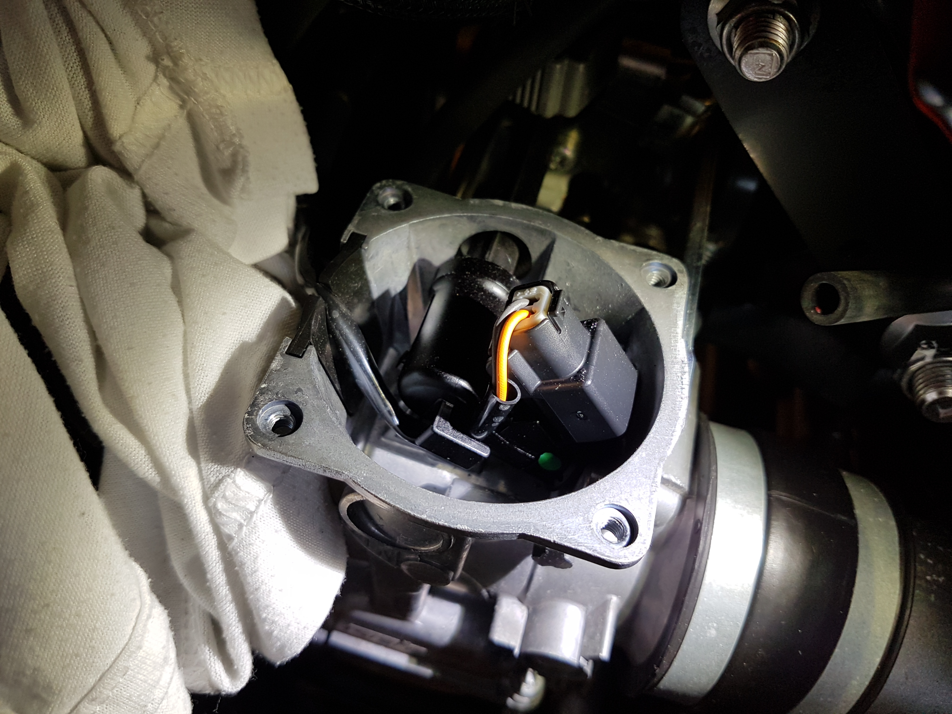

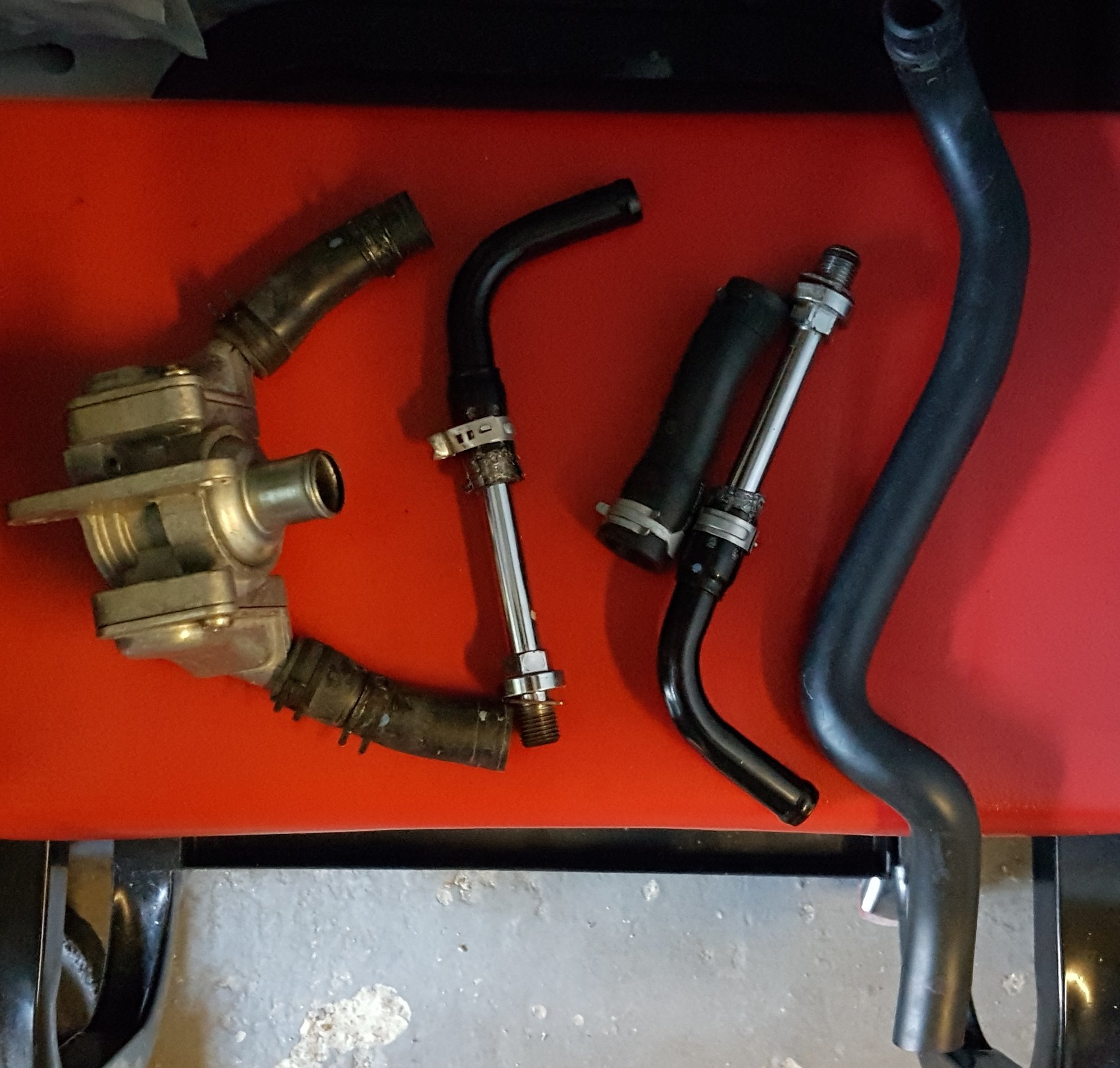

    And just in case anyone was wonder what was under the fake carb tops, it's this.
  8. tcbandituk
    Apr 8, 2016
    2,902
    Reading
    The AIS gubbins removed.

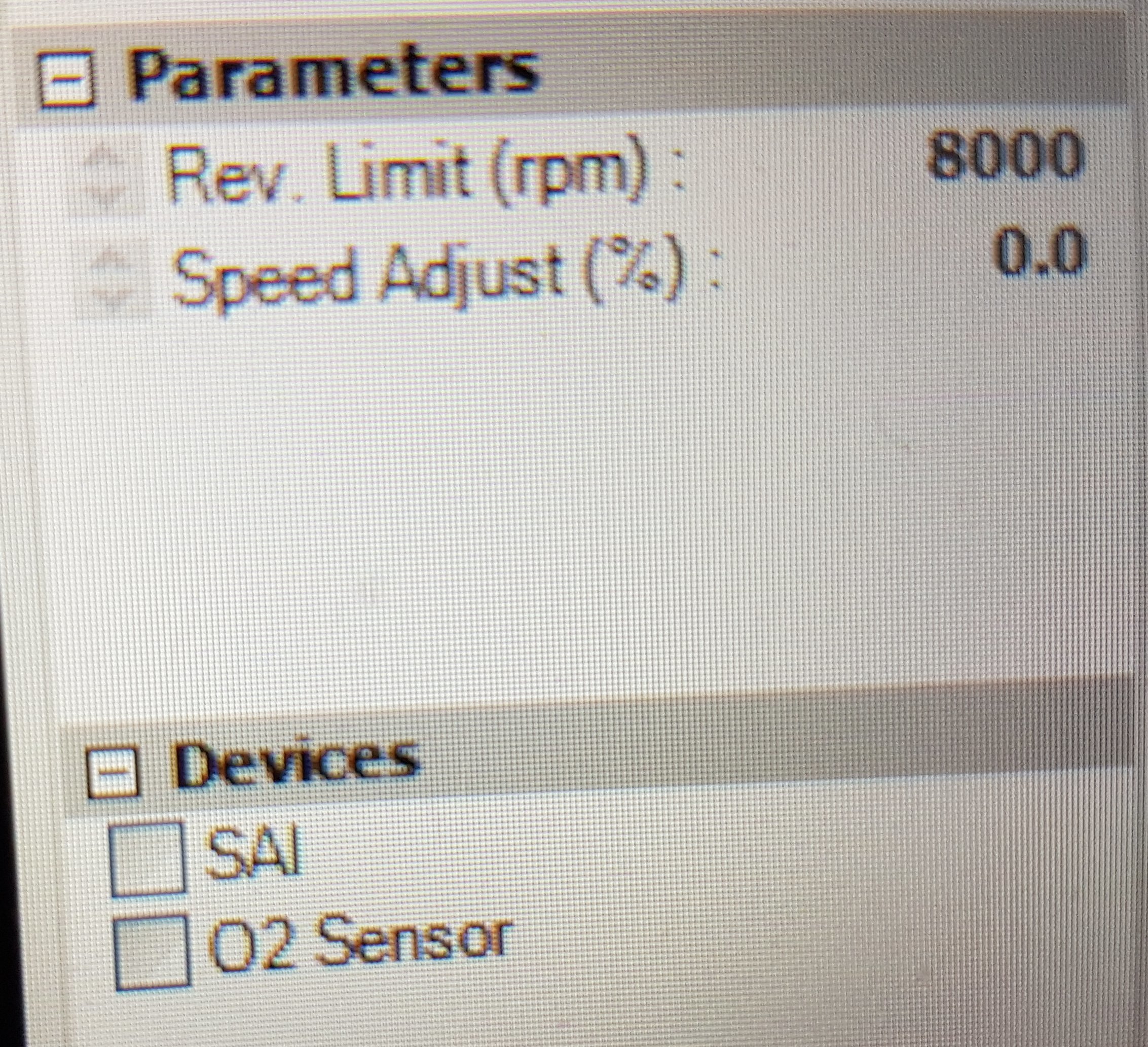

    Did you use a resistor in place of the air pump or just leave it in place to put the engine management light out,
    other method which I did was to remap using Tune Ecu with a saved map tick out of the box for SAI then you can do away with the little black air pump.
  13. tcbandituk
    Apr 8, 2016
    2,902
    Reading
    I just left the pump in place.
    I keep meaning to play with TuneEcu but haven't got round to it yet.
    Something else to keep me busy in the garage :D

    Sound job it's a great piece of software
    Which map are you running

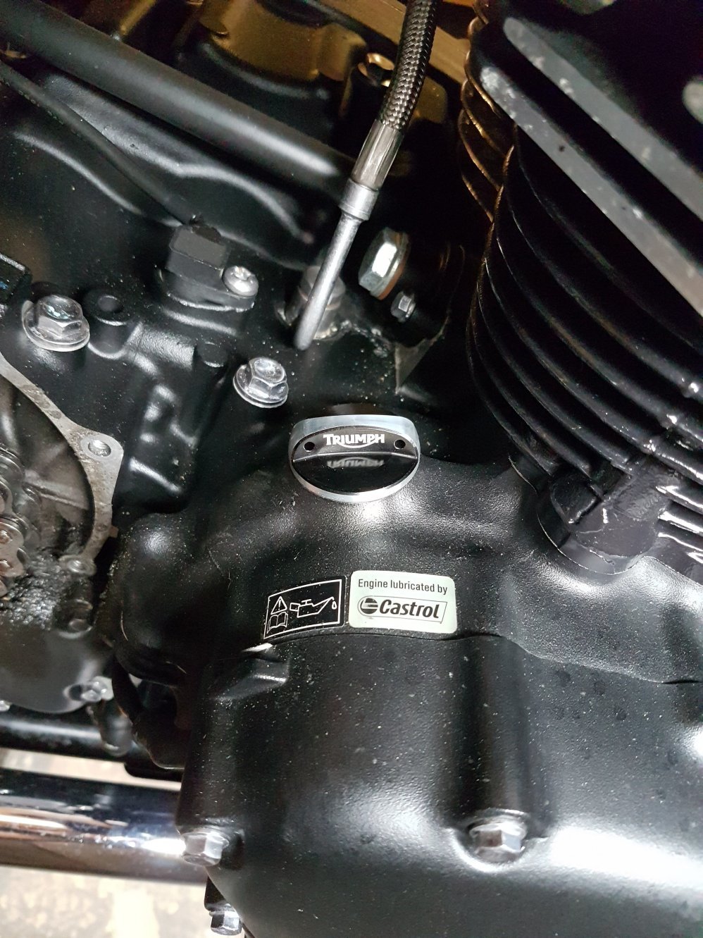

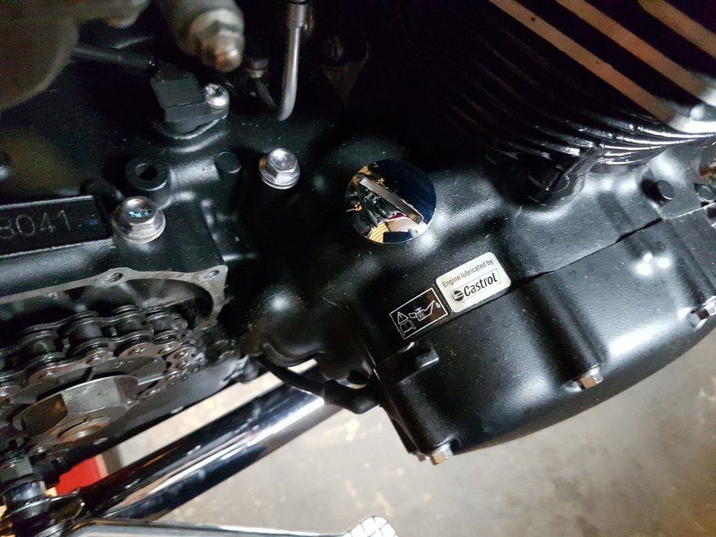

    Only just managed to get the
    Bonnie back in the garage for more work.
    Started with a couple of easy bits, new choke knob and new oil filler cap.

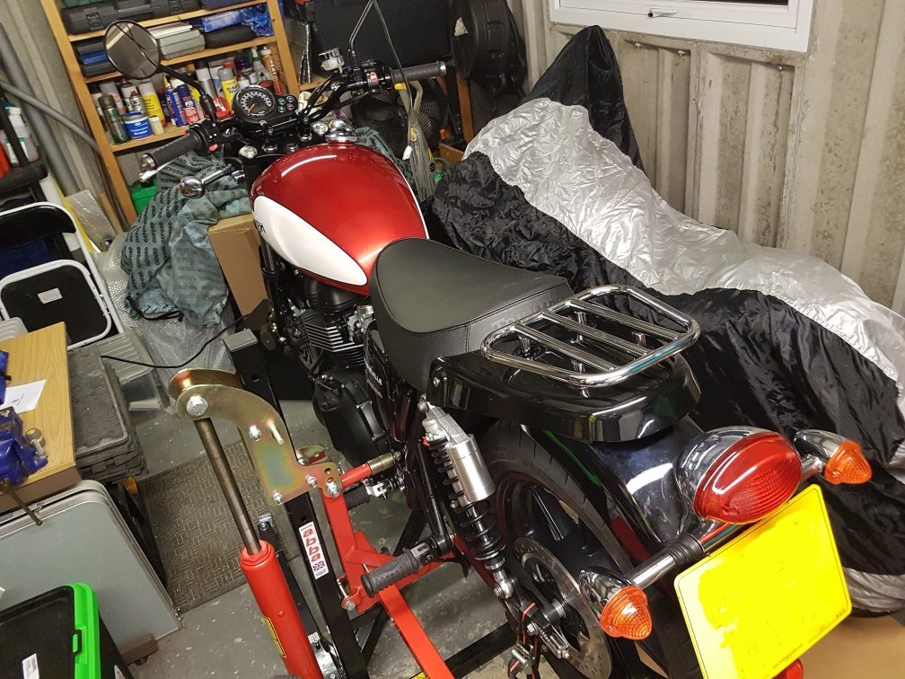

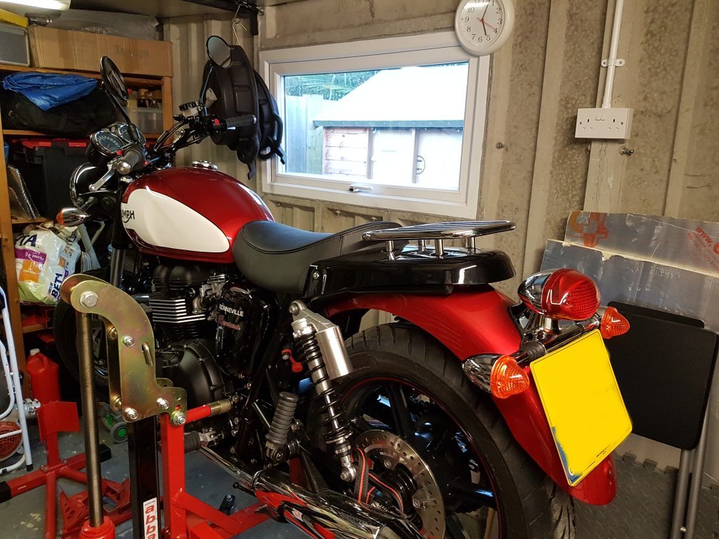

    Got hold of a Cranberry Red mudguard in as new conditionfor £50 from Ebay.
    Fitted that today as well.
    I think it looks better but not sure with the black on the seat/rack?
    Also a slight issue with the reflector mount being different (hence the holes at the bottom) but I'll soon sort it out.
  20. curly
    curly Noble Member
    Jul 3, 2016
    758
    Burton Upon Trent
    I like it, red goes well with the black on the seat / rack set up.
