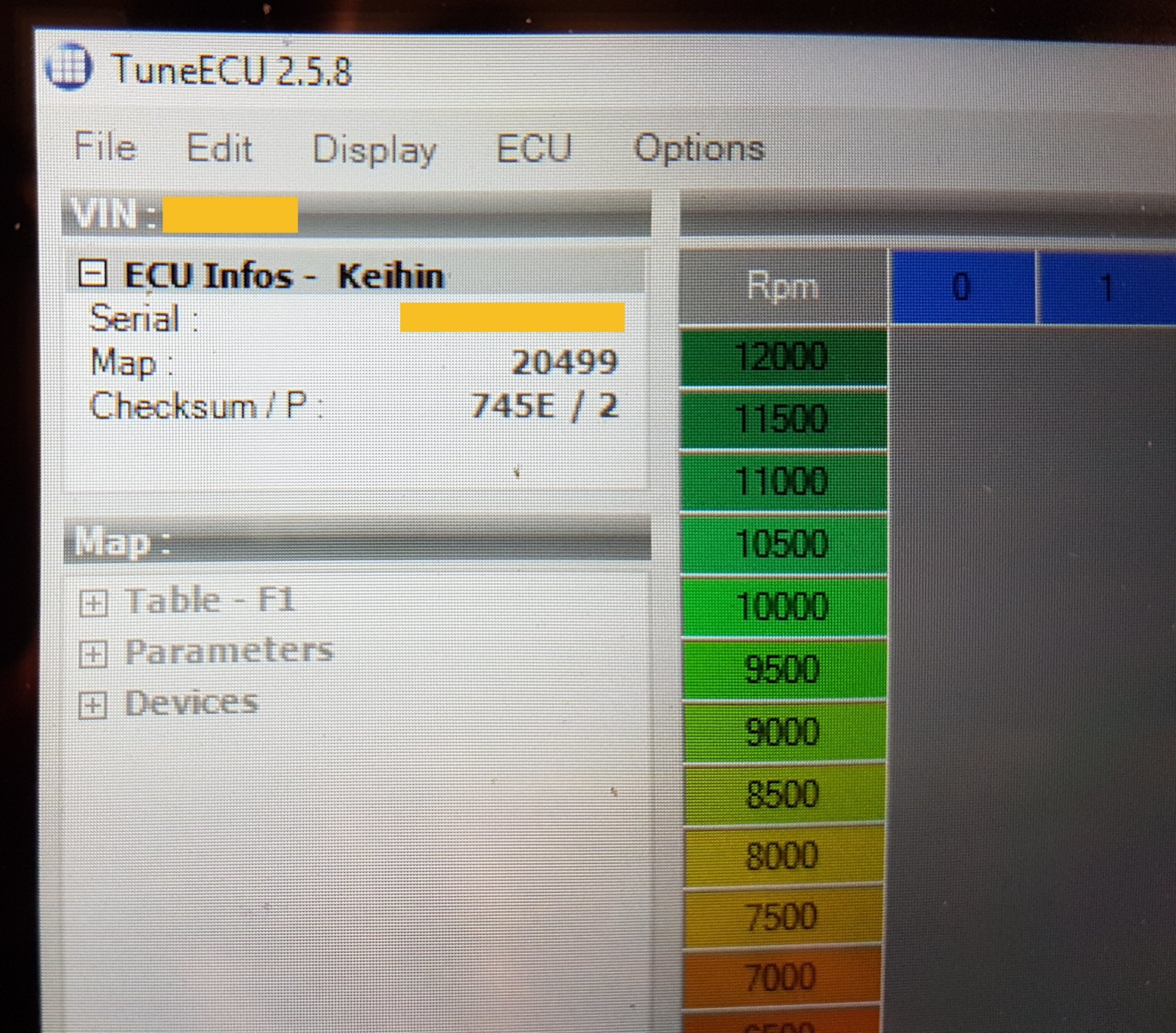

    The Bonnie Newchu has a map in it for the 2-1 Arrow - Map 20499.
    I've fitted the original downpipes back on and some TOR pipes.
    Should I use map 20507 or is there another one specific to the TOR pipes?

    Another question I have is that all the 'TEST' settings seem to be grayed out.
    How do you get them working ?

    I ran the 20507 map with tors the bike ran rich and did not feel smooth also had the stink of fuel all the time overfuelling I think consumption was heavy also now using the arrows 2-2 map with the Norman Hyde pipes and it's just fine map 20505 runs great on this setup the test settings I cannot give you an answer as I
    Never used or noticed

    If they are grayed out they aren't for your bike, tuneecu is generic, it will show almost all/everything that the program will do ! If you hook up to another model bike the gray area's may become active if your bike has those features.!!

    I think what I'll probably do is stick the 20505 map in for now and get it dyno'd at a later date.

    tests are greyed out unless you're in diagnostics menu

    When I was using it yesterday, the diagnostics and the Tests were on two different tabs and you could only select one or the other, not both?

    I reckon so, but the buttons appear greyed out on the wrong display.
