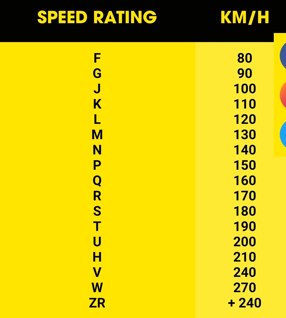

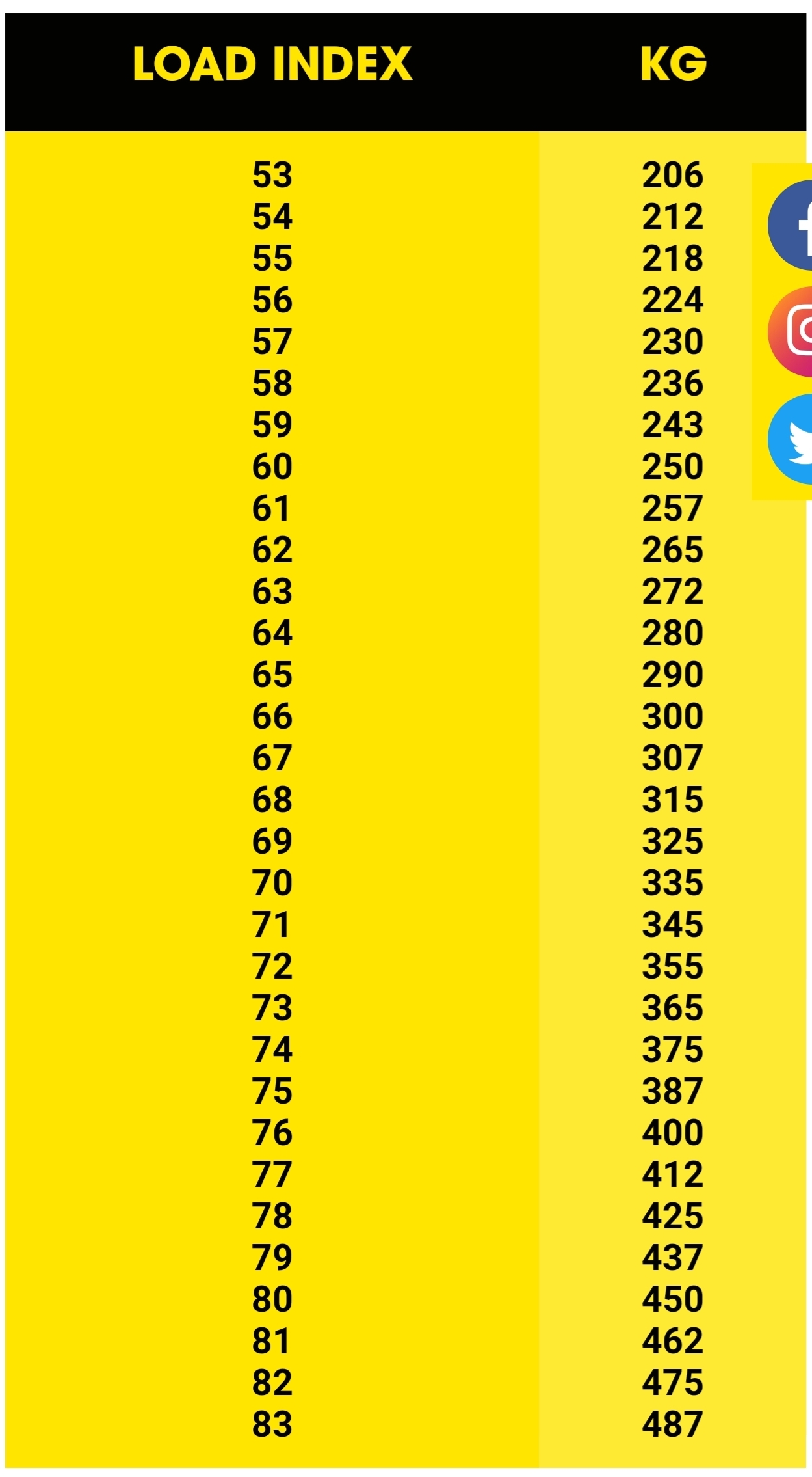

    I think its a speed rating, not entirely sure. I think one may be designed for heavy touring bikes too

    SmartSelect_20210408-053417_Samsung Internet.jpg SmartSelect_20210408-053402_Samsung Internet.jpg

    So given that they’re both the same price, it would make better sense to buy the higher speed rated tyre I guess? In which case I ought to be buying the 75W?

    I would presume so, but I'm not completely sure which is best. I have a feeling that one was intended for really heavy bike so may give a harsh ride on a lighter bike. But then the load rating contradicts that as they're both the same. I'm a bit confused myself.

    Kind of shorthand. They indicate the load and speed rating of the tyre. 73W will have lower weight capacity than 75W. Look on Oponeo's website- they usually differentiate between heavy load tyres which are only normally needed on the likes of Pan Euros or those German bloatmobiles. W is speed rating, so either of those is rated to the same speed. 73W would be fine on a T595 and ought to be the cheaper of the two. :)

    Many thanks, m’friend, for all your time as always. The choice was between 75R and 75W, so I guess it would make sense to buy the higher speed rated tyre, with there seemingly being no difference in costs?

    Yes. R might be a bit on the slow side :p load index of 75 is probably because they are 190 section. More rubber, better load capacity? :)
    PS yes not paying attention again. Your choice was 75R or 75W. R speed rating is a bit low for a sports bike. If you're buying tyres using a dropdown menu probably best if you specify ZR rating. That will only select higher rated speeds. W is rated to 168 mph, so just about safe :p:grinning:
