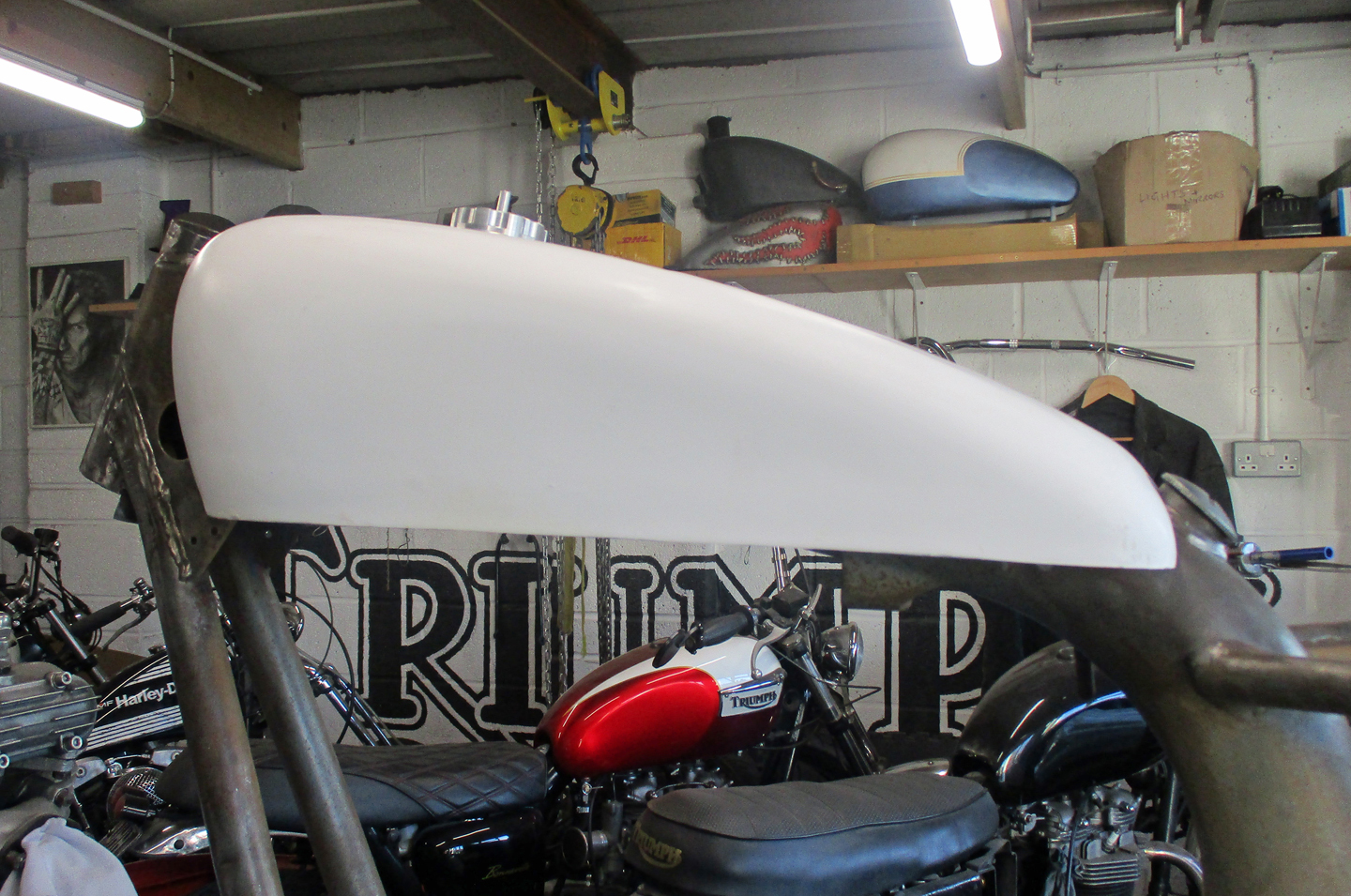

    Trackmaster tank arrived
    good fit on the oil in frame.

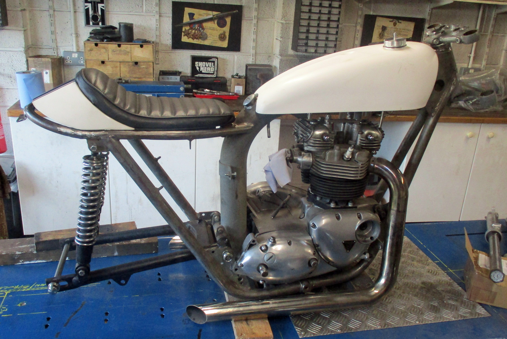

    The engine was a US import back to it's homeland. It must have originally been a UK model due to the T120V engine stamp rather than the US T120R stamp. But no idea of the history there other than it came from Baltimore (wherever that is).
    The engine is out of another bike so the head and barrels went on for that build. Nothing special in there as I just try to get them running to pootle around on rather than tearing it up these days, so pretty sure just standard cams and followers.
    The tank is from Redmax and is a UK made item (I think). I'll line it once the drybuild is sorted as I'm fed up with leaks appearing after completed builds (even after pressure testing) these days.
    I've just laid on a tail section that I made up from another build to see. I haven't shortened the subframe as much on this one (about 3 inches) so I can get my arse a bit further back. Still thinking about rearsets or just sticking to standard with western bars. But coming along I think.

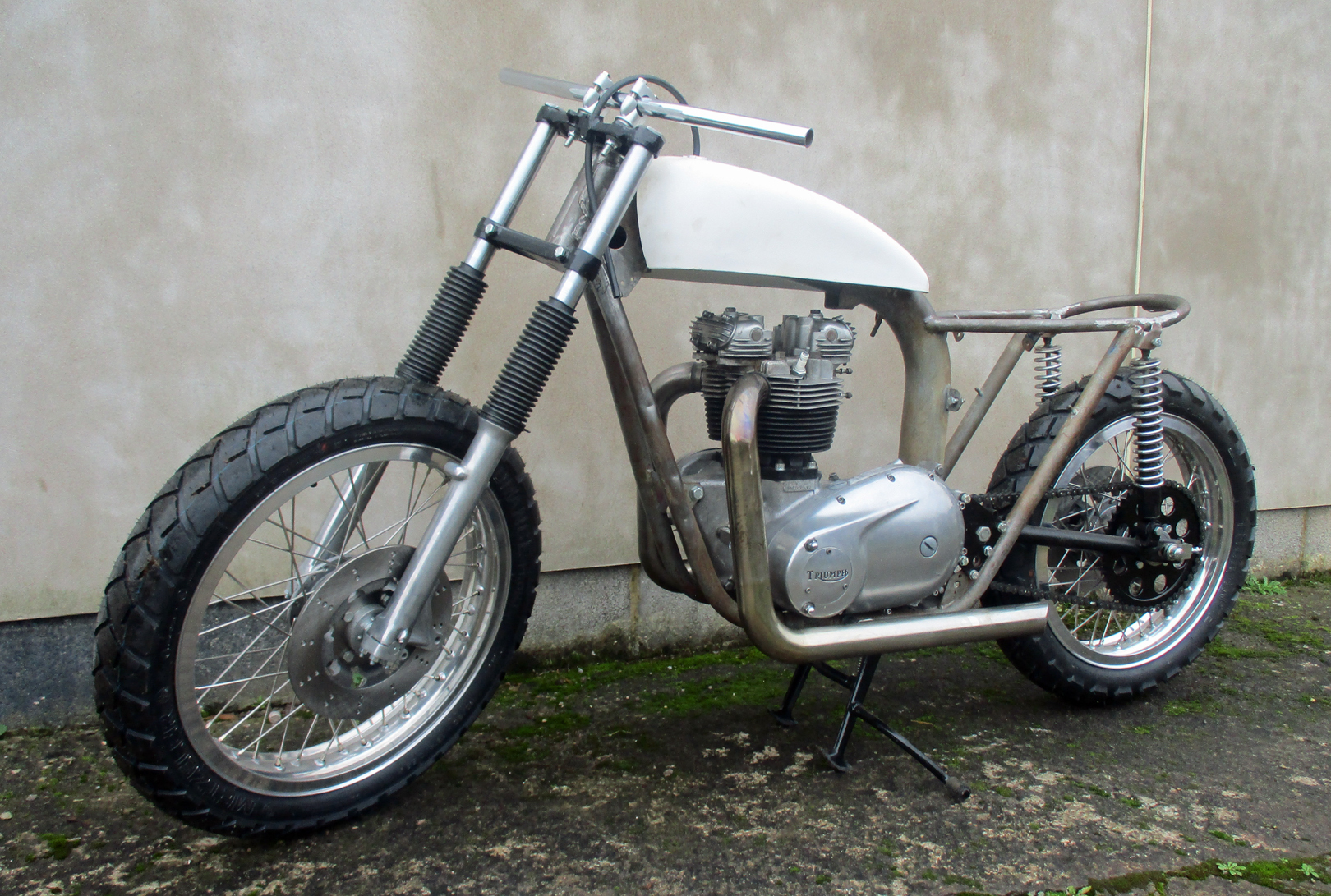

    New yokes, new stanchions and we're back on our feet with new discs and sprocket.
    The sub frame is cut and welded back on an inch or so longer than the last build so I can get my arse back a bit.

    As I am officially getting on in years (I have received my bus pass I'll have you know) I thought I'd make my life a tad easier by using the block and tackle to lift the engine in.
    Blimey, it didn't help at all. In fact it made it almost impossible to move and fiddle the engine in as is required with these. So went back to the old way of man handling the bloody great heavy thing in.
    Phew... They aren't getting easier to lift.
    Dangled the 2 inch zorsts on just to see and I'm quite pleased so far.......over.....
