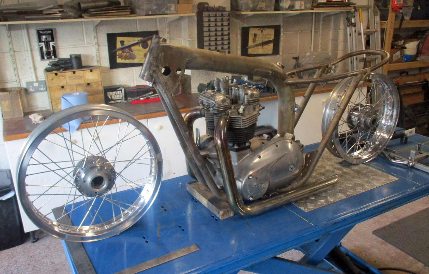

    I like a new project
    I've rebuilt the 1972 T120V engine with 750 Barrels and a Tiger's head.
    Nice 2inch stainless zorsts that should keep the mobile phone users from stepping into the road.
    New built wheels with Italian 3 inch rear rim and 2.5 inch front.
    Gonna try for a Trackmaster tank on this one.
    • Like Like x 13

  5. Iron
    Iron Elite Member
    Dec 29, 2021
    2,753
    943
    Bob Ross Studios
    Thanks Gang. The Shovel delayed me for a while but the Trumpet's Boots are on order now so I can get it on it's feet next week.
  6. speedrattle
    speedrattle Senior Member
    Feb 19, 2021
    1,194
    appalachia usa
    what kind of 750 barrels? T140?
    is that why youre making up head steadies?
  7. Iron
    Iron Elite Member
    Dec 29, 2021
    2,753
    943
    Bob Ross Studios
    @speedrattle they are Routt 9 hole big bore barrels.
    The head bolts are like that as they are all I have for now. They were taken off of another bike I dismantled and originally held the coils. I'll revert to the original steady and bolts when I order the parts.

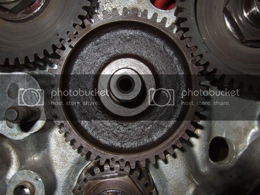

  14. darkman
    7,657
  15. darkman
    7,657
  16. Iron
    Iron Elite Member
    Dec 29, 2021
    2,753
    943
    Bob Ross Studios
    #16 Iron, Nov 10, 2024
    Brill - thanks for that. Hadn't seen that before.
    From the days when magazines used to have useful stuff in them
  17. speedrattle
    Feb 19, 2021
    1,194
    appalachia usa
    they list the 750 short rod motor with a very retarded intake cam lobe center-- 111 degrees, with a more typical 103 degrees on the exhaust. as i understand it, that retarded intake timing was intended to de-tune the 750 so it wouldnt destroy its . . . one-piece timing side main bearing? i forget.
    normal timing is generally at lobe centers of 100/100, or 102/103, or in that range.
    im curious because i run my land speed race bike at 106/109, very retarded lobe centers, and it has very good power at both upper and lower rpms. but the cams are 0.375 lift and 296.5 duration.
    im interested in building a motor with a bias to low-rpm horsepower for a sidecar tug, so im thinking about what i might be doing there.
  18. darkman
    7,657
    Ramp cams as fitted to pre unit Triumphs are a consideration or use dot to dot on inlet instead of dot to line. upload_2024-11-10_18-6-38.jpeg
  19. speedrattle
    Feb 19, 2021
    1,194
    appalachia usa
    #19 speedrattle, Nov 10, 2024
    was the dot-to-dot timing characteristic of milder triumph motors? that would advance the intake cam 7.2 degrees over dot-to-dash.
    at any rate, super mild tuning is what im looking for. im not expecting more than about 45 mph out of that machine, especially with a 17-tooth gearbox sprocket, so any power over 4000 rpm is wasted.
  20. darkman
    7,657
    Dot to dot was the Thunderbird tune
