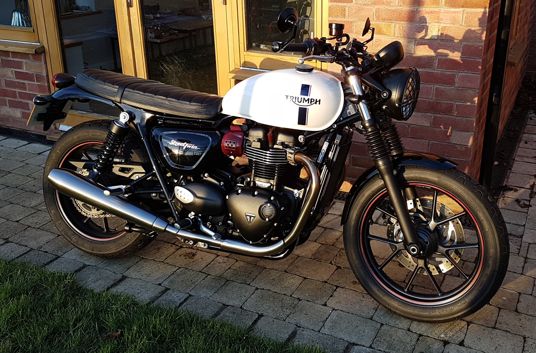

    Last pic, I promise! The sun was out so got a final pic. It's personal, but to me, the bike is looking better than I expected. In particular, I was glad how the burgundy intake cover ties in with the wheel stripe, HT leads and Triumph logo. Really pleased and a sense of satisfaction. I used this picture for my screen saver at work, which was not a great idea as I genuinely get distracted looking at it! I know I have only tinkered a bit compared with some of the projects on here but for me on my nearly new bike there were a few moments where I was a bit freaked by the number of parts, nuts, bolts and washers on the shelf! I will look into performance parts, side panels, sprocket cover and possibly a tank strap next winter.

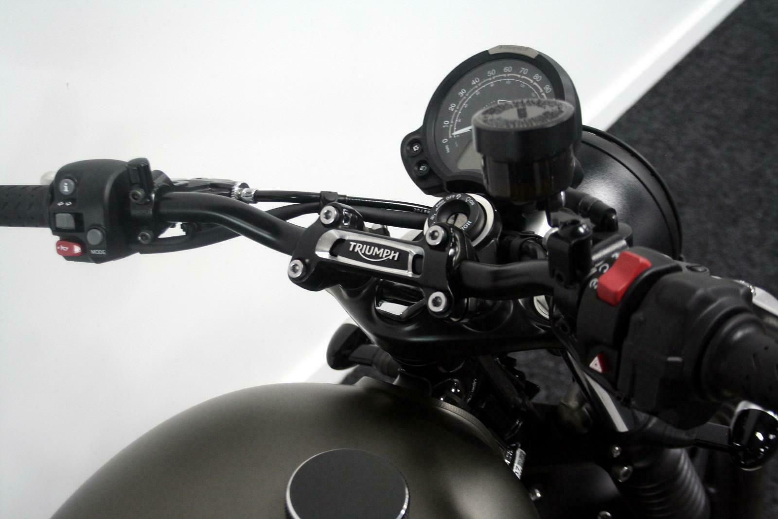

    Had a closer look at the clutch lever clamp (perch?) on your bike, where the original left side mirror was fitted. There's that little stumpy bit sticking up that the mirror screws into, which I think you've plugged with a rubber bung.
    Did you know you can get rid of that bit?
    The Triumph Daytona 675 clutch lever clamp is a direct swop but without the mirror fixing point. Part Number: T2046510. I paid around £7.00 and took 10 mins to fit. You should be able to see the difference on the pics of my bike.
    Looks much better.
