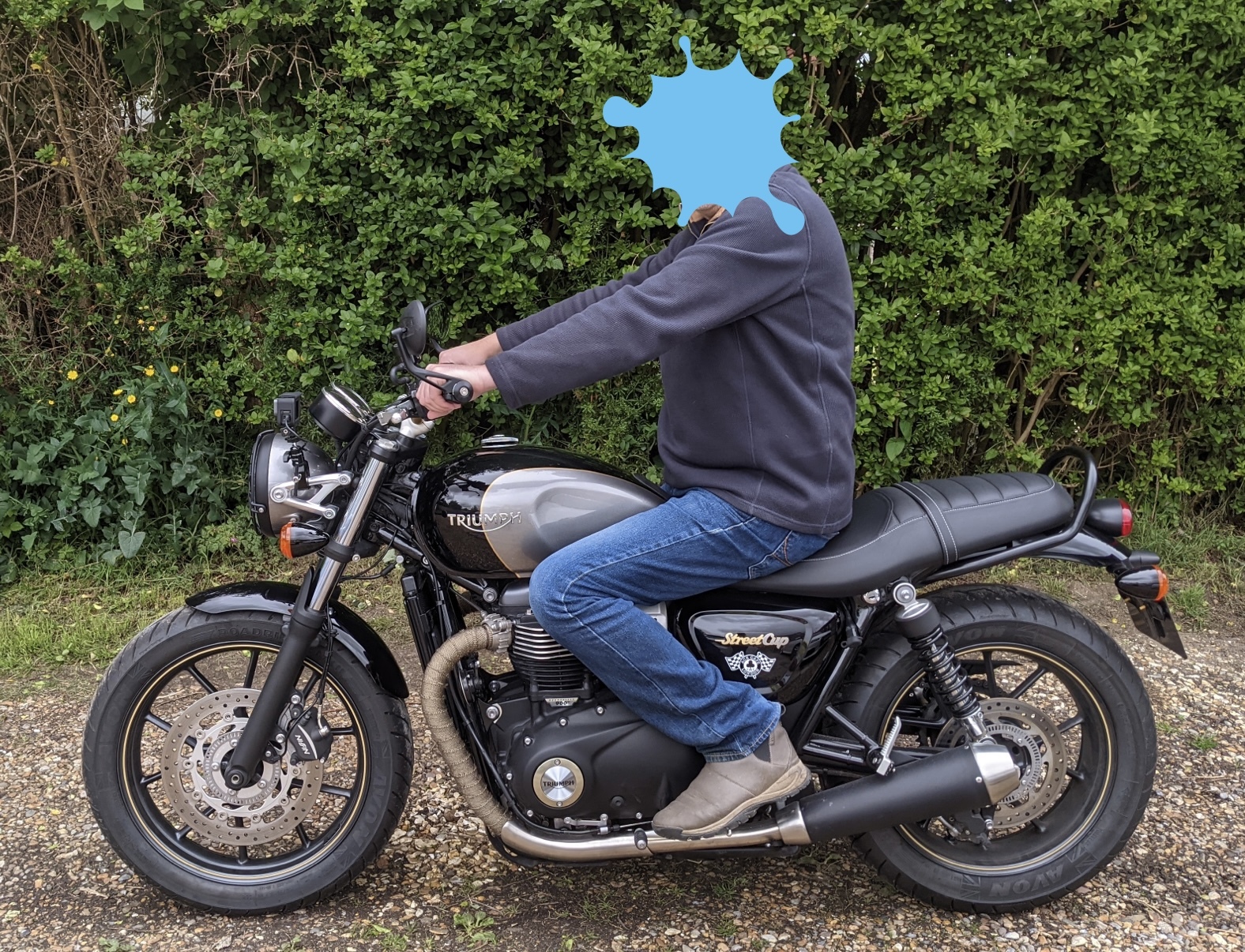

    Here’s a pic of the riding position for me when I first changed the bars.
    #84
  5. Obijohnkenobe
    Obijohnkenobe Well-Known Member
    Dec 14, 2020
    101
    210
    Tonbridge, Kent, UK
    Agree 100%. Would love rearsets for the SC. TEC do adjustable pegs which they say are all that is needed for the SC but I'm not convinced.
