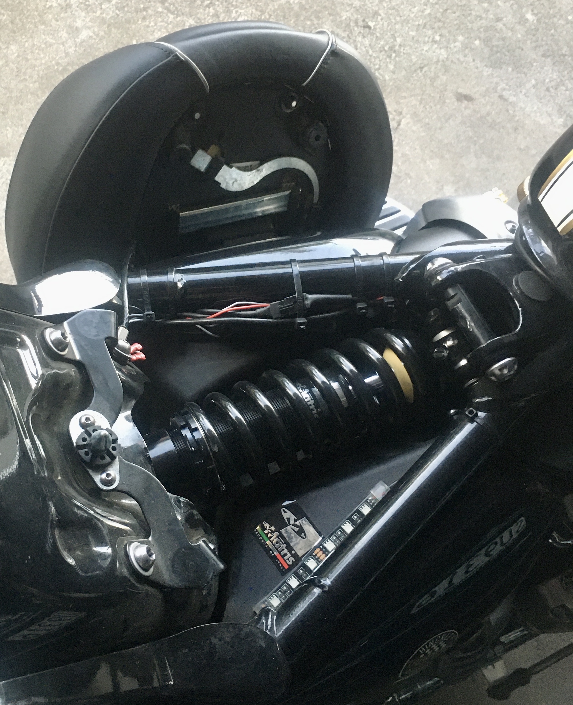

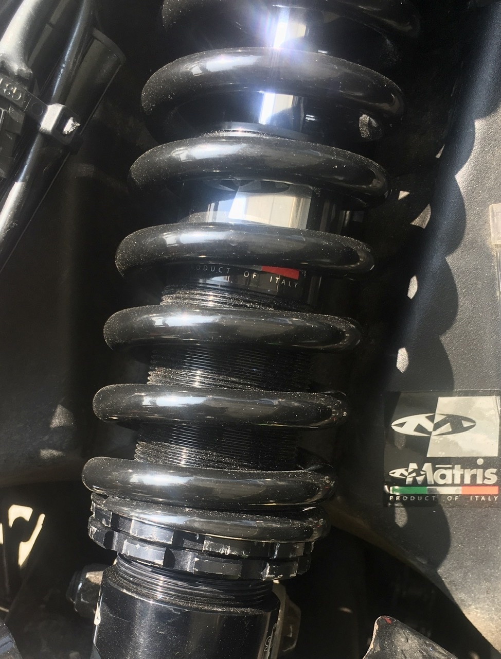

  11. Dartplayer
    7,656
    Hi @Drummer, we have success. At only initial load on the new mono, I have not bottomed out yet.
    Front has also been very smooth, so need to fine tune, but looking forward to trying Mrs Dartplayer on the back for preload test against standard for a pillion.
  12. Dartplayer
    7,656
    Went for a 2up ride with 170kg+ load and only had to adjust Matris mono preload up 3 rotations. You can see how much adjustment is left and the ride was smooth over sharp twisties, over hills, and some big straight roads with marginal surfaces. So happy
