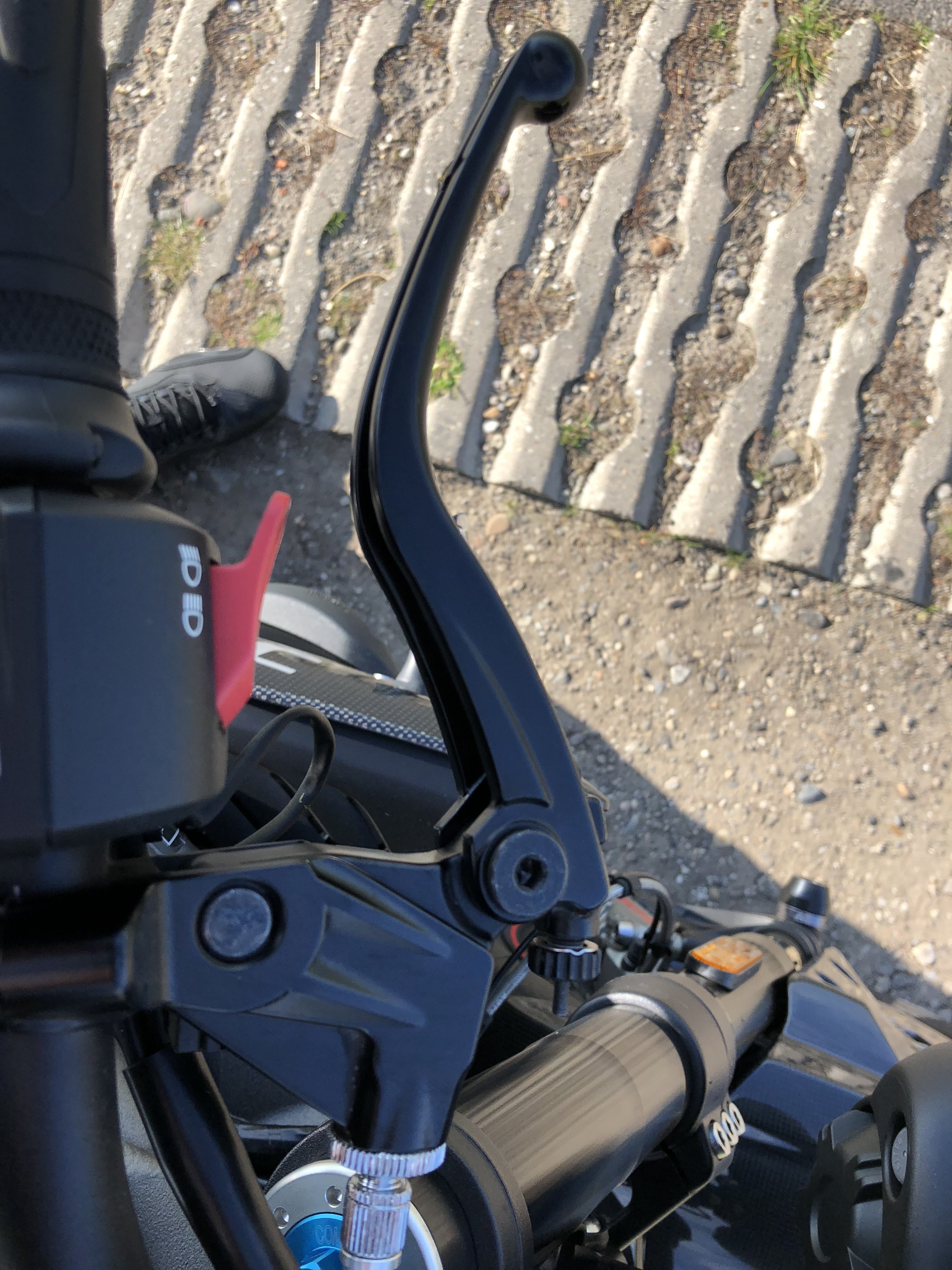

  20. Arno triple
    Arno triple Senior Member
    Aug 26, 2018
    613
    Hi All!
    Had a short trip today, and noticed the clutch was slipping after changing gear. Clutch lever is not going back entirely to original position. WD40 helps a bit, but not permenatly. Will call the dealer this week and keep you’ll posted.
    2 pics show before and after “pushing” lever back.
