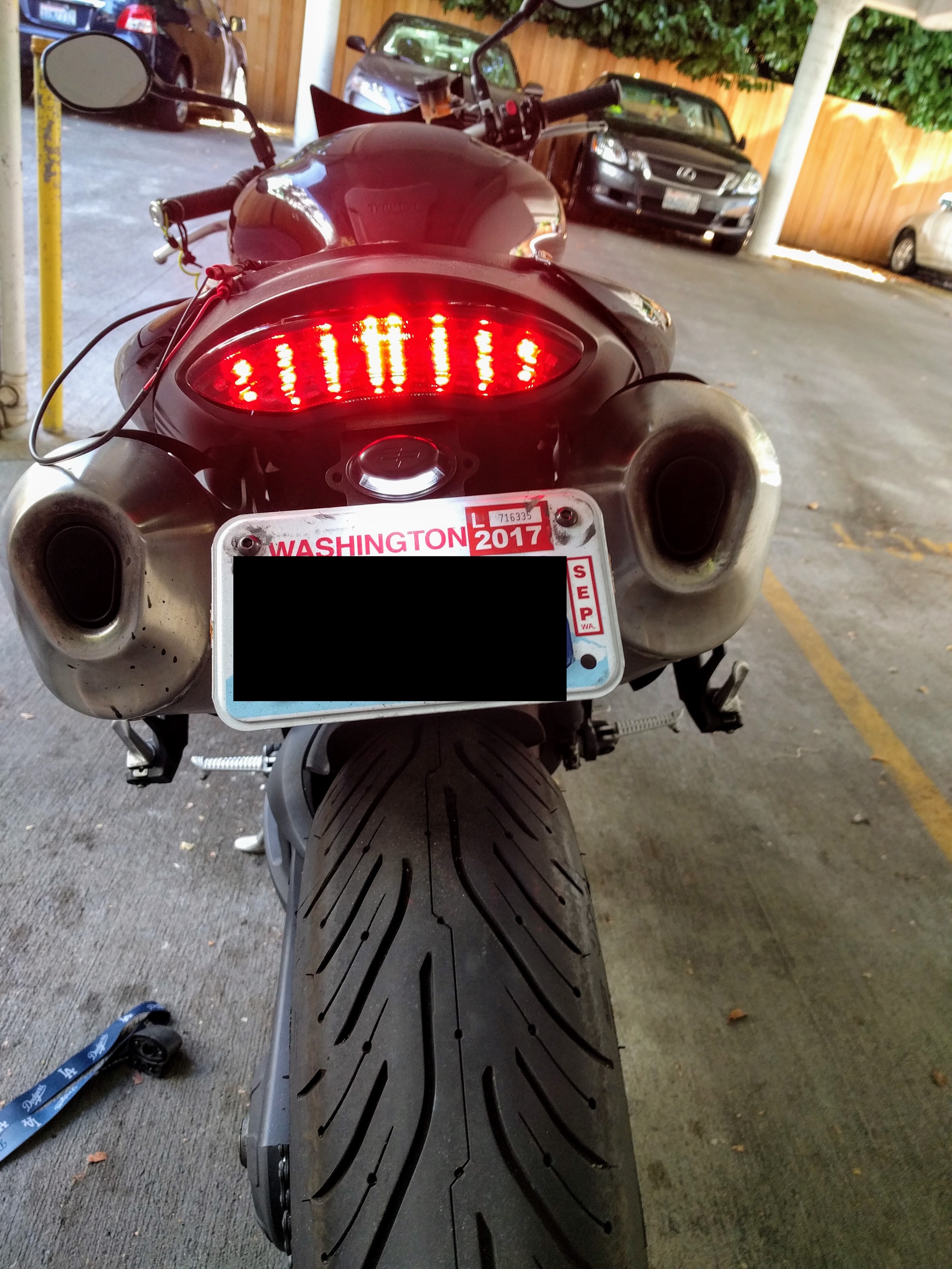

    I just fitted both the motodynamic light and evotech tail tidy. Both are really easy to install its taking everything apart thats a PITA. The number plate light is nice and bright but at least on my 2014 it gets covered by the plastic that goes over/around the taillight. The taillight while on is pretty bright even the smoked version probably lights up the number plate but I installed the evotech light as a better safe than sorry. The evotech light is just as bright as the one built into the integrated light.

    Over here in 'Merica we have the freedom to do cool stuff like this to our motorcycles haha. I only took one picture and no video but I can do more tomorrow when I have a day off.
    In rereading my post I realize what I said is a bit jumbled and doesn't really make sense. So the motodynamic unit has a built in number plate light and is bright and awesome but the OEM plastic bit that houses the tail light has a tab under it that covers the light. The taillight is pretty bright though even with the smoke version of it to probably light up the number plate with no problems but I don't want a fine so I installed the evotech light which is pretty bright as well. Both products are well made and would recommend. I think installing the integrated taillight is the easiest thing I've ever installed. I'll post more pictures and a video of the signals later.

    Thanks for the pic, look forward to the video, and as col C says it is likely to attract some attention from Traff Pol this side of the pond but it looks so cool

    Looks really neat, shame we are stuck with large pig ugly yellow plates over here.

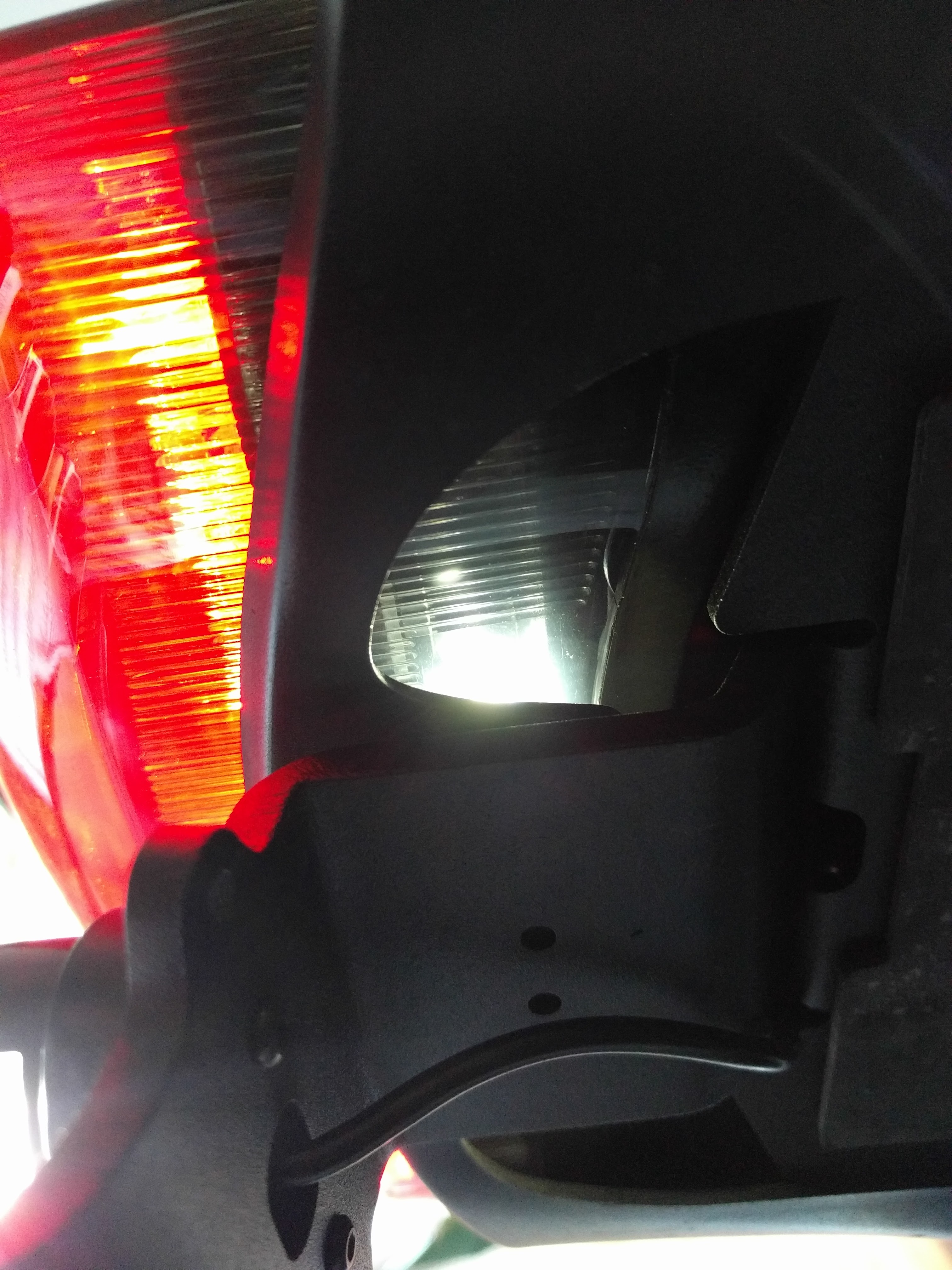

    Sorry for the delay in pic/video. So the pic is where the light from the integrated taillight is attempting to shine through but is covered up by the plastic/tailtidy. And the video which isn't fantastic quality shows the flashers/brake light function.

    Thanks for the pic and video
