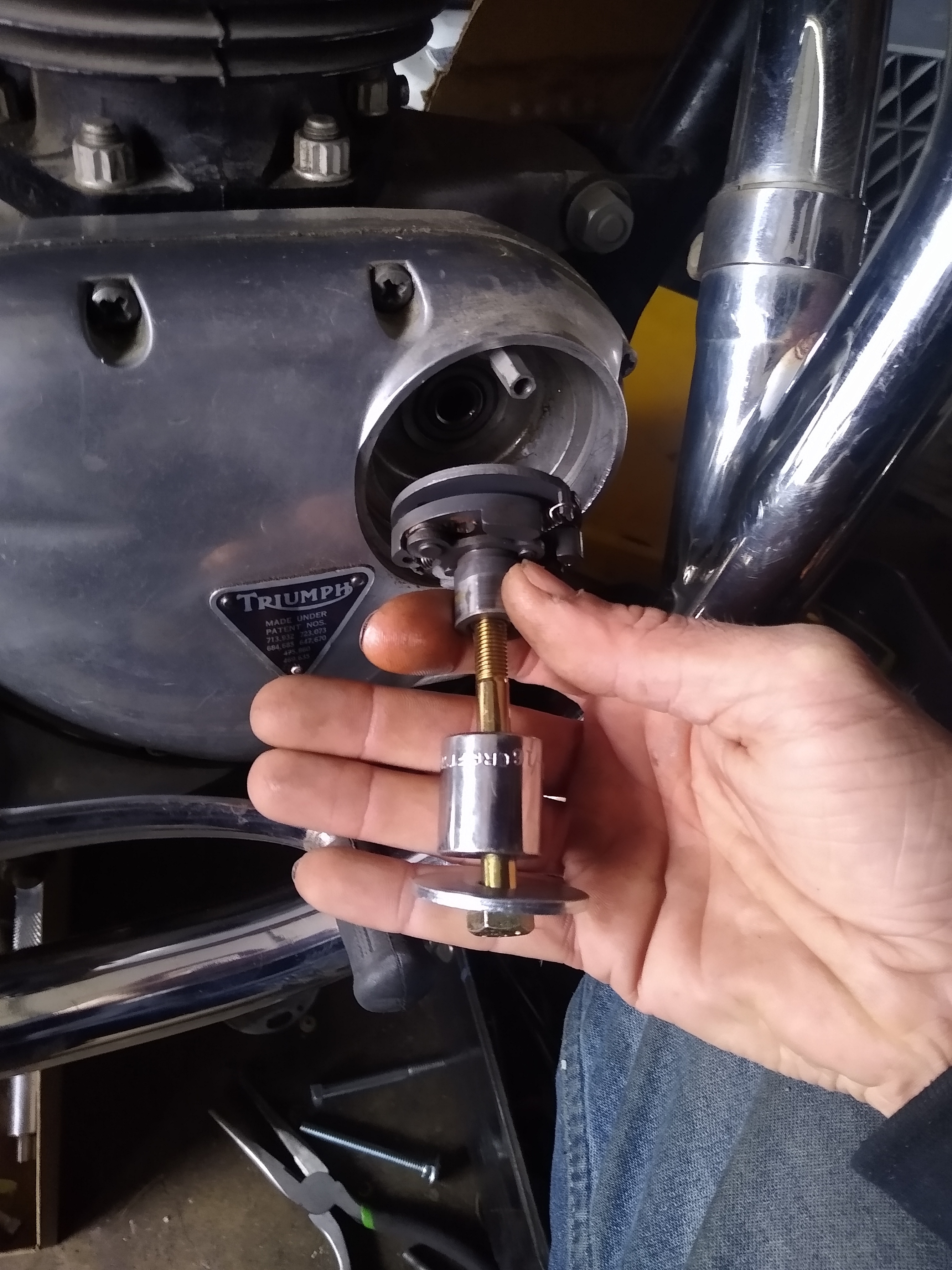

    you probably have the old CEI thread in the AAU. your 69 engine should have UNF threads, i would have thought, but earlier AAUs will still fit and maybe you have one.
    look through your boxes of partz. what you are looking for is a shouldered stud that supports the alternator on the other side, one of three. the stud has different threads on each end. one of the same age as the AAU should thread into it.
    once its in, grip the stud with a pair of vise grips and then give the vise grips a sharp tap tap tap from behind to break the taper.
    there may be other bolts in there that have the zame thread
    there are more brutal ways of getting the AAU off but try the gentle onez first

    I did dig through my stuff hoping for a slide hammer. No luck on that and I really honestly didn't know what I was looking for, basically anything that threaded in there lol. I just figured better to stop than screw something up. I'm trying to hold the record for longest Boyer ignition install. :)

    what lots of people do routinely is to carefully hold a piece of wood against the cam and then tap it sharply sideways with a light hammer. i dont like that because the AAU is tapered into the end of the exhausr cam and it isnt supposed to go sideways.but people do it.
    if its not super tight that should be okay

    Hell of a good way to start the day! Unfortunate part is now I have to go to work. :) Was just a matter of improper thread pitch. I'm getting better at this patience bullsh** :)

    they make an actual puller that pushes against the cam nose rather than pulling against the thrust surface of the cam bearing, but ive nevrer used one. often you can just thread in a bolt and wiggle it by hand

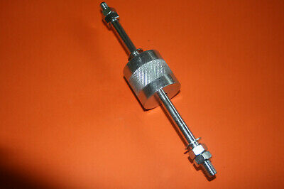

    Yes as a last resort i have seen that done :), i invested in my little slide hammer ages ago as i fit a lot of EI kits for customers and they often like to help out even if its only making tea and it looks far more professional when you pull out a trick little slide hammer to do the job.

    If you are stuck then a small length of smoothed down bolt into the advance unit onto the end of the cam and then reuse the bolt just taken out to press onto the inserted bolt. Tighten up and a little tap with a little hammer and off it pops. If not then tighten a bit more and a bit bigger tap with a bit bigger hammer. I have lots of hammers right up to a 14lb sledge, so this always worked.
    However, I did invest in one of these and it never fails to impress onlookers. But you mustn't say "watch this", you have to busy yourself with something and watch for them to be watching. Well worth the ten or so squids:
    And as it's got a different 5/16 thread, 20 and 26 (I think) it fits early and late and middle models :)

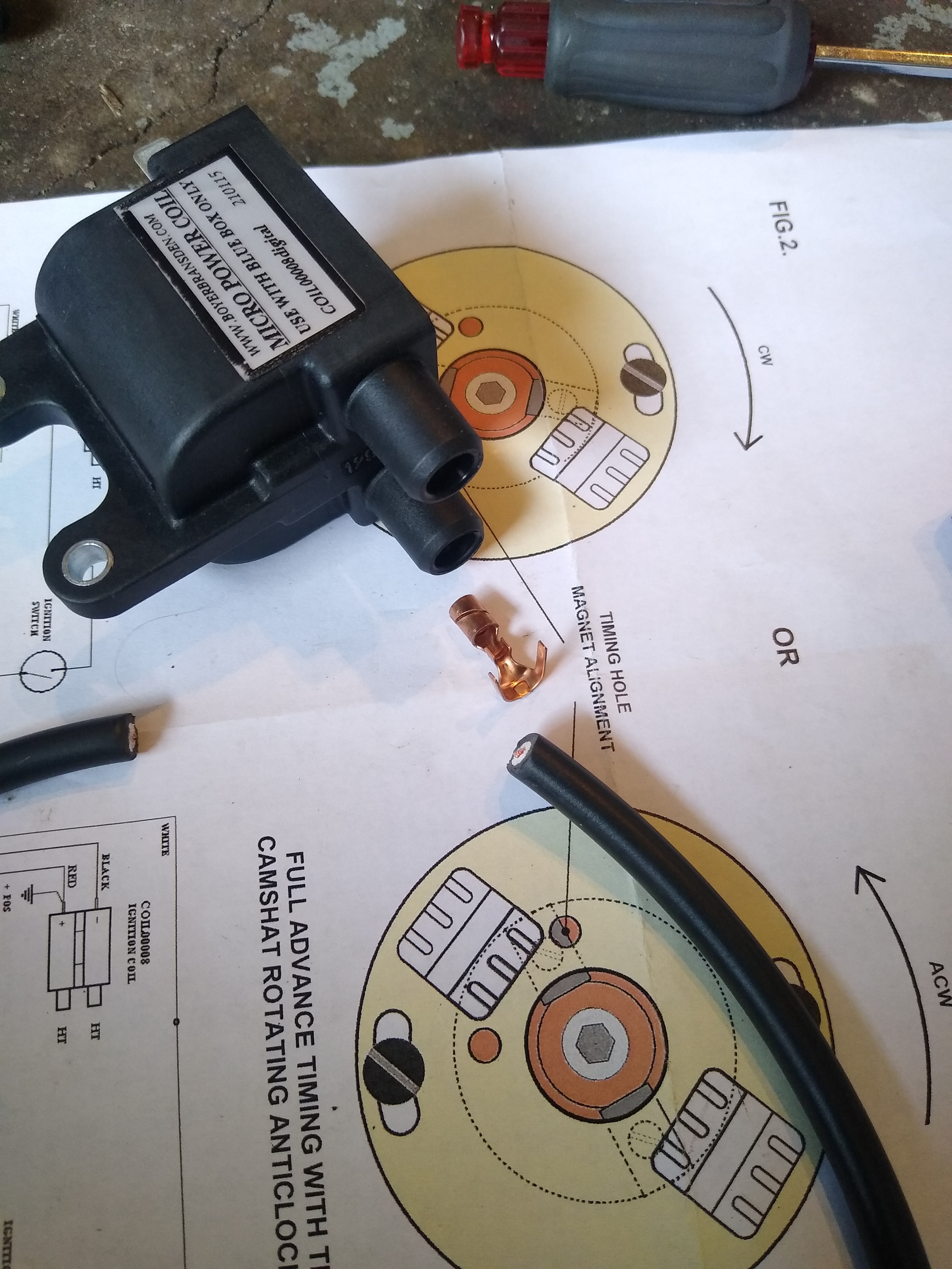

    Do I need to worry about the little tit that corespondents with the advance unit taper? The Boyer magnet doesn't have a taper. Doesn't seem like it's restricting rotation at all but wasn't sure. Nothing in the instructions at all about it.
  10. darkman
    7,660
    Not a problem with the new trigger plate spinner, just make sure the retaining bolt is not to long as i have had to cut them down an 1/8th in the past on some bikes as they bottom out and don't clamp the spinner to the cam taper.

    Never done plug wires like this. ??
  14. darkman
    7,660
    If you don't have a plug wire crimper find a local workshop and give them a couple of $ to do it or you could buy one at the worst :-( On a positive note the time out doing this is giving you even more time for that world record in fitting time :)

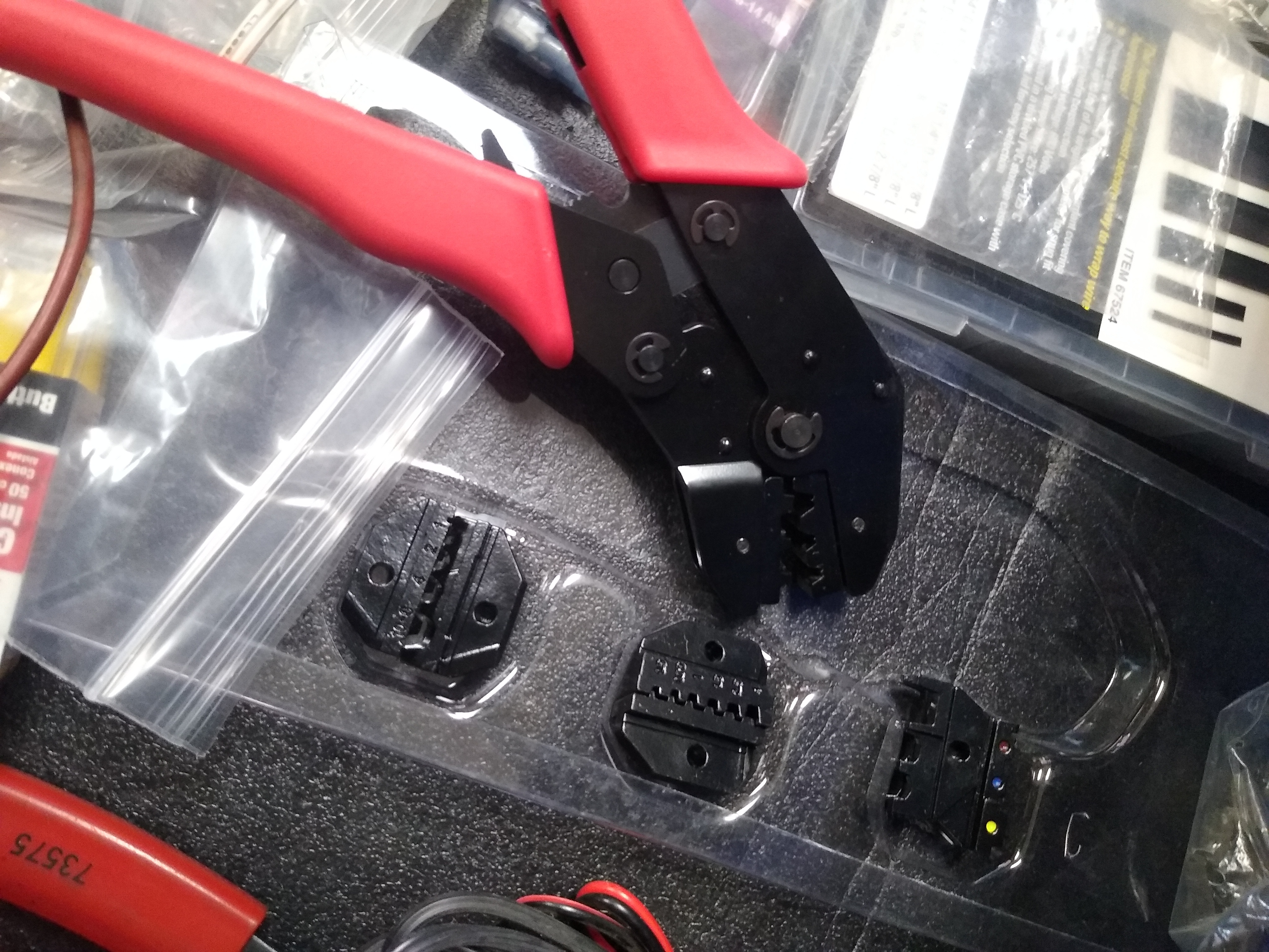

    Yeah I'm used to wires screwing into the coil but did some searching to see the whole cut back, fold over, crimp job. Found these crimps at work, should do the trick.

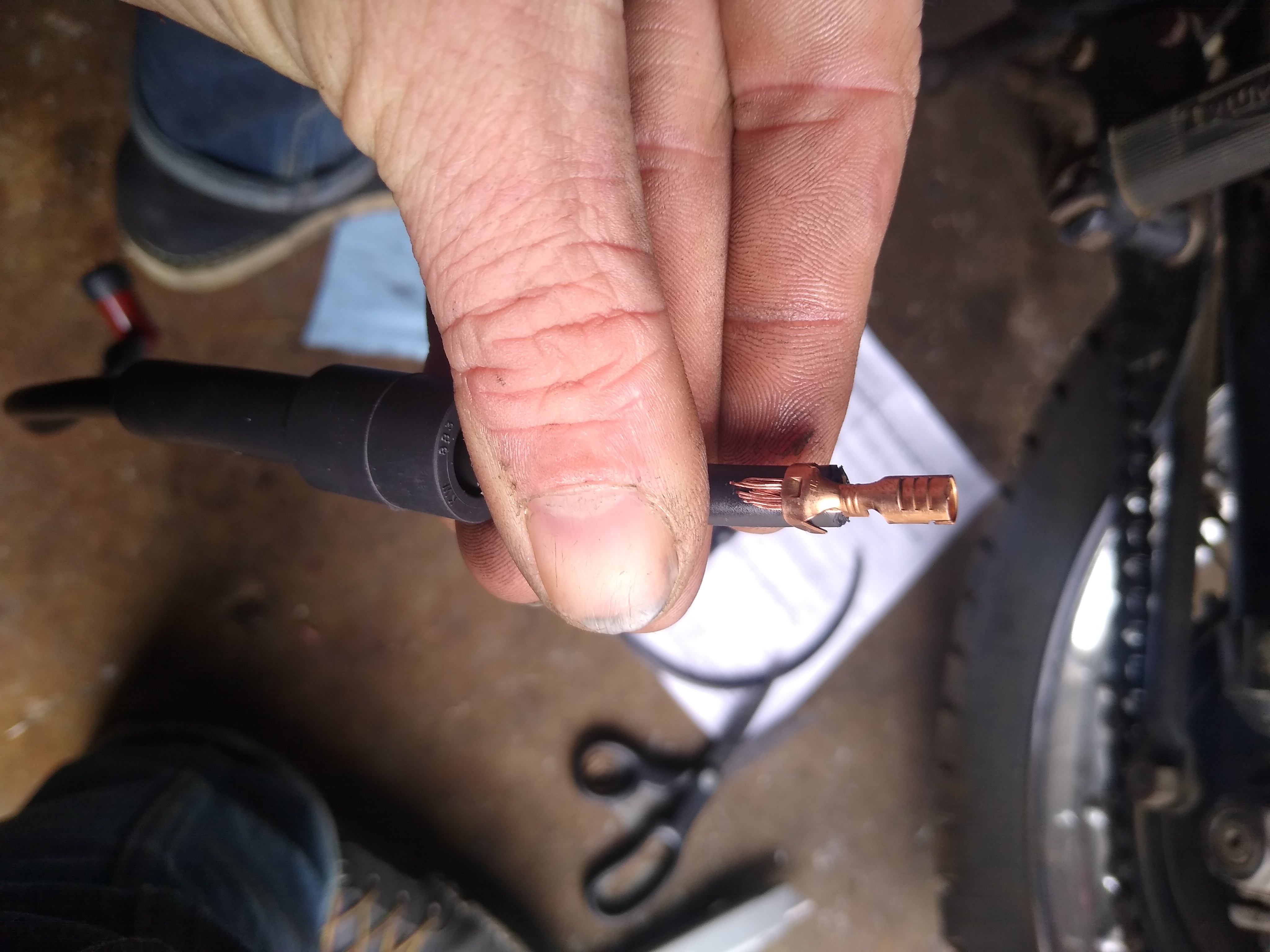

    I'm obviously not finished crimping but this doesn't look right? Just crimp, plug into coil and slide boot up or what? Maybe I should stick to Hondas and Yamahas. :)

    crimp those two bottom tangs tight around the outer insulation to make sure the copper part doesn't pull off. otherwise that's more or less it, primitive though it appears
    this is what you're aiming for, if your crimper will do it:
    put the boots on before you crip on the ends. otherwise you will end up saying bad words.

    Got it done buddy. Looks way better crimped and installed. Coil is mounted, not a show piece but it works. Actually a old coil mount I had in the bin. Blue box mounted on battery box now I'm into wiring it up. Stay with me I'll probably need you! :)
