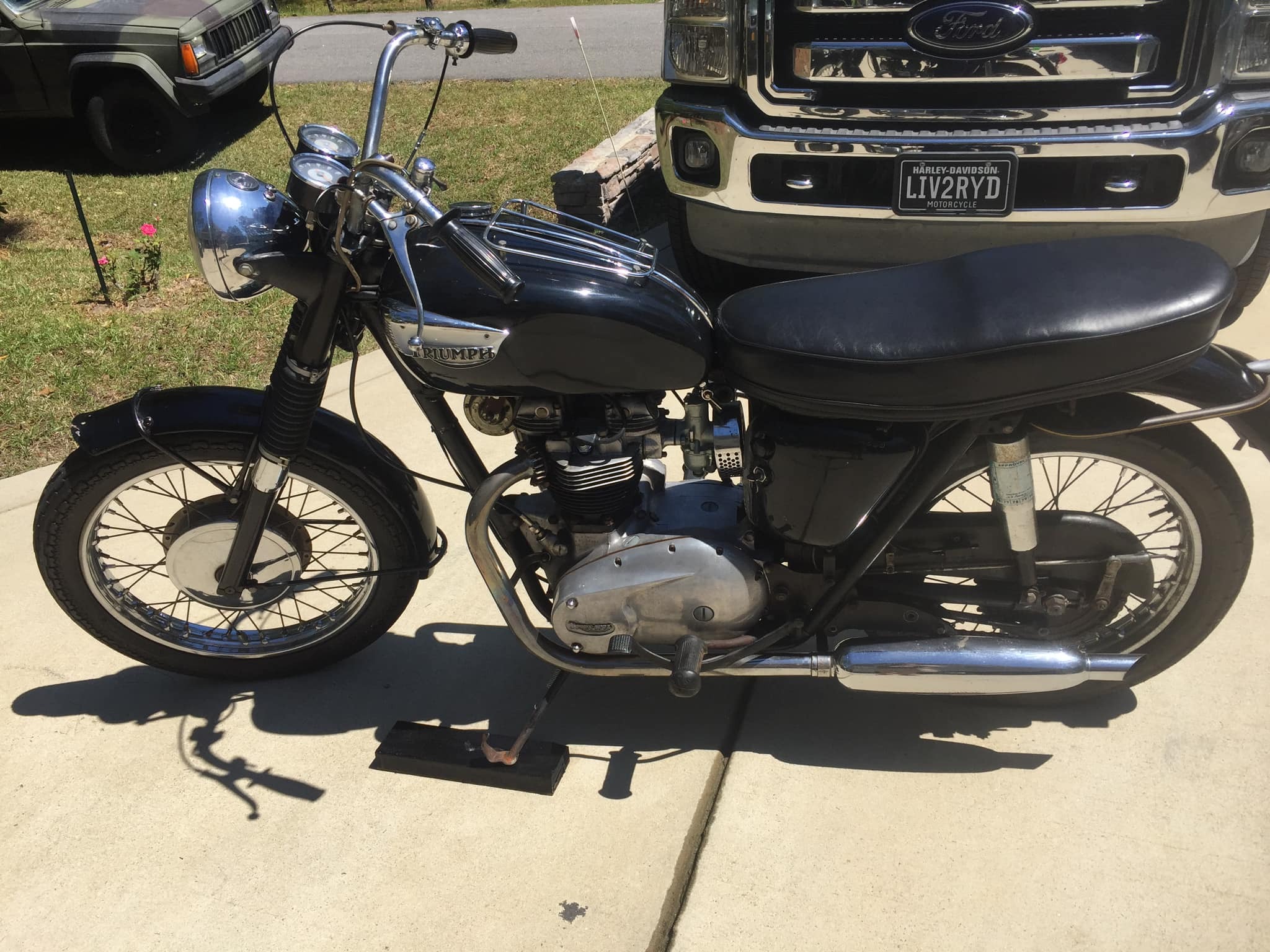

    Hey all,
    New to the forum and am here for some potential purchase advice. I have a chance at a 64' Bonneville for what I think is a good price. I've only owned Japanese bikes and really never thought I'd have an old Triumph but now that the possibility is there, I have to admit I don't know much about the vintage Bonnevilles.
    The bike is a 64, one owner bike, who was a British specific mechanic. Title, British specific tools and bike manuals included. Bike hasn't ran for about 3 years as the owner passed.
    What is the bike worth and I would appreciate any info/history/tech/things to look for. Thanks in advance!

    Hello and welcome HMC.
    First off, putting a figure on the "what is it worth?" hatpeg is a real hostage to fortune - ultimately it's worth exactly as much as you are willing to pay for it!
    In its current 'trim' it's a bit of a 'mongrel' - but not a dog! If it's genuinely registered as a 1964 bike then it's been modified in a number of ways - for instance, the TLS brake is definitely a '69 onwards fitment; the rear light, too, is (I think) a later item; the paint colour and scheme is of a later version. I can't make out the numbers stamped into the crankcase side and just visible in your last picture, but they will identify the year range if you check here :-
    https://www.tricor-andy.com/triumph-dating-information/
    The bike's 'market value' will be enhanced if engine and frame numbers match.
    It's obviously been fairly extensively modified - the finned points cover; rocker oil feed pipe and rocker cover caps are gloriously beautiful, period accessories - lovely! Maybe not so nice is the TR6 conversion to a single carb manifold! It's a Bonnie - it must have twin carbs., regardless of how much pain and angst you will suffer to keep them synched and in tune! Likewise the exhausts - a siamesed pipe in this country would scream "sidecar use" but hardly likely in Montana I'd have thought? Not so nice, either, the odd folding front footpeg - presumably a way to avoid crashing the shins on a hefty kickstart attempt. ;) Actually, I've just noticed that both front footpegs fold - possibly a sign it's had parts donated from a Trophy? And the oil tank filler neck extension/modification is practical but a bit unusual and positively NOT standard!
    I can't expand the images but, from what I can see, the mudguards (fenders) are probably aftermarket as they don't appear to have rolled edges.
    OK, so, this is all sounding like I'm trying to rain on your parade - for which I apologise. That's not my intention. If you want to restore the bike to its original state then you now have SOME idea of how much stuff you'll be buying and fitting to do it and, therefore, you have some negotiation ammo! In the final analysis, it's a mid-'60's Triumph and is, by definition, a thing of great beauty (and value). These are the very bikes that made Triumph a world leader in sales, technology and performance and are almost always worth owning, restoring and enjoying.
    If you want to see THE VERY BEST of restoration exemplars @darkman should be along very shortly with some pictures of his own unique and stunningly beautiful work.
    What's it worth? Whatever you can afford. Good luck with the purchase ....... I hope to see the resto. thread as it develops!

    I suppose that the best thing to do when you get it is to do quite a strip down of the bike and to see whats-what.
    As you’re aware, things perish and need replacing but going on the pics, not too bad at all.
    I'd definitely change those fuel hoses asap though first if you are going to ride it!!!

    Thanks for the quick reply guys. Awesome info. I'm not super happy to hear all the mods but I'm also okay that's it's not 100% original. I do know the guy knew his stuff and wish he was still alive to discuss why he made those changes. I enjoy the period correct changes.
    I guess my number one priority is the money I may potentially spend on it. I'd be selling two bikes to get this one. Are we talking 4000, 6000, 8000? It was listed at 8k which I felt was very high but I don't know Triumph values. There is wiggle room and I'm sure the seller will work with me when I can explain the state that is currently in.

    Hello HMC-MT are you in the US ?
  9. darkman
    7,661

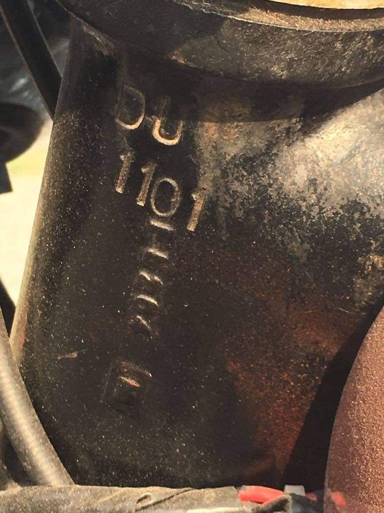

    Frame is 63-65 year only, pic of number would confirm. The rest is a 69 T120 inc engine that looks to be a re stamp ? need clearer pic.

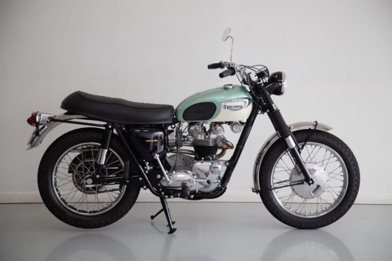

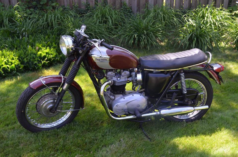

    I run a few groups specialising in unit Triumphs and have just taken 2 picks that are in our advert section at random, first bike offers on 6k US$ and second 5.5 These are original running titled bikes. 121005669_10158654906975242_4960682585577533350_o.jpg

    As its not original numbers or parts bikes like yours go for 1.5 to 3k max in the US and are brought by people wishing to make choppers or part them out, just out of curiosity what would your plans be for the bike ?

    I'm tempted by the (1970?) model in the second pic. - especially at 5.5kUSD!!

    Engine and frame number...
