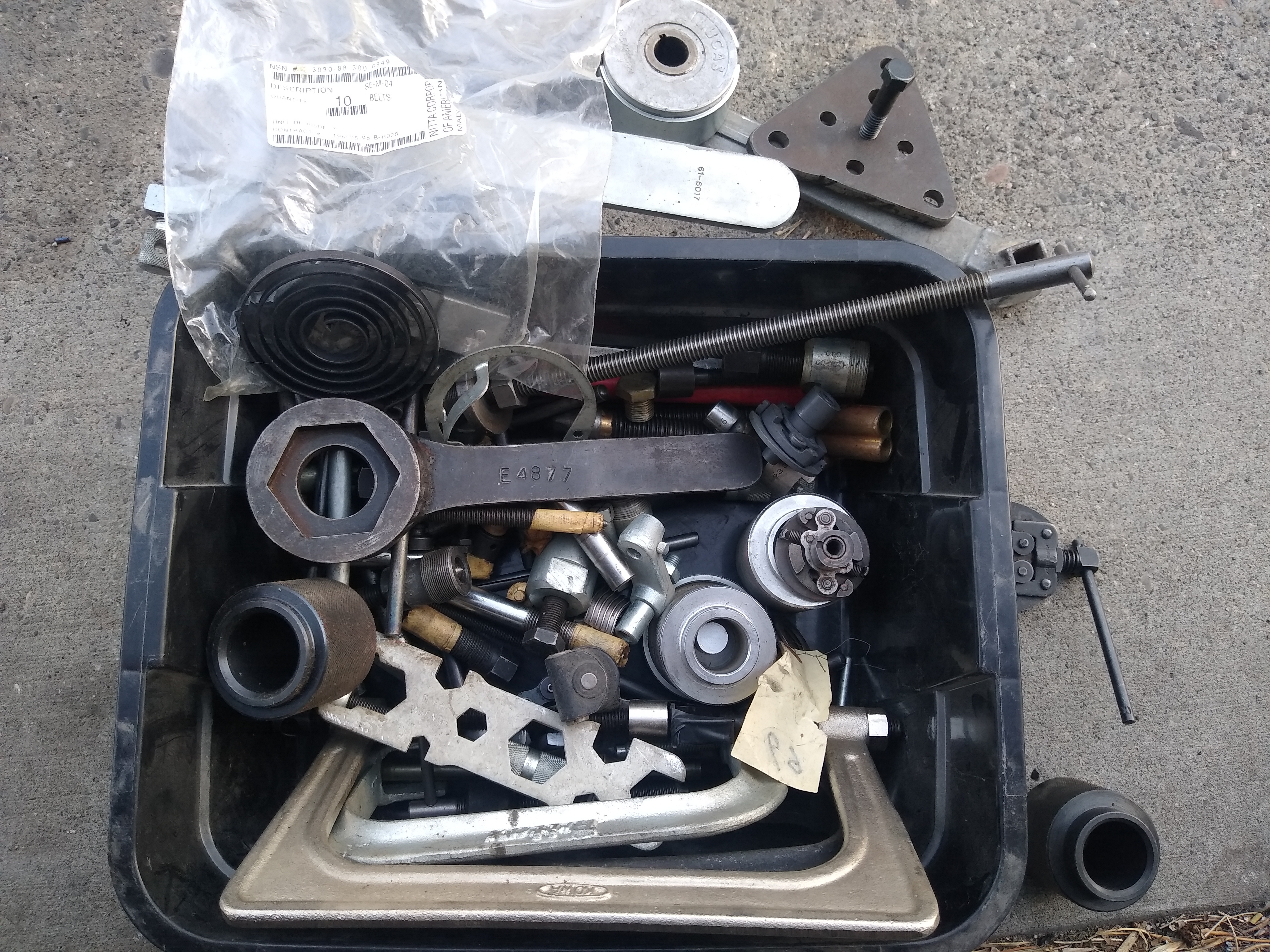

    well the tools are certainly comprehensive. you ve got pullers for the cam and crank pinions, gearbox sprockets, valve spring compressors, a fork tube puller, a seal holder wrench, clutch hub pullers, main bearing race remover, a tappet guide block drift, and so on.
    you also have two tools i've never seen before in the flesh.
    one appears to be the crankcase separator, possibly homemade, 6046
    the other is the removable timing ring, 2014
    there's lots of stuff in there i don't recognize. spread em out and take more pictures

    That's probably only half of what I got too. I'll be getting more pics and wanting to identify everything once the bike is running!

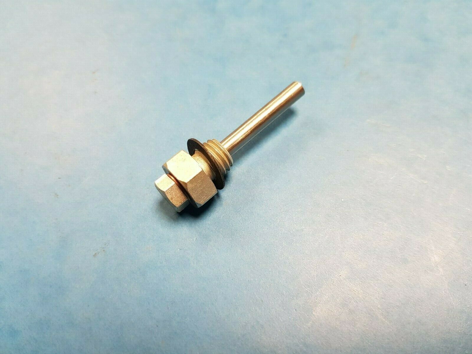

    Gear box drainplug is the small two part plug, main plug has a level tube for refiling level and the smaller plug that seals the tube, remove both and drain oil, refit big one with tube and fill box through filler plug next to kickstart, when oil stops dripping from tube fit the small bung. Removing the sump plug will allow you drain the little oil in the sump and clean the filter/gauze at the same time, wash with petrol the same as you would with the filter/gauze in the oil tank. Also the 69 engine has separate oil in the primary that is worth changing/checking.

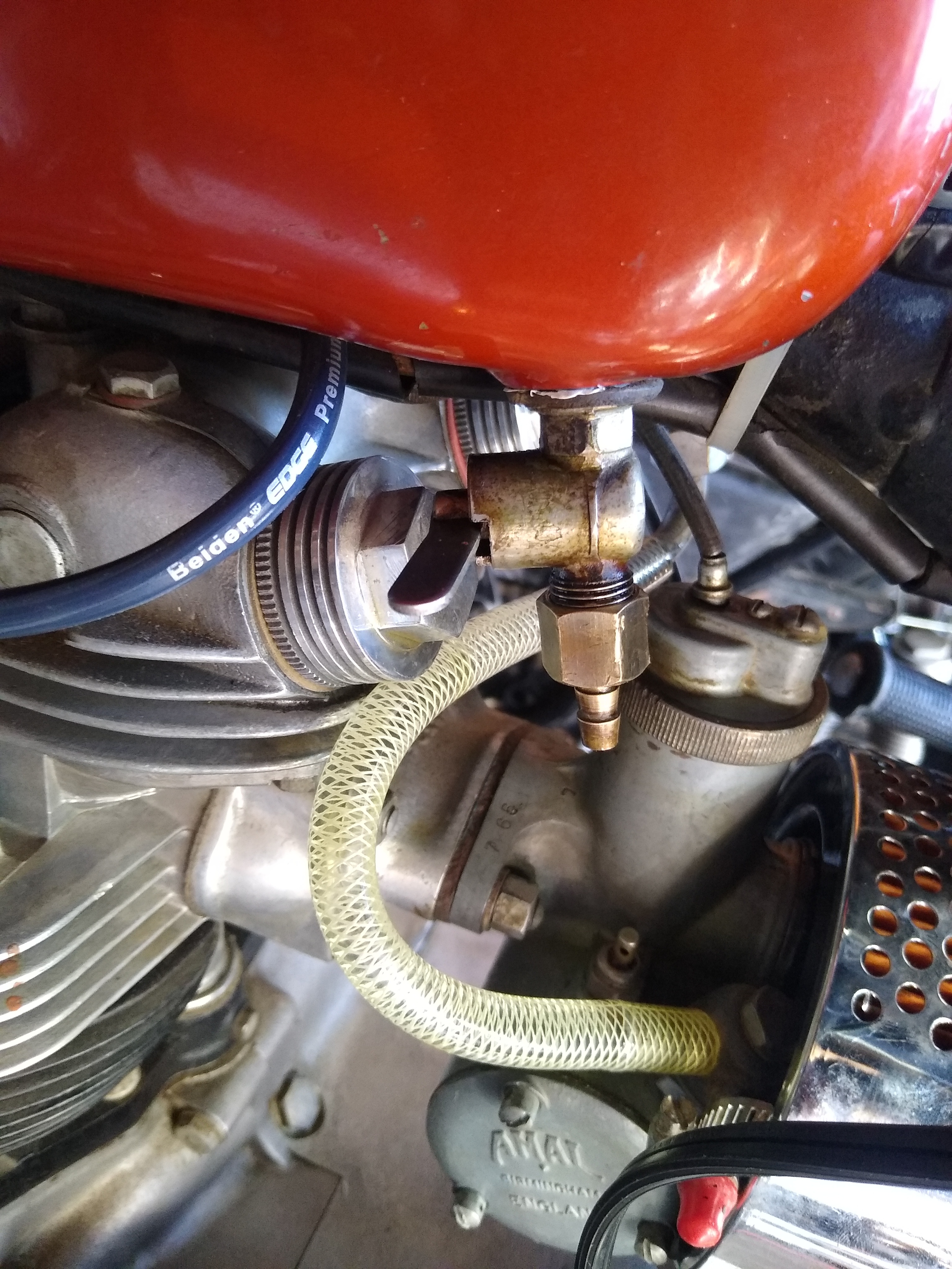

    Here are my "taps" aka petcocks haha. All this Brit verbage. :) The left side kinda weeps when on so I'm checking the parts stash. Right side I'm guessing is the one you're referring to. Just on off which again is strange to me as well as having 2 taps for one carb with 2 inlets. Do you only turn one on and them use that right side as reserve or how does that work. The cool things about this bike being so strange to me is it's like everything is new again! Very exciting times for me and suddenly I'm not as interested in all my Japanese bikes! Oh no haha. Gear oil and primary fluid after work and hopefully she'll live again!!

    Those are the correct Ewart's taps but one is for on and one has a riser tube for the reserve tap. Only by removing the taps from the tank will you see the difference as both have filters on them but the reserve also has a 2" long extension inside the filter gauze.
