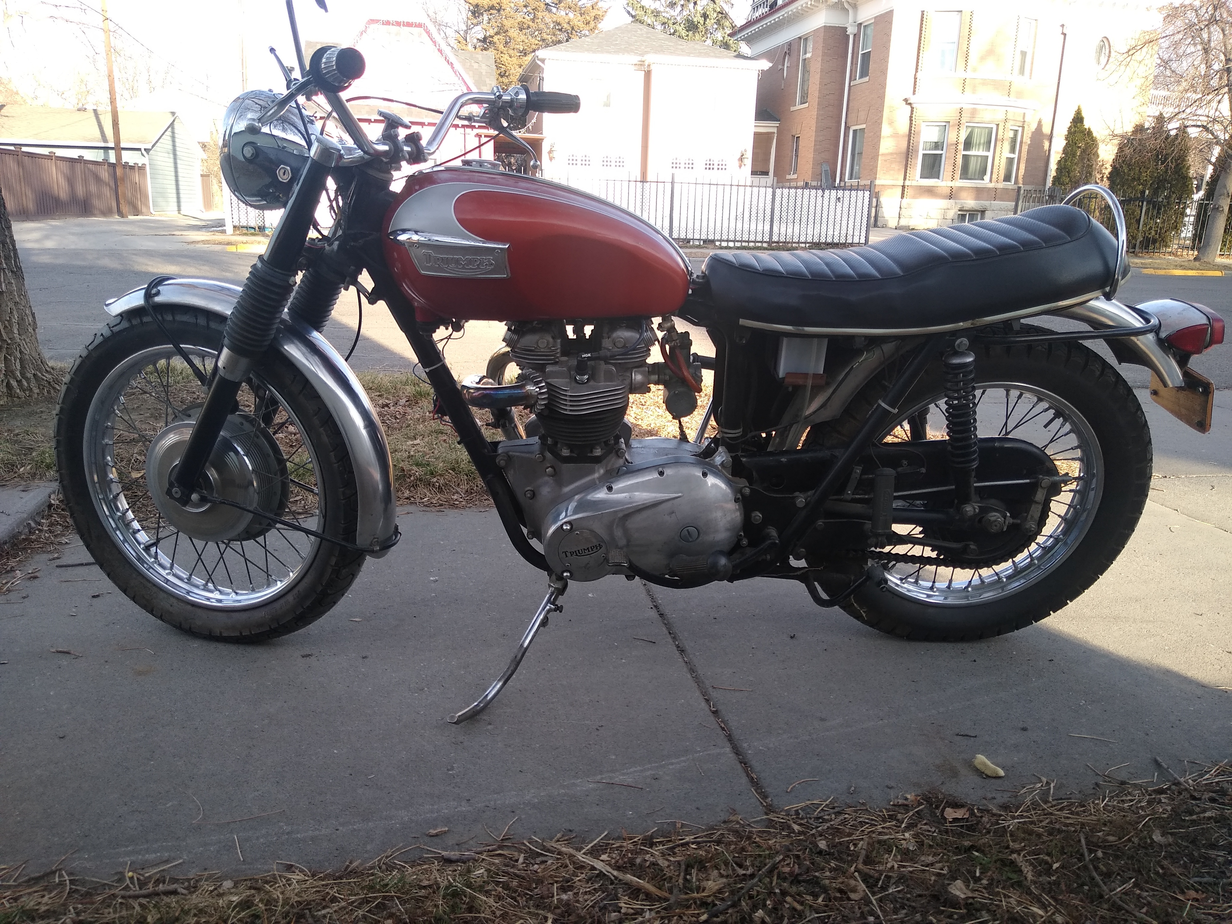

    DU1101 is a 63 model year bike and was the only frame to have the number on the headstock as the 64 model year bike had the numbers stamped lower down on the down tube part of the casting, also 63 frame should have different foot rests but yours has folding pegs from a later C model. Although the numbers on the cases look good they are copies/restamped as the cases you have are one year only production cases for the 1969 model year as are all the other parts on the bike, sounds like its had a great past but the simple fact is its its not 8k when you can by a rare fully restored C as above for 8 or less. Hopefully you can buy it for 2-3k and have some fun with it :)

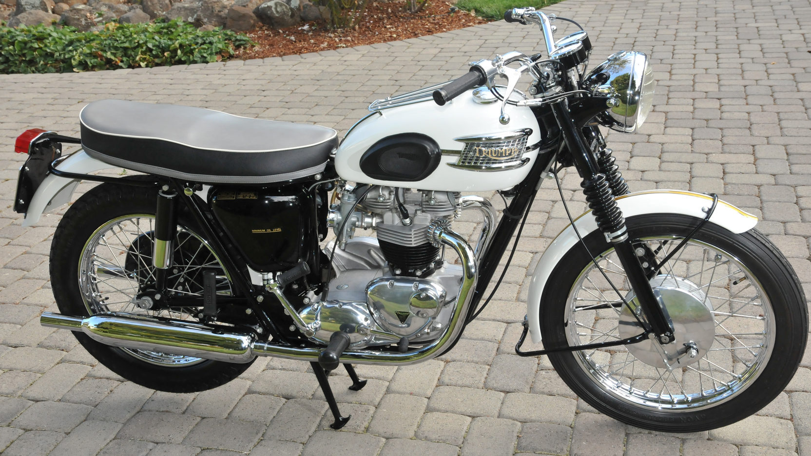

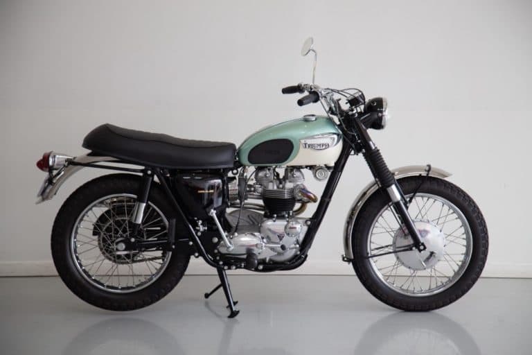

  3. darkman
    7,658
    A pic of a friends 63 T120 showing how it should look as standard for your reference.
  4. darkman
    7,658
    Because the engine in your bike is a one year only made casing, on my friends bike you can see the gearbox filler plug behind the barrels as early bikes had that and your 69 model year engine does not have.

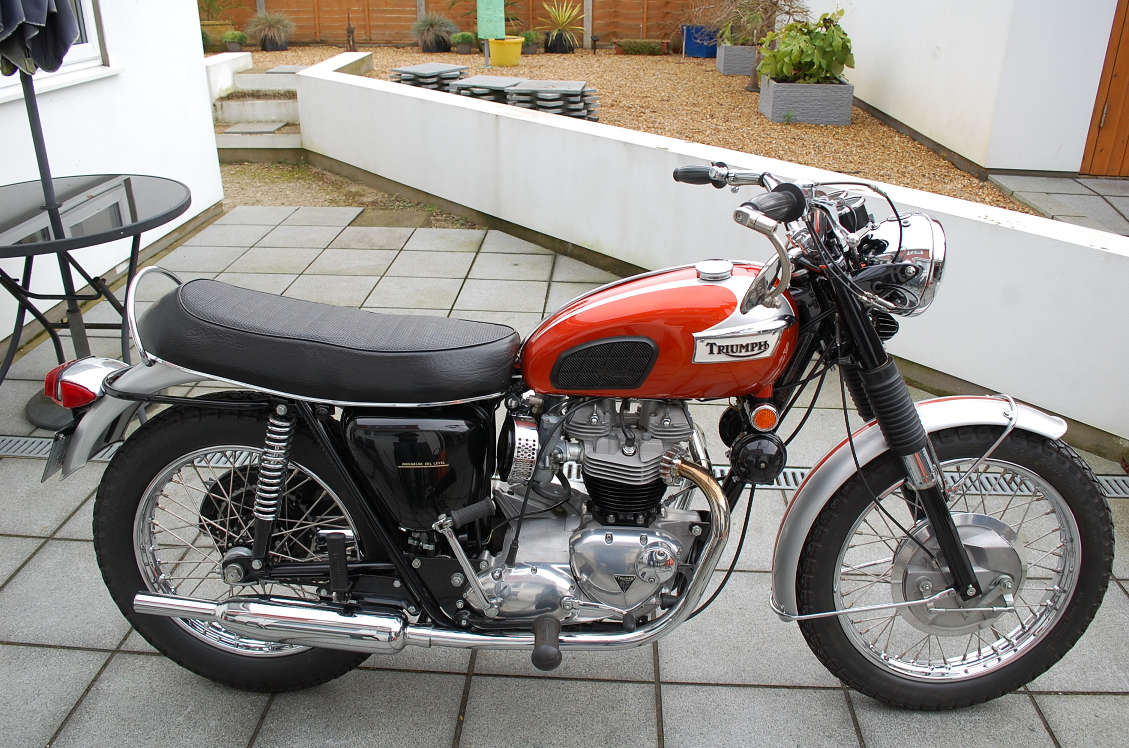

  5. darkman
    7,658
    Here is my 69 and you can see all the parts on my bike are the same as your bike except the frame :)

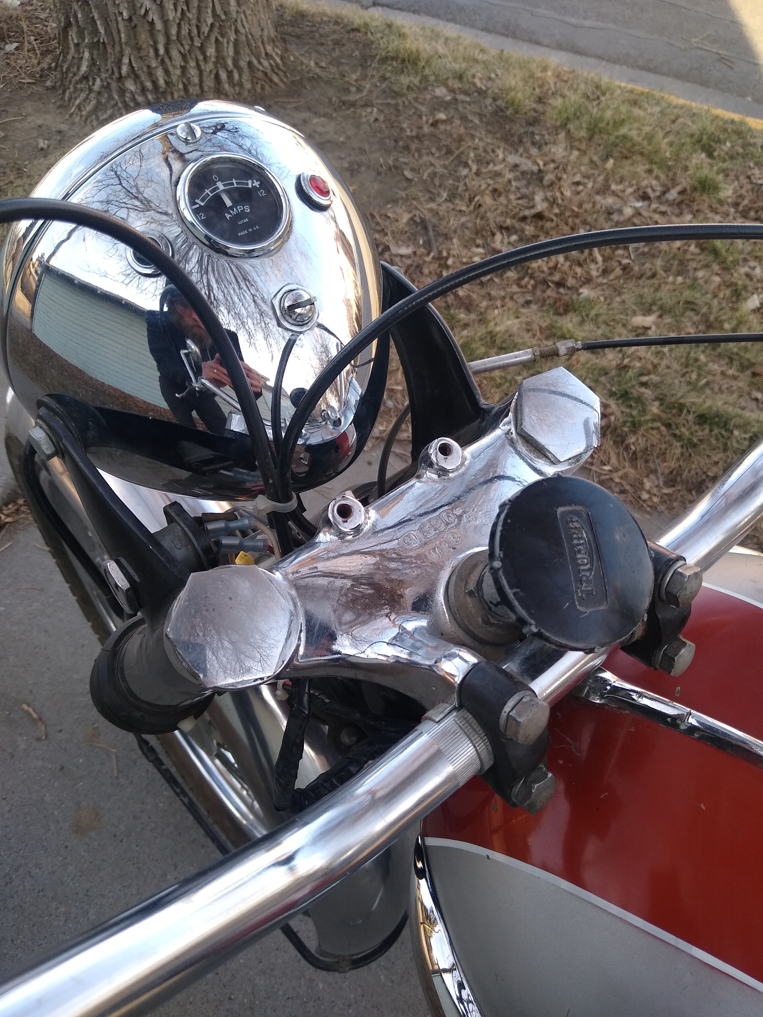

    What's up guys... I'M BACK! :) Months later this bike has come back into my path with a MUCH lower price tag and I'm traveling a couple hours on Wednesday to look at it. The price is right and I'd be getting a clear title, spare parts and all the British metric parts she has. The parts and tool haul sounds substantial. So, I wanted to revisit this thread. She also said the bike was bored out (by her British specific mechanic husband) to 750cc. I was also told about the level of mechanic he was by some peers. Again this would be my first Triumph so any info on what to look for when the bike is in front of me etc. would be appreciated. Also keep in mind I love the bike for what it is and am not concerned with it being 'correct' or original. I appreciate what he did and like the bike as is. It is not running but has been stored in her heated shop, engine not froze and was apparently prepped for being parked before her husband passed. Glad to be back on the forum!!

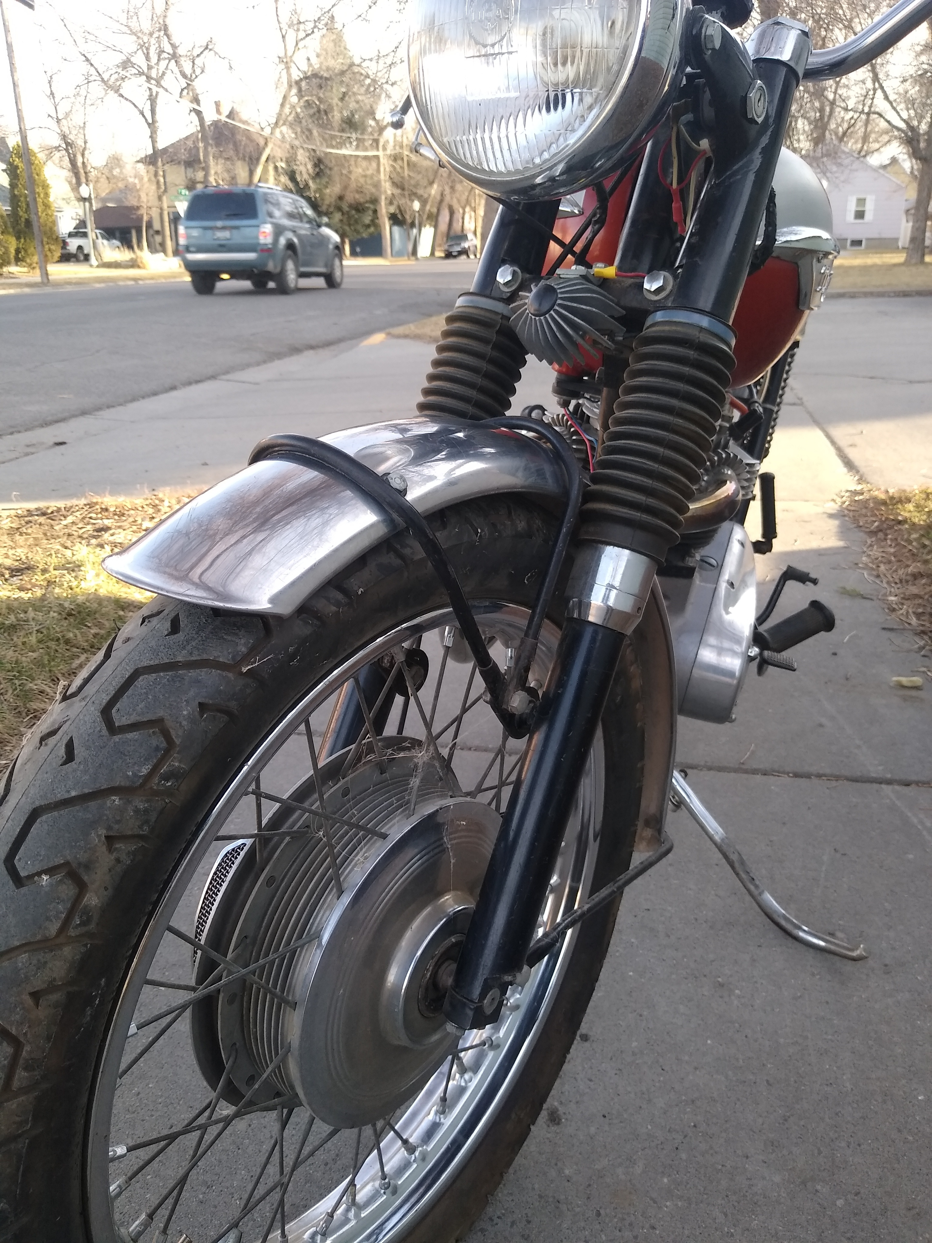

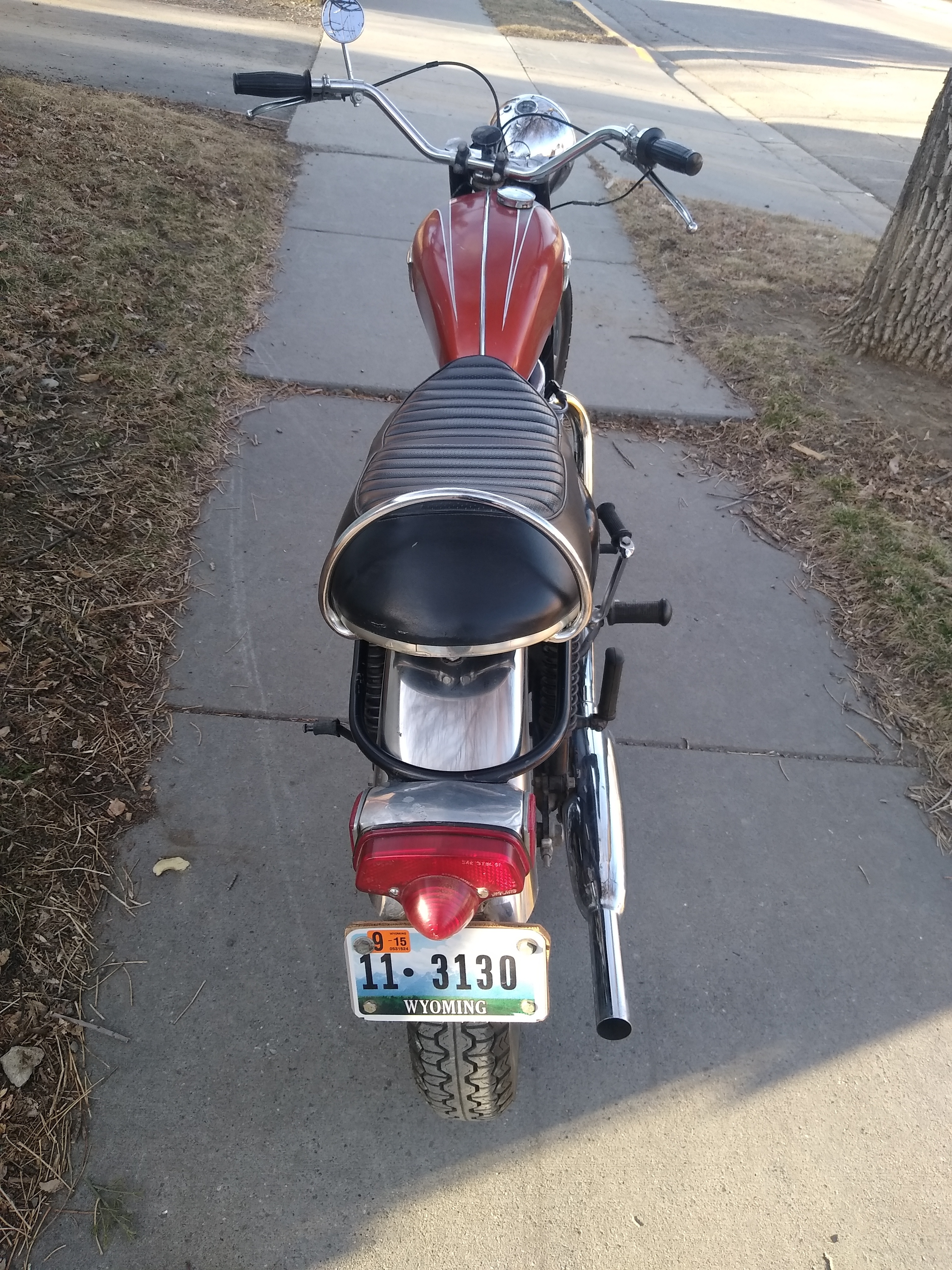

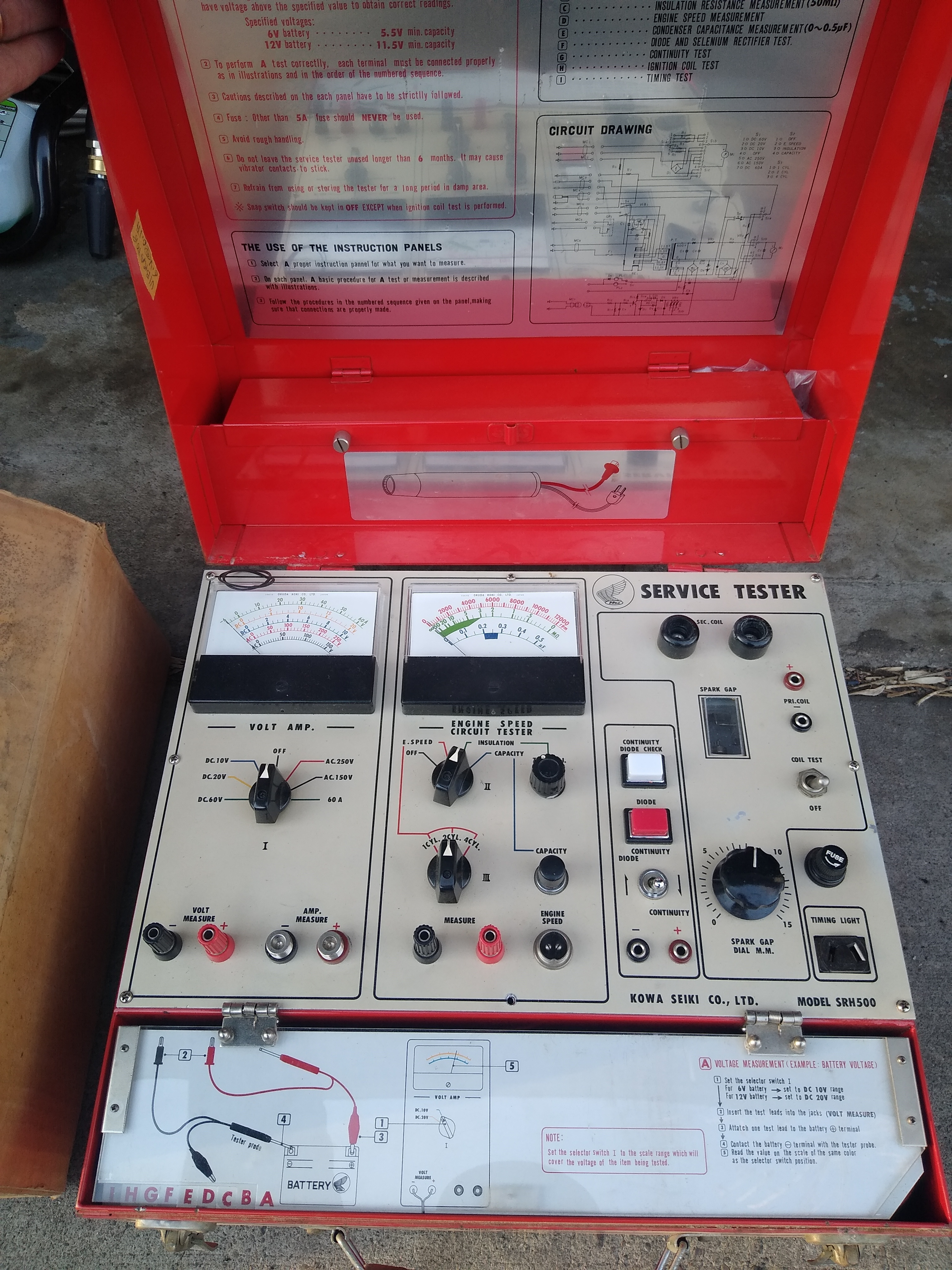

  20. HMC_MT
    HMC_MT Well-Known Member
    Nov 30, 2020
    174
    Billings MT
    Well...I got ZERO replies after my "Triumphant" return to the forum. Hopefully better luck with this post. I bought the bike and came back with probably 10 boxes of parts, manuals, vintage Snap-on BS tools and some amazing test equipment. For an awesome price. I couldn't be happier. Here's some pics...
