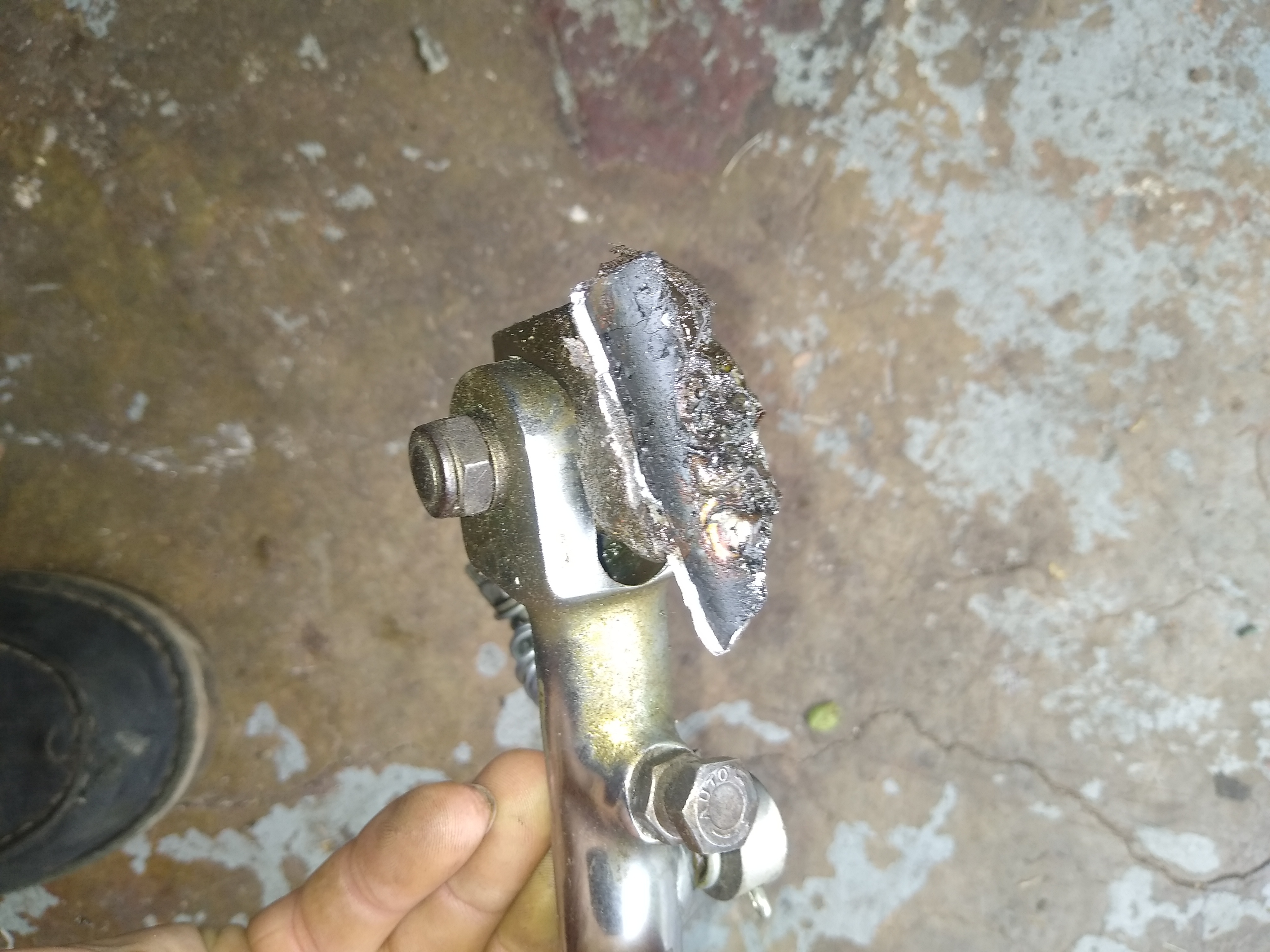

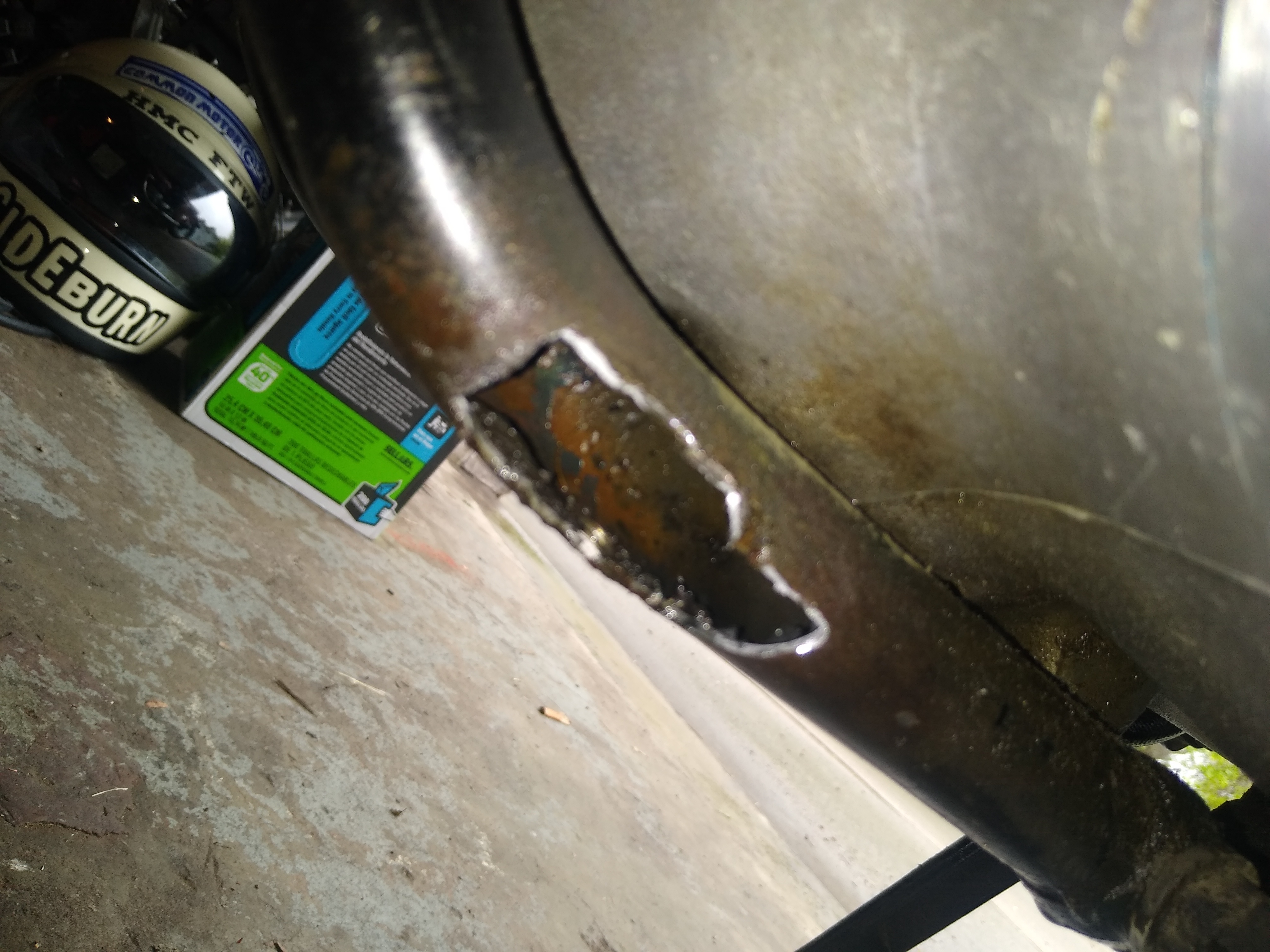

Disaster has struck. But I guess it could be worse. Went to work on the mutt, took her off the center stand and put on side stand. She kinda slowly leaned over almost to the ground. Feared the worst and sure enough
Out with the welder then. May be worth checking a few other areas though. Although it could be a previous fix that broke
It looks like exactly that! And a half ass repair too. Luckily my buddy is a genius welder. He said he could have it fixed in an hour on Monday! Will definitely be inspecting the whole frame. On a brighter note my carb is perfect and new throttle cable fixed my hanging idle no problem. Smooth as silk throttle and my beautiful Amal is DIALED.
