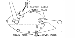

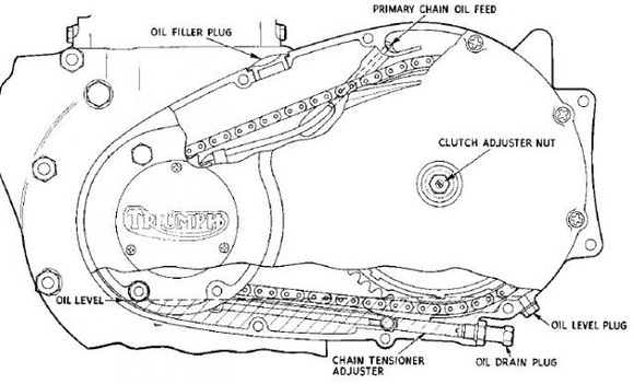

    It's fine, just check your levels in the primary and in the gearbox and go enjoy. Keep an eye on the oil level in the tank as you would with any old machinery. Go ride and make some noise.
    Here's the gearbox showing oil level
    And here's the primary cover showing oil level
    All pretty simple just use the correct plugs to ensure filling and levels and you are good to go. Enjoy.

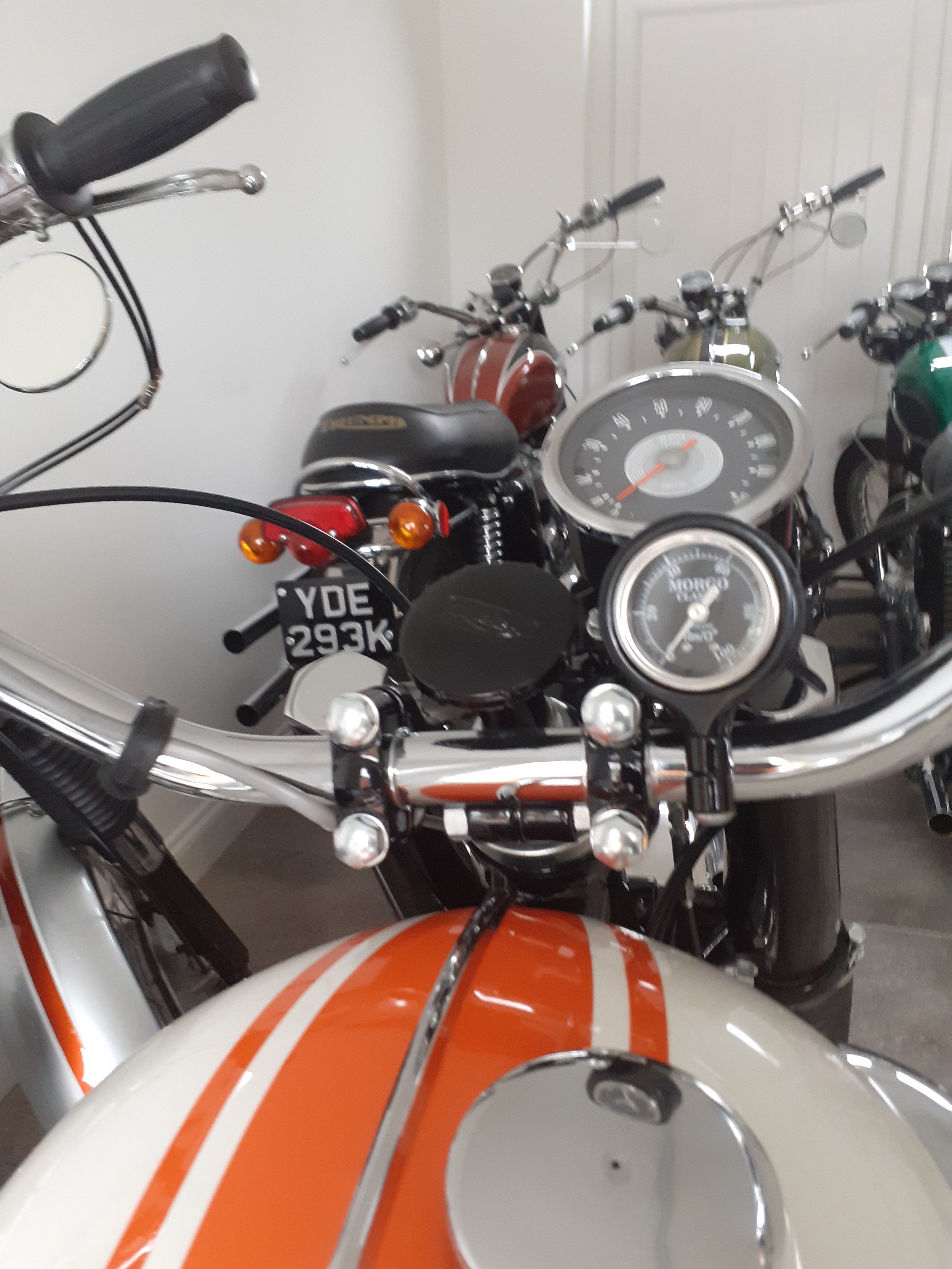

    I have a pressure testing kit for workshop use and i also have a Morgo gauge fitted to my TT that i can use/swap on to any bike should i wish to check oil pressure whitest riding on the road.

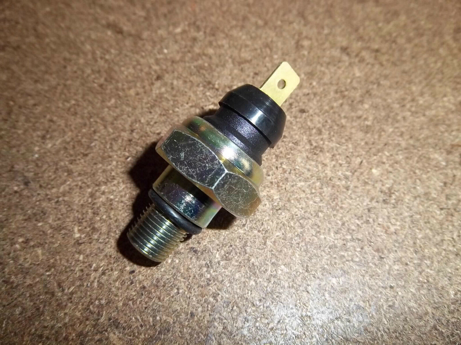

  14. Iron
    Iron Guest
    Yep, agree with Darkman. Some way to check oil pressure is a must in my book. I prefer a light, which is a simple fit. The switch would bolt straight in - take the bolt out at the bottom of the picture in the timing side cover (post #171) and install a pressure switch. Wire in, choose where to stick the light, probably in the headlight shell, sorted. Go make more noise.
  15. HMC_MT
    HMC_MT Well-Known Member
    Nov 30, 2020
    174
    Billings MT
    Got a link for those pieces by chance?
  16. Iron
    Iron Guest
    #216 Iron, May 16, 2021
    Look up t120 oil pressure switch for your model. There's a few types with different threads. Earlier ones have a tapered thread called a Smith's type, then there's later parallel threads of 24 or 26 threads per inch. Take your bolt out, it'll drip a few drops of oil, measure the threads and look up for a switch with thread to match. They are about a tenner each. I put it in with some plumber's PTFE tape as well.

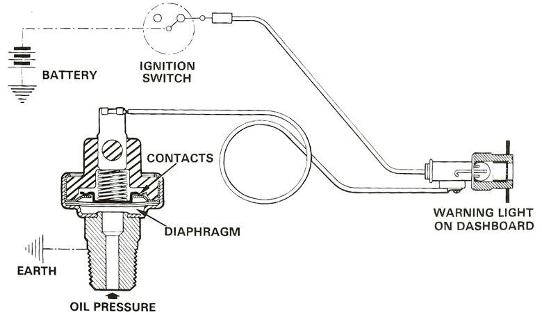

    Then a couple of wires and a bulb.
    Here's the wiring diagram. The light will come on with the ignition and go off when you have pressure.
