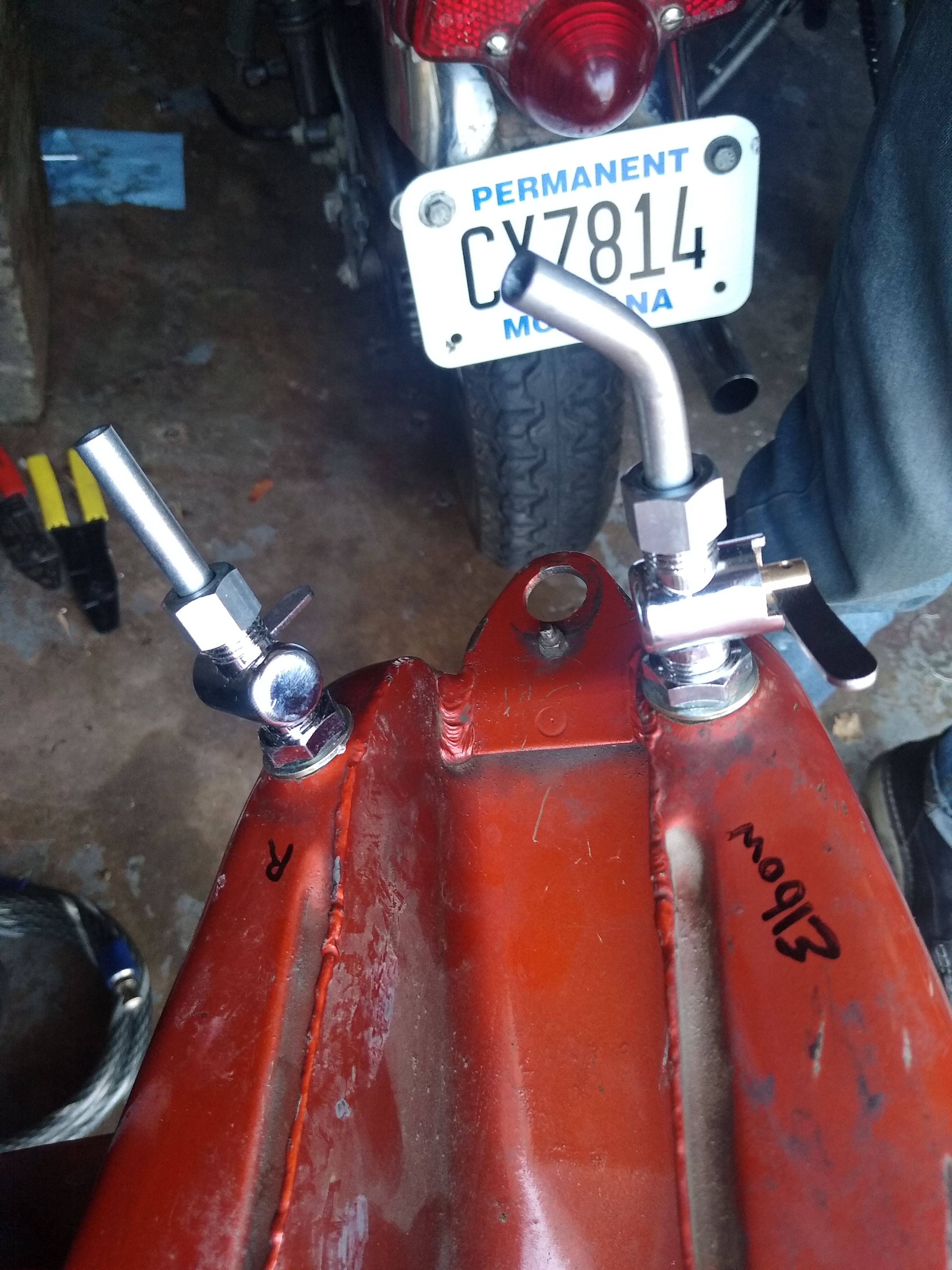

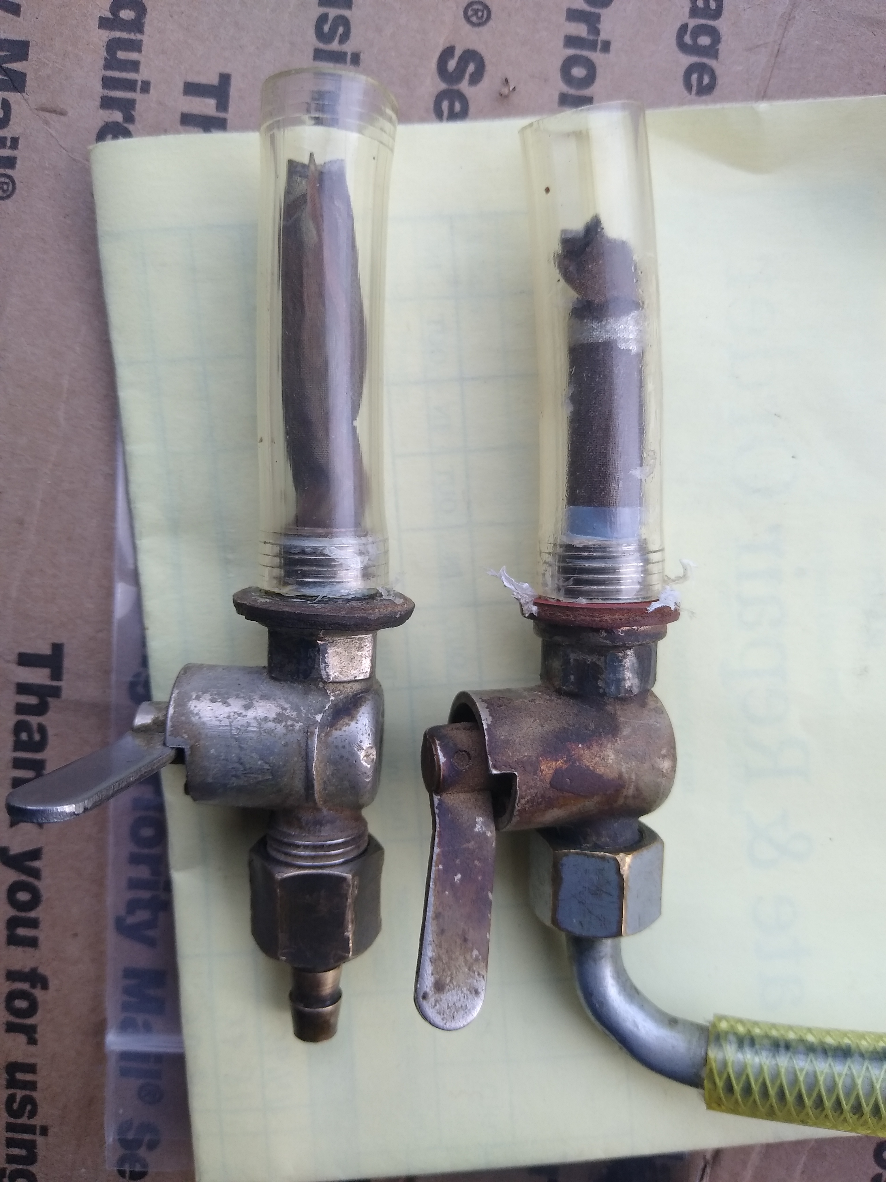

    Found two new fuel taps in the stash so was gonna swap those out with my new 2 into 1 fuel line fitting. Looks like the left side was reserve, one with elbow that you can tell in pic leaked judging by the length of the gauze filter. My two new ones don't look like either are a reserve tap. I'd like to have a reserve on left but not too critical. Thinking I'll just run what I have (the new ones)

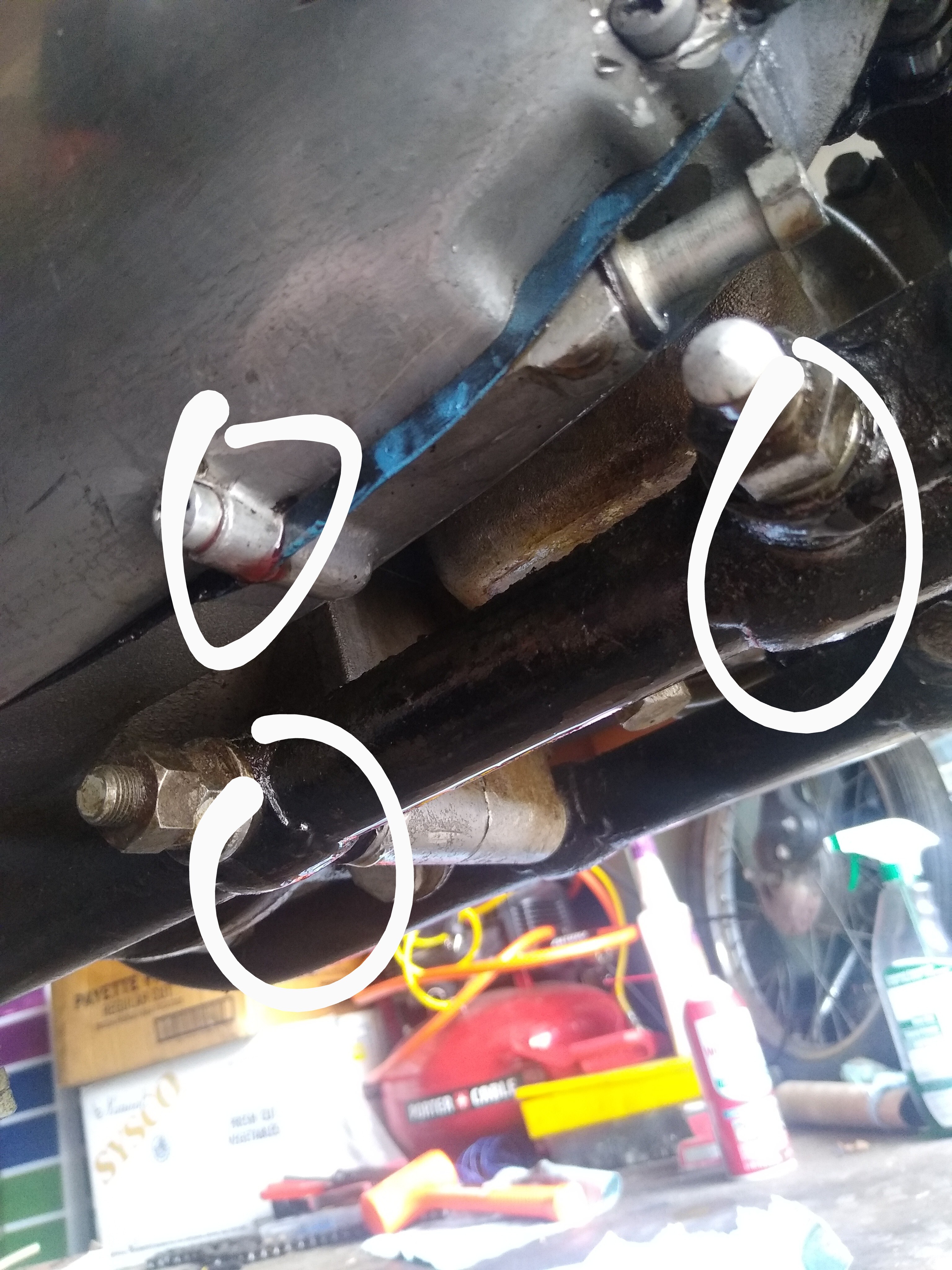

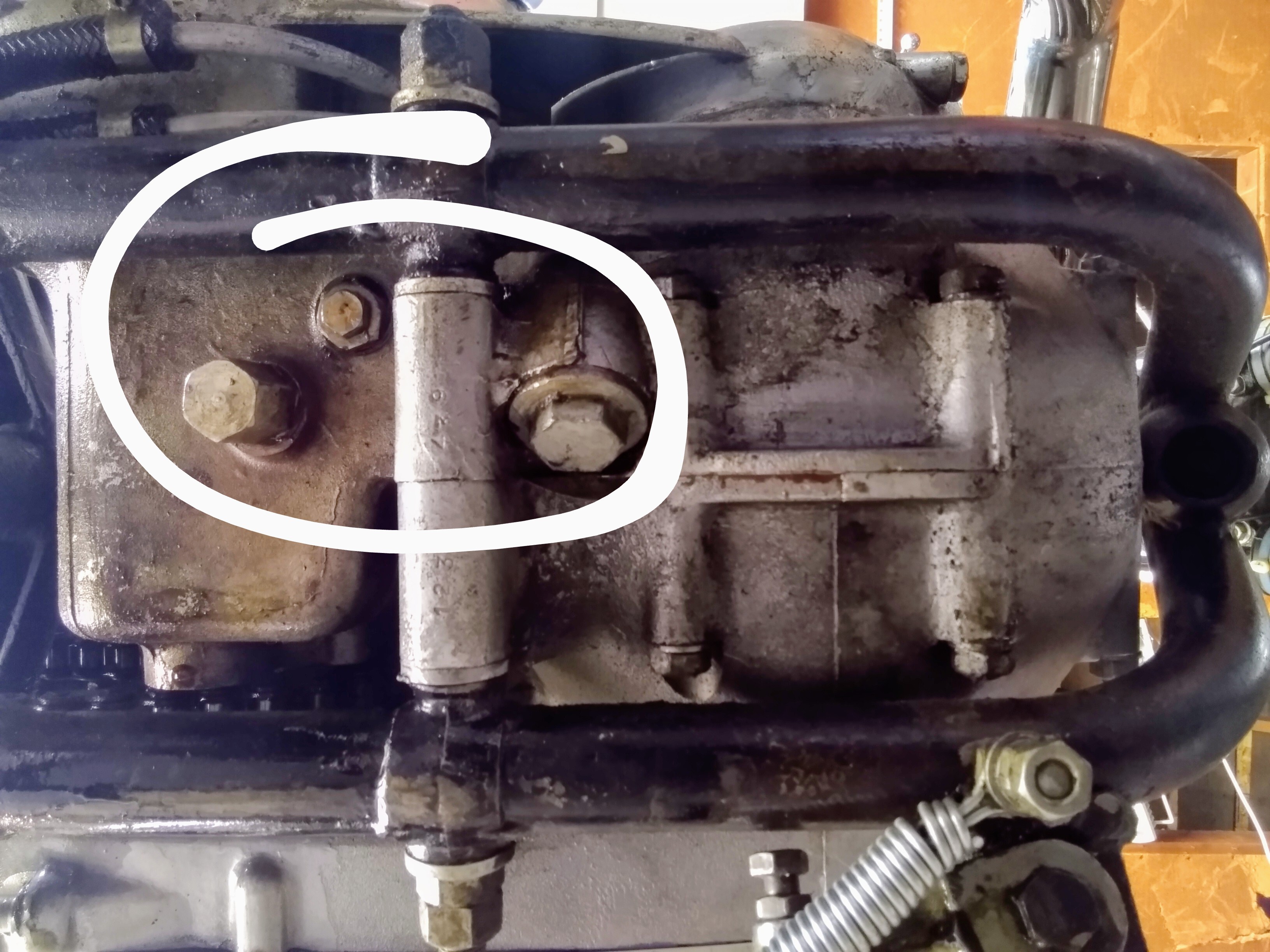

    The obvious one is ATF coming out the inspection plate. I had 1 of the 3 bolts missing which was a no brainer but since fixed that. There is supposed to be a gasket there yes? 1 drip spot accumulated at primary drain bolt but is oil, the rest is not so obvious. I do have a primary gasket in the stash so that's worth replacing. Gonna start by cleaning up the underside, go for a short spin then park and start tracing. Also see if it leaks less on the center stand.
    Here's some pics, first shows the spots where droplets accumulate. Second I'm wondering if this is my gearbox drain? I may have too much in there as I just topped it off. Also asking to identify what the 3 bolts are on the underside so I know.
    #195
  16. darkman
    5,158
    7,661
    The three bolts are detent plunger, holds spring and plunger, oil drain and level plug, remove all to drain or just small part to check level, followed by the big one that is crank drain plug and filter/gauze left to right. Oil leaking anywhere along the primary will end up dripping in that position as its the lowest, wipe it clean and determine if its the gasket at the front timing cover blowing back or the main cover gasket. In all fairness if you are just getting a little drop like that after a good run recheck rightness of bolts/screws and then live with it until you have to remove a cover for other work.

    Picture One - looks like it's a leak from the primary case and/or primary chain adjuster bolt (the long necked bolt in the primary case top right of your picture). The other drips from the frame could be leak from oil seals on the main shaft either on the gear box side (behind the front sprocket) or on the primary side (behind the clutch). Clean it all off and try to trace after a short run. Feel with your fingers up both sides of the front sprocket (the front of the chain).
    Picture Two - is the nut holding the outer gearbox case (it should be a domed nut) it's not the gearbox drain.
    Picture Three - the large long bolt on the left is the gearbox cam plate index plunger. Essentially a point on a spring that slots into the cam plate at each gear. The cam plate is turned when you use the shifter which moves the gears into the correct position, this plunger holds the cam plate in position.
    The smaller bolt in the middle is the gearbox drain plug and level tube. The gearbox is filled through the slotted plug above the kick starter (as shown in your picture two). Once filled it will spill out of the tube held by this bolt. You'll get a drop or two through this when you get out there and bomb around in the future.
    The large bolt on the right is the sump plug. This is where you'd empty the sump and attached to this is the crankcase filter. Inside which is the scavenge tube that the oil pump sucks on to return oil to the rockers and oil tank.

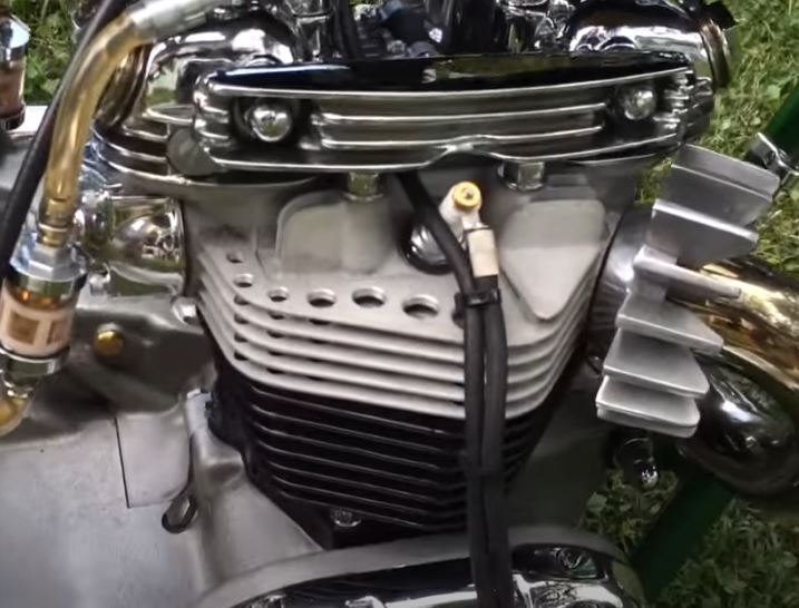

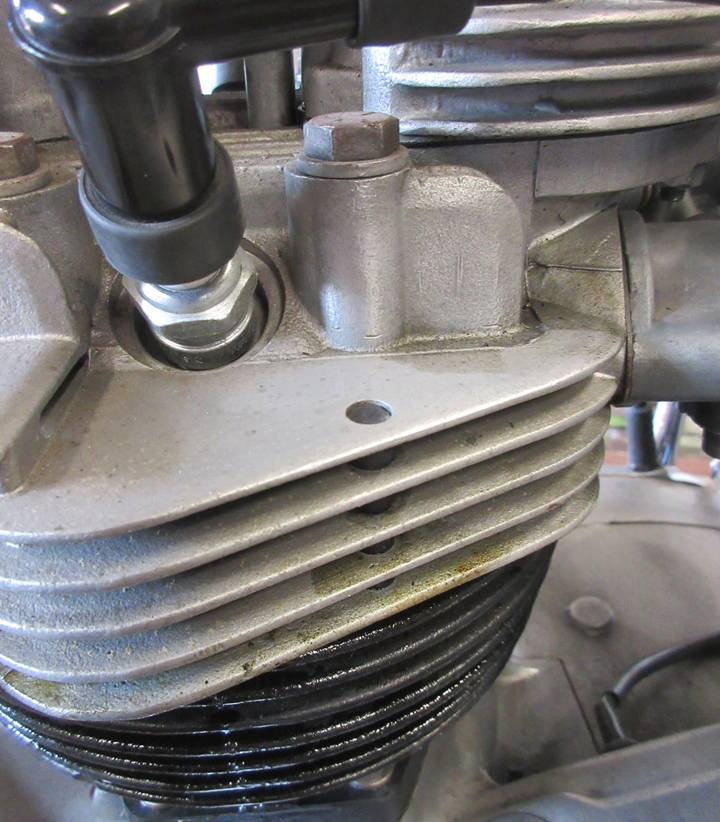

    is tha hole driiled in the fin on the head?
    #198
  19. Iron
    Iron Guest
    T140 10 stud heads originally came with a rubber dowel insert that travelled through all of the fins, I think Triumph tried everything to lessen vibration. I haven't seen any heads with the rubber still in for ages. I can't think that it helped much.
    I have seen heads drilled with rows of holes that look pretty neat, this is a nice detailed green digger (I don't get/like diggers but a nice bike). Not mine by the way.
    Sorry, way off thread :expressionless:
