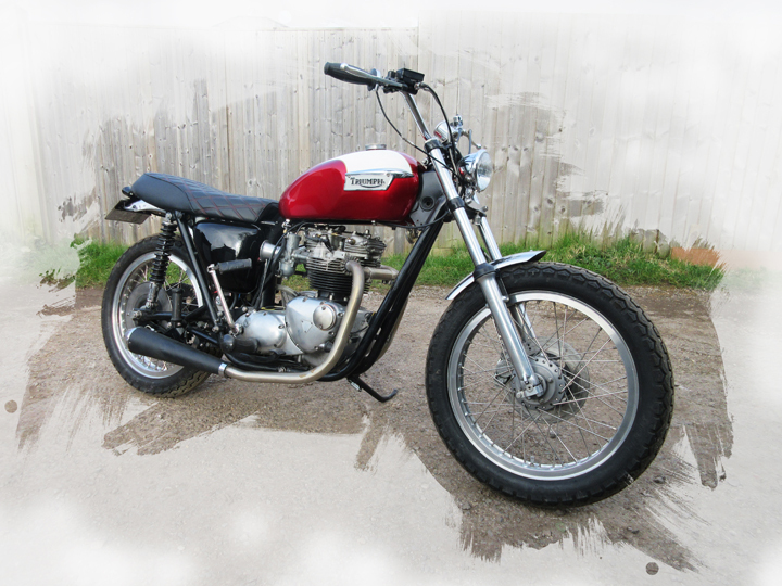

    Found an arty whatsit on photoshop so thought I'd stash the picture here for posperity...porputary....postuariry....postoperation...post sumthin...:neutral:...while it's still clean and before I start getting to it again with a spanner. Those zorsts will have to change, too skinny back tyre, and I don't like the muffler things, the seat is too big, I think I'd like a trackmaster tank.....

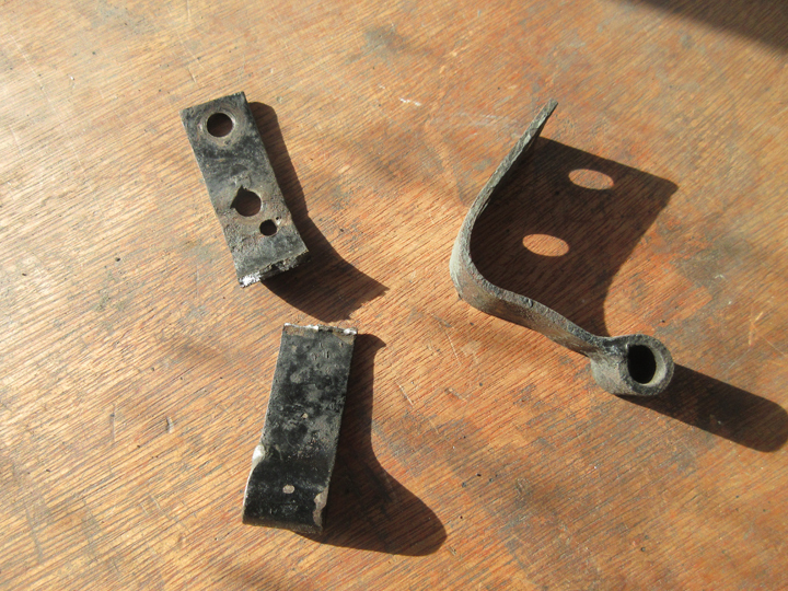

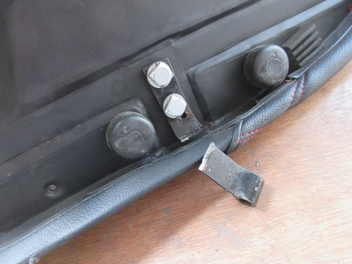

    Well, a couple of nuts loosened off that I hadn't tightened properly (the rear lights/number plate and the clutch lever pivot) and a couple of leaks sprang where they shouldn't be springing. The back brake needs sorting (although I did put on a new master cylinder) but it's the one with the calliper on the bottom of the disc so perhaps air. The PO had put the new thinner seat on, which is quite nice, but I assume came from a country over in the East. So the brackets broke and I'm not that bloody fat. They look pretty rough so I'll make some new stainless ones.
    A bit of fettling to do then. Another reason or three to lock myself away in the garage then. Living the dream, living the dream :)

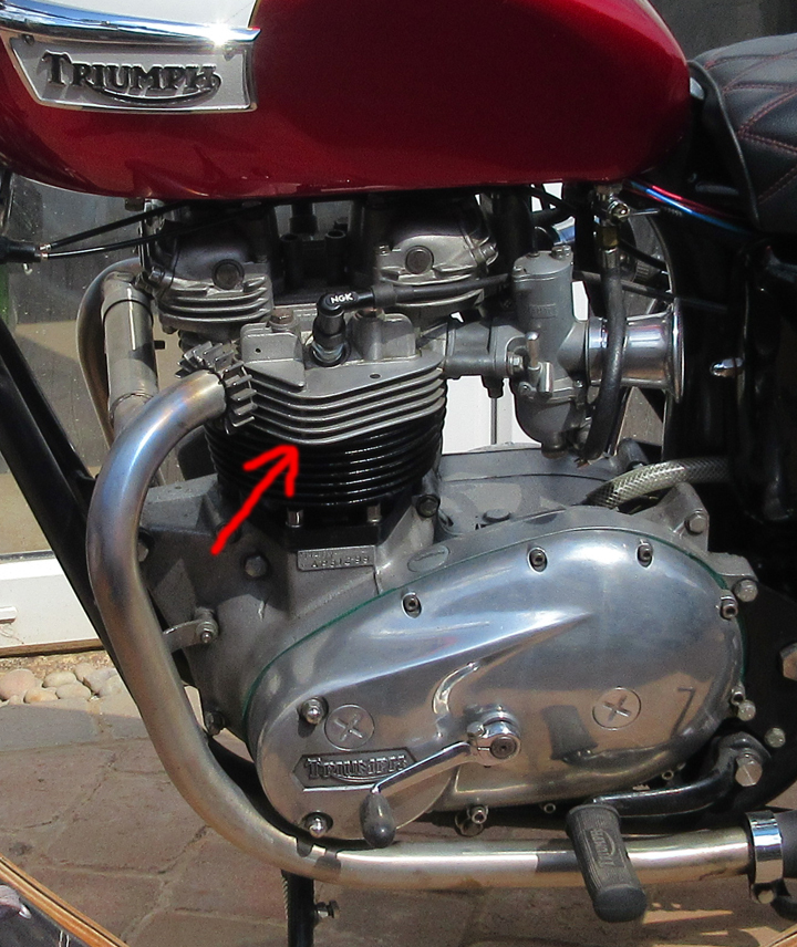

    Put some more miles on the clock since rebuild and have solved a few issues. However, I like a tight motor so have been tracing the drips as they just get on my nerves. It pulls and rides well, I really like this one.

    The third, and it's quite a big one, looks like it's coming from the head gasket ?? I originally thought it was the front rocker cover but it seems not. So I've sat in the sun and had a contemplate but have really just scratched my head about it.

    The leak seems worse when the bike has had a run (it's only had two short 10 miler ones since rebuild) and the oil cascades from the bottom fin on the head down the barrel fins onto the the primary. It also covers the bottom fin on the head but that is probably just running to cover the hot head.
    There's no evidence of the oil running from the rocker cover that I can see, so I thought it was the pushrod tube top leaking and somehow running round the zorst (cause I wonder about these things while not actually near the bike). Nope.
    Only leaks while and after a run so maybe oil running down the front inner head bolt and escaping past the head gasket???
    I'm obviously going to climb into it to check by removing head etc but I'm honestly not sure what I'm going to find, any ideas before I get the spanners out?
    The arrow shows the head of the oil waterfall
