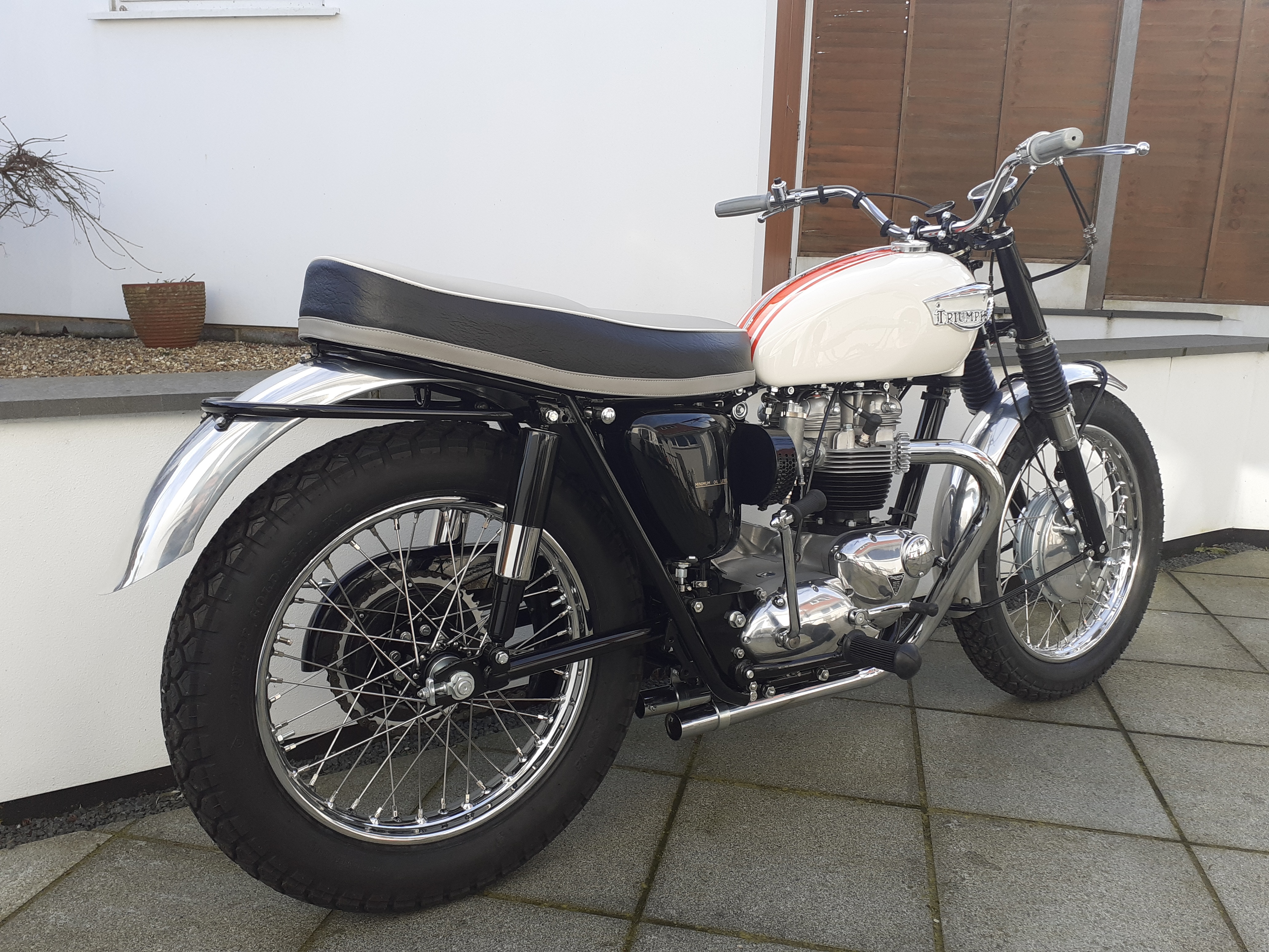

    Just, sort of, finished this off. Last year I was looking for something as a sort of project after I'd used it as a runabout for the summer. So having a scout about I settled on an advertised Bonny from a, I think, quite reputable dealership. They sell rebuilt vintage bikes so I thought they'd be pretty good to have a chat with, ask them how the bike was, seeing as they have some experience with these sort of machines and they could sort delivery etc etc. All was well.
    So, any old end up, I paid and they delivered, luvly. Had a quick look at it but as I'd already sorted insurance on went the helmet and off I bombed. Got about a mile and kaput, bollox, right in the middle of the traffic as well. Pushed to side of road, had a quick look, minimum amount of petrol, kick started ok, bombed off to garage for fuel. 500 yards, stalled, double bollox. Started again, arrived at garage, filled with nice new petrol. Off up the hill back home, FFS stopped again, ended up pushing home....
    Another project then. I could've, and maybe should've, told them to come take it back. But I wanted a project, this would just simply jump the queue. Which is why the Amen framed chopper has been waiting in the corner.
    For those of you who are considering a bit of a project. I can't tell you how much fun it is to do on these machines. They are relatively cheap, easy to work on, there are a few special tools you need, but overall there's no complicated electric wizardry stuff going on and there's plenty of help and spares available. It's not really that expensive either, when you compare to newer machines or even the likes of older Harleys etc. And they are better, miles better.
    My advice is to go buy one, get those spanners out and enjoy climbing into them. I'm not gonna run you through the whole rebuild process on this one (as I haven't got all the photos) but I will list the things I ended up having to sort.
    Just kicked it over this morning, it kicked me back first, then second kick it started, vroom, vrooooom

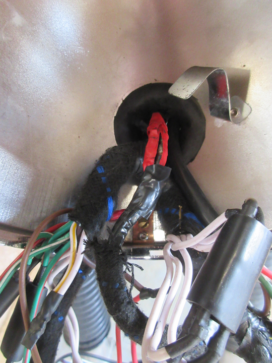

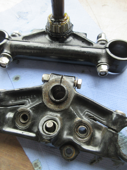

    This is the sort of thing you'll have to undertake when climbing into one of these. Don't let this put you off, it's really enjoyable, keeps you off the streets (I'm not let out after dark anyway) and you have something you did yourself at the end. The street cred climbs significantly as well. Right, the notes I made in my little book:

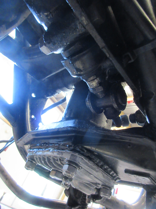

    Oil leak when running from primary case
    Oil is new but frame oil cover plate has been stuck on with layers of three bond (looks newly done) so can't get off
    Points cable is actually a 3 core electric household cable
    Drive chain rusty and worn
    Seat pan not bolted up
    Oil drain plug only finger tight
    Engine plates held on with wrong bolts, some only held on with one or two threads
    Right footrest loose
    Clutch cable cover split
    Engine bolts worn by loose chain - had to cut off as nylok worn away
    Rear brake nut only finger tight
    Mole grips had been used on head bolts to tighten as wrong sized allen keys had been used
    This is the first page only - there's another 7 or 8 pages of issues that I found as I disassembled. And the issues got worse. Here's some pics

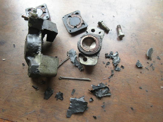

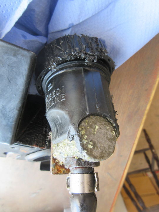

    I totally rebuilt the engine (you really need to check the sludge trap) even though a receipt was included in the sale showing £2500 had been spent with some other service company rebuilding the engine not long ago. And again (I've found this before on engines that were supposedly done) the work wasn't done well. Previous rebuilders seem to reuse stuff that shouldn't be. Nuts that have been hammered, tab washers reused again and again, oil seals reused, old hermygotight not cleaned off and stuff not tightened. I even found a sludge trap plug loose once.
    I bought new standard barrels and pistons as the existing ones had been welded and weren't in a good shape. The rear brake cylinder had to be renewed as I couldn't get it apart to service (even with the grub screw out). Pushrods were wank as they'd actually come off of the ends and marked up the covers.
    Lots of parts had been plastic coated, the plastic coating had been applied over bolt heads even on the tappet blocks.
    And there's the usual grime over everything.

    I'm still not enamoured with the back tyre width, I'd like something a bit wider. It has the really nice Akront shouldered alloy rims, the rear is a 2.15 rim with a 4.10H18 Dunlop TT100 Roadmaster tyre. The front is a 1.85 rim with a 4.10H19 on it. So the front looks pretty but the rear looks really skinny.
    I know the handling will be better with the tyres it's intended to have but I'm a high heels sort of bloke cause I like the look of em. So widest is bestest in tyres with my eyes. And I don't fly around the bends these days anyway.
    I'm thinking I'd get away with a 110 or even a 120 width tyre on the back. Assuming the wheel has been built with the correct offset has anyone tried these tyre widths on a 2.15 rim with the standard sprocket and swingarm?

    No idea on other options but 350 19 front and 400 18 K70's look ok on standard rims and were original fit on competition bikes back then.
  10. Iron
    Iron Guest
    Yep, yours is a beauty, especially with those TT pipes, and the tyres look good from that angle. The tyres on the T140 are even wider than yours at 4.10s but the back still looks awful skinny. Did we get away with 4.75 or even 5.10s back in those tearabout days and we even ended up with chain marks on the tyres? I can't bloody remember ffs :neutral:

    There's a nice double tail light, a nice small bates headlight, a Harley ignition switch mounted on the frame under the battery, nice old style side panels, ally bellmouths (velocity stacks), slimmer seat, luvly painted export tank, new spirit bell, total re wire, akront ally rims, new barrels and pistons, and...and... a new sludge trap plug, mumble mumble...was quite funny though :)
