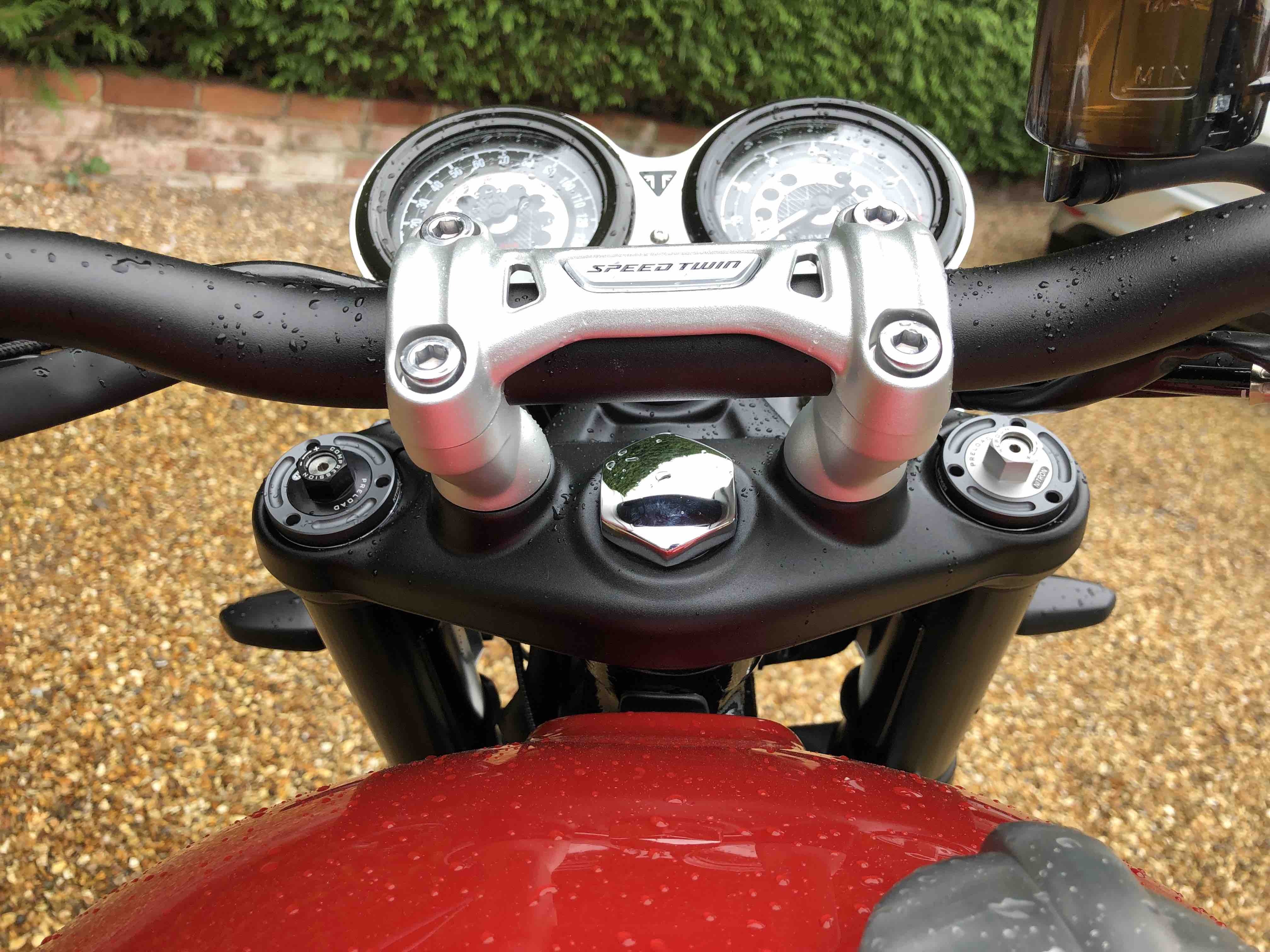

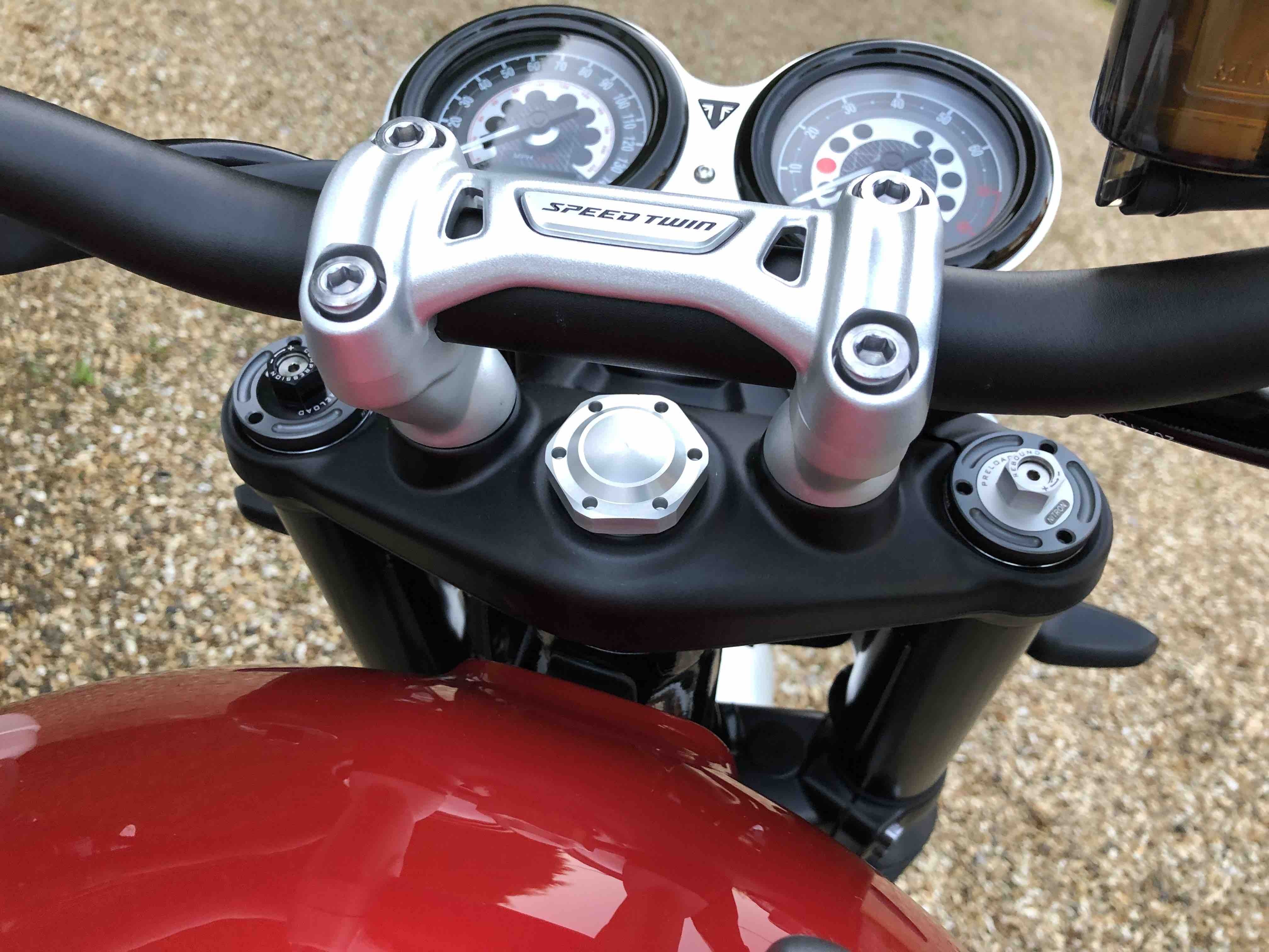

    That looks soooo much better than the original chrome thing. The Street Twin has got a similar chrome yoke nut, which I'd love to be rid of. So a couple of questions for you..how much was it? Can you measure the width of your original yoke nut please (I want to see if it's the same as the ST)? What's the part number on the packaging (don't tell me you've already thrown it away..I mean recycled it)? Cheers.

    https://www.fowlersparts.co.uk/parts/view/T2049880
    https://www.amazon.co.uk/DRAPER-EXPERT-SQUARE-DRIVE-SOCKET/dp/B0002BUO8K
    I think those two links should answer your questions Beerkat. I think the M25 is the thread size on the inside of the new nut and it is the same dimensions as the original chrome nut and so the 1 1/2" socket fits both.
    This is where I copied the idea from...
    The torque figures he mentions are correct I think, well, the same as I'd seen listed elsewhere from a copy of a Haynes manual.
