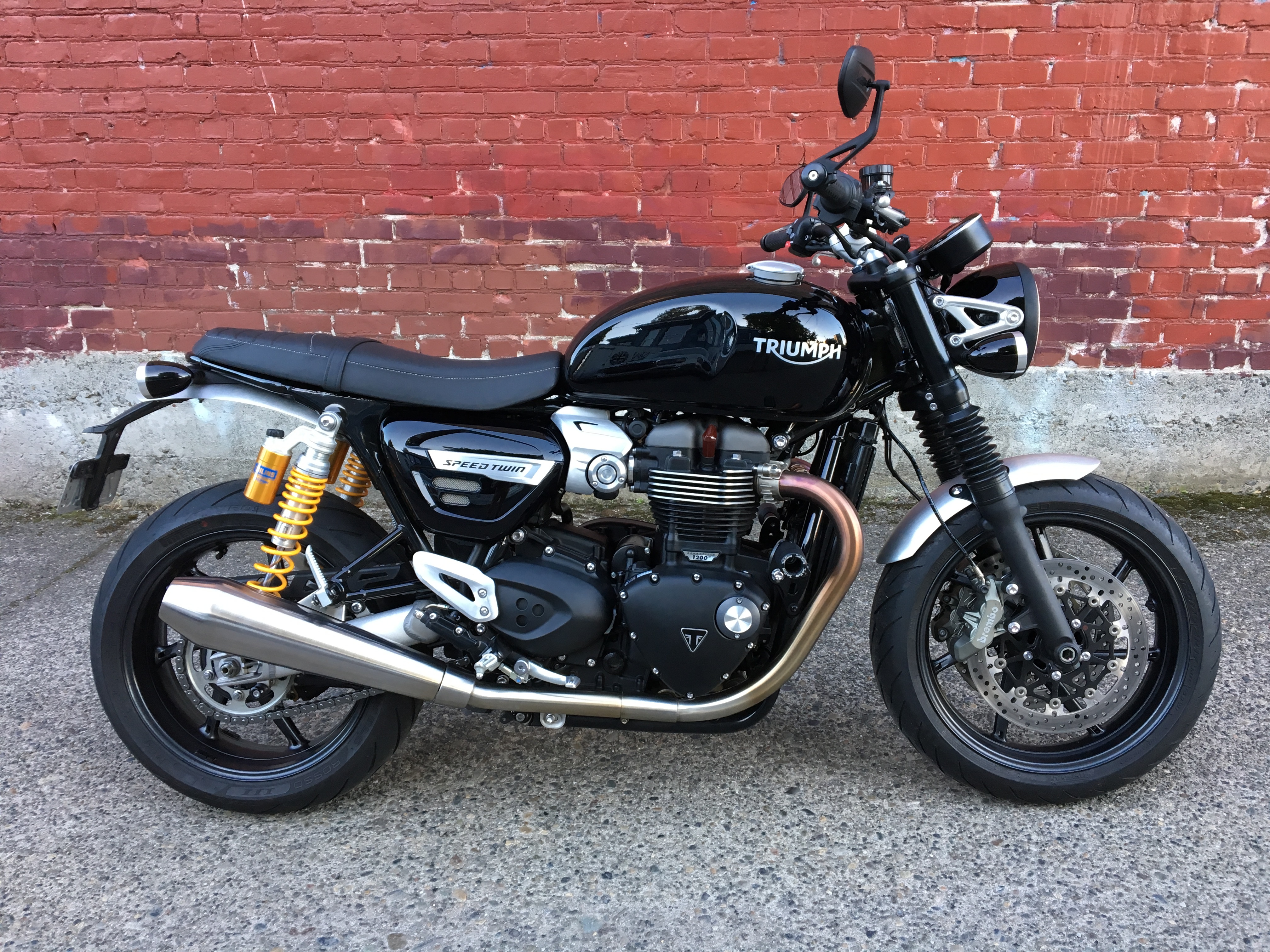

    After what seemed like an absurd amount of research on rear shocks (how can there be so few options for a bike that's been out almost a year?), I put the Ohlins from the Thruxton R onto my Speed Twin.
    The spring rate is pretty firm (and I'm relatively light at 160 lb), so they are set for the least preload and 'comfort' settings of 20 clicks compression and 44 clicks (44 clicks? How much adjustment do we need?) of rebound.
    The Ohlins are noticeably better than the stock setup, but your work with Nitron is next level stuff. I wish Ohlins was that engaged and responsive. My rep couldn't even tell me what Ohlins rear shocks would fit the Speed Twin.

    We are similar weights Jet, I'm 70kg, probably 75kg or so in my kit. It sounds like you are thinking about softer springs? I've just looked at the Nitron record card which says the twin shock springs I have are 16-24 N/mm.
    Using this conversion tool
    http://www.dfaulknersprings.com/acatalog/Conversion.html
    it comes out as 91.2 - 136.8 lbs per inch.
    It depends on the type of riding, roads, pillion and luggage of course, questions they asked me, but that might be useful. As you'll see on Faulkners website, springs are relatively cheap to change, based on i/d and length, but I don't think they do progressive springs.
    I think my shocks have 24 clicks of rebound available, 16 Hi-speed compression and 16 Low-speed compression, more than enough to experiment with. As you say I'm starting with a good set up which I got to enjoy for an hour yesterday.
    If you're keeping the bike, maybe you can find out what springs you have and source some others, even if you need to get them powder coated.

    Right now the Ohlins have been on for 1200 miles or so. They are fine; if I had a complaint it would be a little too much compression damping so I'm going to back it out four clicks or so and see if I like that better.

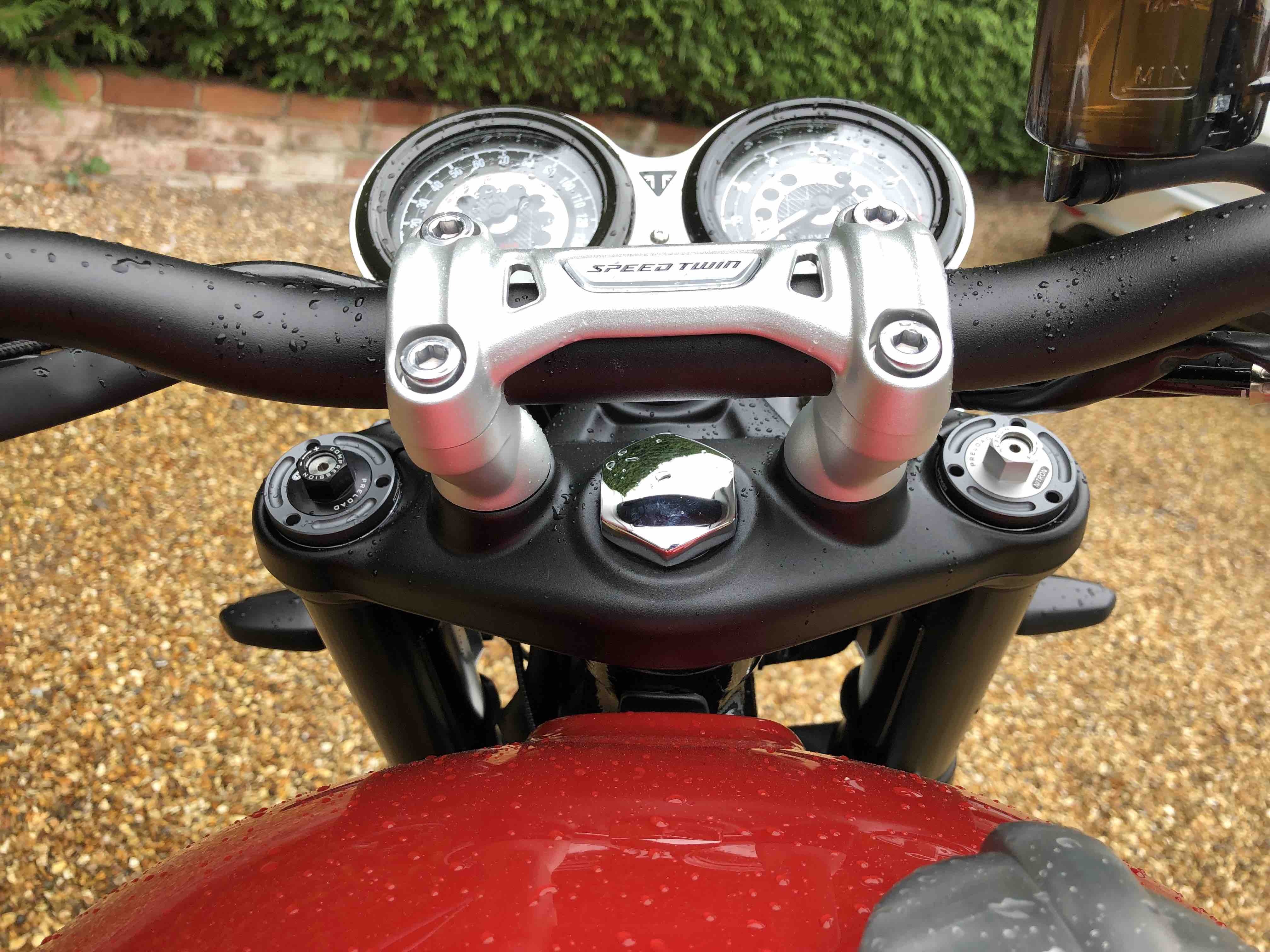

    Swapped my Upper Yoke nut for this aluminium one which is fitted to Thruxtons I think. Got it from Fowlers.
    I think it goes well with the Nitron adjusters better than the chrome one anyway.
