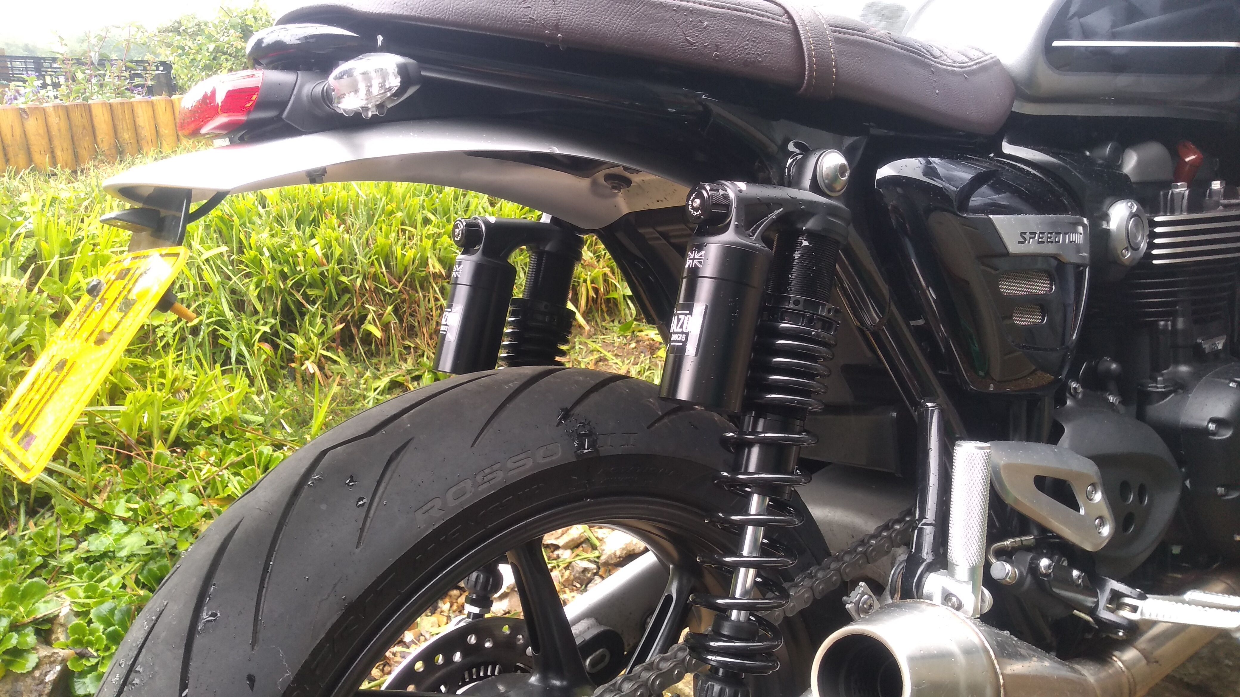

    the shock on the right hand side on my bike was clear … just. But the left hand side was making contact and Ktec have changed the tops on mine so there is about 10mm clearance now.

    Can you share a pic? I did contact KTech US and they are looking into the issue. Either way I am fine with the set-up as it is.

  18. Tosgha
    Tosgha Noble Member
    Jul 31, 2018
    326
    313
    worthing
    could only upload two pictures at a time. hopefully this shows you the clearance with the new head.
