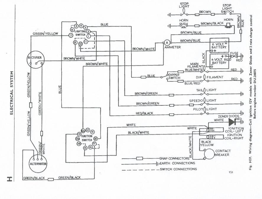

  5. MrOrange
    So by the power of GREYSKULL, well deduction actually, I think the rocker switch (blue line) is light off, side/tail & headlight on, and the wee bar thingy is horn and dip/main beam. (highlighter)
    This diagram looks best fit for mine, but colours to ignition switch are all wrong, further investigation required.
  6. MrOrange
    Yes, but no key and only one wire connected to it, other is just hanging loose. Trying to figure this all out.
    Put a battery on it today, but nothing worked. By the look of the wiring diagram, the headlight should have worked ! But the loom is a feckin nightmare.

  8. darkman
    7,659
    #88 darkman, Jun 1, 2018
    Wiring dia and colour codes. bar switch is like you say dip n main, horn is the button

  9. MrOrange
    Mine's doesn't have rotary switches ! And ignition switch only has 2 wires coming out of it. Blue/white ????
    Just trying to decifer what changes /repairs have been made in the past, and then what should be going where. It's only a bike, so compared to a Land Rover, should be able to do easily enough.

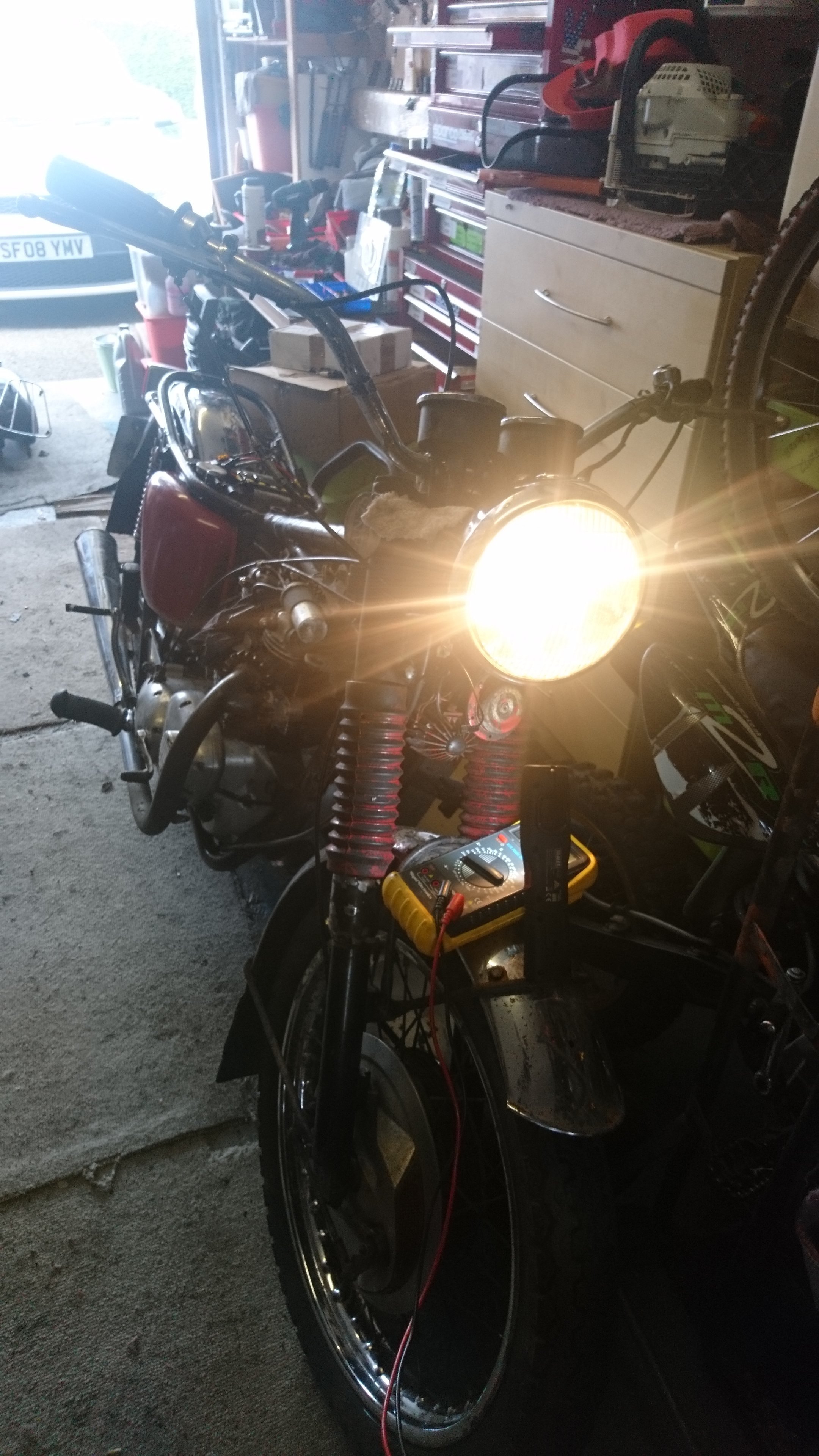

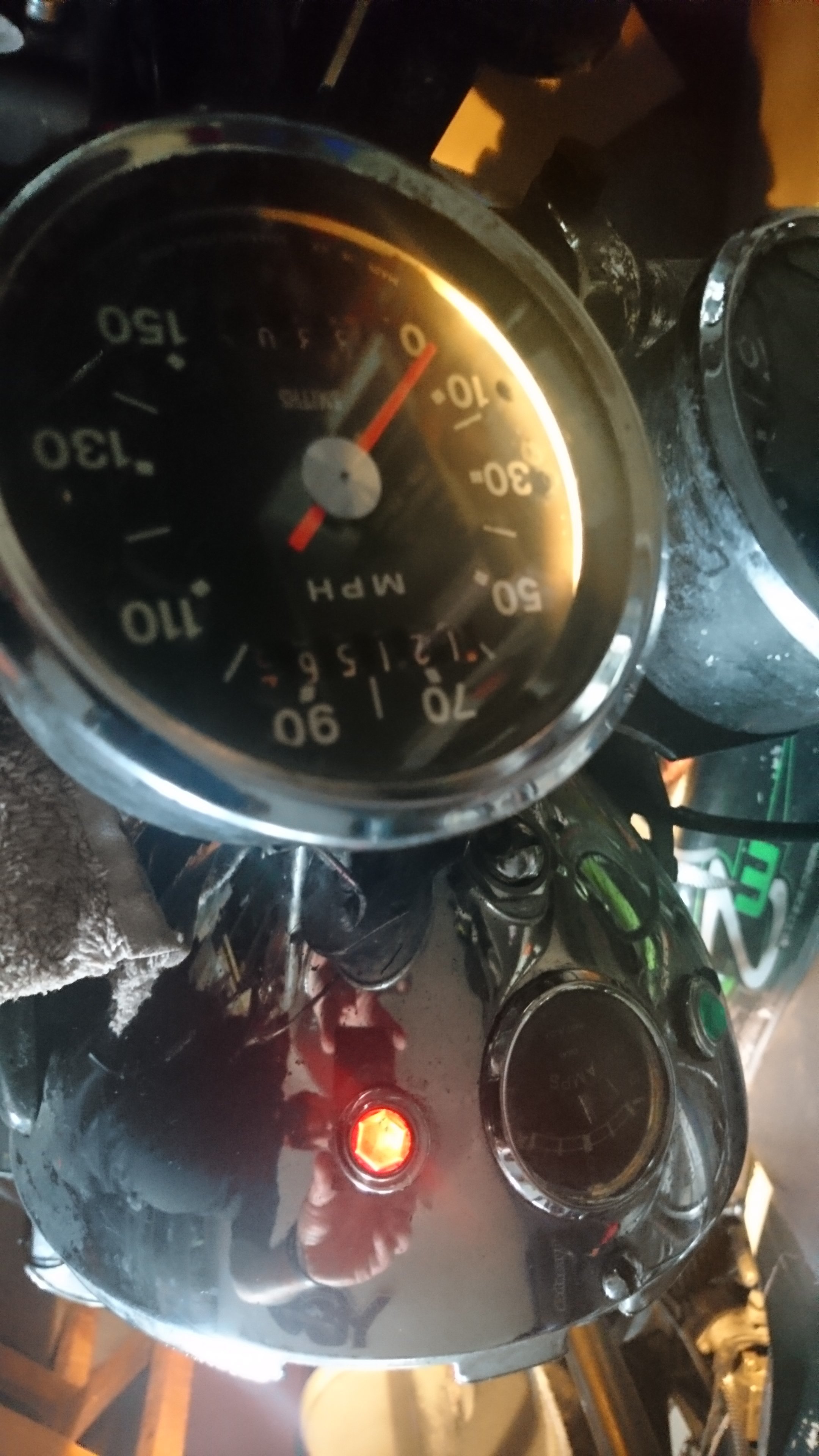

    Battery attached, bit of feckin about with bits of missmatched colour wires around where the ignition switch should be, and we have power !!!!:cool:
  13. MrOrange
    Got more stuff working
    My ignition switch!!!!
    Before your grumbling about crimp connections, there just there to prove operations. And better than electricians screw block things.

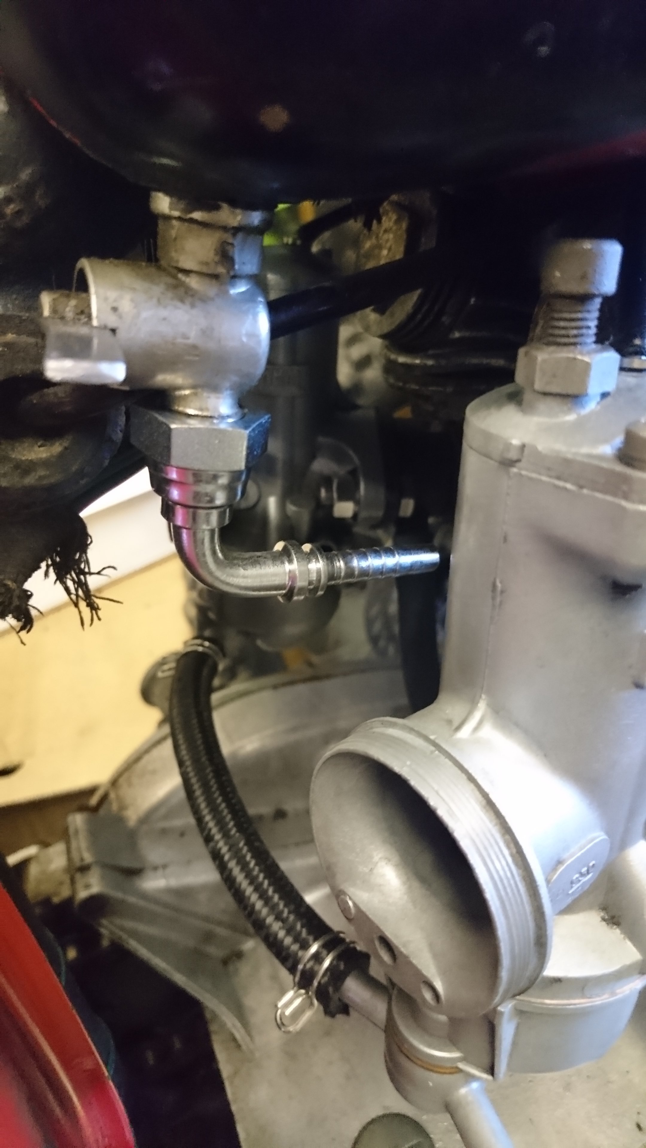

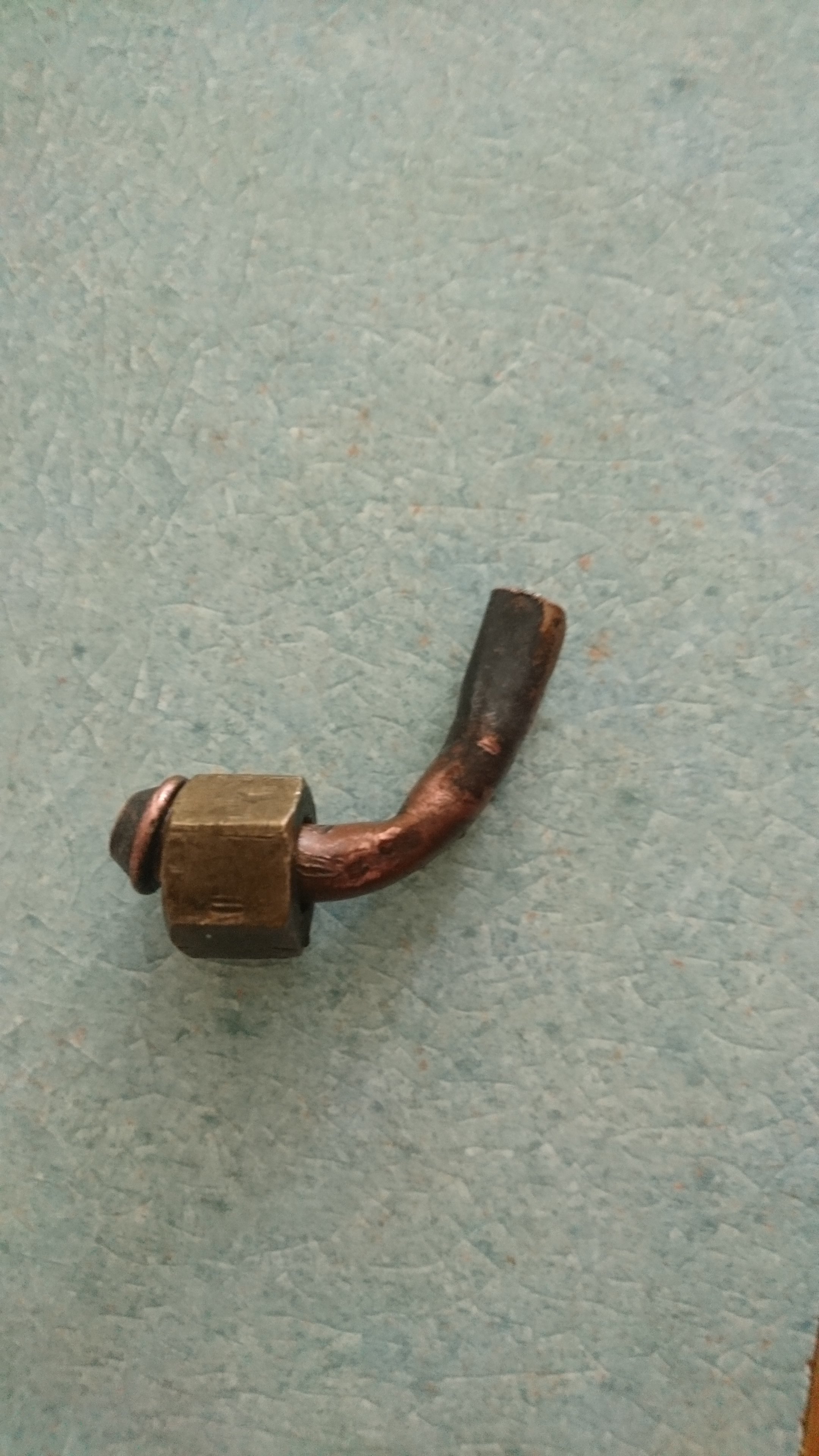

  14. MrOrange
    Need one of these. Like a brake pipe but bigger, fits onto the petcock. Any ideas, anyone?
  15. dilligaf
    You could try a plumbers merchant and they might be able to help :)
    Better still....do you know a plumber :p
  16. Callumity
    Callumity Elite Member
    Feb 25, 2017
    3,362
    Nr Biggar
    Microbore plumbing? 8 or 10mm? Flaring it and re-using the nut .......
  17. Callumity
    Feb 25, 2017
    3,362
    Nr Biggar
    #97 Callumity, Jun 5, 2018
    I have the tools! Imperial pipe was 1/4, 5/16, 3/8, 7/16, 1/2 or 5/8 inch.
    I think boats still use Imperial so it may be chandlers rather than plumbers.
  18. MrOrange
    #98 MrOrange, Jun 5, 2018
    I could re-use, ut I can't clone! Need 2 of them, only got 1.
    Found them on EBay, with the help of @darkman , fuel petcock spigot. From what I can gather, looks like 1/4 BSP fitting.
    Have a boat chandler near work, might go visit tomorrow, looks like they still use the old imperial fittings.
  19. MrOrange
    Went to a chandler's today, useless fecks were shut. On way back bumped into a pal and in conversation mentioned what I was after. He used to be financial director at a big tractor dealers and said he wrote off old stock, but the boys. In the store would keep hold of it.
    So off we go after school and now the proud owner of two shiny new petcock spigots. :cool:
