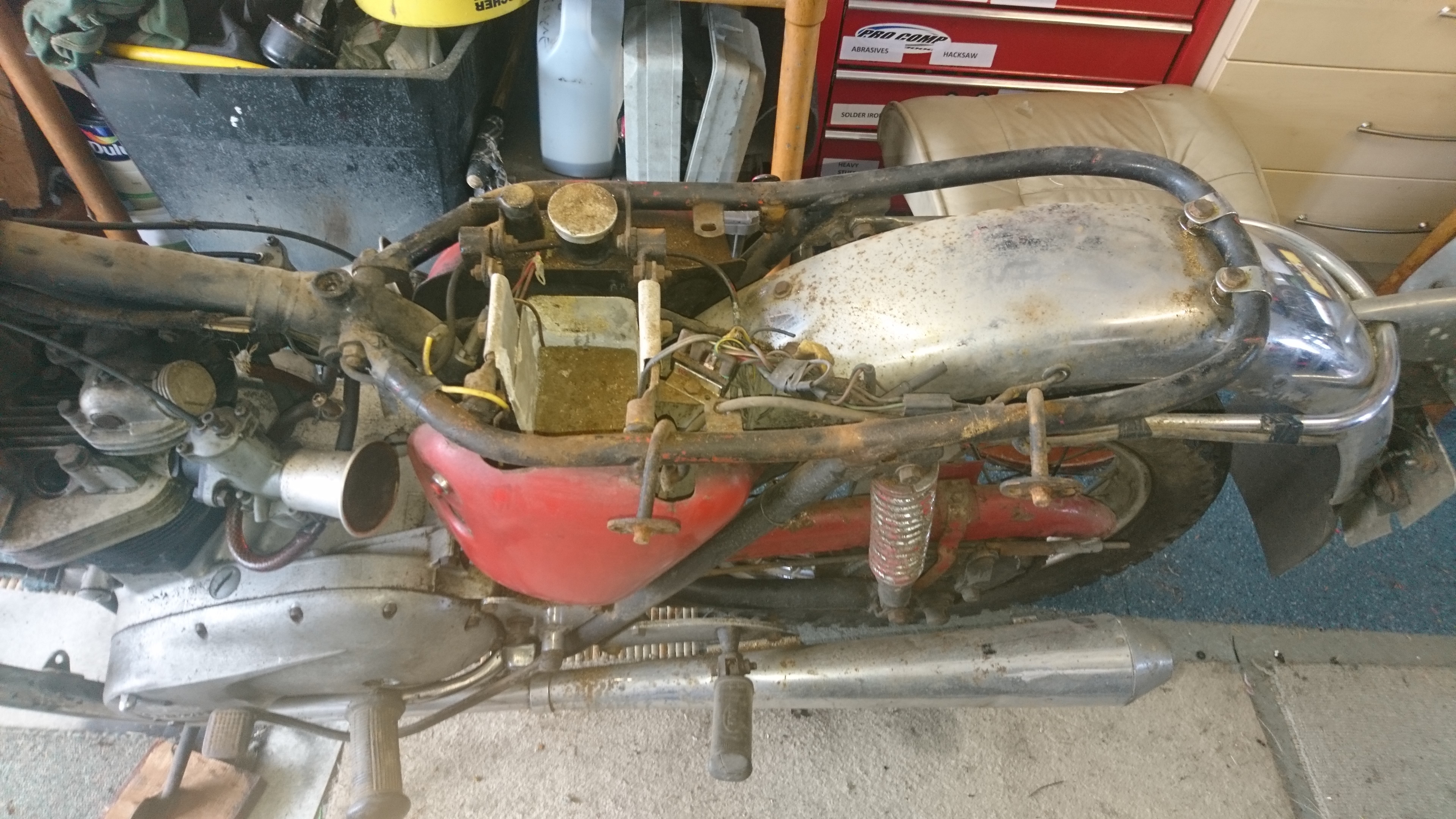

    Rebuild thread. Will update as we progress. I know how you like photos so let's get started.
    Tank and seat off. Fuel pipes are as hard and brittle as cast iron.
    Side panel off. 7/16 coming in very useful. Recognised size of bolts straight off, all coming back to me.

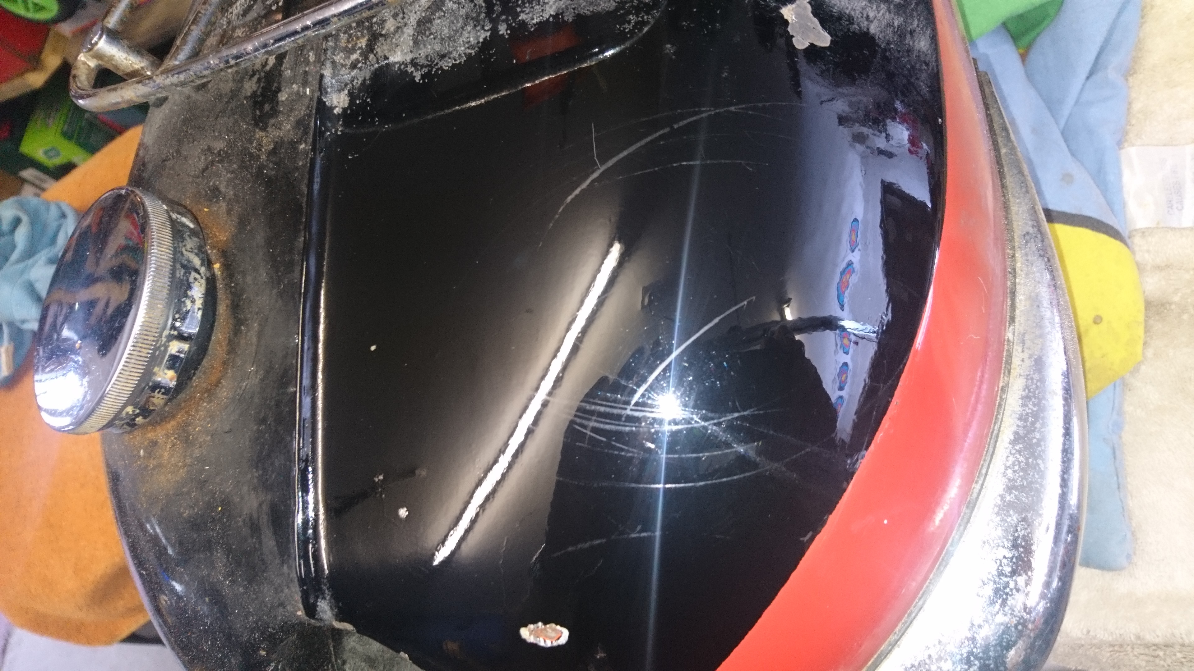

    Most of that will soon polish out!!!!:grinning::grinning: Probably.:(
  4. MrOrange
    I wish! :p
    It's all part of the fun, be boring if it was easy. :cool:

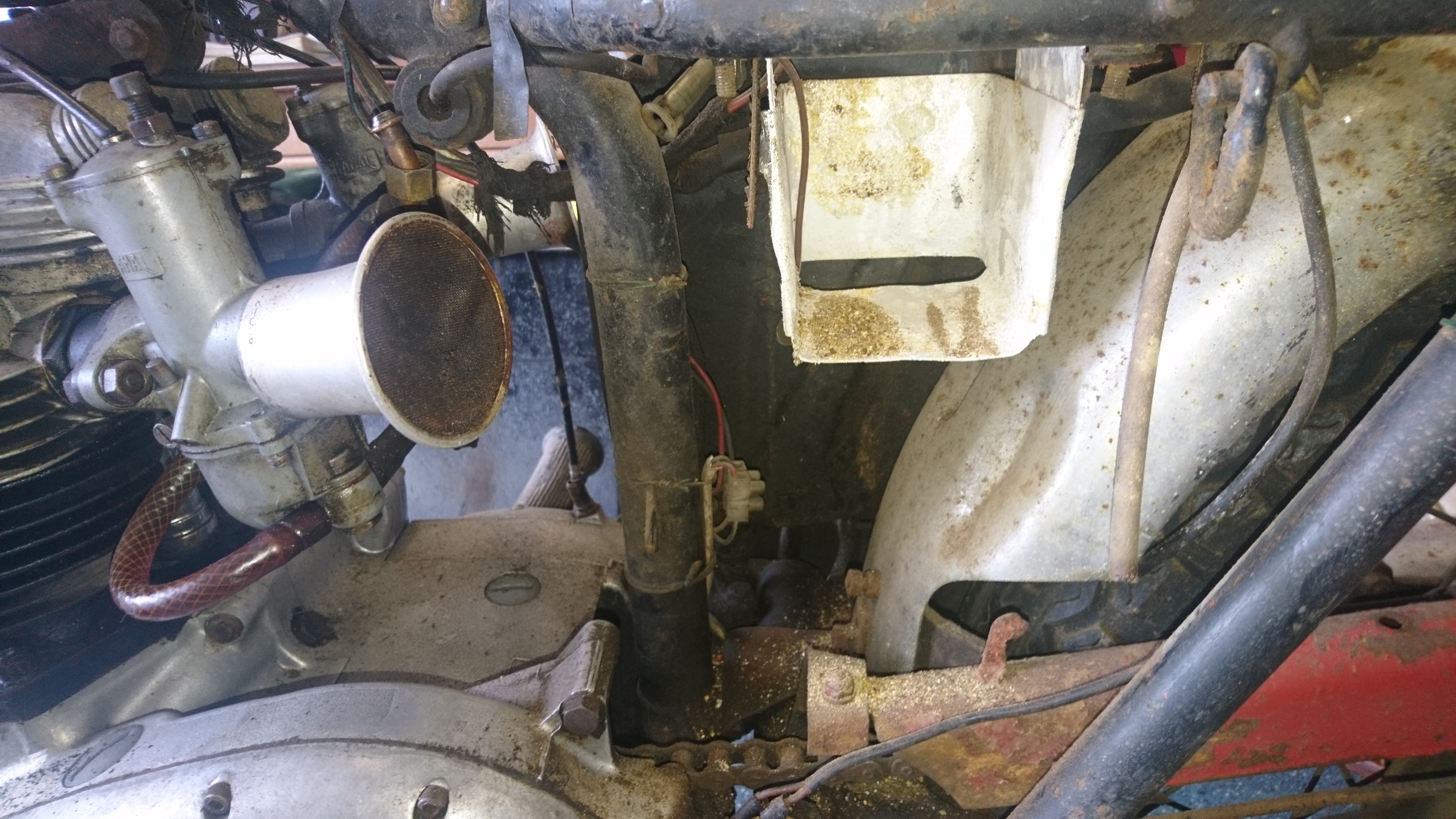

  11. MrOrange
    Coming up nicely.
