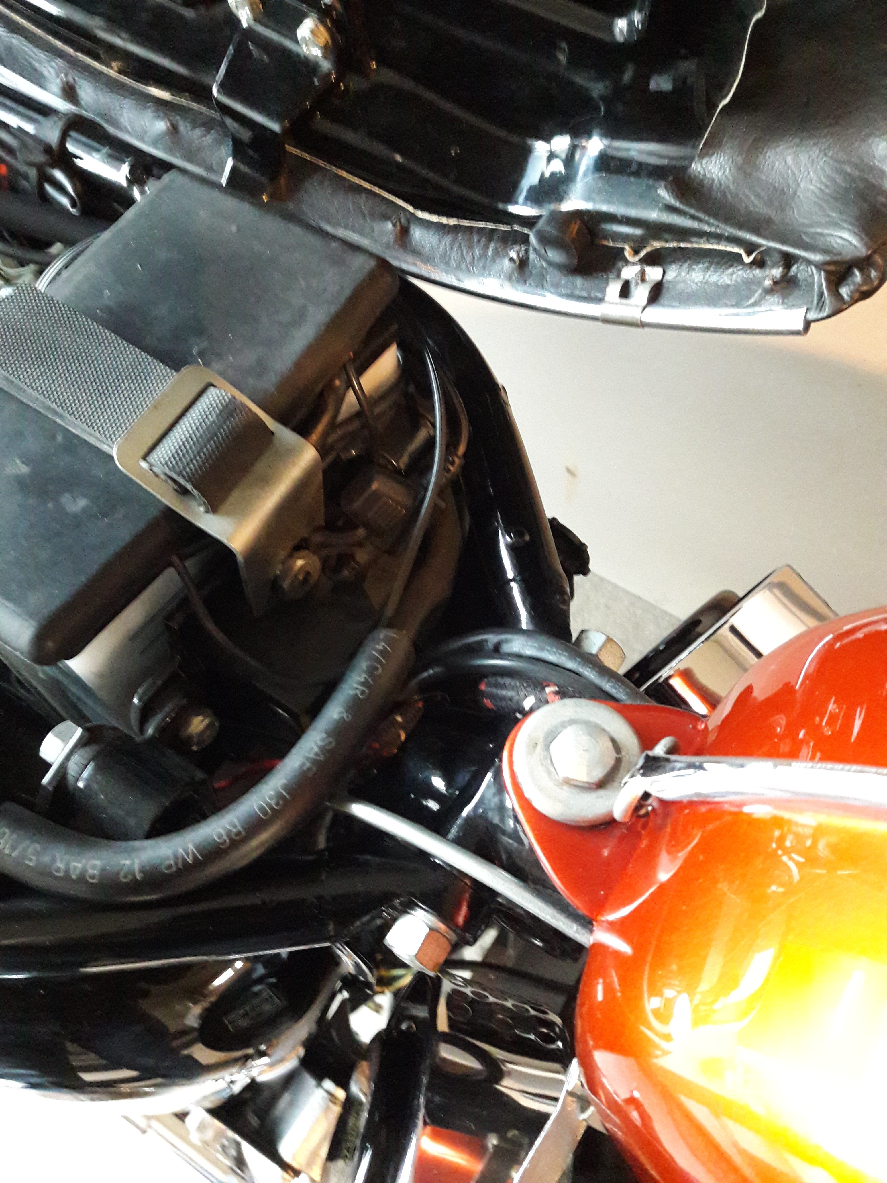

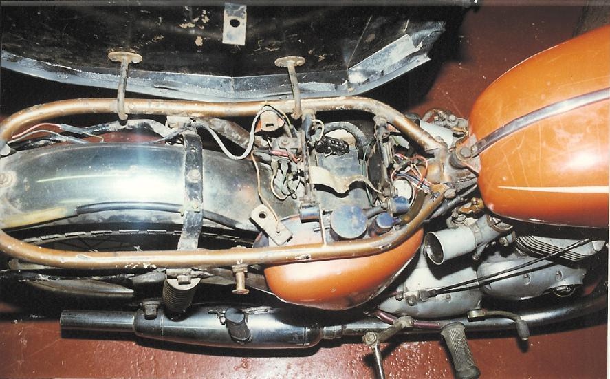

    Under seat pix as requested, 3x my 69 T120 and 1 66 that i found.

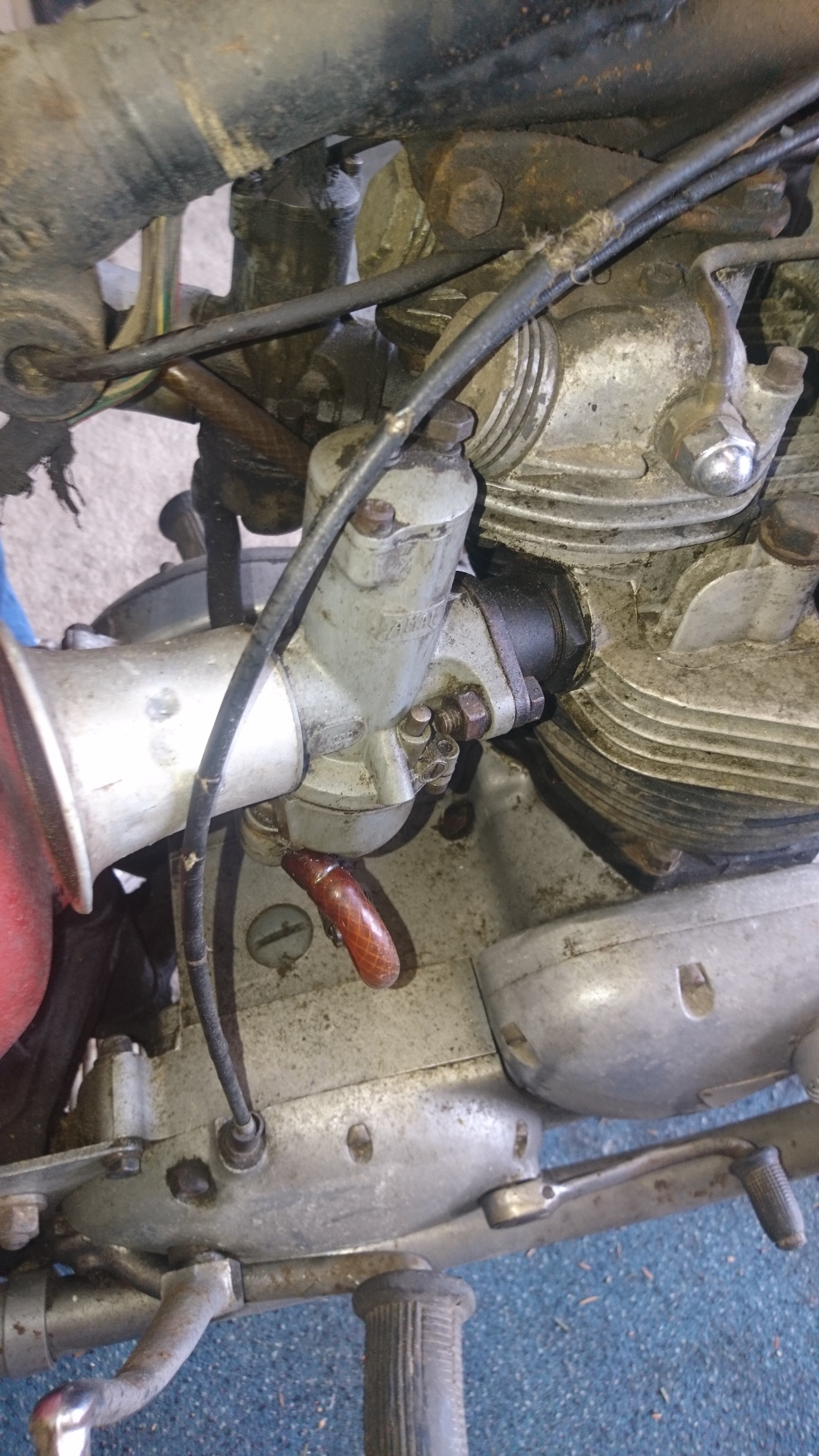

    Engine Oil, Gearbox oil, battery, plugs, fuel pipe, clips and carb gasket set ordered today.
    My kind of shopping:cool:
  5. darkman
    7,656
    What about points n condensers or does it have aftermarket electronic ign fitted.

    As most buyers don't have a clue how to set twin points i would see electronic ign as a bonus, even i gave up on my old points last year and fitted electronic as its fit n forget :) can't believe all the hours i wasted doing them before.

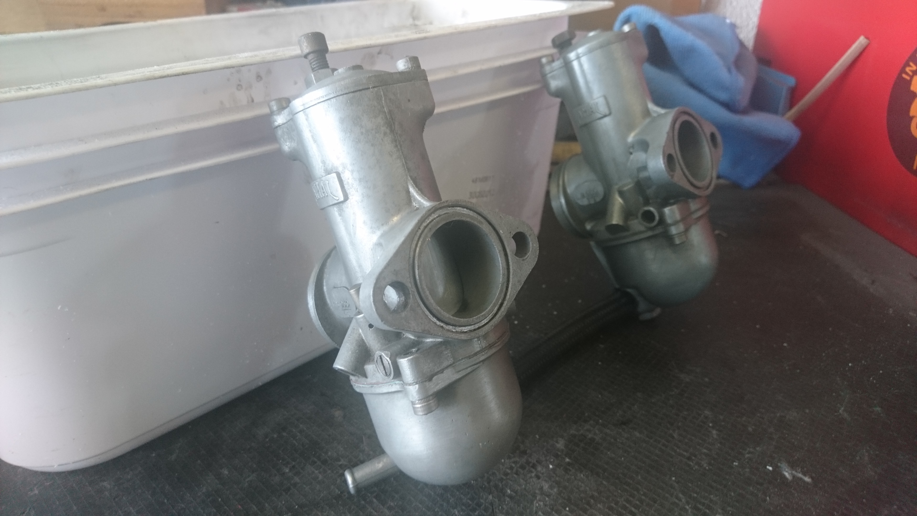

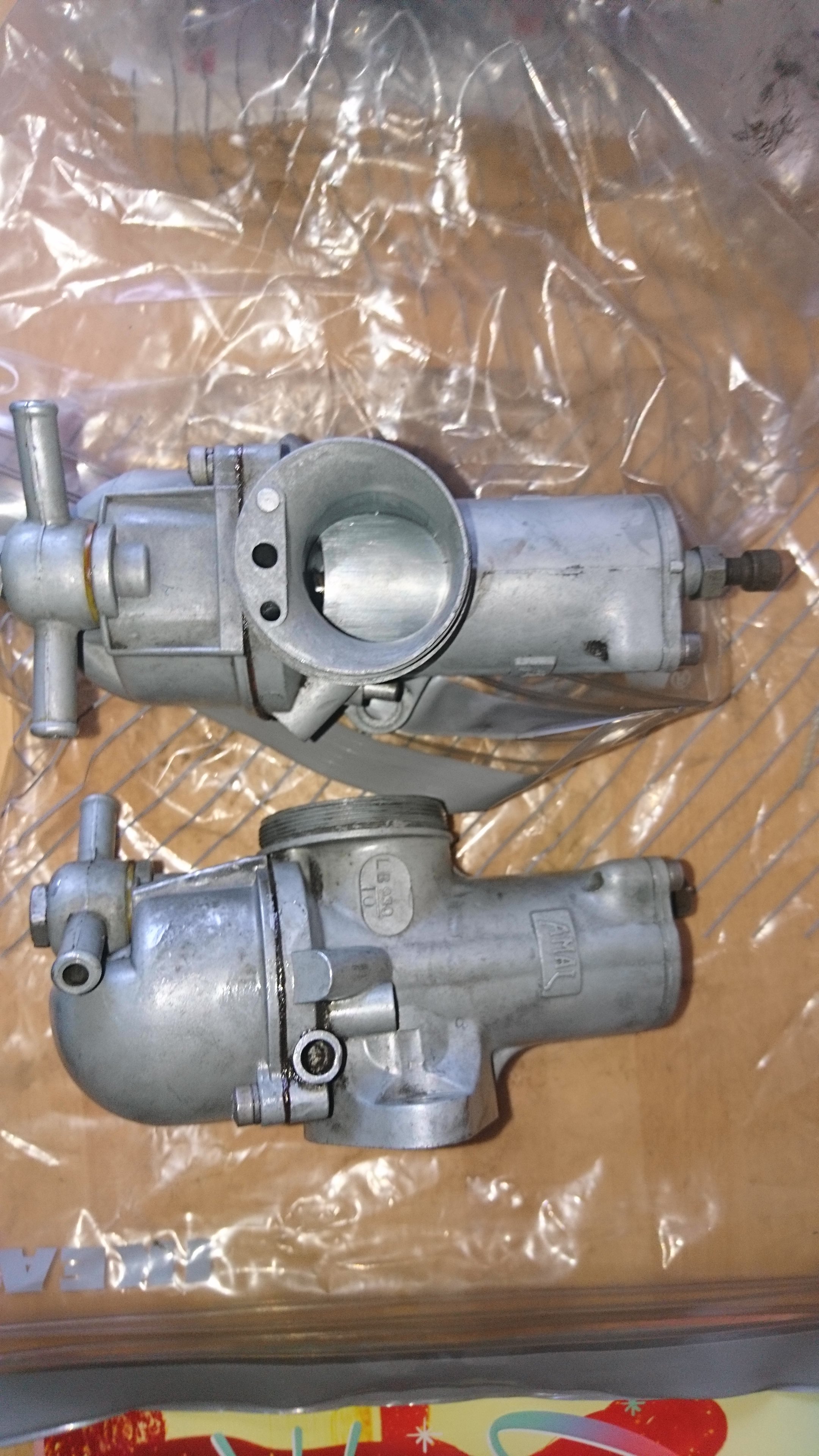

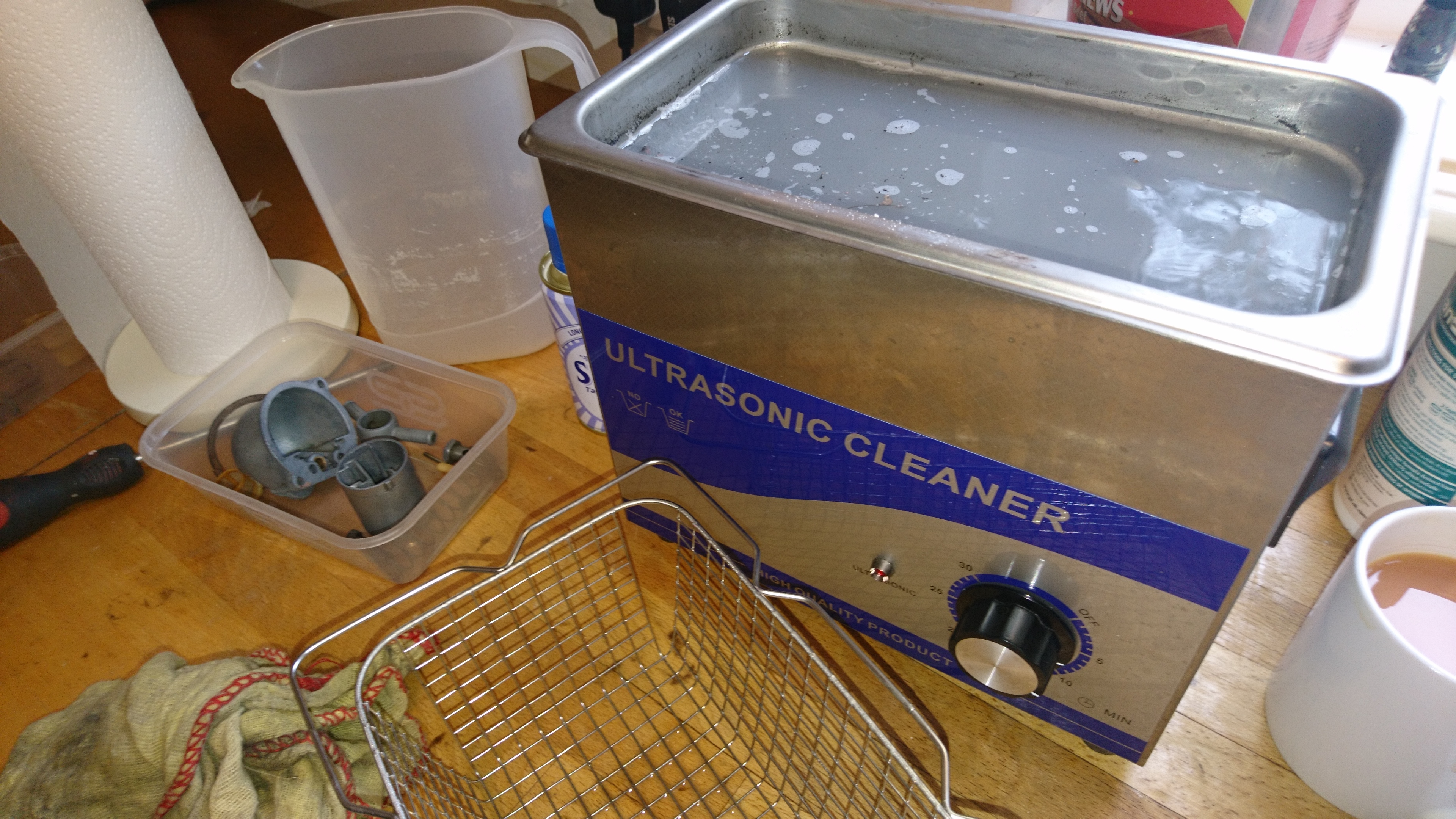

    Carbs rebuilt, gaskets and O rings replaced with genuine Amal gasket kit. Can buy everything for these carbs.
    Got some very nice cotton covered fuel line, I know its not OEM, but it looks really nice. :cool:

    Take care when replacing the carbs. Do not over tighten them as the inlet manifold can deform apparently, which means you then can't get a good seal. I'm not sure if this applies to just monoblocs, concentrics or both but I've seen it mentioned a few times in various publications. I don't remember it being a problem when I were a lad, but maybe I was just lucky.
  13. MrOrange
    When I took them off, they had a gasket and a O-ring. On the replacements is a slip of paper instructing not to use both! Does seem a bit belt and braces with both, but thought just the vagaries (never typed that word before!) of british engineering in the 60's !
    Will take care tightening, thanks Steve.
  14. darkman
    7,656
    The gasket is used on single carb engines as they usually have a heat spacer fitted :)

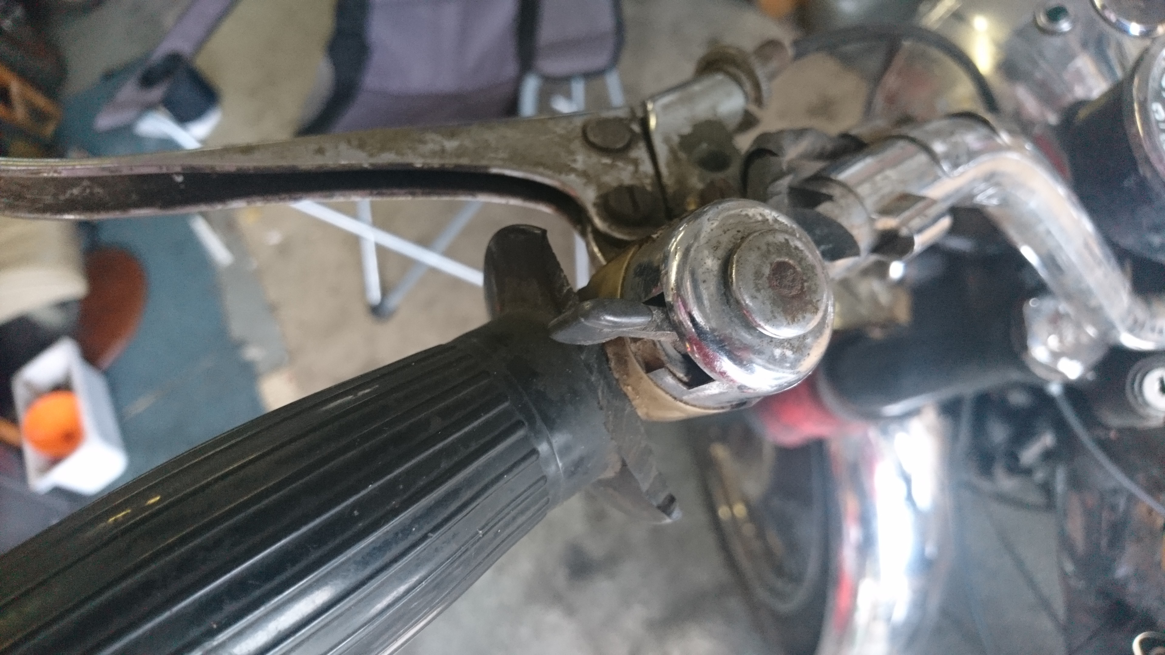

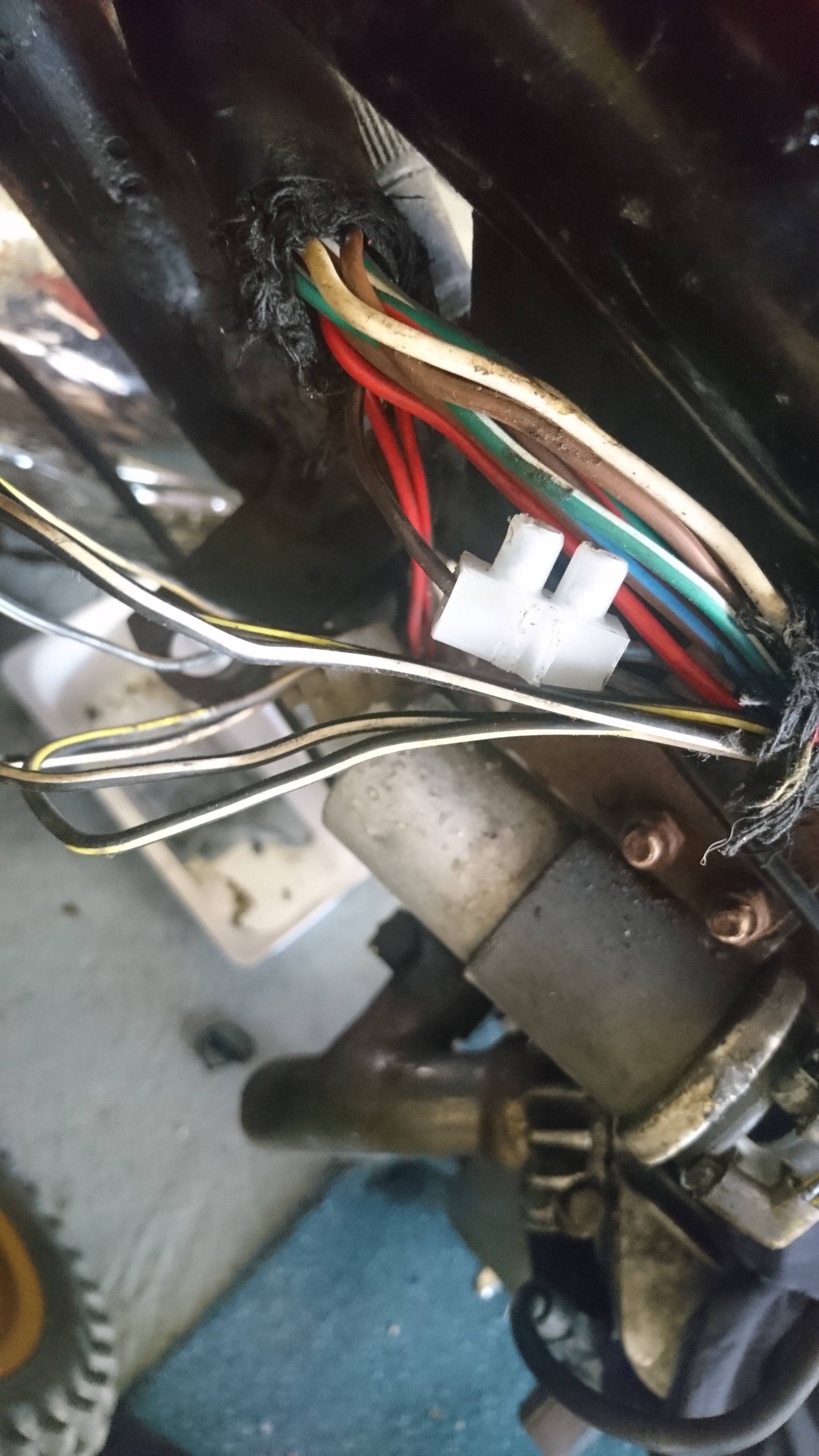

    What function does this switch perform, the thumb slider and the press on top? Thanks.
    As you can see looking at electrickery on the ol girl. Wiring loom is a feckin mess, with a few of those horrible screw connectors thrown in.
    Don't think these are OE! :dizzy:

    If my distant memory serves that is the old headlight switch and dip/main beam?
  20. MrOrange
    #80 MrOrange, Jun 1, 2018
    Is that not the three position rocker switch on top of the headlight? If not, what does that do then?
