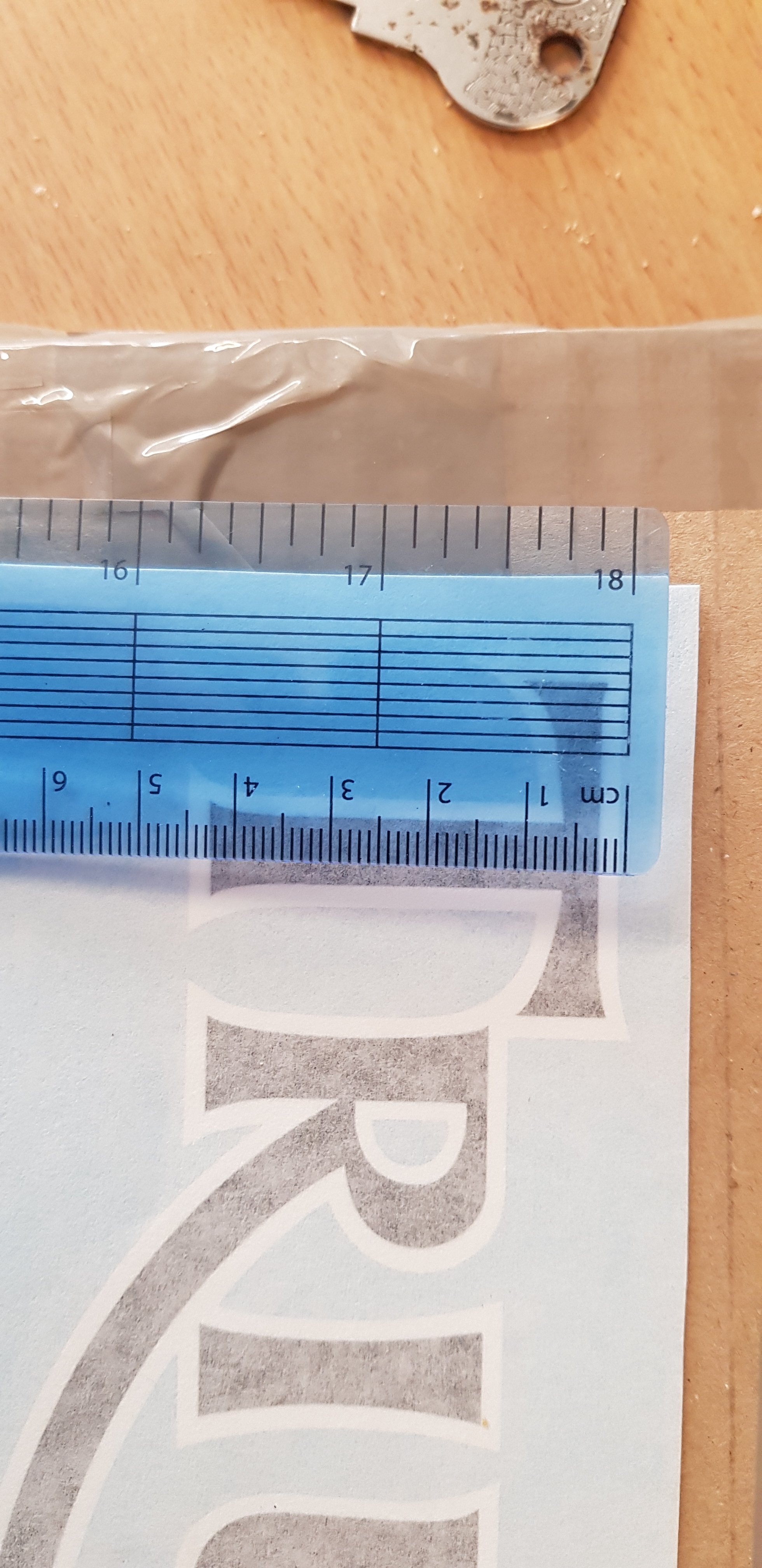

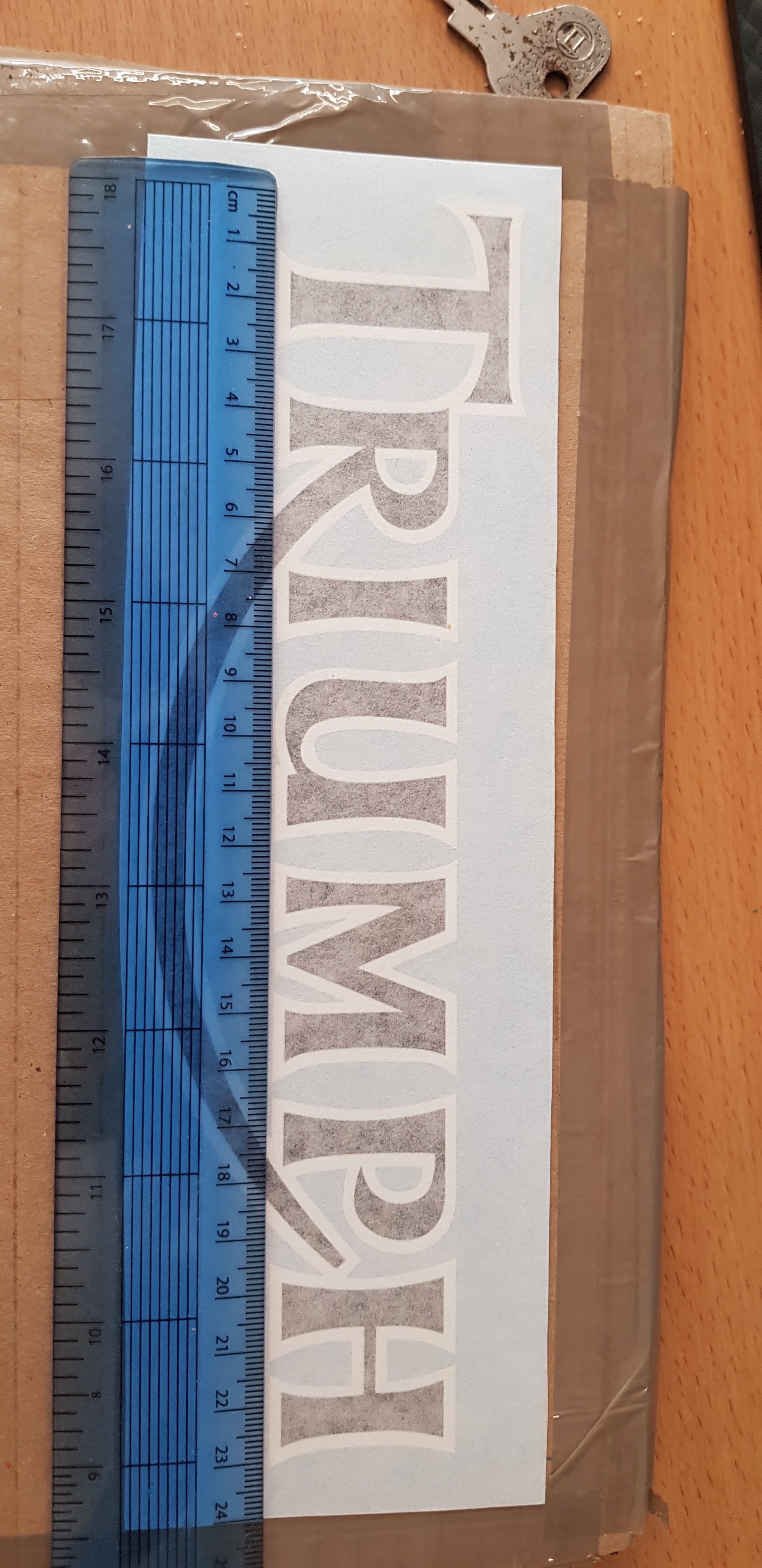

    Hello folks, no photos today but the tank respray is coming along nicely and all this warm weather has been great for curing times, no oven needed! I received the new tank decals today, they look really good but they're bigger than the ones that I had on the tank. I'm hoping it's because the tank I have is from a 92 Trophy but was wondering if someone could confirm the size for me please? 20190724_182206[1].jpg

    Just want to double check they're right before I clearcoat over them. cheers

    Hi Skip. Yep, they look pretty much on the money - if anything very slightly (maybe 0.5 -- 1.0 mm) short on the height compared to mine.

    No problem about support, Skip - that's a given. Sorry about the brainfart over colour, I did recall our conversation a few minutes later! What "confused" me was the fact that your new decals have a black "centre" and I ASSUMED (ass ... u ... me ..... duh!) they would be just the white outline!

    I'd assumed the same thing Adie but I'm guessing the black centre stops the outline from deforming.

    You're probably right about the decals. I did feel motivated to go out and check the decals on mine and I'm certain that they, too, are not just outlines since you can feel where the clearcoat goes over the ridge at the outer edges of the characters but not between the outlines. Not sure if that makes sense but the point is I'm sure that what you've got is the same as is on mine.

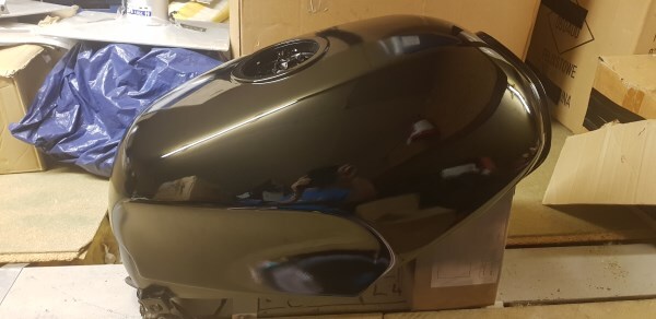

    Paint on the petrol tank is done now, I'm happy with the results as I've never done this before. Front mudguard is still a work in progress though, I thought I had it flat but the black paint shows every tiny little mark so I've had to rub it down and start again. I've still got to get the tank decals in the right place though :scream:

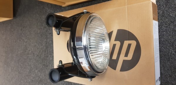

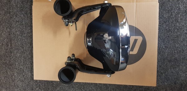

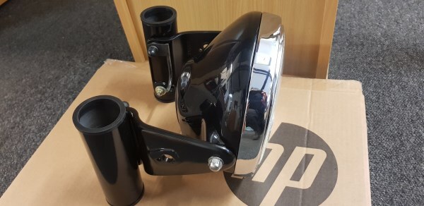

    Happy Days. All the headlight mounts are finished and in the right colour, I managed to find a UK lens on fleabay for sensible money because the chrome ring was a mess, luckily the one from France was in perfect nick.
    This has been one of my biggest hold ups as I haven't been able to put on the clip ons and top yoke, new front brake lines or mount the clocks until I had the headlight mounts. Time to finish the front end now! :)
