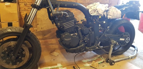

    South Coast
    Morning All, sorry that I haven't updated this thread for a while, things have been a bit manic with work and everything.
    So here we are up to date, all the suspension and swing arm back in the frame, lots of lovely fresh grease and new bolts where needed, the swing arm pivot bolt is a b**tard to get in, there are so many bits to line up and the end of the shaft is flat with an internal thread so you can't hammer it. 20190504_122132[1].jpg I made this little tool from a bit of nylon I had laying about, a bit crude but it worked a treat, the recessed end fits in the shaft and protects the thread, the pointy end lines everything up for easy fitting. If anybody wants one let me know!
    The engine is back in its rightful place, it was a bit of a twat to get in to be honest, especially as I didn't want to mark the nice new paint job.

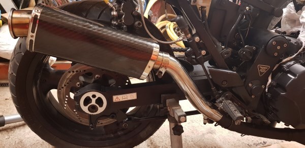

    I've been busy picking up random bits of 'zorst from ebay, the link pipe was a decat pipe for a Kwak, I had to cut it down and get the welder out to make an adapter but I'm happy with it for a tenner 20190619_081707.jpg 20190619_081625.jpg The end can is from a Suzi GSXR, I didn't have to do anything to that. Both bits are SP Engineering, nice quality stuff they turn out. It's just dry fitted here as I need to make a hanger bracket.

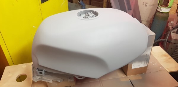

    Tank's all repaired, rubbed down and put in primer. Massive thanks to Adie P for putting me onto RS Bike paint, they have dispatched the paint today, fingers (and everything else) crossed that it's the right colour o_O
    Spent most of the weekend fannying around with the rear caliper that had a broken off bleed nipple. I thought it would be an easy little job but turned into a swearing fest, I've never had much luck with easy outs sadly that is still true! After drilling out the nipple as much as I dared I used the thickest easy out I could get it, the bloody thing snapped off :mad:
    No chance of drilling that out so I had to use a nut placed over the broken nipple and filled the hole with a weld, first go didn't work, more swearing ensued followed by a beer break. I had another go and turned the amps up a little, this got the nut glowing orange, I sprayed it with WD40 until it was cool and out it came, happy days.
