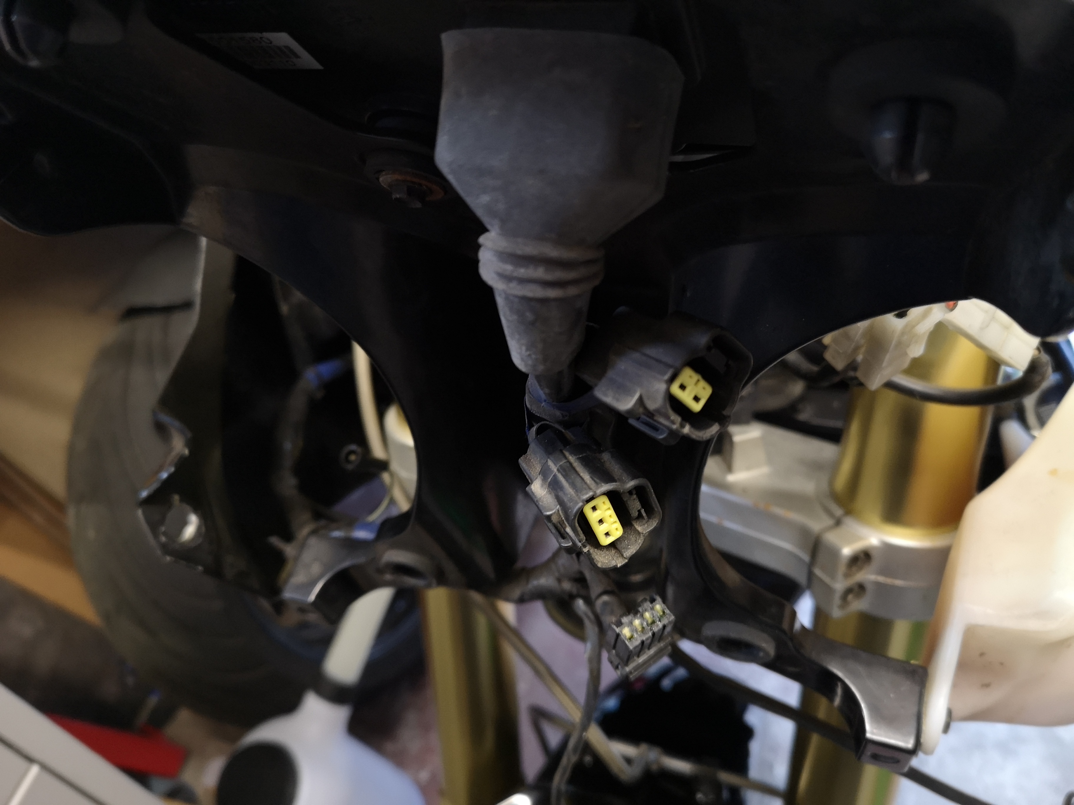

    There are two feeds behind the clocks both on a 10A fuse, one for GPS permanent live ‍♂️2 way, and a 3 way for heated grips (this has the ignition switched live also).
    Additionally as mentioned by Johnjo, there is the aux socket wire under the tank, taped to the loom. But again this is a 2 way permeant live feed. Againg I think this is 10A

  8. David Bell
    David Bell New Member
    Sep 20, 2019
    9
    IMG_20190929_160330.jpg these are the connectors behind the clocks
