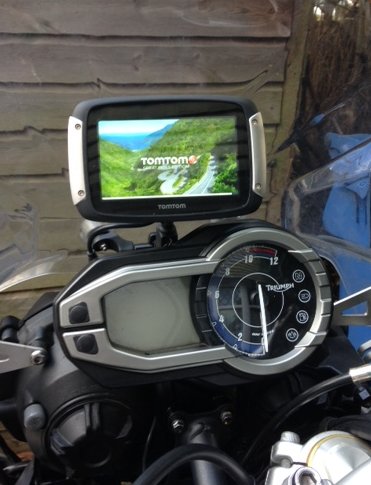

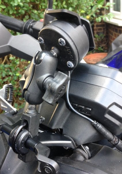

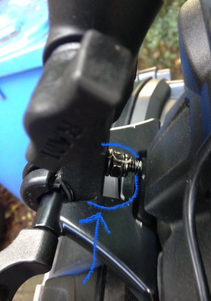

    well ive been toying with getting an above clocks mount for my sat nav as i found the handlebar mount too close and too much of a head movement to look at it. After looking at the possibilities none actually said how they fixed behind the clocks and I was reluctant to spend another £50 odd quid so I decided to see if I could use my Ram handle bar mount. I could. I had to cut a bit out of the screen mount bracket and shorten the bolts ( best done with the nuts on so you re thread as you take them off)
    A bit of padding so the clamp tightens up
    taraaa! I'm quite pleased with it, yet to take it out on a test run though. It also protects it from the weather a bit better
  5. crispey
    7,198
    Took it for a test run and it works really well! So you can use the standard handlebar mount that comes with the satnav to make an above the clocks one.
