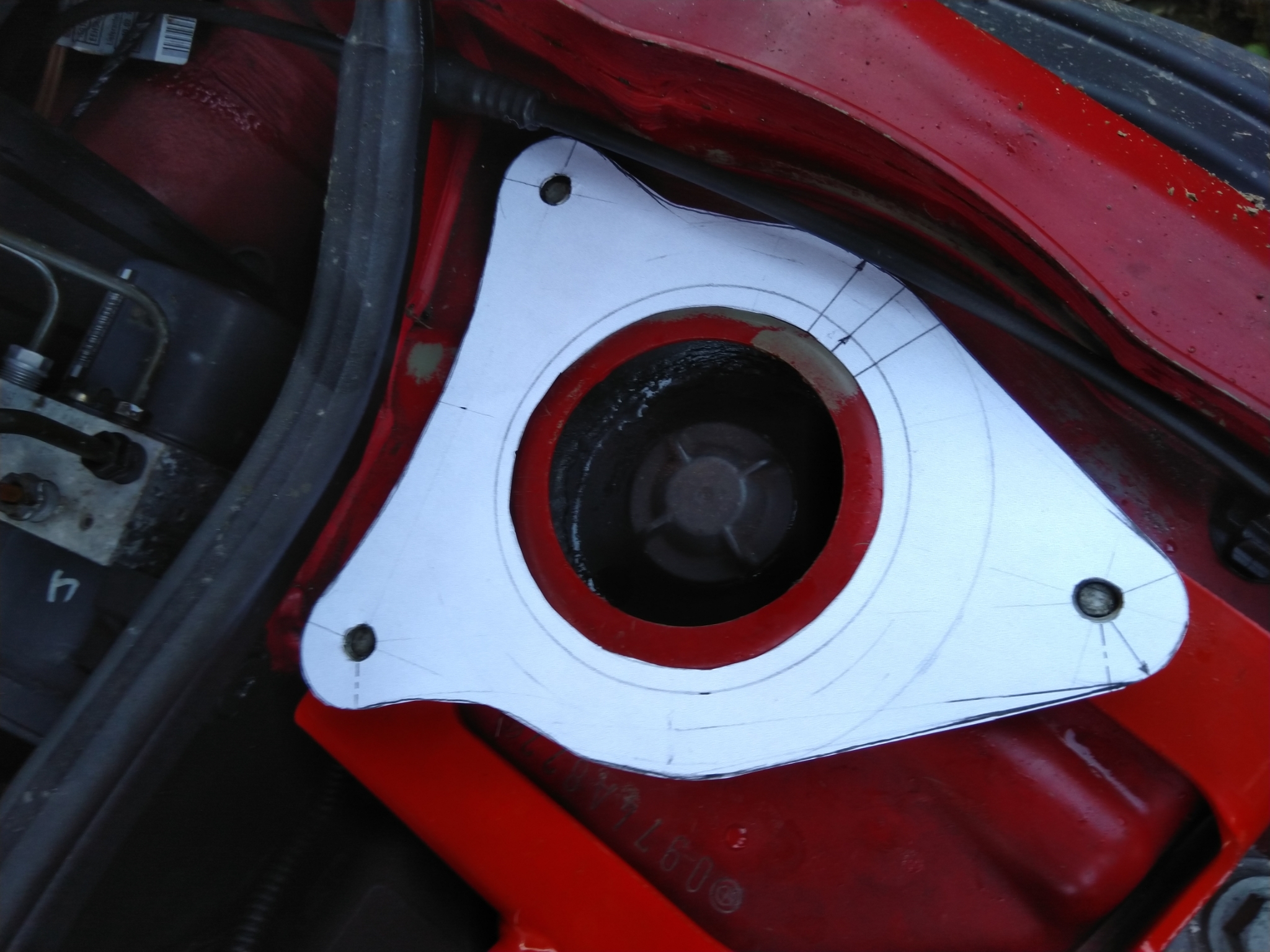

  6. MrOrange
    Yeah, but it only uses 2 of 3 shock top bolts. Am going to get a template measured up soon. Not doing grass Autotesting till May, so have time to get it sorted.
    Need to make sure it's running right, before we start modifying. :cool:

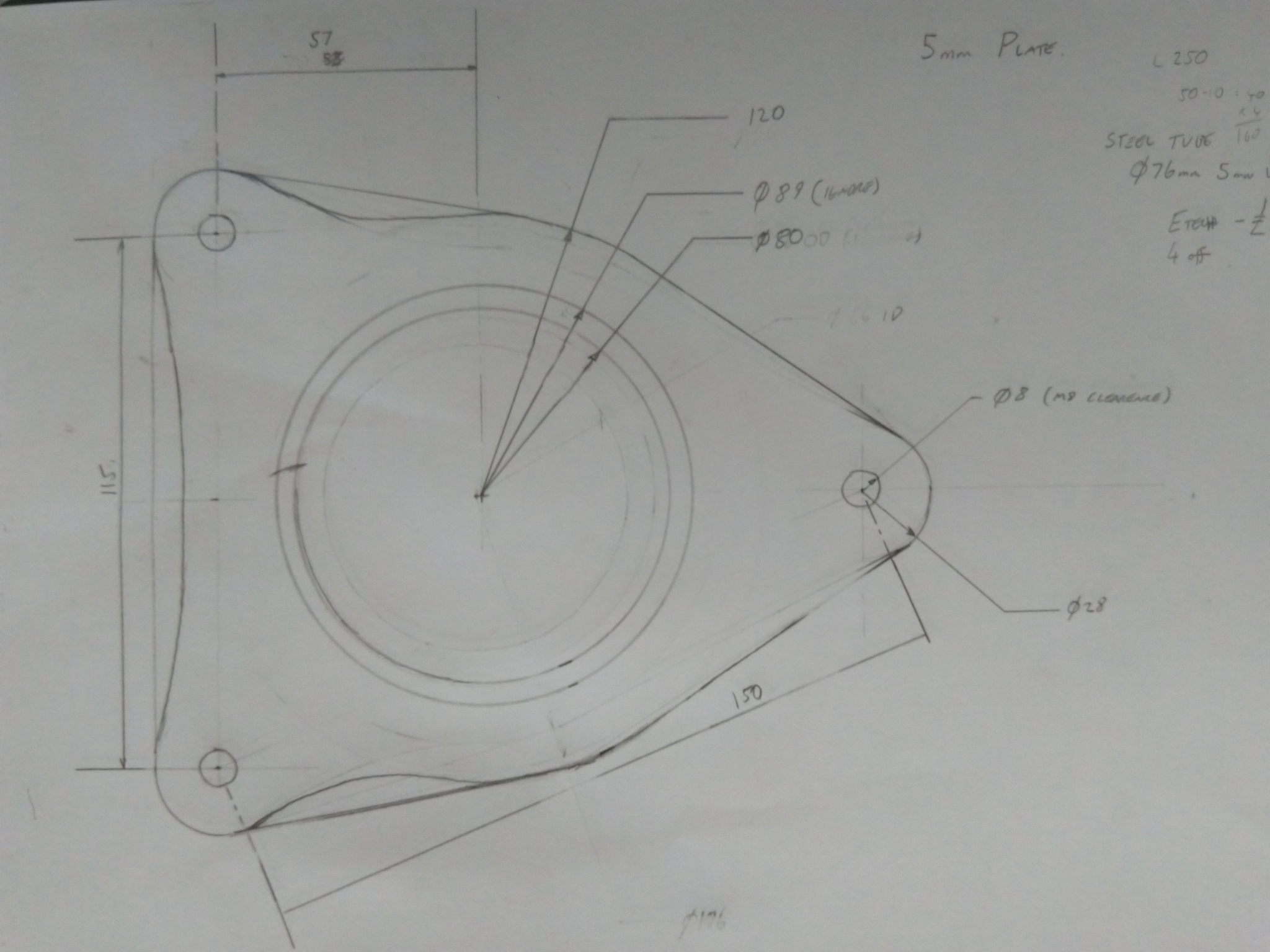

    Spent the morning designing the plates for my suspension lift. Started with a 3" / 76 mm tube, but changed to a 89mm OD tube to reduce bending on the plate.
    @andyc1 - The photo good enough or would it be better as a scan? Can email it across.
  11. MrOrange
    The only one I see I've missed is the centre line. It's half way along the 115mm centre measurement, on lh side of the drawing.
    Cheers Andy :kissing_heart:

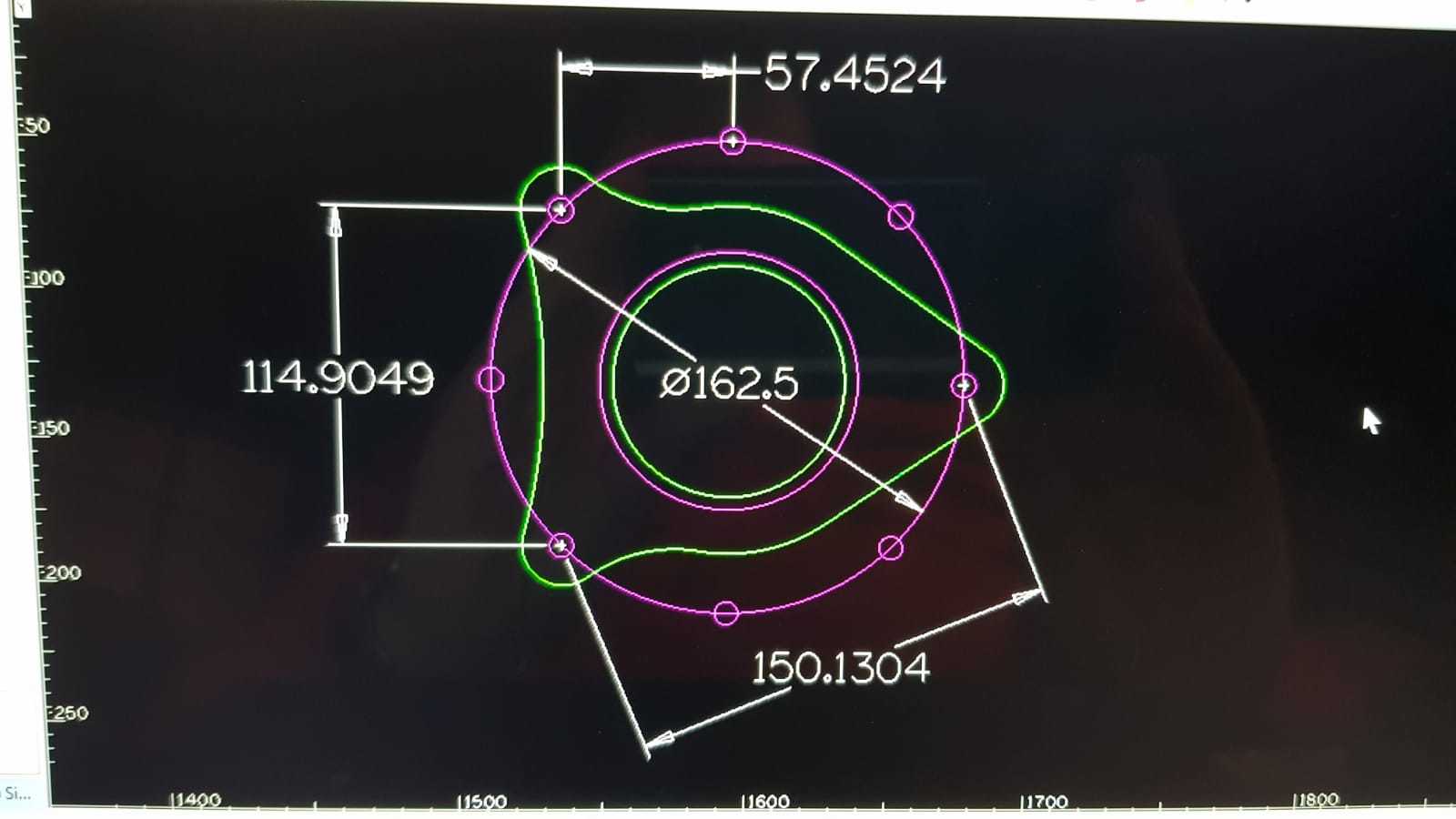

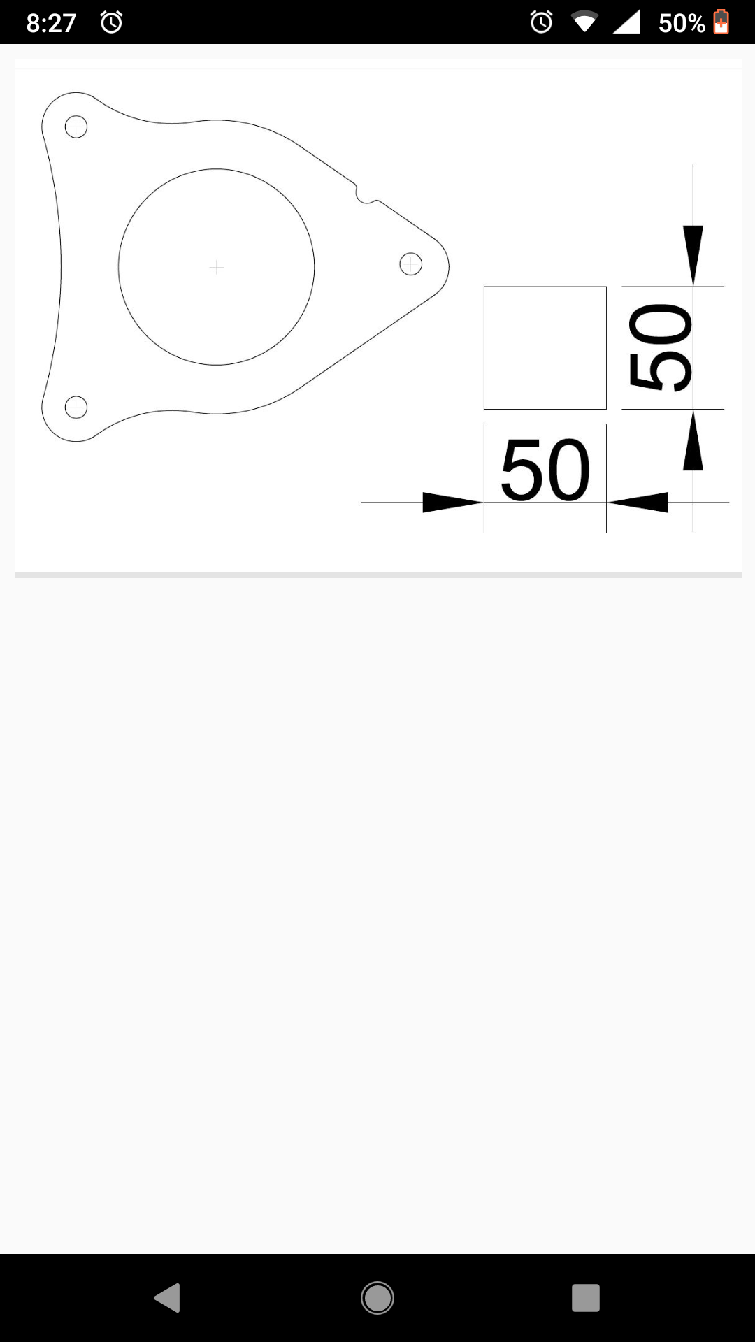

  17. MrOrange
    That's it sorted. R&A Developments have designed the top plate for the mini spacers.
    We thought we had worked out an a 162mmm pcd, but it didn't work out. Feckin stoopid girmins :triumph:, you'd have thought they'd worked it !!! Nope. :confounded:
    The wee notch is because they are going to be handed. Will be identical, but the notch has to go to the outside and they'll fit perfect.
    It's amazing what two bored, technically minded chaps can do in a day :D
