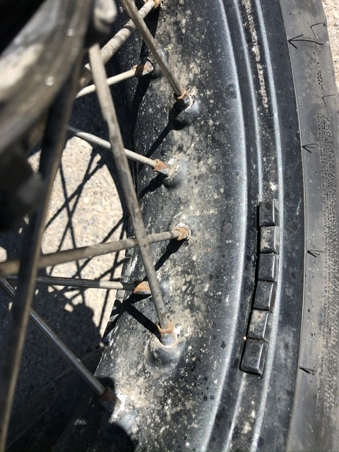

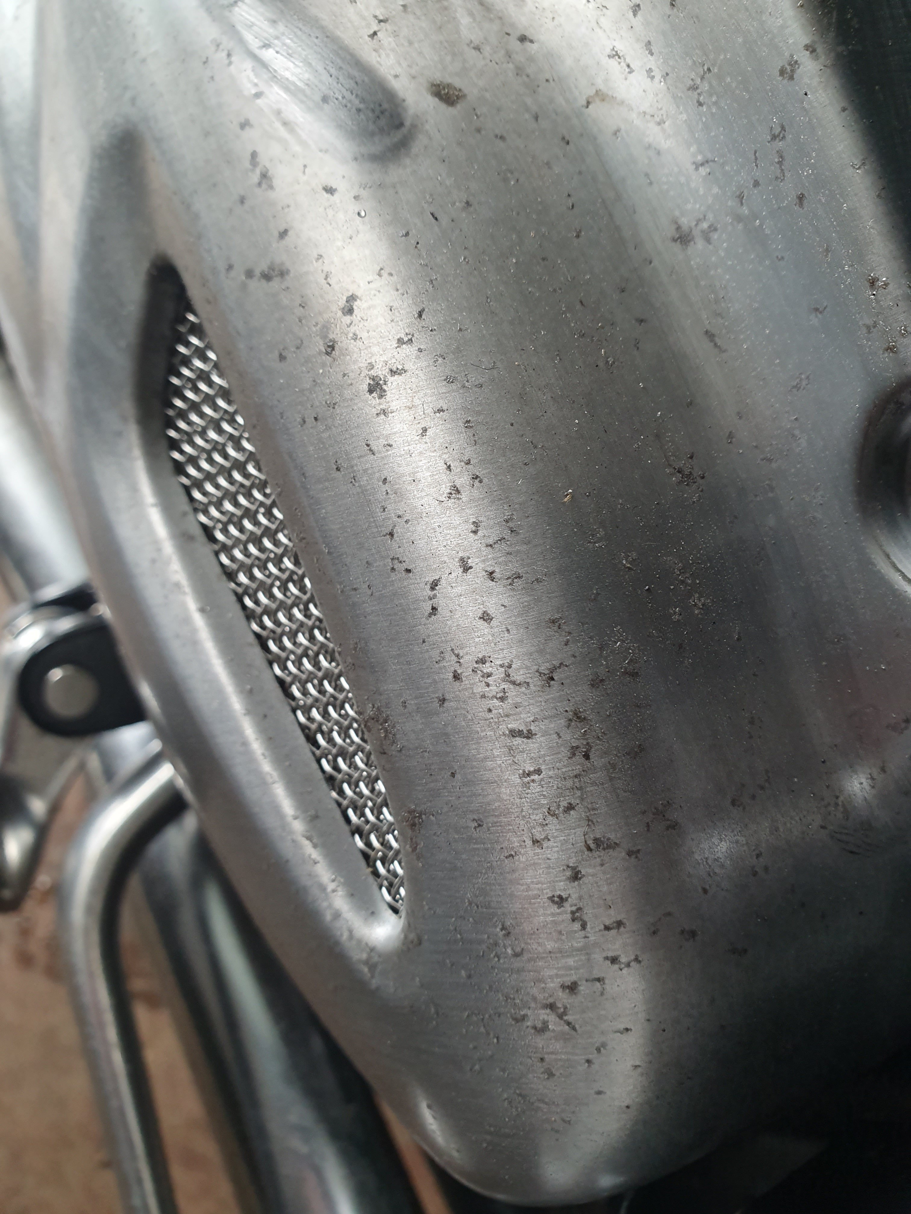

    Rust vs Corrosion
    Most metals want to corrode back to some form of ore. (Gold is one notable exception.) Corrosion starts with oxidation, where atoms of metal link up with oxygen, followed by a gradual, or not so gradual, breakdown. Rusting is a specialized form of corrosion that only iron and steel go through.
    Rust is when the iron oxidizes and flakes off. It’s accelerated by moisture. Flaking exposes fresh metal beneath, which in turn oxidizes and flakes.
    Aluminium oxidation happens faster than that of steel, because aluminium has a really strong affinity for oxygen. Rather than flaking though, aluminium oxide just forms a hard, whitish-coloured surface skin. When all the aluminium atoms have bonded with oxygen the oxidation process stops.
    Aluminium Corrosion
    Scratching this oxide skin exposes bare metal, and the process begins again. It won’t eat the metal away though, except under two conditions. First, if chlorides or sulphides are around they’ll attack the aluminium oxide layer.
    Chlorides are compounds of chlorine. Sodium chloride would be an example, which is the chemical name for salt. And where do you find lots of salt? In the ocean. Likewise, sulphides are sulphur compounds. They’re prevalent in areas of polluted air.
    Second, if conditions are right you could experience galvanic corrosion. this is an electrical effect experienced when dissimilar metals are brought close together in a conducting liquid. For example, immerse brass and aluminium in seawater and electrons move from the aluminium to the brass. This can be a problem in boats where brass fittings are close to or even in contact with aluminium. (Fuel tanks are a prime example.)
    Preventing Aluminium Corrosion
    You can’t do much about aluminium oxidation, and unless appearance matters, it’s not a big problem. Aluminium corrosion could however be a serious issue. If there’s any possibility of it happening you have two options: Apply a protective coating and minimize or mitigate the effect of galvanic corrosion.
    First picture's show no protective pre winter application applied nor any washing. The last picture is what will prevent corrosion.
