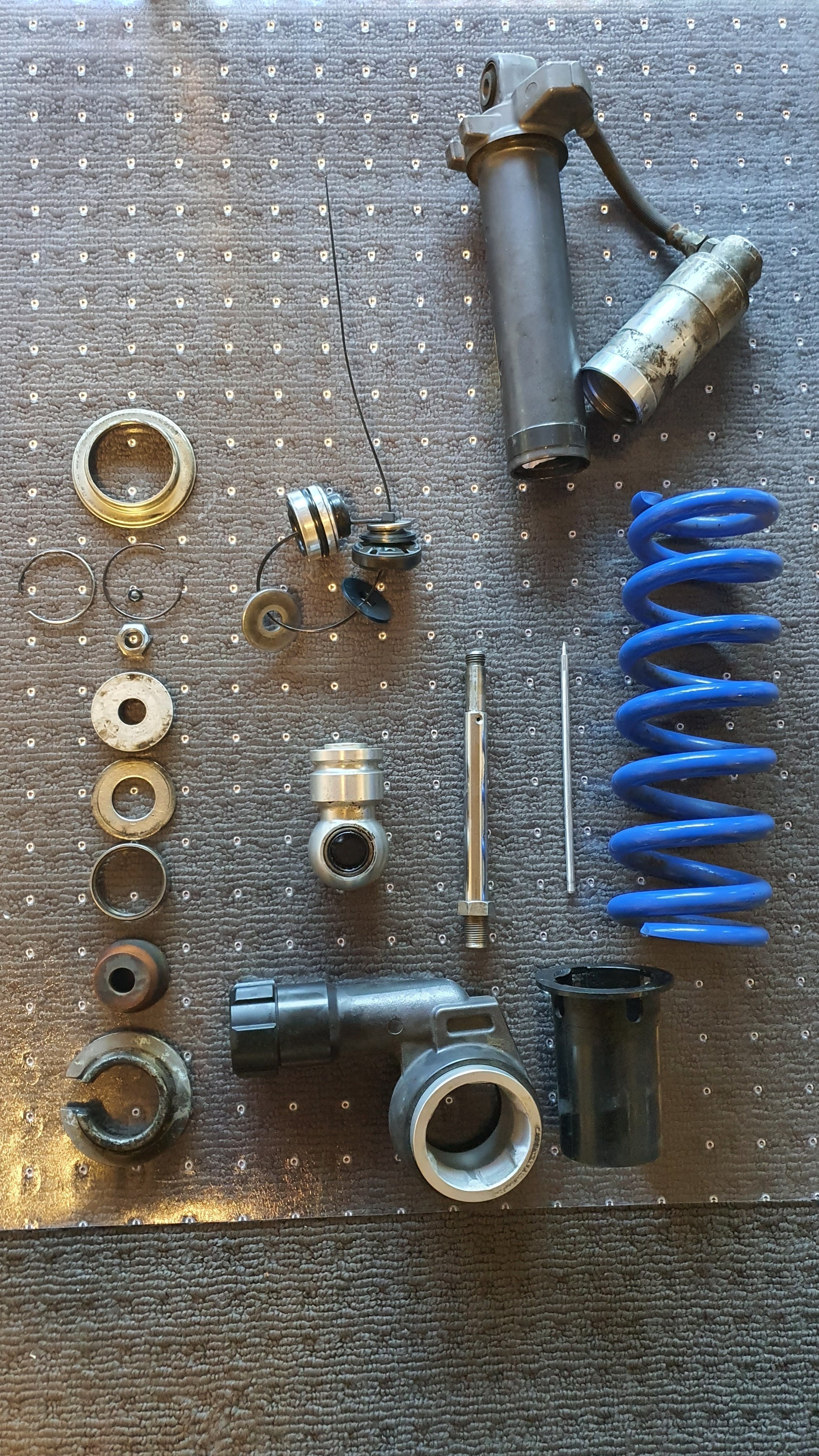

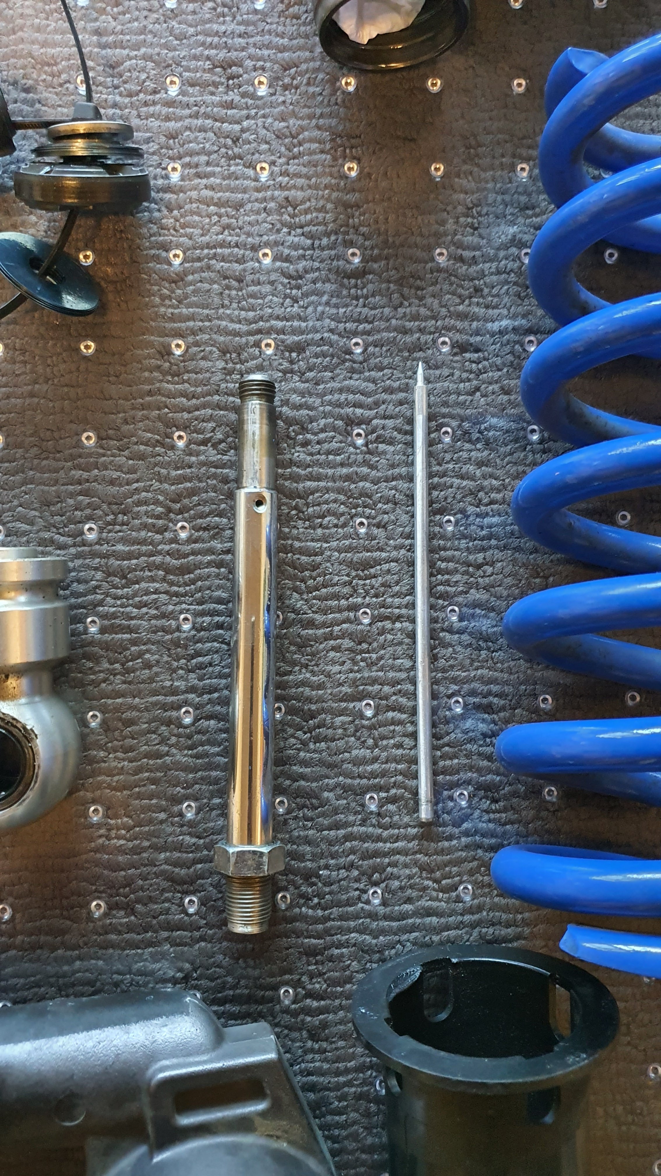

    Unfortunately mine was broken from the inside. It was some sort of a long needle like shaft that had snapped. I ended up buying a wilbers type 641 Competition suspension.

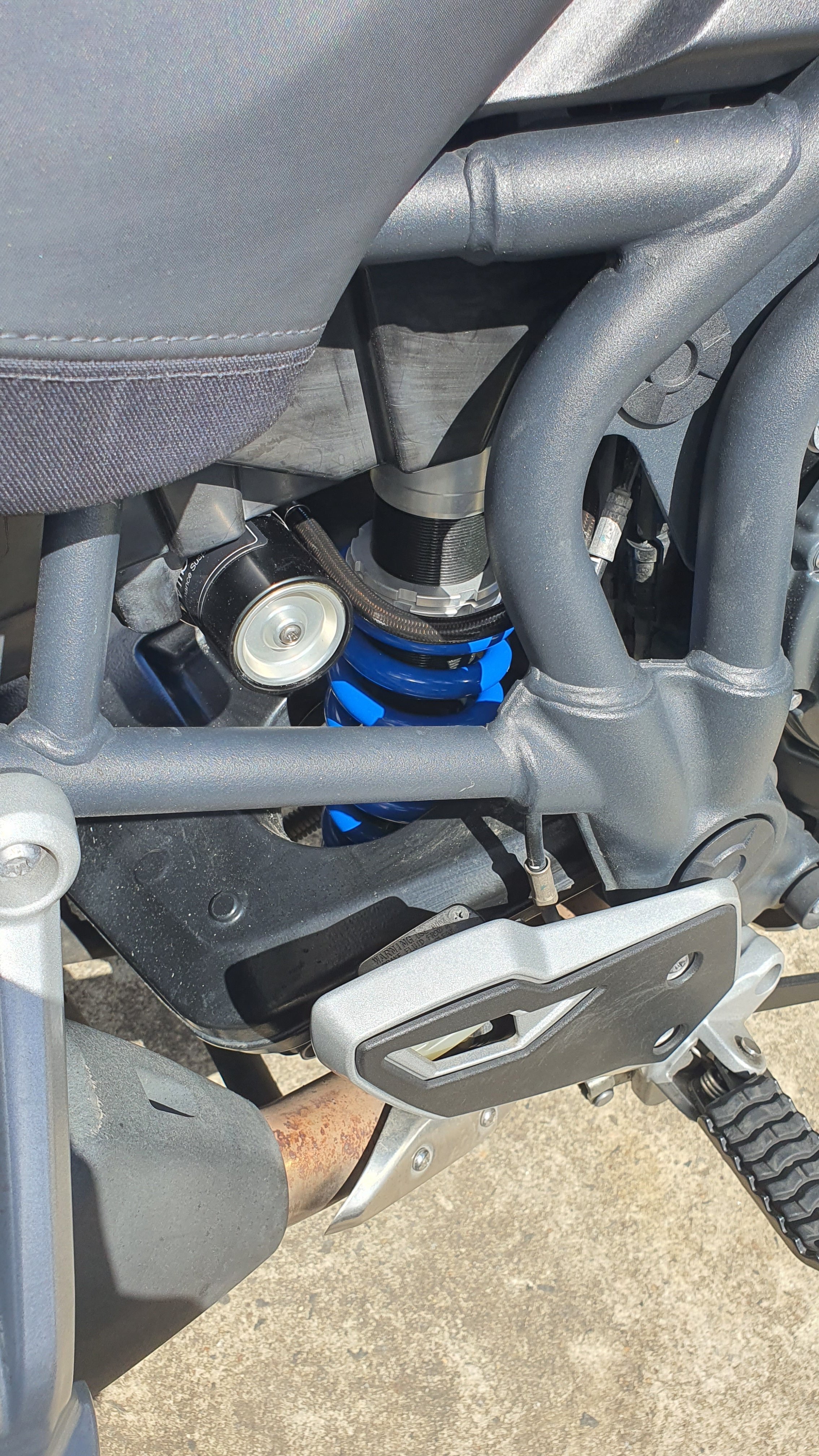

    It has been 2 months and 11 days of wait till I finally got the bike back.
    I didn't had proper time to ride the bike yet but all the noises are gone and the ride is more stable.
    I'll post the photos of old disassembled suspension and some photos of the new one.
    Thank you all.
