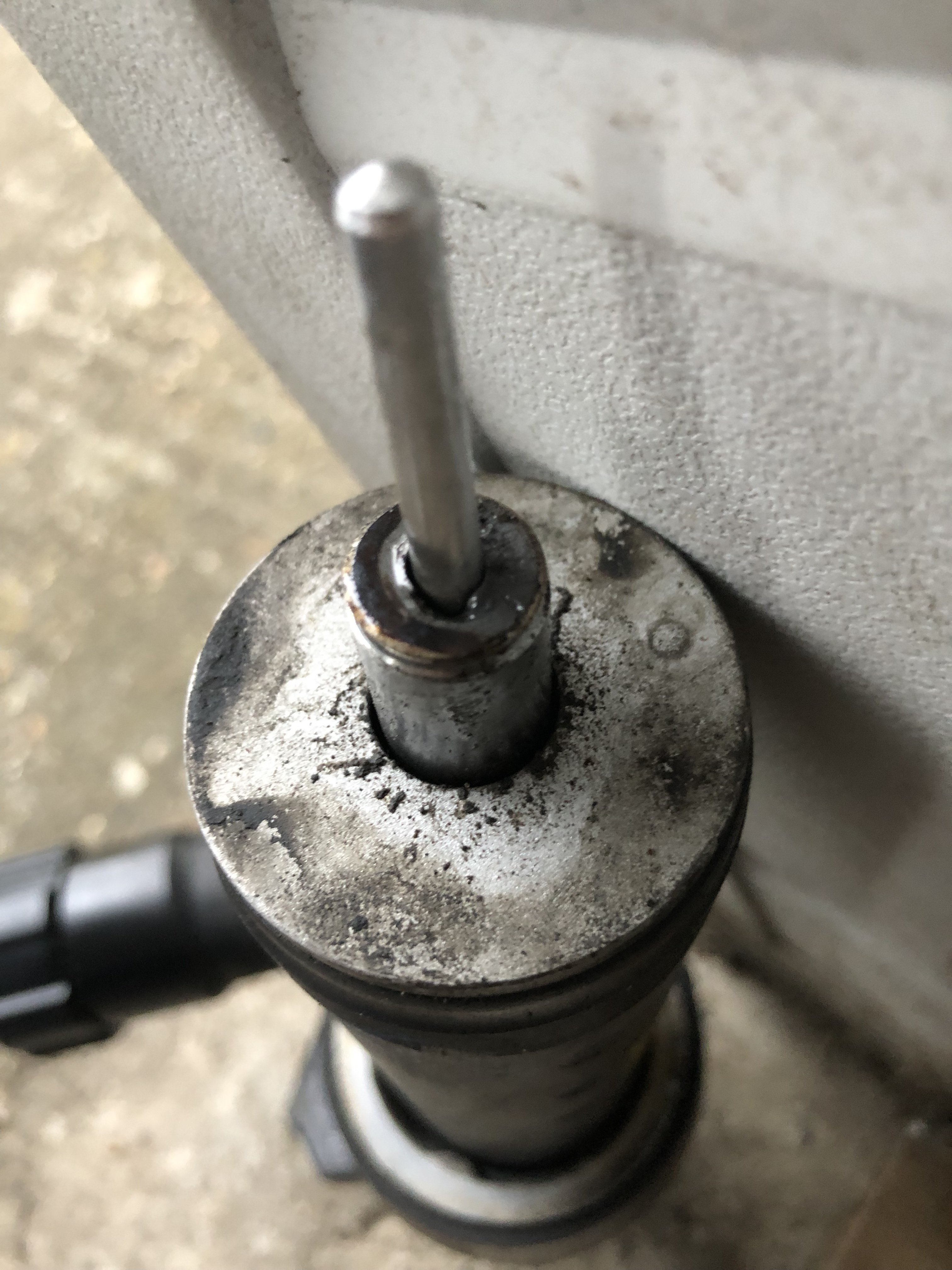

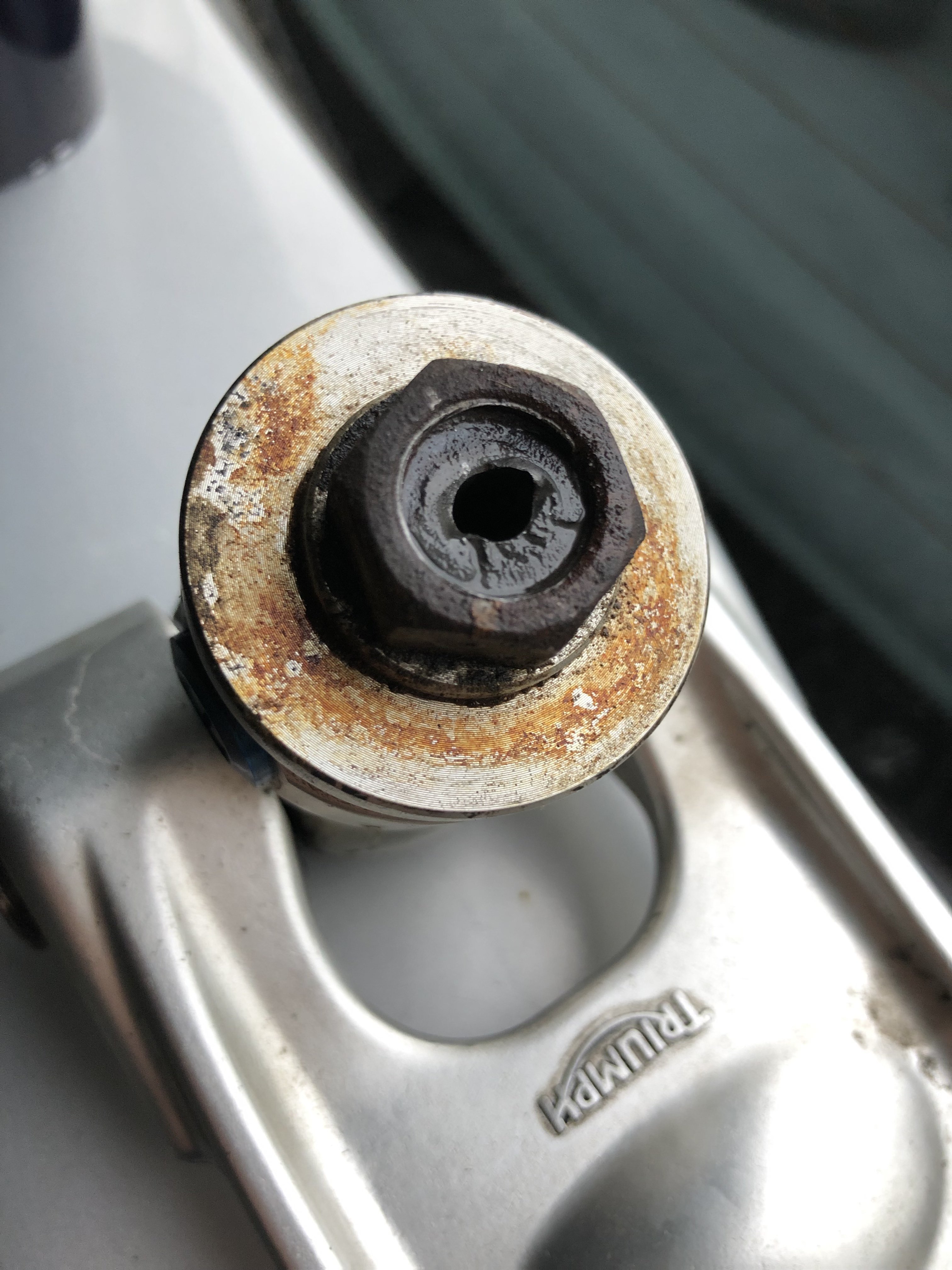

After a bit more investigation, Jack Lilley's service department have said that it appears something has failed within the shock absorber that is not connecting the dampening rod. There is no leakage and it is not wear and tear, so it appears to be a failure within the unit. Now waiting to get a further response from Triumph's technical support department.

I have a 2013 explorer, 22500 miles and rear shock gave out. After pulling the unit it was apparent the damper shaft has snapped at the base. Admit replaced it with Hagon as £1250 is expensive for a genuine!
