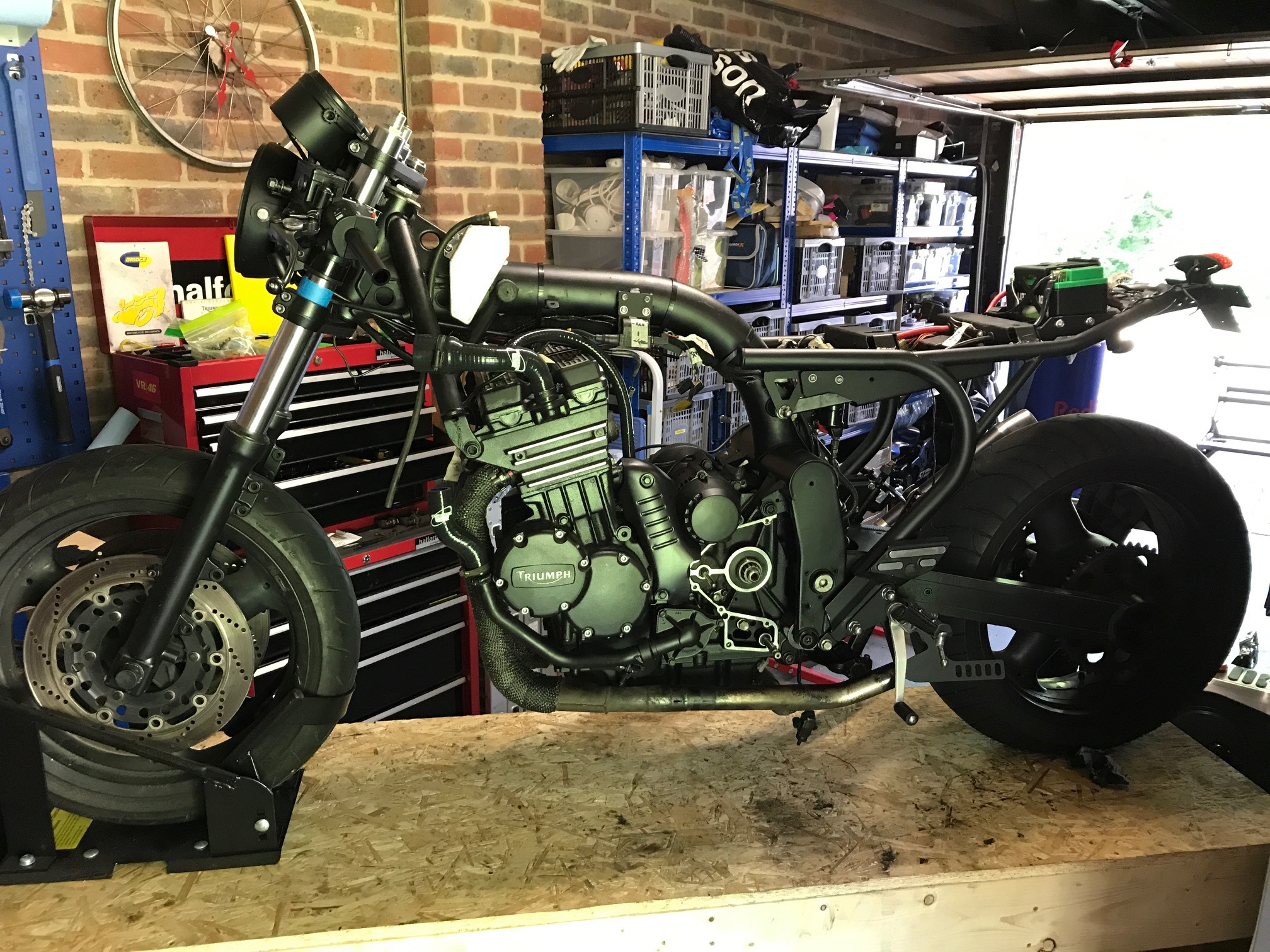

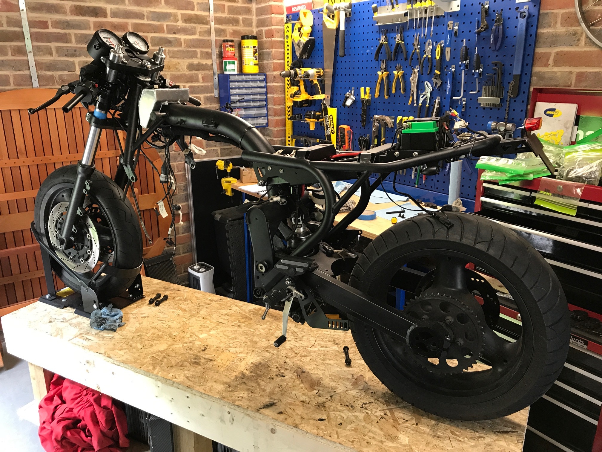

    OK so made quite a bit more progress this weekend with a big push to get it all done by the end of the month.
    Still a few more bits and pieces to do but the main thing is the wheels are on !!!

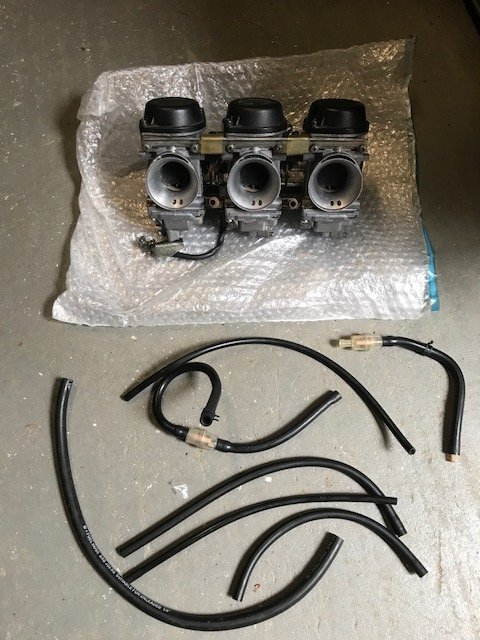

    Guys I have run into a bit of a problem - to clean my carbs i removed all the pipes and blew them apart. They are all back together now but not 100% sure how to route all the pipes.
    I know the bottom 2 go to the fuel tap but can someone help me with the vac pipe setup please?

    Vac pipes at top of carbs, ( 2off ) leave open, the 3 smaller ones on the plastic carb tops have rubber plugs that seal them off

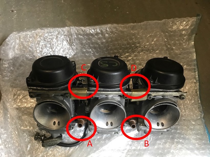

    OK so here is my dialemma...
    I know A and B go to the fuel tap but not sure where C and D go.

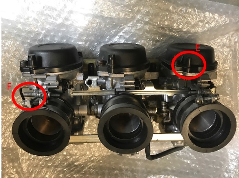

    Then there is E and F
    Not even the Haynes manual explains so am a bit stuck but am sure plenty of you will be able to show me just how stupid I am being.

    Hi There.
    A & B Connect together with t piece ( see CRK Manual and then connect to the fuel tap on the tank.
    E used to be vaccuum to tank not needed now so get another one of the rubber covers same as on the other 2 carbs and blank off.
    F ignore it just end of casting.
    C and D are breathers for the carbs that used to go into the original air box.Just leave open.

    Thank you so much for this Boothy - just to check I dont need to route C and D away from the engine in case any petrol leaks from them do I?
  17. Boothy
    Boothy Active Member
    Sep 9, 2016
    117
    Lancashire
    No just leave them open you can get small chrome breather filters on ebay if you want to be sure

    Quick update:
    Almost there and just dealing with a few teething problems with the wheels. Turn our i need to shave down the mount points on he brand new calipers I bought to clear the spokes and centre the disks and need a new spacer for the front - all doable but just taking a bit of time.
    Sorted the disks out too and managed to get some wavy ones from BRAKING that fit perfectly.
