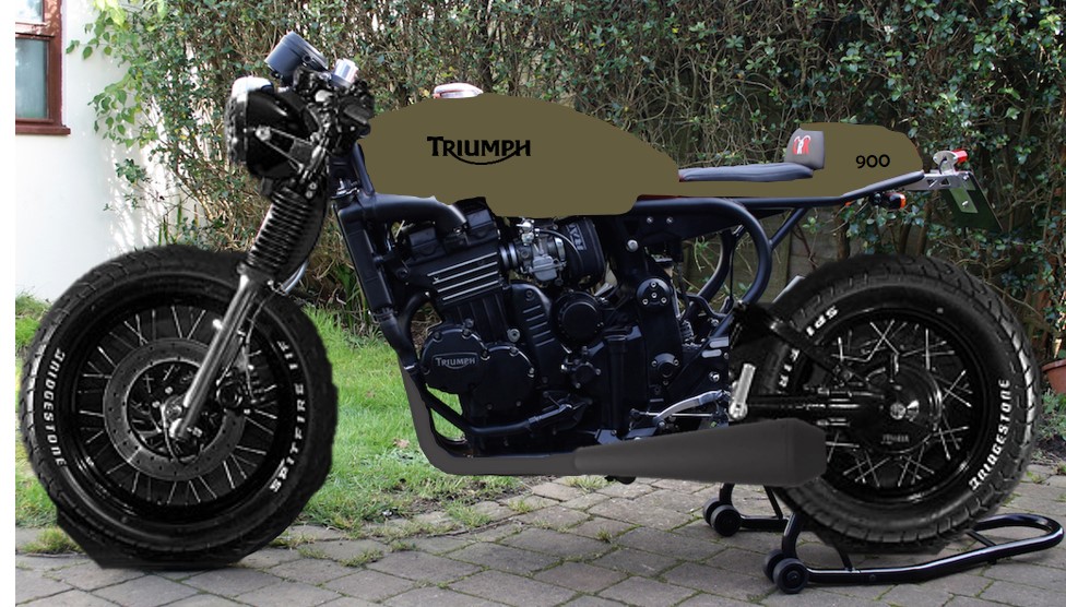

    Right so here is the vision ....
    Please pardon my graphics skills but paint will only allow so much! I know anatomically everything is not quite right but gives you a good idea of where I am headed.
    I will probably make a different plan with the rear light section and to keep the tail short and may try the exhaust further back and pointing up a bit but you get the general idea.
    Any thoughts??
