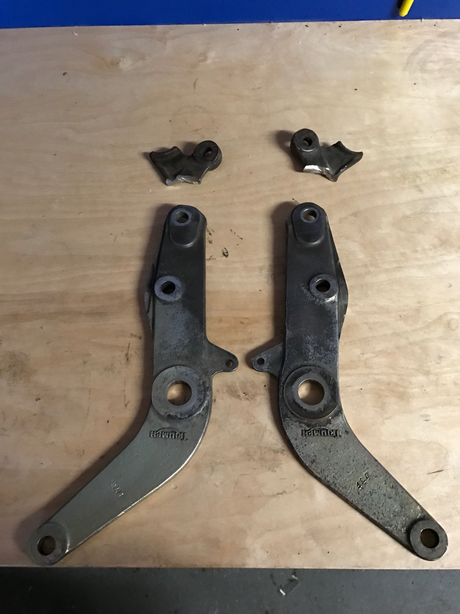

    117
    Lancashire
    Im sure that looks like you have cut to much off !!

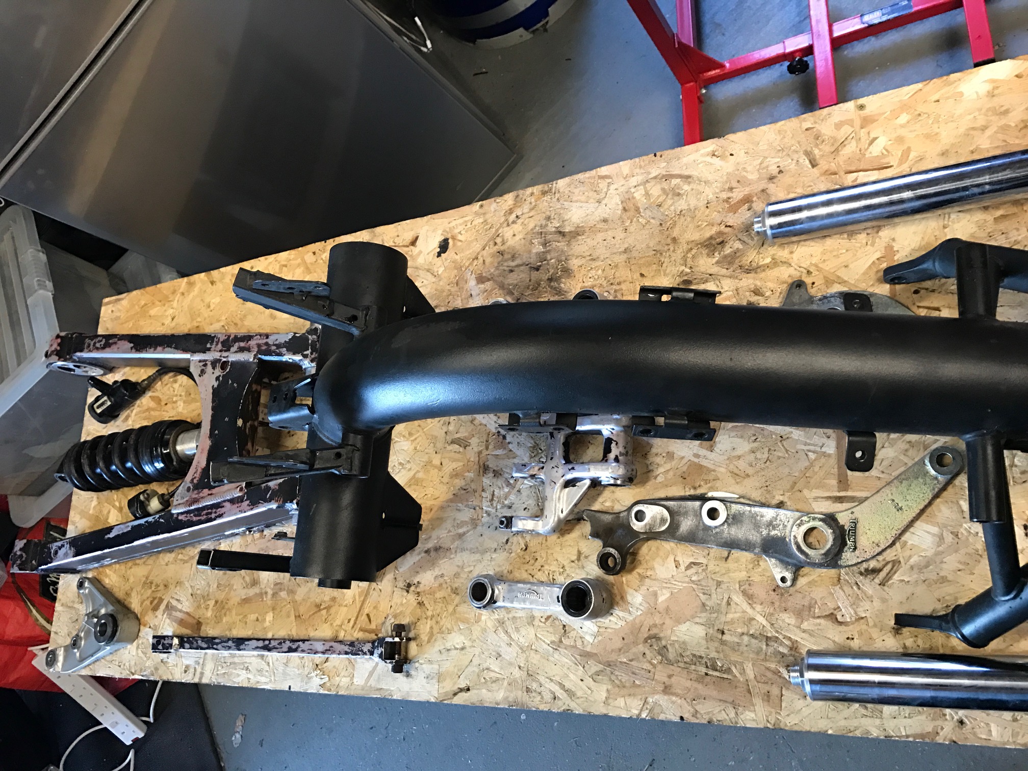

    Happy New year to one and all - I hope you all had a great festive period.
    Small update from me as family commitments left me little time for tinkering but managed to get everything clean and prepped ...
    Next steps is to paint the frame components and go over the engine before getting everything back together.
    Cant wait!

    Looking good!
    Get that centre stand mount cut off too! Saves at least 200g!!!
  13. Cafe Hinckley
    Cafe Hinckley Well-Known Member
    Nov 2, 2016
    176
    Reading
    Hey Matt,
    I noticed you had done that and actually wanted to ask you about that as they are pretty hideous when not in use. Did you just follow the line around the bottom mount with an angle grinder?
    Deffo gonna need those 200g after all the mince pies :)
  14. matt botterman
    matt botterman Active Member
    Feb 4, 2016
    107
    33
    sussex
    Yeah exactly right. The metal is actually slightly thicker for the main section making it easy to see where you want to cut.
    Vice, then angle grinder, then bead blast, then paint with a rattle can so it doesn't rust!

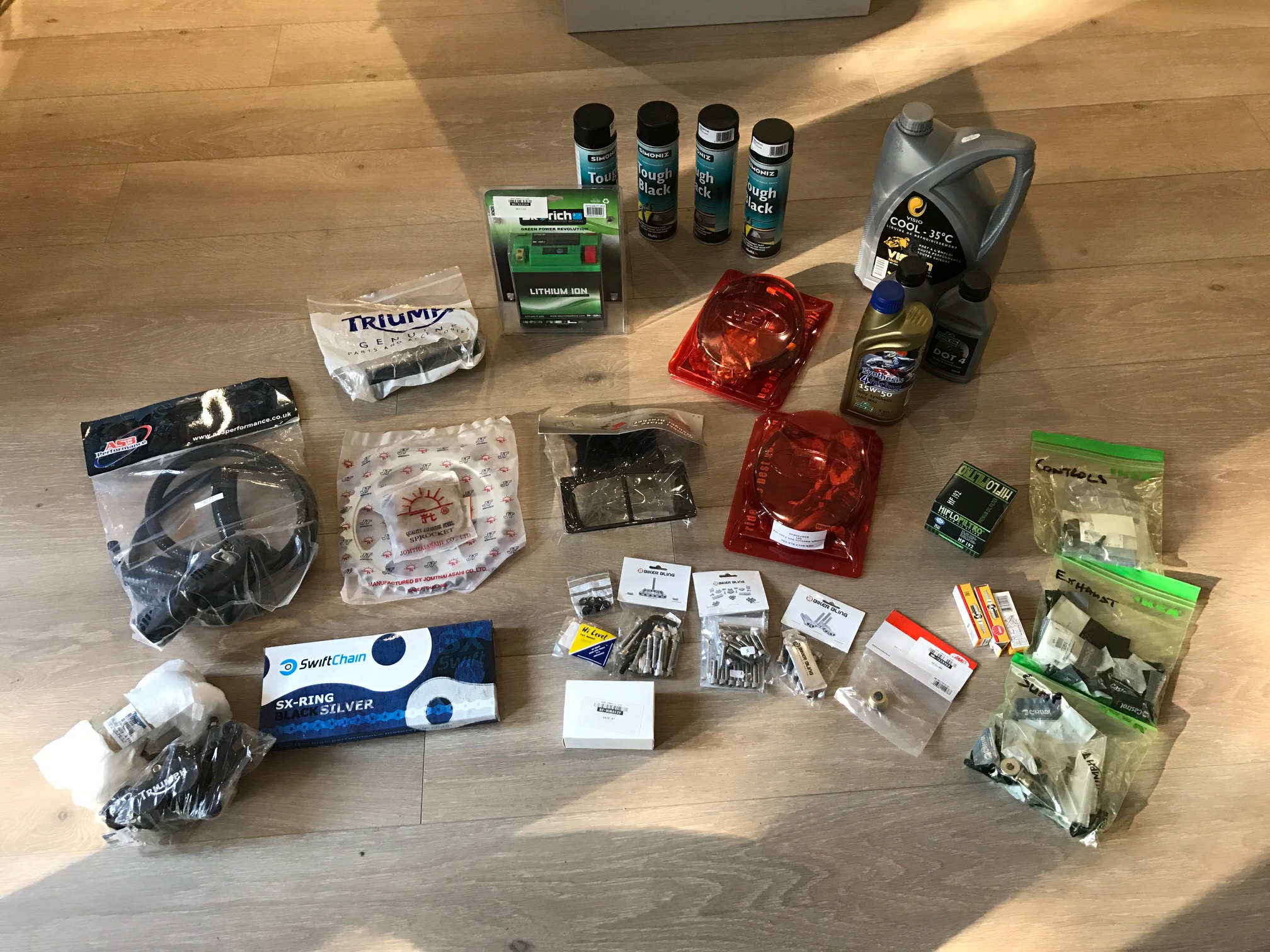

    Building up for a big weekend of spannering!!!
    Part are starting to arrive ...
    Forks are back from Brook Suspension
    And engine will be ready for collection early next week.
    Hoping to have frame/engine painted and back together by the end of next weekend - just in time for the wheels :)
