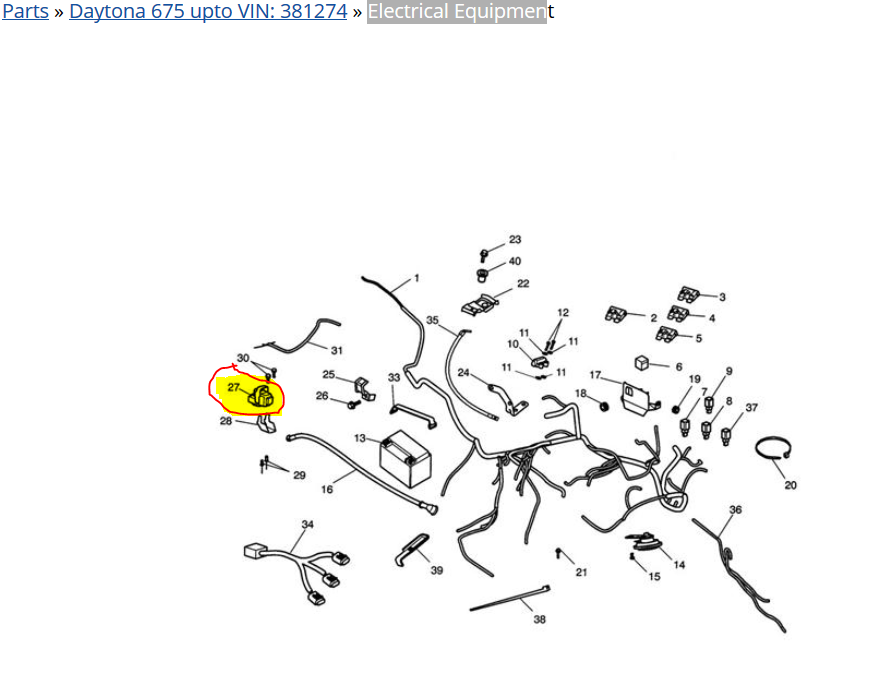

    Please can u help the not been on the bike for a week took her out the garage today started first time went for a hour ride and stopped for a cuppa got back on her and she wouldn’t start or even try there was a Halfords near by so I baught and fitted a new battery and started first time off I went for about 40 mins then stopped for fuel now won’t start not even a turn over so here I am stuck in a petrol station waiting for recovery but why why why won’t it start it’s a brand new battery

    okay, sorry you are stuck there
    First the easy things, kill switch is in the on position
    Side stand up
    In neutral
    Clutch in
    Battery is still connected with a strong connection to the wires
    Does the dash/clocks light up
    Does the fuel tank pump charge up
    Is there any clicking from the starter solinoid

    Yes to all the above
    I can hear the pump but no clicking

    Just spoke to the dealer I baught it from they will pick it up tomorrow and find the fault
    Should I say to them about the solonoid

    Just explain the symptoms as best you can, the decision needs to be theirs as to what is wrong.
    If they replace the solenoid and it still wont start, they will say you told them it needed a solenoid and you are responsible for the cost.

    It could be a simple solution as a stuck side stand or clutch switch
