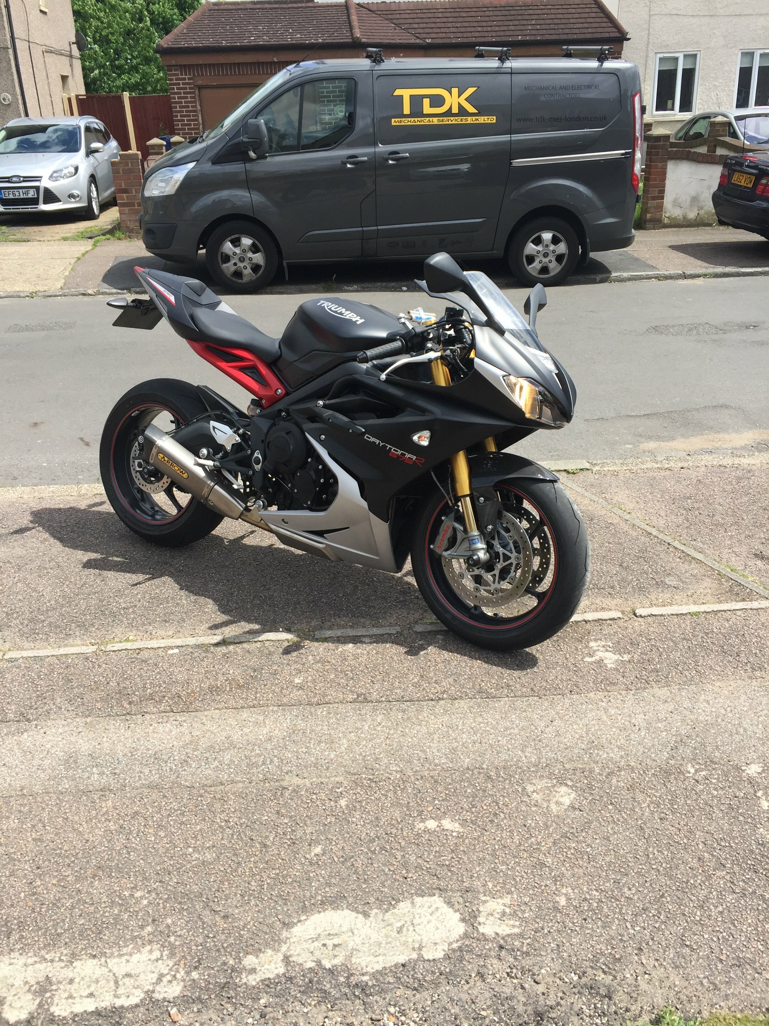

    I used to wipe over my Daytona with hot water on a cloth to remove stubborn mess, usually dead flies then used Halfords spray can Brake cleaner which evaporates very quickly to clean the whole bodywork.
    Kept it three years and it always looked good 12783E21-9A27-4C66-994A-70AD4D814362.jpeg

    That’s exactly what I do with regards to the hot water and a microfibre cloth after each ride. I’ve heard of people using brake cleaner but have never tried it myself. Very nice bike by the way. I alway wanted to ride a Daytona, but never had the chance. Maybe one day.

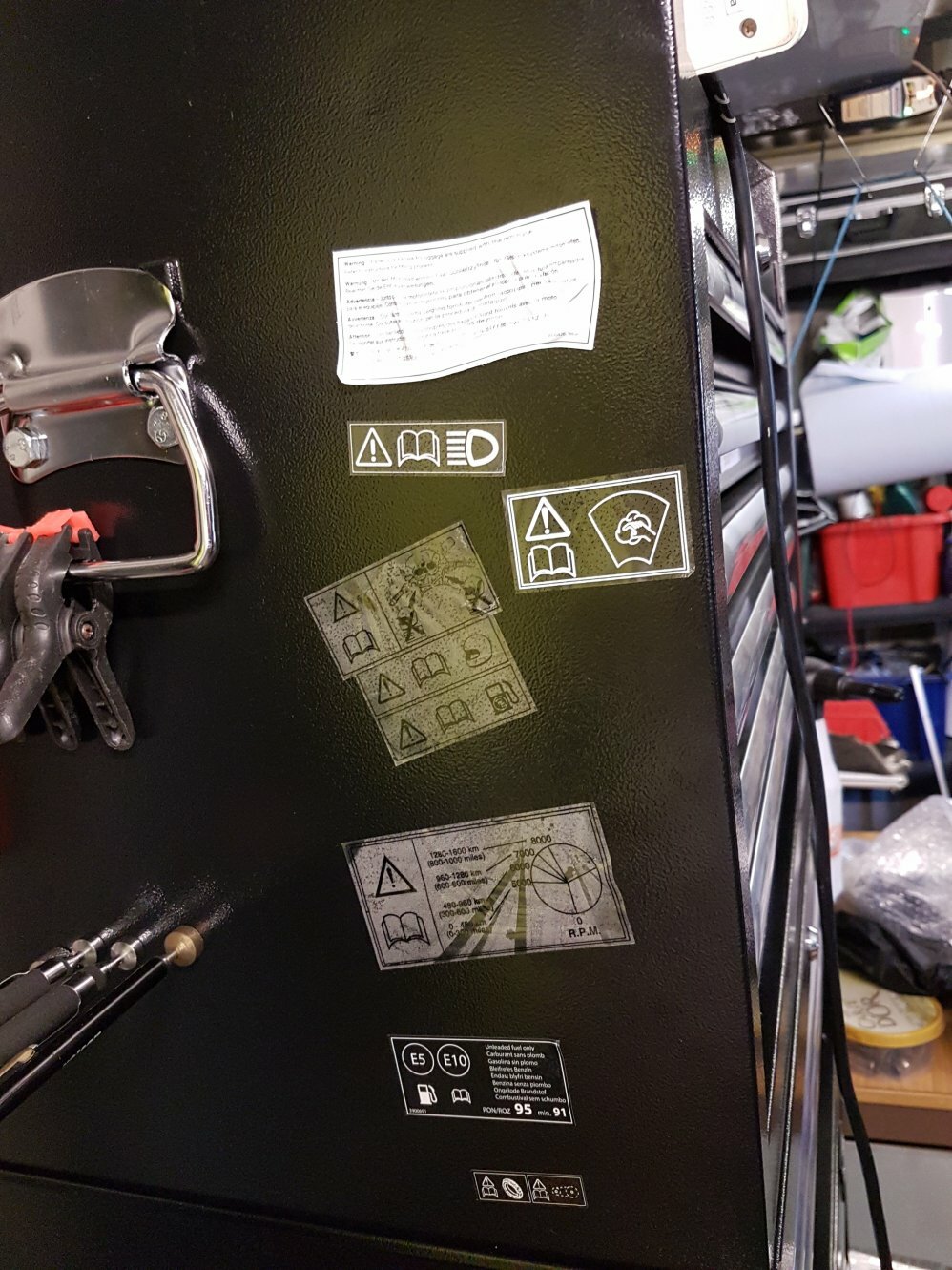

    Removed the stickers on my Tiger the other day, 4 of the things on the petrol tank alone! :mad:
    8 in total....
    I used a hot air gun to remove them initially and brake cleaner to clean the residue off.

    Congrats on the Tiger. That’s a good idea to stick them to the side of the tool box. I also removed the VIN sticker off the frame. It looks a little shabby as it doesn’t stick very well anyway.
